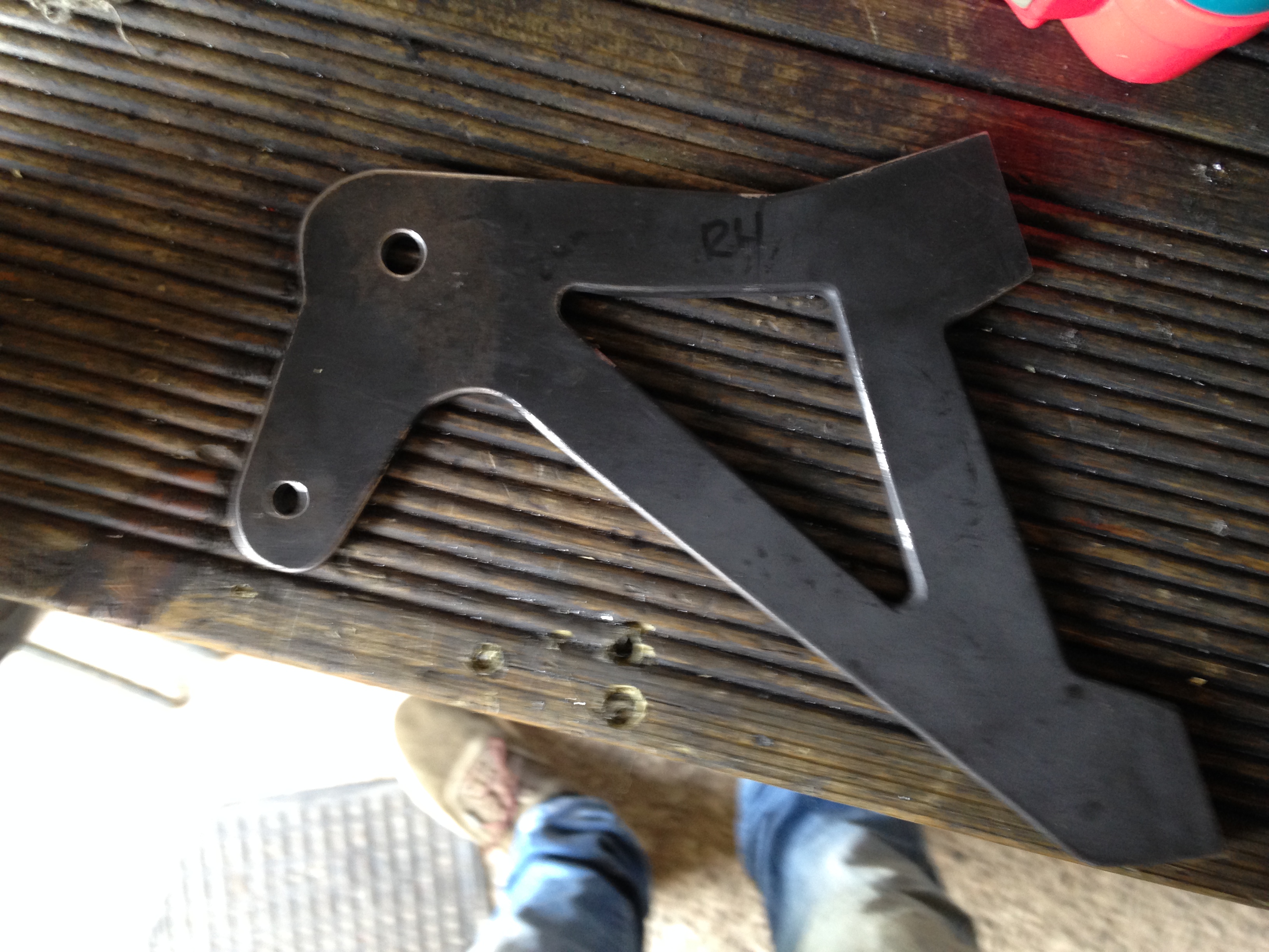

Got some time to drill the holes for the footpegs and exhaust hangers on the rear set mounts today.
I didn't like the amount of material on the exhaust hanger as it looked too big and out of place, so I drilled the hole so it wasn't concentric to the bottom, and will shape it further with the grinder to remove some more material.

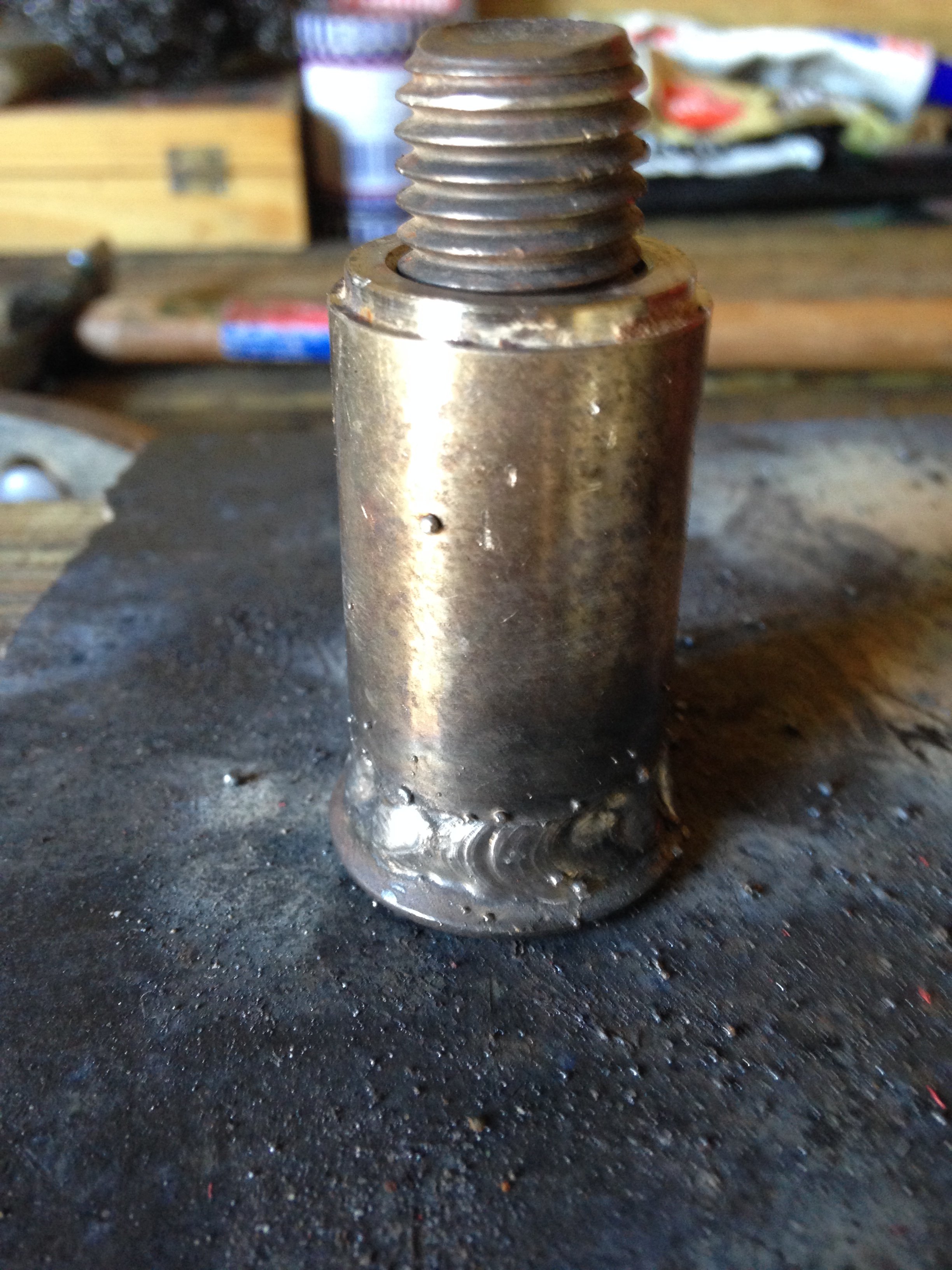

I found a scrap steel sleeve, so I tried welding it on to a bolt. Didn't go too bad I don't think. Any advice on the welds below?

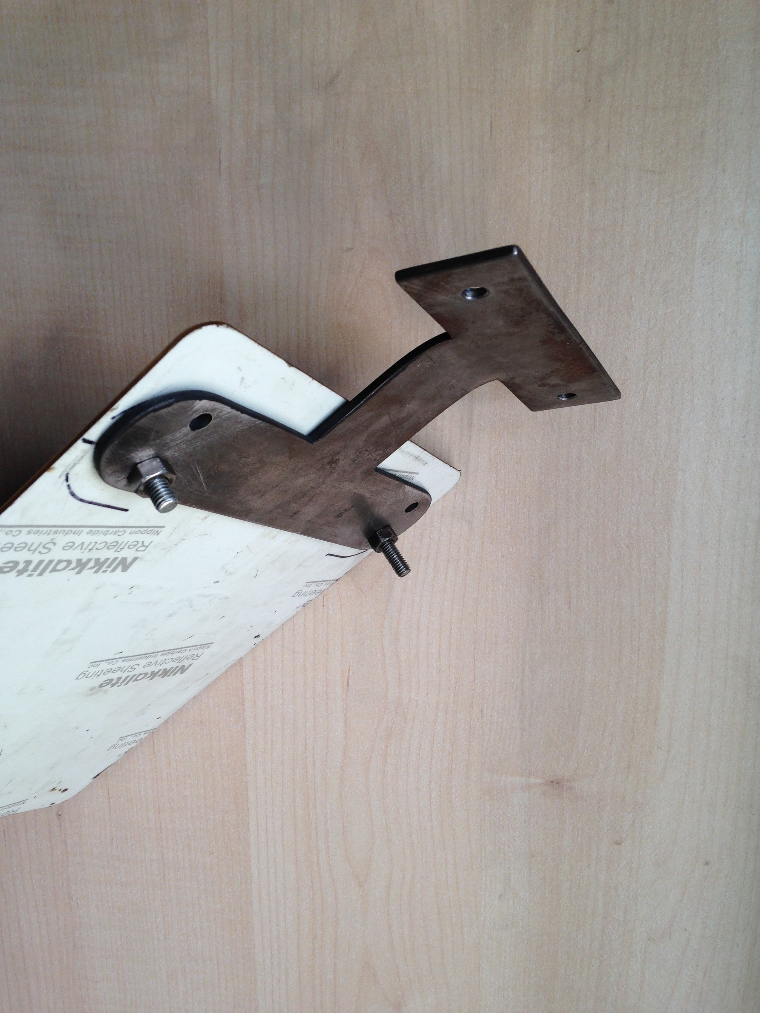

I also got around to sorting the mounting for my number plate bracket. Drilled the mounting holes, and got one of the slots 'cut'.
I still need to a bit more shaping and de-burring, but my arms is knackered from all the filing haha.

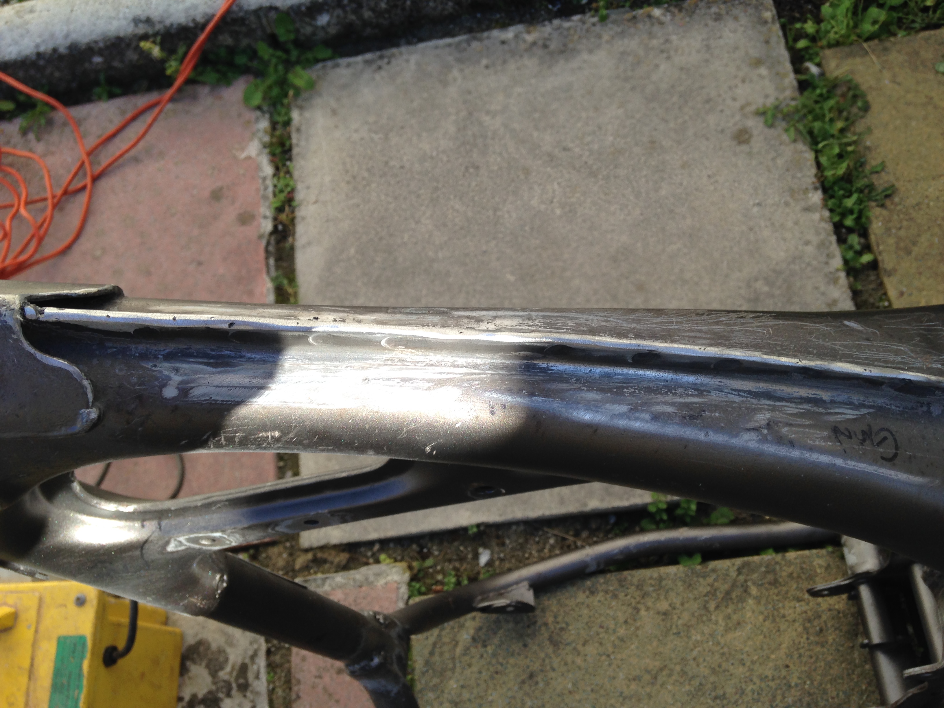

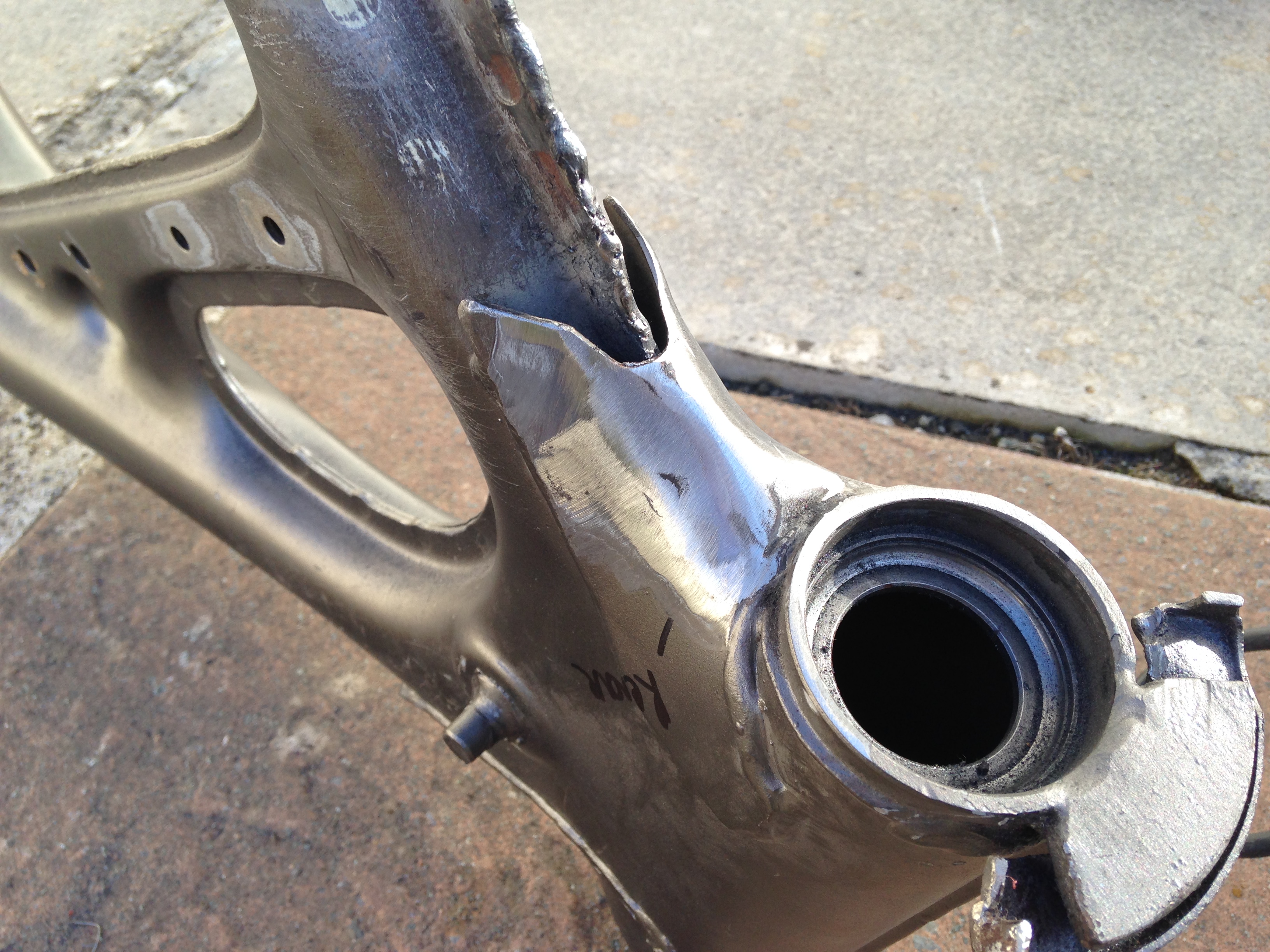

I tore the bike down to the frame so that I could weld the new rearset mounts on without ruining anything else. I'm also correcting a few thing while its torn down ready for powdercoat at a later stage.
I seam welded the backbone and downtube in order to increase rigidity. They could still do with being tidied up a bit with the grinder as my welds were far from pretty.
I also finally got around to removing the steering lock from the headstock as I didn't need it and forgot to remove it the first time around.
The rear has been shaped a little bit more, in preparation for a new seat pan. It will look and function exactly the same as the previous one, but will be welded on instead of bolted, and will have battery mounts etc now that position has been finalised.

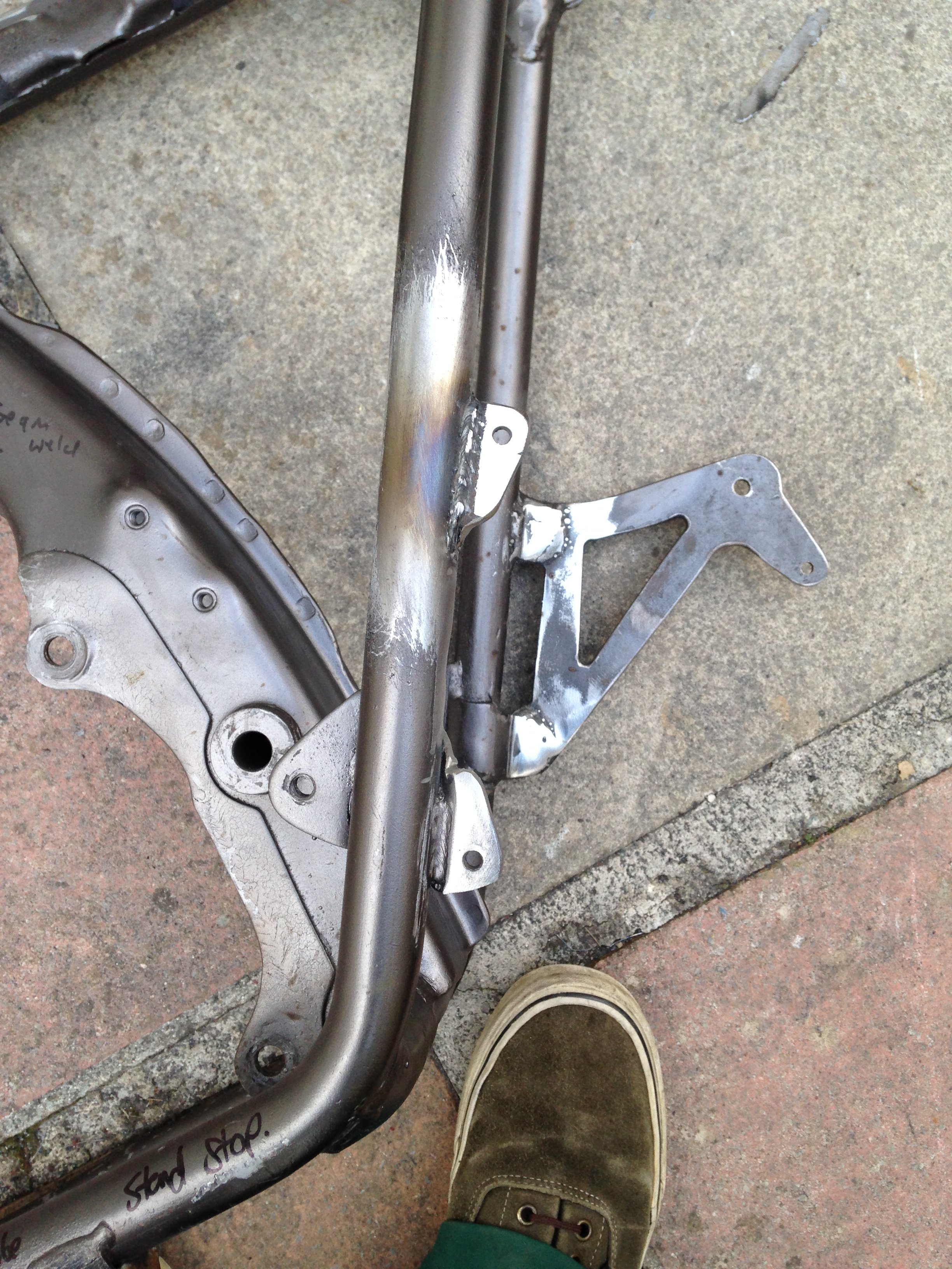

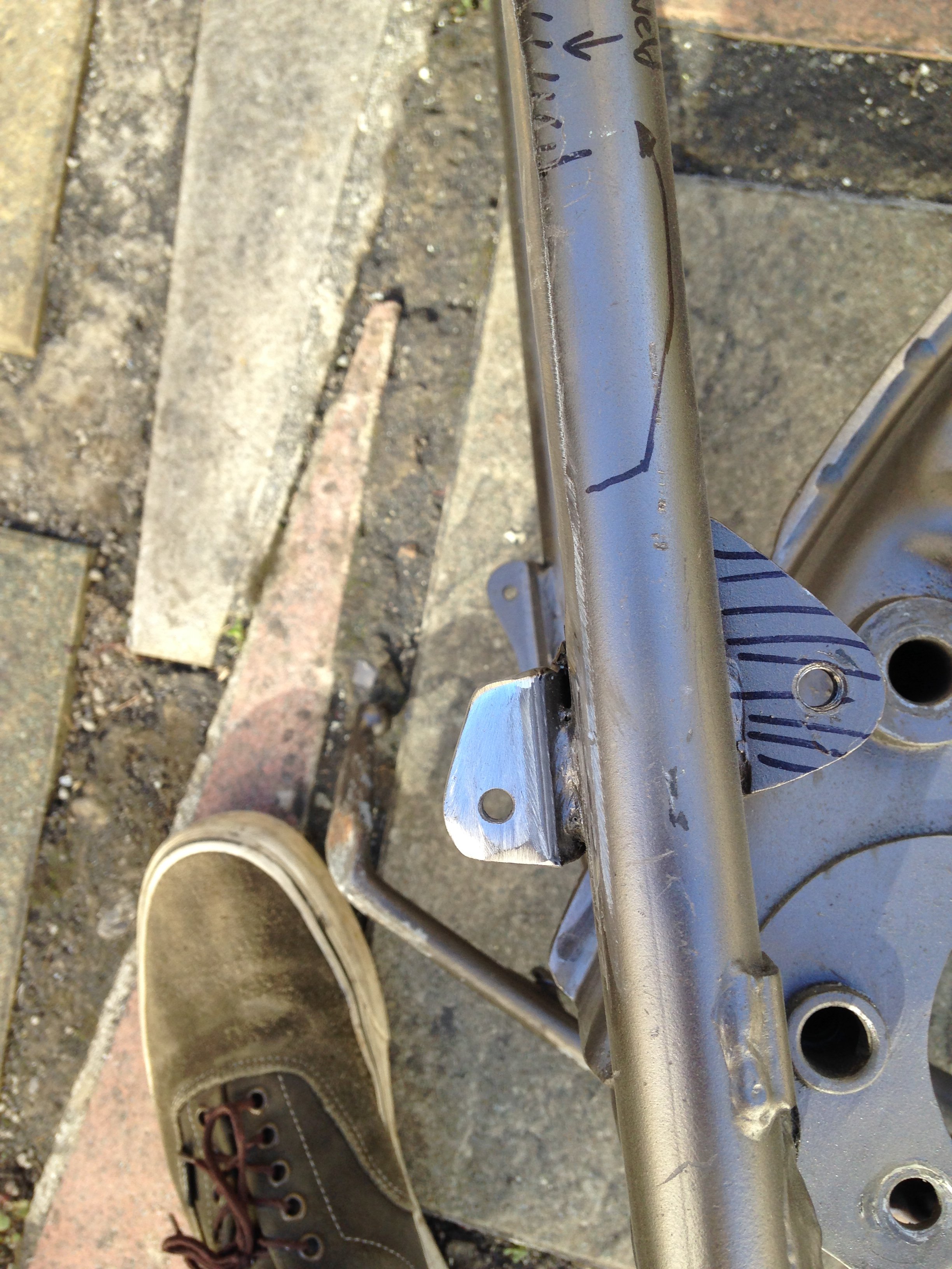

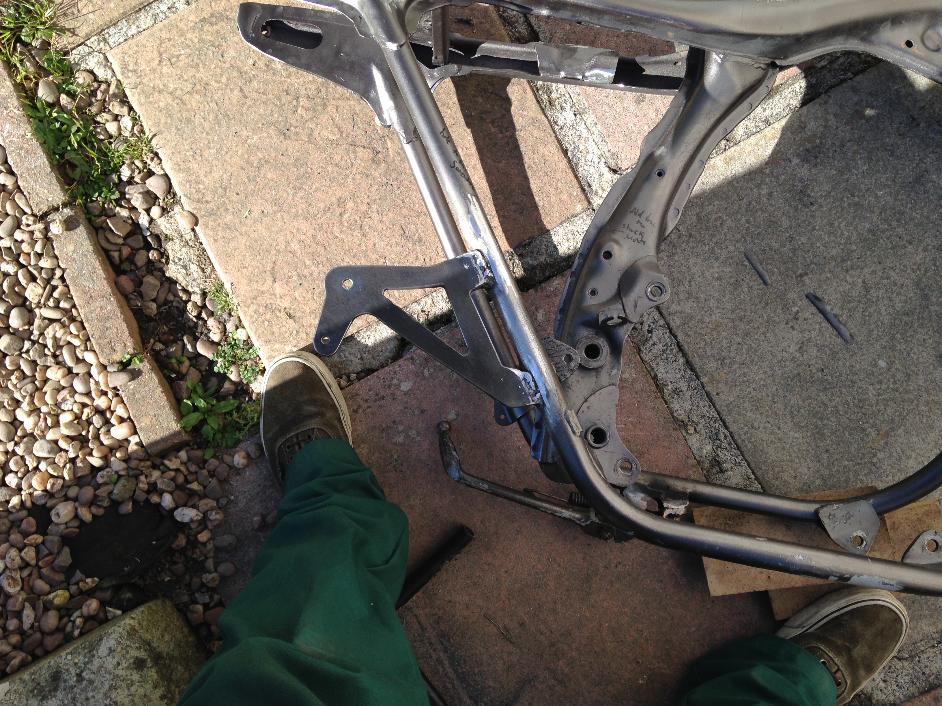

For the rear sets,
I cut the original mount into 2 so that I could basically 'lap weld' the bracket onto is, as well as welding it directly to the frame tube.
I had to weld the part I removed further up the frame tube so that it coincided with the top arm of my bracket. I then spot welded my rearset bracket on to check position, then welder it up fully.
I still need to weld the bracket to the mounts on the left side, and tidy a few of the welds up.
With the tank and seat in place, the mounts look much better than the cheap bolt on brackets I had!

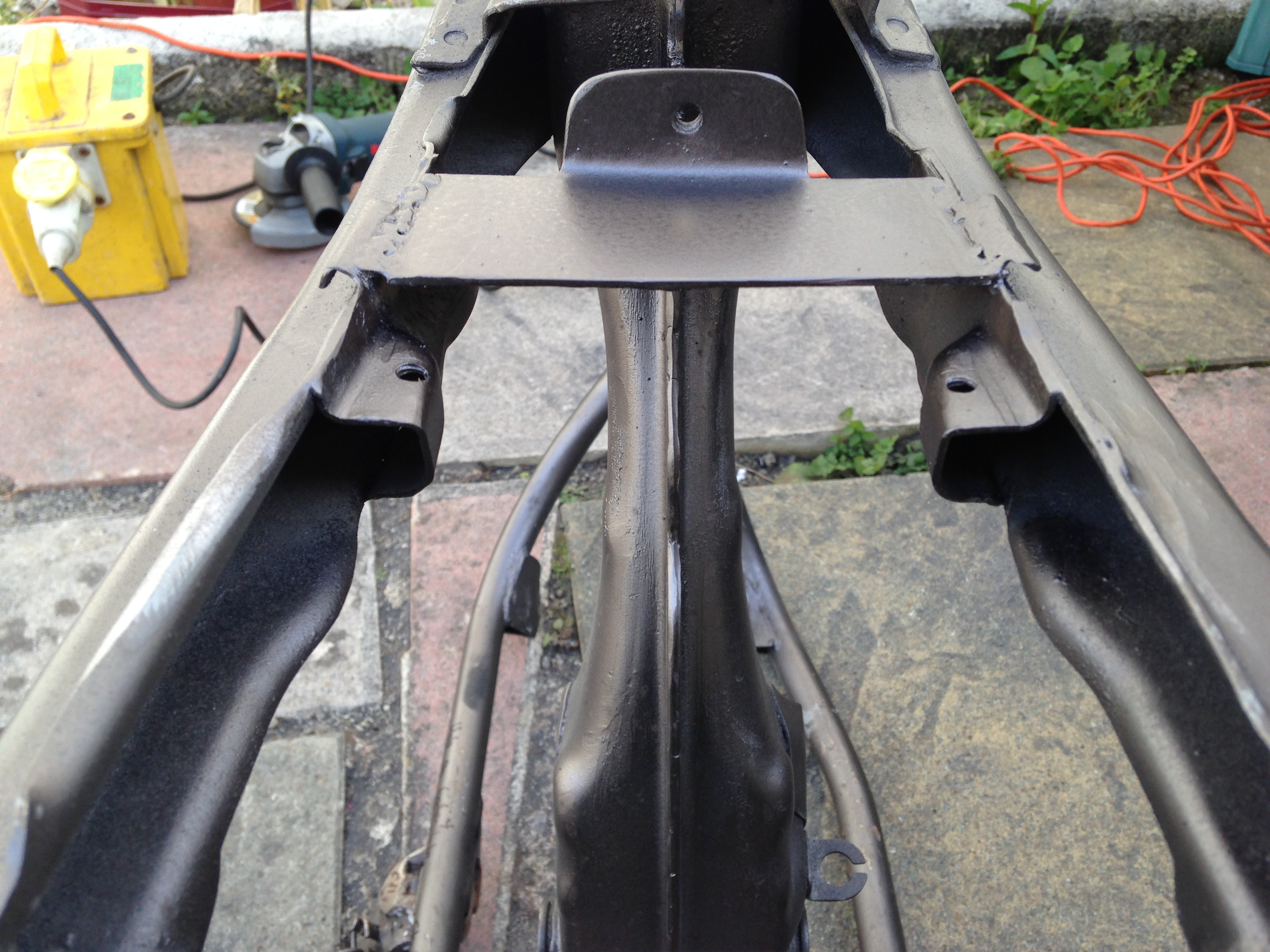

Welded the second rear set mount in place today. I still need to do a bit of blending in to the frame tubes. I'm waiting on a die grinder to clean out inside the cutout sections as hand-filing was taking ages.

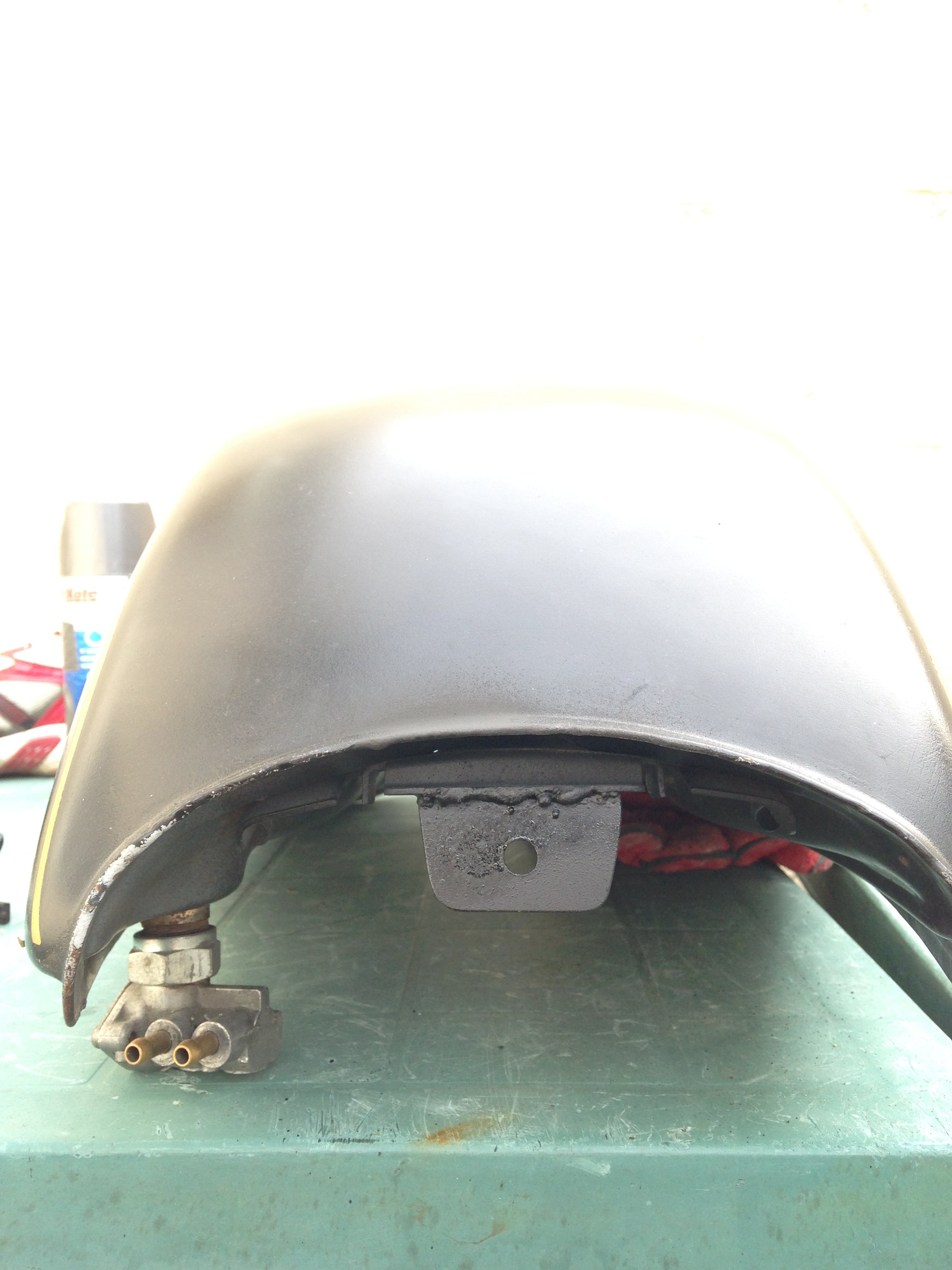

I also started work on the rear tank mount. It's replacing the original plate I had welded in place which secured the front of the seat, so it will secure both items now. I just need to weld a 90 degree plate on to the existing tank mount on the tank. It will then sit in front of the frame plate, and then be secured with the nut. Again, as I only had access to an angle grinder, the cuts and shaping are all a bit rough, so i'm going to tidy it up at a later date with hand files once I know it works as expected.

Got the plate welded in place for the tank mount, and welded the mount onto the tank itself. The welds aren't the tidiest but I'll clean them up later.
