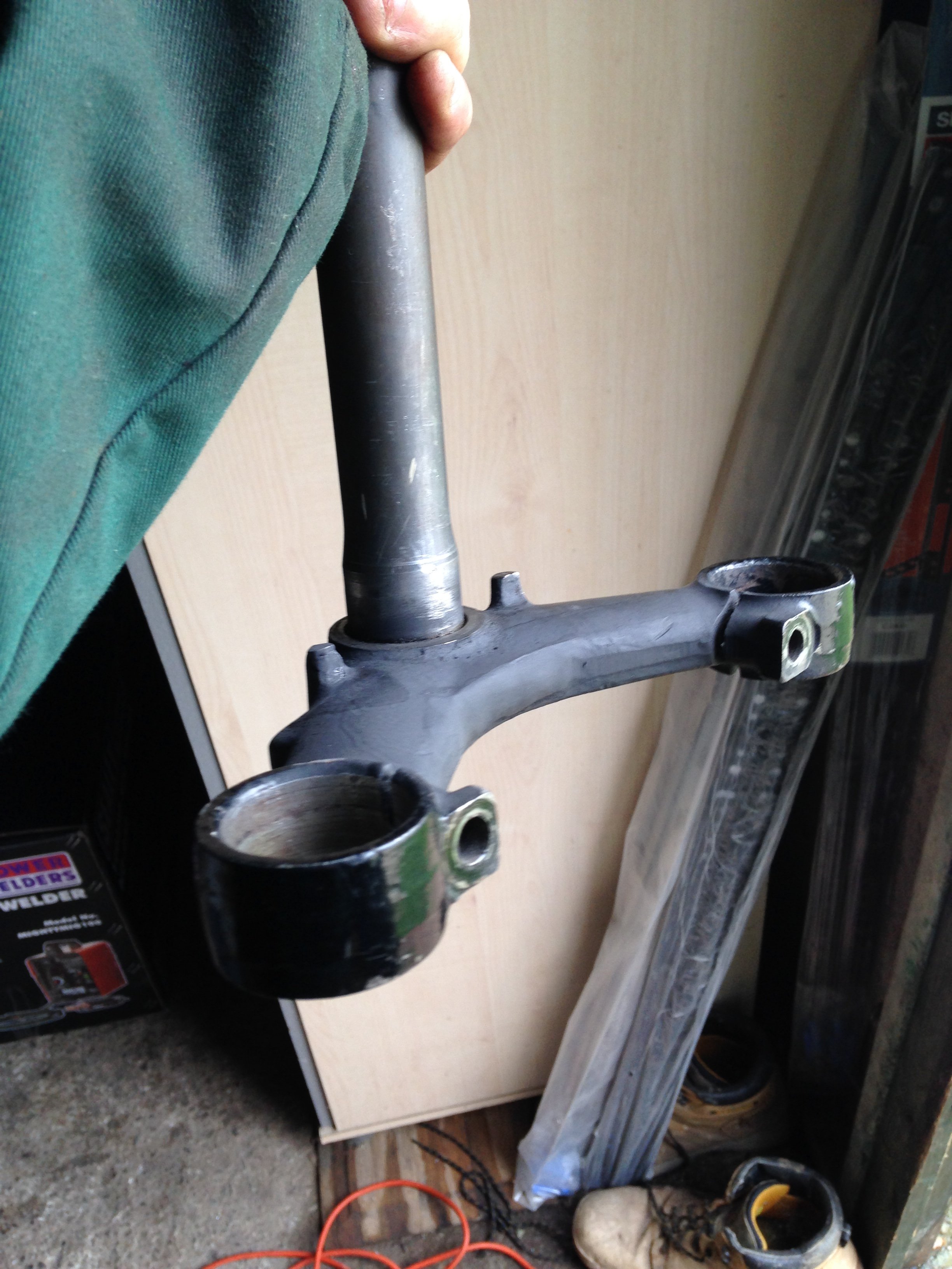

Managed to finish off my numberplate bracket today, and removed the steering lock from the lower triple. I should get access to the die grinder tomorrow so I can finish cleaning them up ready for powder.

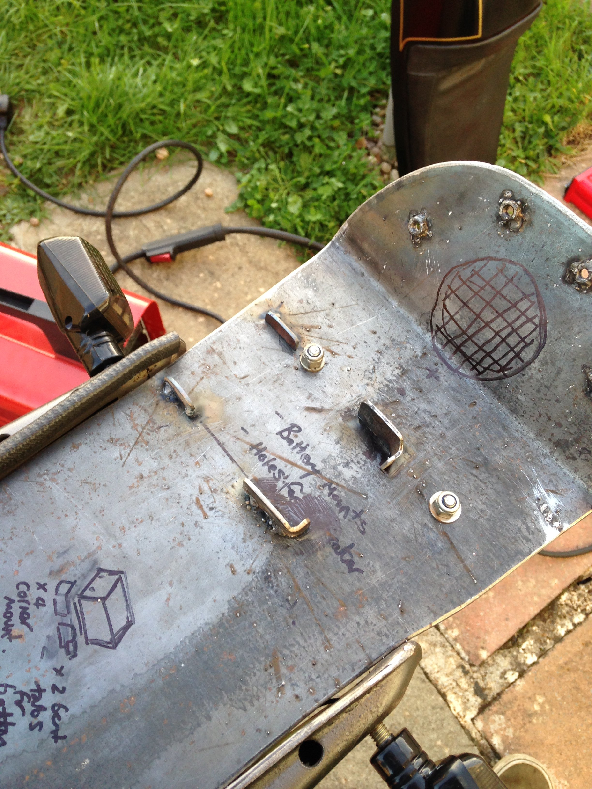

Got the majority of the work for the seat pan completed today. Only thing left is to cut the hole for the tail light.
Got the steel pan bent into shape, and welded on 4 nuts for the rear of the seat to mount to. I covered the edges of the pan and the seat rails with some rubber trim. The base of the seat was resting on the rear subframe so the rubber trim is there to stop direct fibreglass to steel contact.
Drilled some holes in the pan for the numberplate mount, and welded in a few brackets to hold the battery. I still need to add one on either side so I can send a strap over to hold it down. Hopefully I can get access to the plasma cutter tomorrow so I can get the tail light in, and then the seat pan will be welded in place.
Then its off to powder! ;D

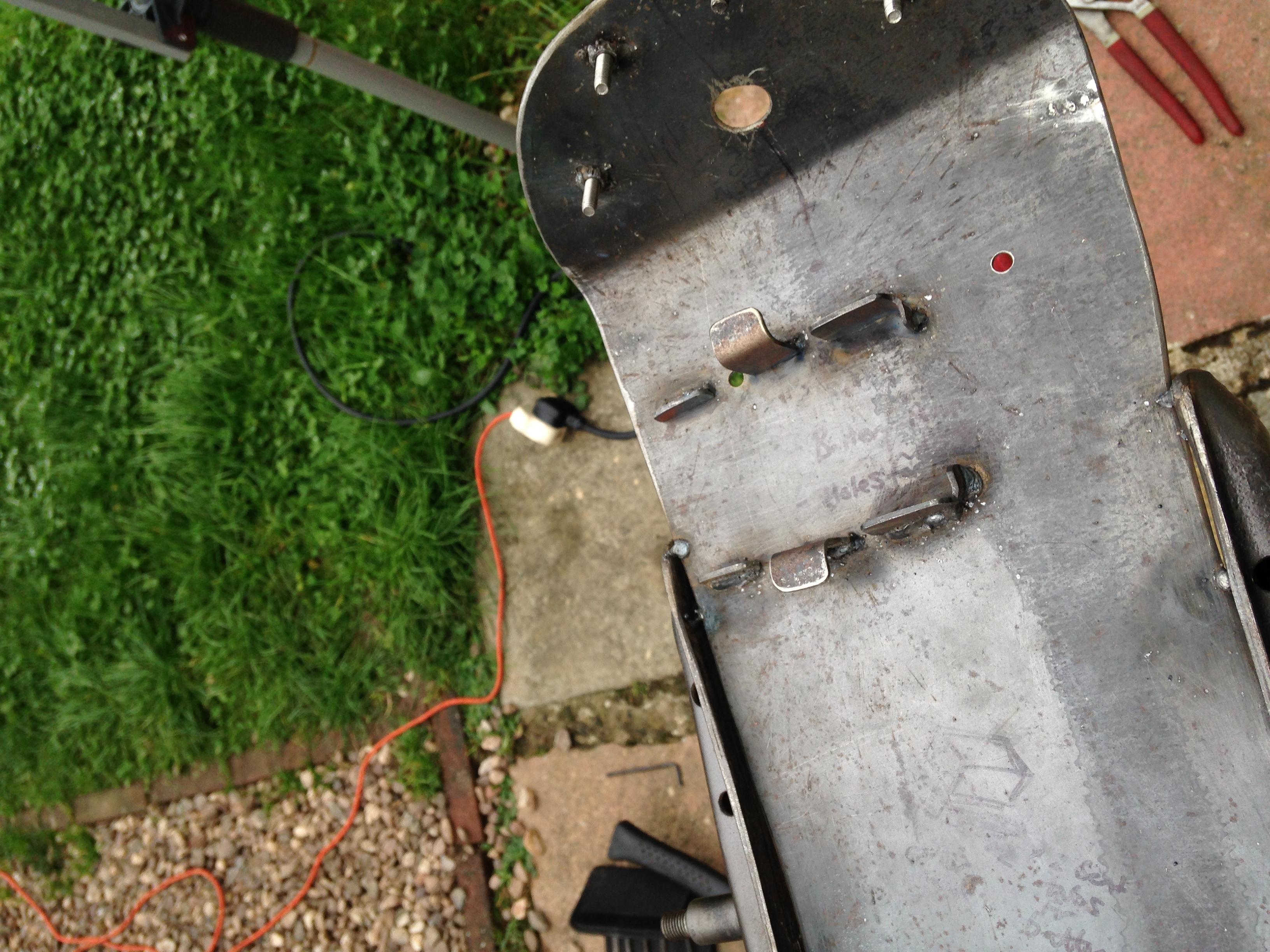

Seat pan is welded in place, and 2 extra tabs for a battery strap are welded in. The only thing left is to open up the hole so the tail light fits (along with the a grommet), and then its off to the powder coaters.
None of the welds or tabs are the neatest, but seeing as they wont be seen I couldn't care less.
