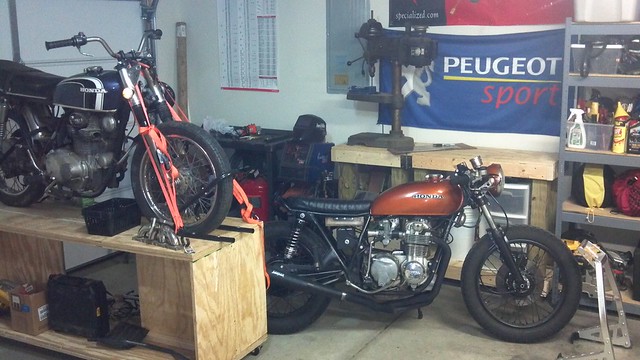

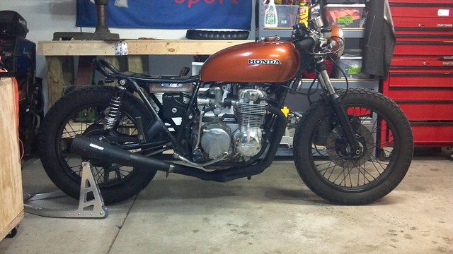

Here are some pics from Kiley's that I snapped.
Rear shot, you can see the new tail light and plate location.
I consider this phase 1. Over the winter, I plan to install rearsets, redo the front suspension, redo the battery box and maybe some other odds and ends as well as pick up a new project. Right now I am just riding it and enjoying it while the weather is still decent.
