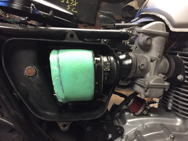

I made a couple of paper templates and cut/glued some UNI foam to make a filter element. I used hot glue to hold everything together, and cut the pieces a bit small so it would be a snug fit.

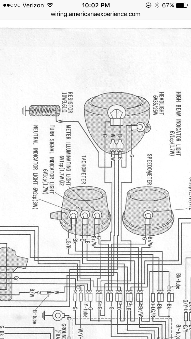

I cleaned up the stock bucket and I'm going to use it for now until I'm ready to upgrade. Can someone explain the purpose of the 10w 3.61 ohm resistor in the wiring diagram?
The resistor is to compensate for the difference between high and low beam headlight power. The lighting coil puts out 35 watts which matches the 35W high beam draw. The low beam filament is only 25W so the resistor in the low beam circuit burns off the excess 10 watts. Without the resistor the low beam filament gets incinerated quickly.The stock resistors are scarce and hard to come by. Not sure where to find a generic that will handle the power and heat.
-Bill
-Bill
Thanks for the info Bill. I figured it was something of the sort. I believe I still have the stock resistor, I wonder if there is any way to ensure it is working properly.
Do you recall where and how the resistor is mounted? It was so long ago that I disassembles the headlight bucket. I noticed from the parts fiche there is a metal bracket used to mount the resistor as well.

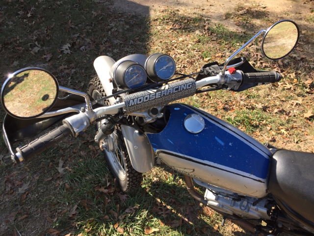

Been a while since I've made any real progress but here's a small update. I cleaned up the gauges, replaced a couple bulbs and reinstalled them. Put on a set of KTM brush guards I grabbed at Barber for a few bucks and some repop stock mirrors.

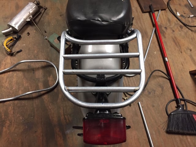

Started to bend up the luggage rack. I like the initial shape. I'll bend up a cleaner version, add some cross members and weld some stays on it so it's removable as well.
