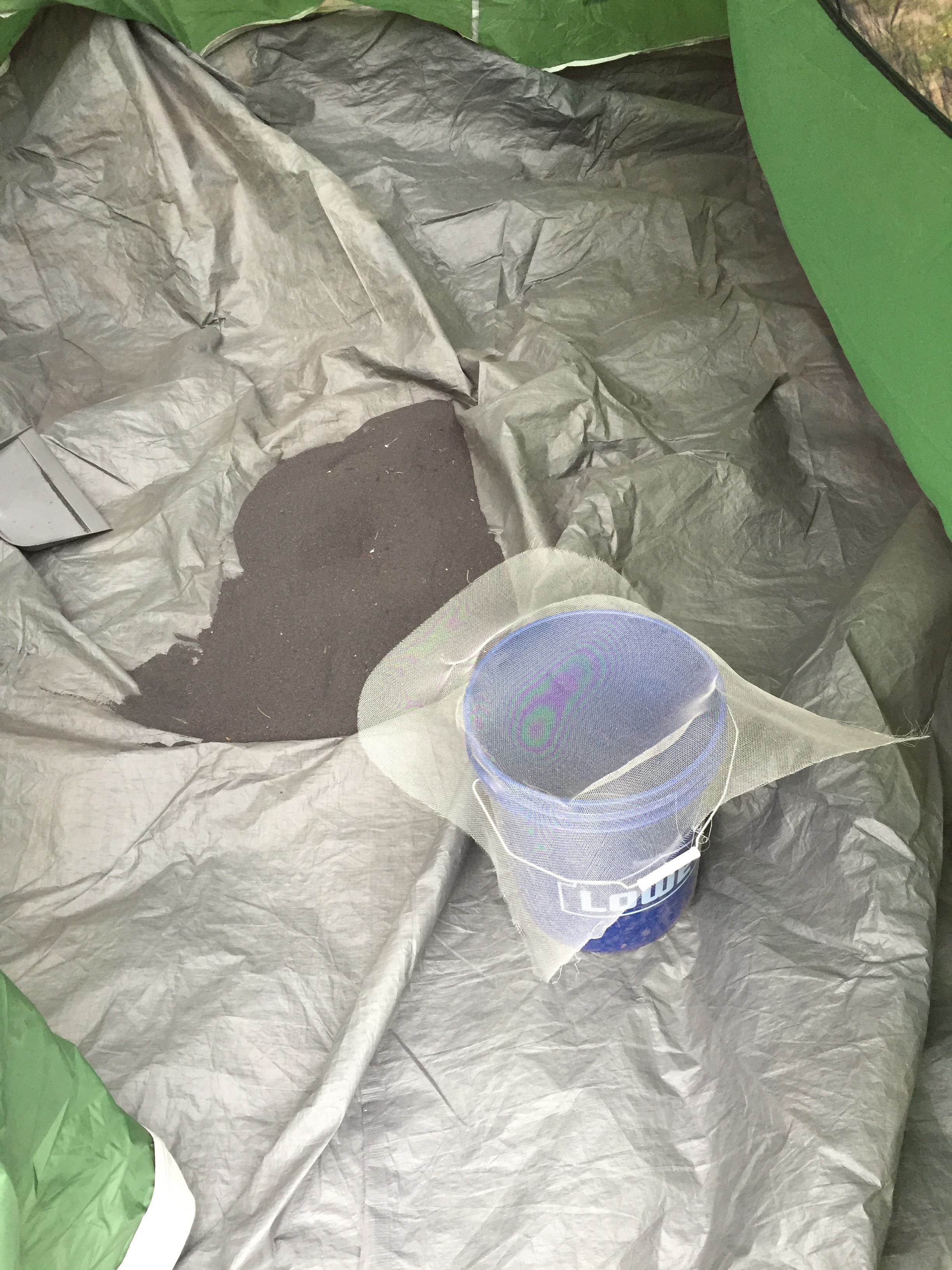

Pitched a tent in the backyard and started some blasting. I called/went over to the sandblasting shop and no sign of the dude, SO i said f' it and grabbed the cheap 50 lb hopper/blasting gun setup from harbor freight. http://www.harborfreight.com/portable-abrasive-blaster-kit-37025.html
After about 3 hours of use, I will say this thing works pretty damn well. I ended up cutting the hose from 10-12ft down to about 6' to avoid kinks. The hose is not that great quality so it can easily kink and screw up your media flow. I had the parts on the ground, and I put the hopper up on my welding table at about ~3 feet. Pretty necessary to have the hopper elevated since its siphon fed and not pressurized. Bought a 50 lb bag of aluminum oxide, and I've been able to save about 95+% of the media using the tent method.
Our compressor runs 6.8 CFM at 60 PSI, and I was running the gun at ~80, which seemed to be the best balance between air flow and blasting power.. It seemed to keep up alright, but after a few minutes I would take a break to let my goggles unfog and the air build up. Shake all the shit to the middle of the tent, screen and repeat. Had to run out too many times before I got started, so I only got the swinger and about 50% of the frame done before dark hit. I'll have the complete frame blasted and painted by tomorrow. Not bad turnaround time!
