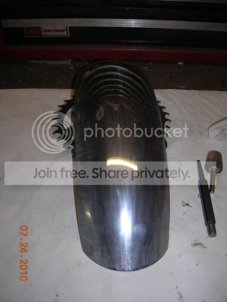

The four mounting holes for the rear sprocket were too large on the Parts Unlimited sprocket I ordered. No way it would have worked, so last night I made some bushings on the lathe. I have one of the four pressed in. I started cutting down the front fender I made on the english wheel a couple of months ago. I narrowed it up and need to get back to my friend with the wheel to fine tune the radius. Off work till Monday days, so hopefully get that done this weekend. I'll get some pictures of it when I have access to the wheel.
Its been a good Saturday so far. I lightened up the stock ignition switch bracket with holes and then used the counter sink bit. I made it over to my friend with the english wheel and brought my chassis with me. I finished the front fender. Nice to have the bike there to get the correct radius. And last night, I finished pressing in the bushings I made for the rear sprocket holes. Hope to bite the bullet and drill the holes in the fender and get it mounted yet today.
lbums/uu16/stik70/englishwheel002.jpg[/IMG]
Last night, I sanded out the fender and polished it on the buffing wheel. It looks pretty good. When I finished shaping it on the english wheel, it became wider again from stretching the aluminum. I may try narrowing it again with band saw and not putting it back on the english wheel. I'm liking how it looks though. This picture is the fender sitting on the tire with no fender bracket.

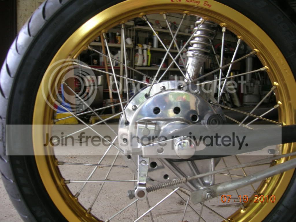

stik70 said:
I love the use of the mesh behind the holes. I planned on doing something similar to mine when the time came. Mind if I ask how you're keeping the mesh on the hub? Tack weld maybe? Thanks.
Hey, I ended up using JB Weld. I cut the screen out to shape, put the JB down, then the screen, then JB on top of the screen which contacted through the screen to the first layer of JB. I did one at a time and weighted it to keep it down. Let set about a half a day per screen. Hope this helps. It looks like its really bonded well and would try it on the next one.

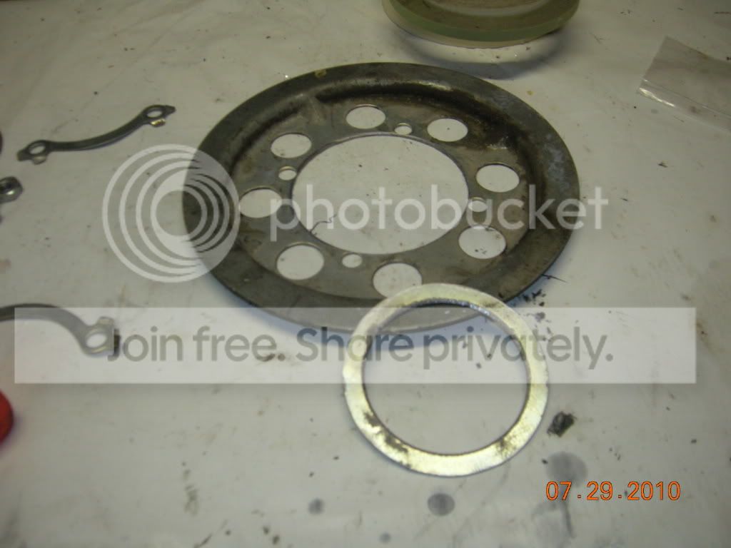

I cut the center out of the sprocket guard on the lathe. Don't have to look at the anymore. I got the front fender cut down yesterday and hope to actually get it mounted this weekend ( I've said that before). And I found my notes for ordering exhaust tubing, collector, and bends out of Cone Engineering, which I hope to do today.
