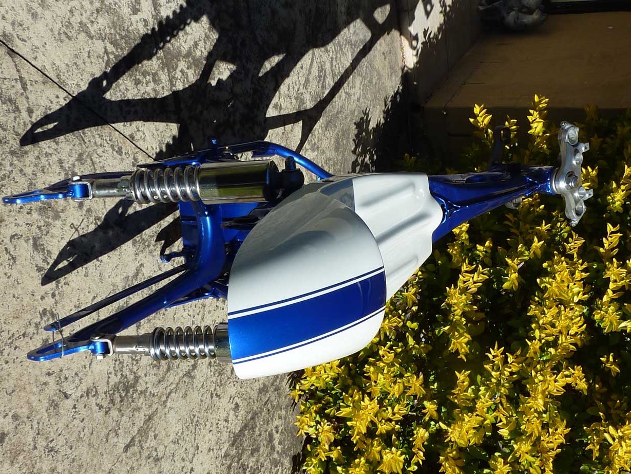

I recieved the frame back from getting painted and it looks really good. Still waiting for the tank, seat and other bits to get done. In the meantime ive been working on the engine, and had quite a bit of work that needed to be done.The valve seats where in very bad shape so i got them reseated. Cleaned the entire engine. Got new piston rings, ordered new gaskets, oil seals and some new stainless bolts that have yet to arrive. I took advantage while the engine is apart and painted the head black with high temp paint. Also found out that the vlave inlets have been ported and polished at some point, so thats a nice bonus ;D

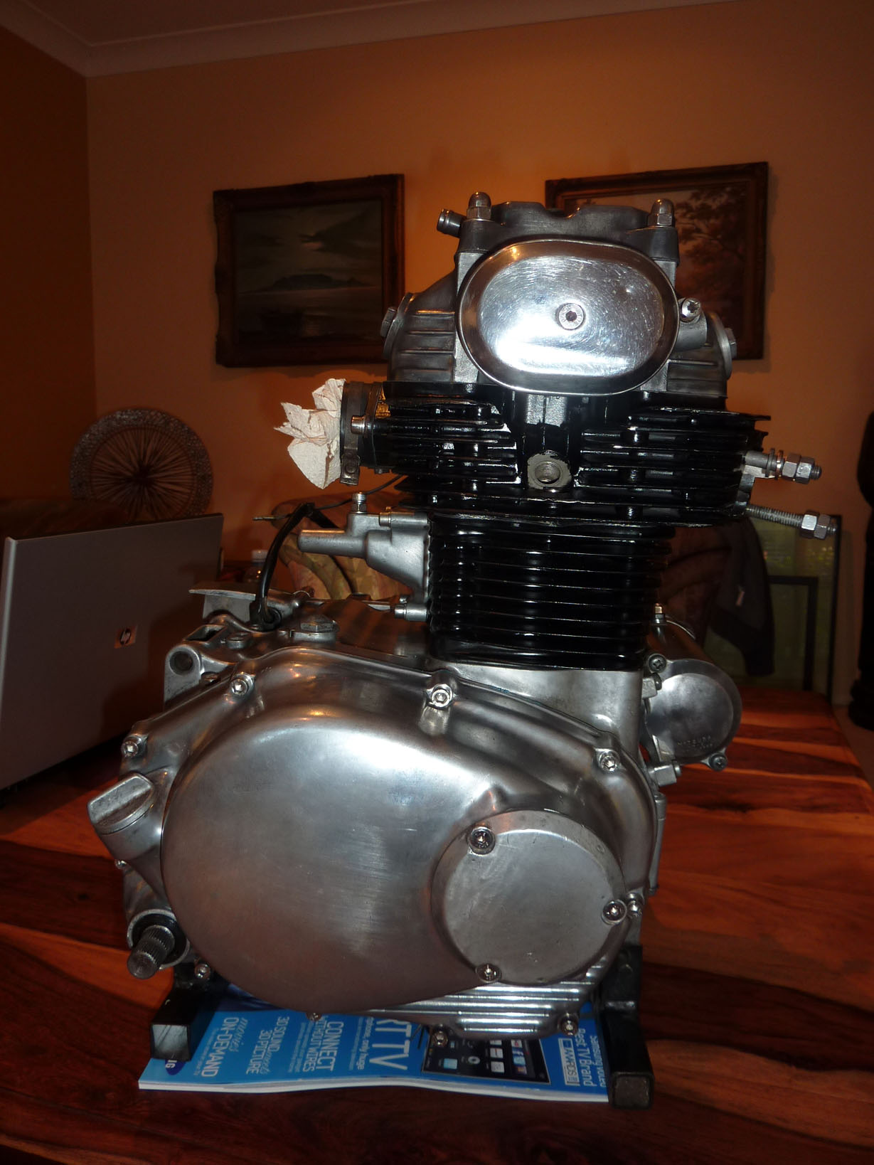

Put the engine back together this week with the aid of another enthusiast to help with the timing and torquing the bolts correctly. And i must say it came out better than expected. ;D Had a bit of trouble with the kickstart mechanism as it prevented the engine from turning backwards, and after re-openning the bottom half of the engine case found that the little metal bracket that comes on after the springs was bent open preventing the kickstart gear from disengageing.

So last minute i decided against the silver and went with a pearl white, and i think it was a good decision. Still just waiting for the tank and fork covers.

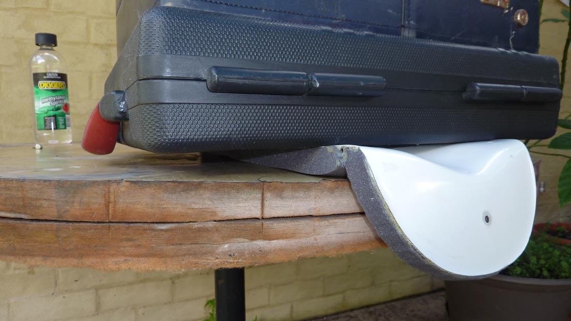

In the meantime ive been working on upholstering my seat. First i grinded the edges off the seat for the look i want. I used a steel grade epoxy to keep the flange nuts in place. I decided the nuts would be better on the top part rather than the bolts because it would be easier to get the vinyl wrapped underneath. Ive already covered the seat with polyurethane foam, and just waiting for the glue to dry.
