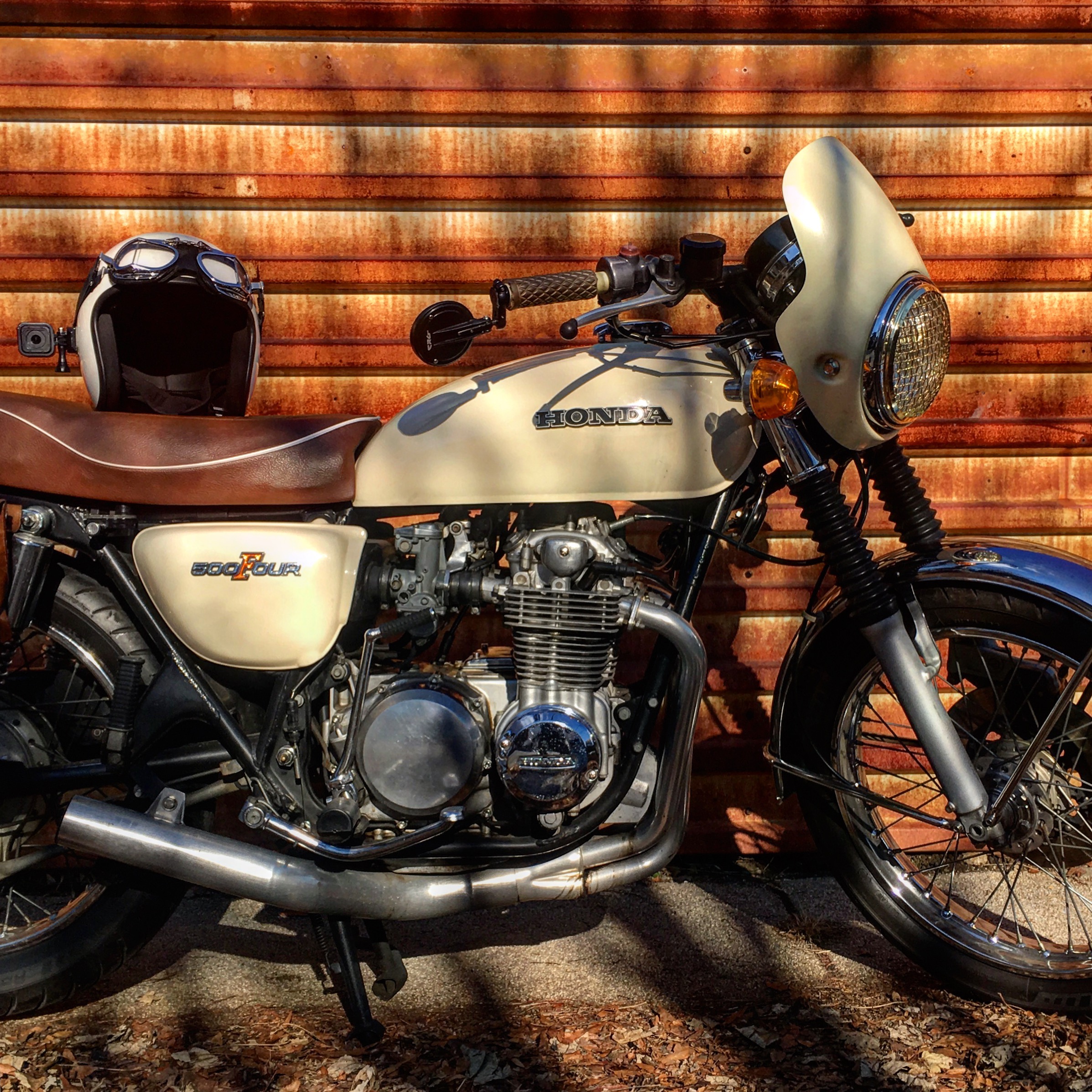

Nice thread and nice build. Ive been searching for a KZ650 but had no luck. So Im picking this up tomorrow, a 77 KZ750
In re the fairing, below is my 1973 CB500f. I found this fairing on EBAY. The fairing maker is pretty popular and sells these, made to paint. My bike just happened to match. I like your fairing but I think a fairing of the same color as your bike would make it pop more. And yeah I know, oil is leaking onto my exhaust on the CB. Its since been corrected. The Oil filter was loose

Re: 79 Kawasaki KZ650 - Need Paint Input
Thanks for the compliments on the thread. I totally agree with you. I've been researching painters and I think your right, need to get the front fairing painted with the rest of the bike. Just debating if I do it this season or at the end. Ive been riding a lot and rather be riding then waiting for paint to dry.
