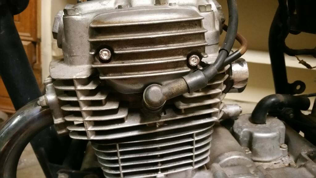

So i put the hoses on the right nipples
Hooked up the battery and attempted to start the damn thing...
Nothing.
Held the spark plugs against engine case. On the left i saw nothing. Tried to test the right side and the starter motor wouldn't turn over smoke coming out of the chain cover on left side. There's a small set if wires going to the "stator"? Afraid to do anything else now.
Sent from my SM-N915V using Tapatalk
