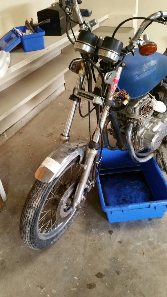

Woot! Went to see a guy about a kz400 but left with a 305 lol. Picked it up for a $160. No carbs, leaking oil, with a title on the way (I hope). I'll post more pics when I get home. Wanting a sweet bobber build, but we'll see.

it looks pretty overwhelming at this point... no carbs, rust in tank... should I try to get it running THEN tear down or what?
Sent from my SM-N915V using Tapatalk
OK so I guess what I need to do is read my manual and find out what I'm missing. .. order parts... in the mean time take off the wiring harness, lights, tach etc.
I would highly recommend getting it running before you tear t apart. No point in making something look all pretty if it doesn't move. If you're pulling the wiring harness, I'd leave the essentials (coils, ignition, kill switch etc) so you can get it running before you rip the whole harness out.
Bring tank to a radiator shop and have them give it an acid bath to clean out the rust, guys here have had good success with that method.

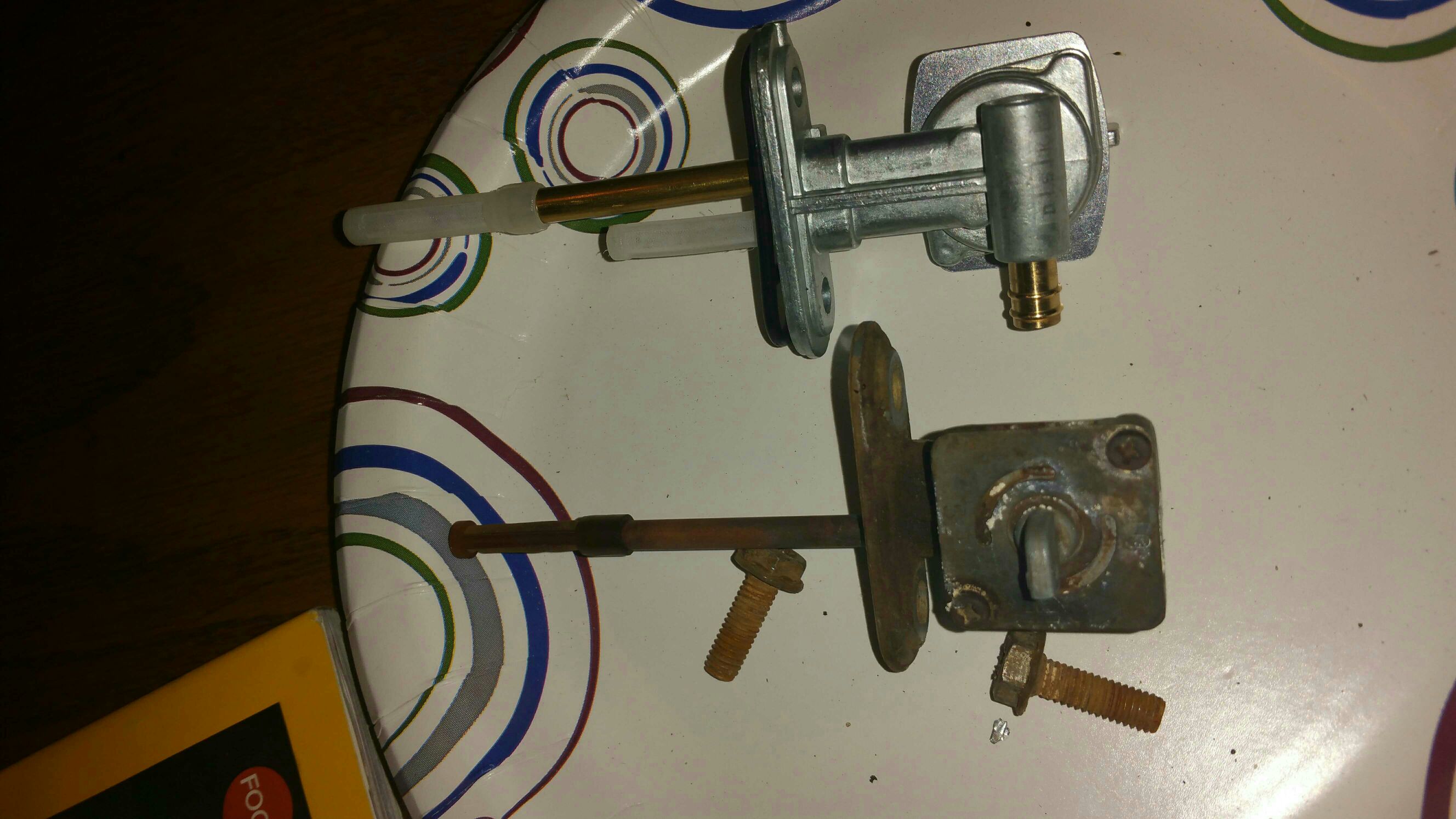

Rusty ass petcock.

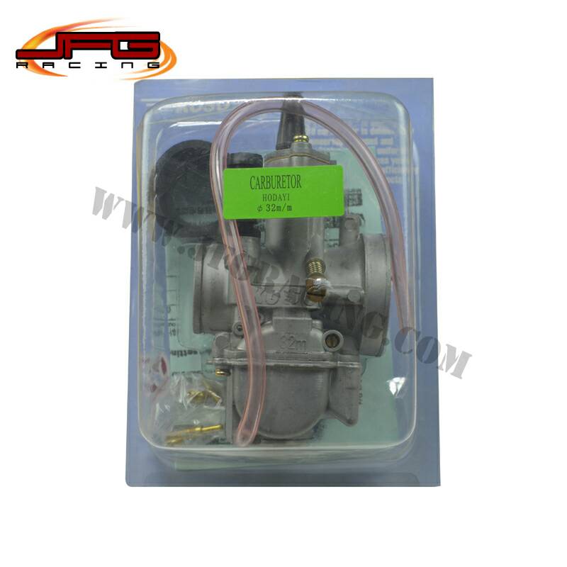

Like i mentioned in an earlier post, I'm having no luck with finding stock carbs for this thing. Anybody know of a good thread about bolting two carbs up with two throttle cables or any other option I'm overlooking? I just recently took the leap of ordering off aliexpress for cheap Chinese shit. Might snag two 32mm koso carbs for $45...

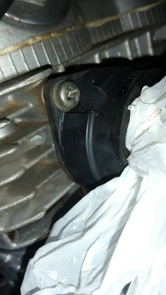

Can't really get the impact driver AND hammer in there to get the carb boot bolts out. Been spraying penetrating oil every day so far but no luck. Maybe grab a disc for my dremel and cutting a slot in it.

VICTORY! Got one of the bolts off the carb boot!

I've heard some pretty bad things about those Chinese Mikuni knockoffs. One guy even told a story of gas eating through the bottom of the bowl. However, even if they work well for you I think that 32mm will be way too big for your 305 - it will be tough to get it tuned. I'm running Mikuni VM30s on my KZ400 and they perform fine but I'm told that VM28s would be sized better for it. Hopefully they work out for you though.
Yeah I'm a little concerned. I just wanted the cheapest just to see if this thing runs. The stock on the 305 are 32 keihins, but I know that doesn't really equate since these are flat slides. Maybe if she starts up and it turns into a promising project I'll drop some $$$ on nice carbs. Is there a guide anywhere about selecting carb sizes based on displacement?

Got some parts in! New petcoc!

Alright so they arrived! Only came with one other set of "jets", they have no markings so I'm unsure of the sizes or where I could get more of them :/ in the meantime I'll be enjoying the fourth , researching these carbs, possibly getting my grandfather to help fab some sort of manifold, and ordering a 2-1 throttle cable!

DesmoBro said:
Following i just grabbed one not too long ago where did you get the petcocks?
2000-2011 YAMAHA TTR TT-R 90 125 225 230 250 FUEL GAS PETCOCK SWITCH VALVE https://www.amazon.com/dp/B00KLKL6ES/ref=cm_sw_r_awd_r7ILvbD145XFG
