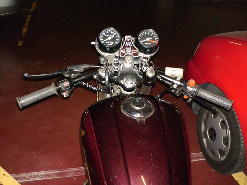

Bought this '83Honda CM400!

I don't have much tools, money or even a garage, just a parking space. Total rebuild is out of the question.
taking in account that this bike is one of the ugliest I have owned it won't be hard to get it to look nicer.

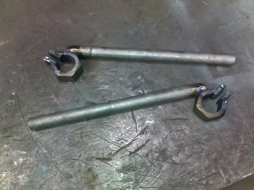

I hope your welding skills are pretty darn good. Losing one or both of your handlbars at the ton isn't something I'd like to experience!
Yep, they look really scary
You don't have enough weld area in my opinion?
Have you tried to break/bend them?
Using even low tensile nuts will give a very brittle weld (or area next to weld)
The welding is fine, shit design though :) already ordered new clipons. will probably arrive this week.

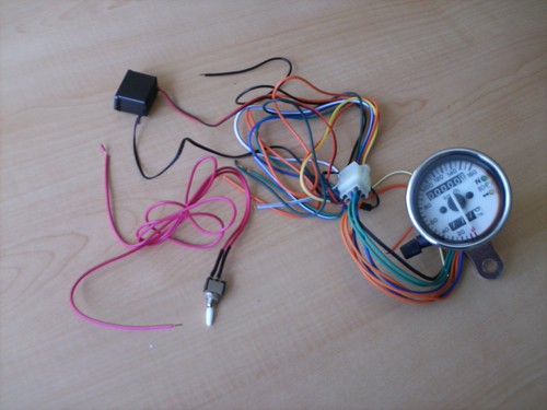

New speedo en choque mount.

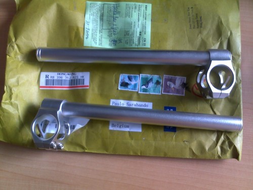

New clipons.

Also, I would suggest replacing the hardware that come with those clip ons with something a little stronger. I broke a screw and decided it would be wise to replace everything.
What do you mean? replacing all the bolts?
sarabando said:
Still waiting on a tail light to scrap all of the back side.
Yes. Chinese fasteners are notorious for being weak.
