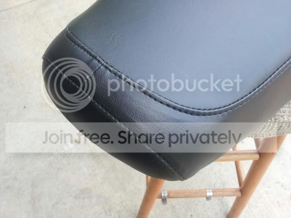

I also dropped off the seat at my favorite local guy. I was just going to leave it with him while I worked on the project, but he called two hours later and told me it was done! Stock pattern in heavy duty, marine grade vinyl.
