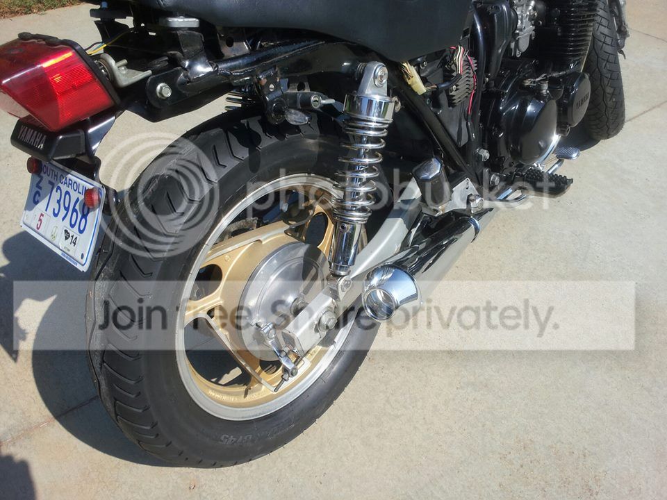

I finished up the muffler installation today. I had to modify the hanger bracket slightly.
Now they're on. It's a nice, tight fit. The factory trim parts on the side cover up the header/muffler joint and make it look really nice. They clear the swingarm nicely, etc. Really happy with the look and the sound.
