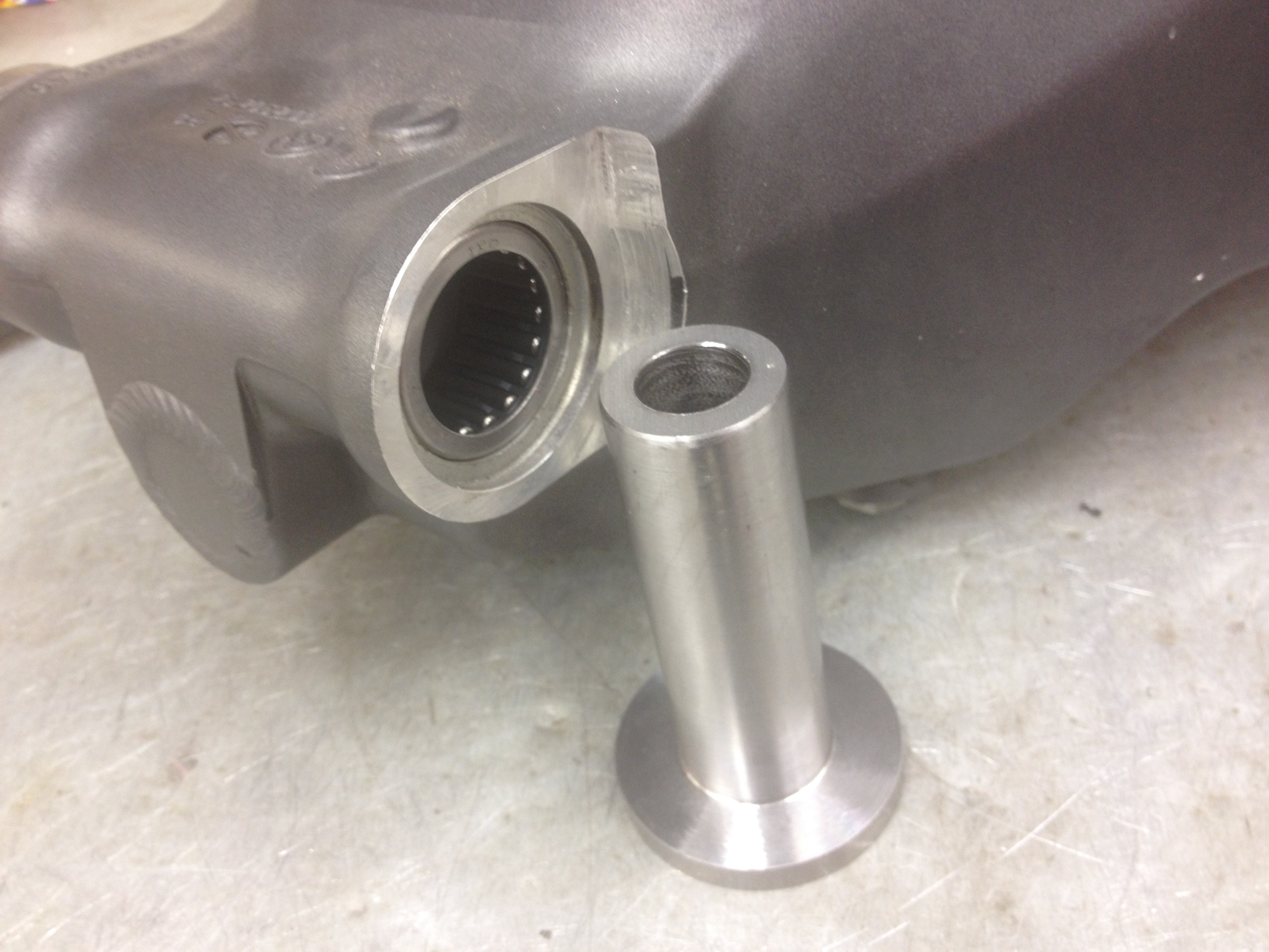

So I will hope to get back to the shop Friday night, machine these down to take the bolt, cut them down to size and correct the end float and hopefuly on the weekend, start on the cage to hold it together, then back to the frame we go
