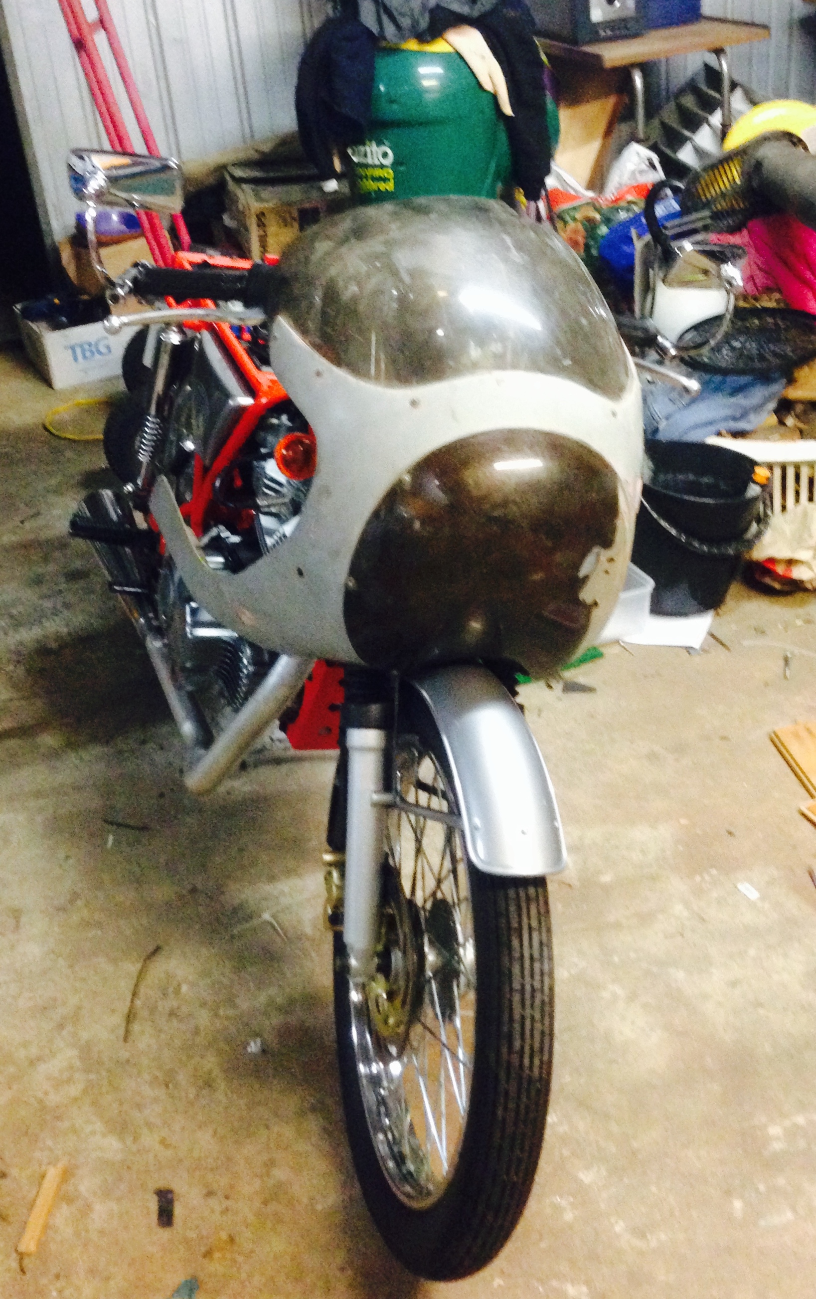

Hi guys!
It's time to make an exciting announcement I've been waiting for confirmation about. On February 28th this year we will be taking the Ace SALT LAKE RACING!
We will be heading over to Lake Gairdner in South Australia to compete in the 50cc modified production gasoline category at the DLRA's Speed Week 2014.
As a result we have been busily prepping the bike for racing. The new seat is almost complete, handlebars are all set up now with a substantially lower bar height, headlight and indicators are gone, new jets in the carby and the exhaust has been opened up.
For those wondering where the main restriction is in the 50cc exhaust, the easiest way to get to it is to cut the seam that is overlapped by the exhaust mounting bracket. you will find the main restrictor hanging in there. I have left the baffles in there to give a little bit of backpressure, but the corrogated restrictor had to go.
would love to see photos and on board video of the run if you can swing it :D
sounds like its going to be a blast.
