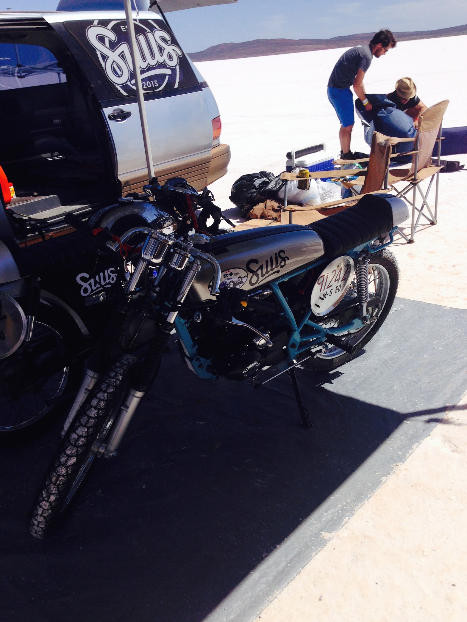

moving up to the start line on yamaha y1 (with ace seat). record making run
