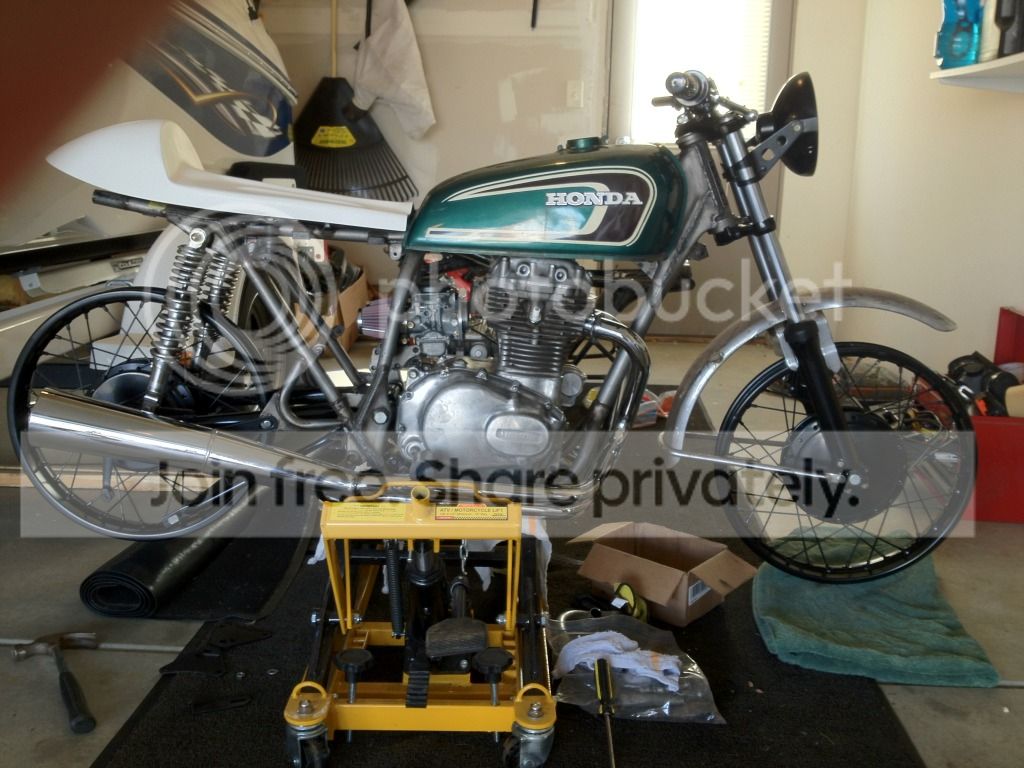

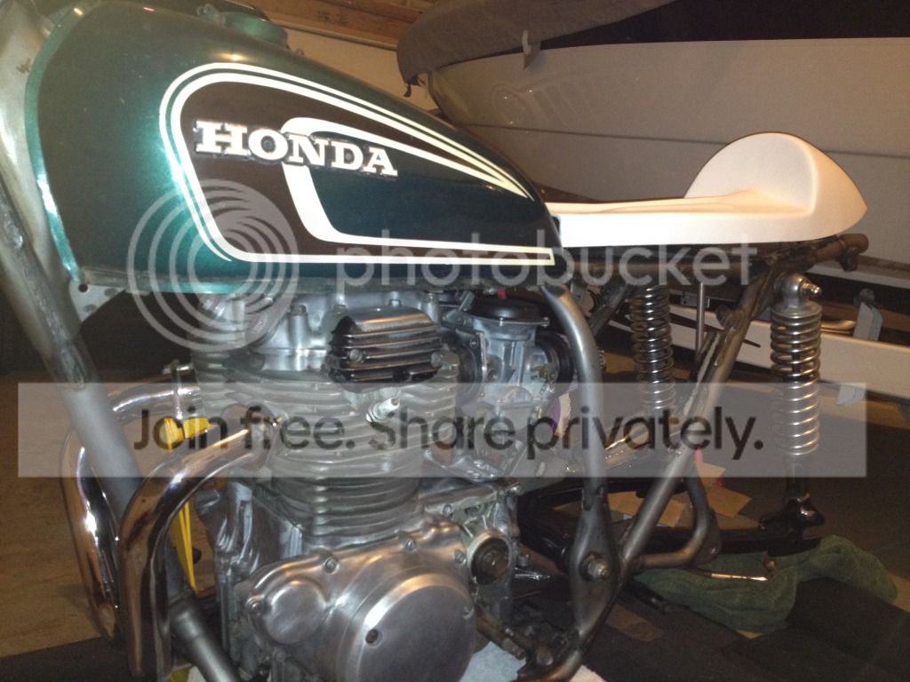

So I picked up a CB360 on craigslist locally over the winter and started a build. Not sure why this model is so popular these days. Seems like everyone is building one.
Unfortunately I did not take any real 'before' pics, but it was pretty rusty and missing lots of parts. It had a CL360 tank on it. My plan was to originally build a tracker style, but I found this really nice seat on ebay and decided to go with a cafe build instead.
Parts purchased so far:
black drag bar
new clutch and brake perches from DCC (getting rid of all stock hand controls)
CM400 shocks
duro tires front and rear
CL360 drum brake setup for front in place of disc setup from CB (I know it sounds crazy but I wanted simplicity)
MAC 2-into-1 pipe
all new seals, bearings and gaskets for bike
new top triple clamp (original was cracked)
K&N air filter PODs
new/used headlight (mine was broken)
new clutch lever spindle (mine was stripped)
new gauge faces on order
Here is my plan:
finish stripping engine and paint it black.
finish stripping frame and paint it black.
use the MAC 2-into-1 pipe as seen in pics
strip and re-paint the CB360 tank
cut off frame tabs and get the seat pan to sit down on the frame rails.
mount and balance the duro tires on my black powder coated wheels.
decided to go with drag bars (two other bikes I own have low slung clip-ons, so I want to save my back on this build).
will use stock front foot rests instead of rearsets (see comment above)
Some thanks need to go out to crazypj for rebuilding my carbs.
More to follow soon, I hope.
For those of you who are curious- the second to last picture shows my CB200 engine and spare CB200 frame.

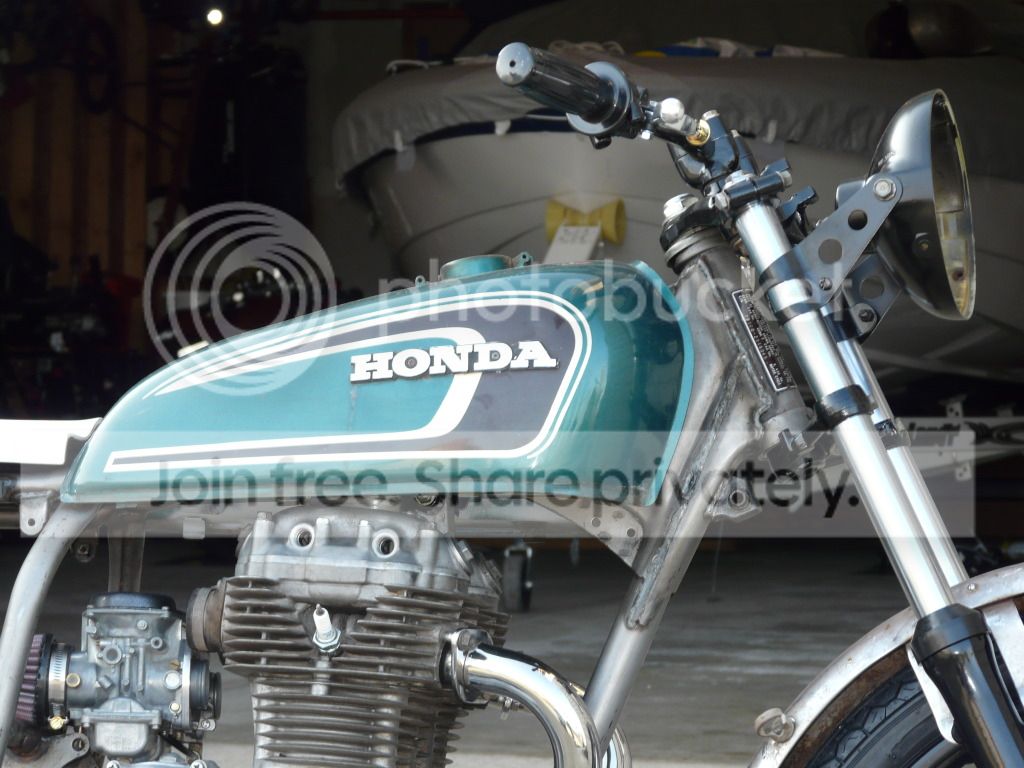

some more pictures.
I mocked up the wheels and plan on marking and cutting the front fender down. I like the look of the black drag bars and the new, simplified hand controls and perches. I know the headlight is too high- I just threw it on there quickly and didn't even mess with height on it. Pipes are Mac 2-into-1.
I am a little bummed about this tank- picked it up on ebay and the guy said there was one dent on top. Unfortunately it has about 7 dents all over. I wanted to polish or powder coat this tank, but it looks like I won't be able to do that with all the dents. I might keep looking for a dent free cb360 tank in the meantime. Anyone have any thoughts about dealing with dents and still being able to polish the tank and leave bare metal?

Re: I know its hard to believe- but another CB360 build
Looking good, keep at it. dont cut that front fender too short right off the bat. just take off a couple inches and take a look at it on the bike, then keep going inch at a time. I cut mine down to the nubs and didnt like it so short, I tried for a year to get used to it. never did grow on me. I got another from ebay a few weeks ago and tried again. its a couple inches longer and I like the look a whole lot better. Also if you have trouble w carbs crazypj is the man. I fought my carbs for a long time. crazypj helped me make it right. runs amazing now.
pj actually rebuilt mine for me. We worked out a trade for some pipes I had for his services. Thanks for the advice.

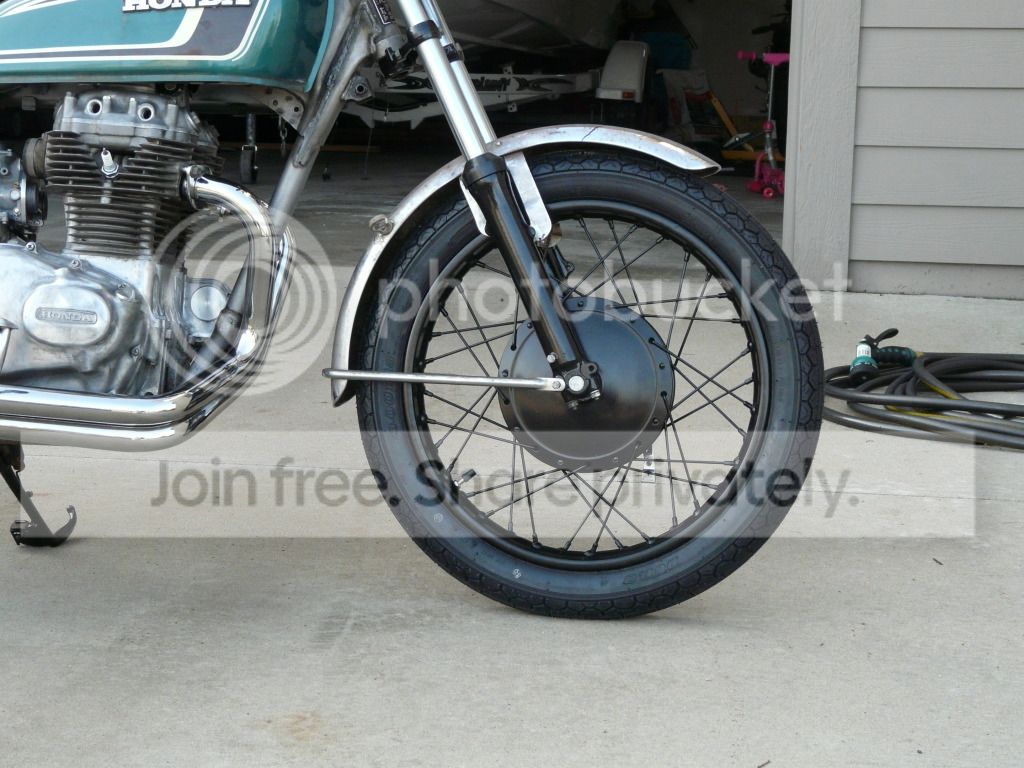

Re: Another CB360 build- tires mounted.
Got my Duro tires mounted and the wheels back from powder.
I just wanted to get an overall feel for look of bike.
Headlight needs to be lowered.
seat pan needs to be shortened.
frame needs to be de-tabbed and modified to fit seat pan.
Not sure what I am going to do about tank. I really wanted a polished CB360 bare metal tank but i cannot seem to find one without dents. I am on my third CB360 tank. I keep buying them on ebay from people who claim no dents, and they are full of dents when I get them. Frustrating!
I have a dent-free CL360 tank I could use but I don't really like that tank. By the way, that's my CB200 in the background. Check out the link to that build thread at bottom of my posts.
forks and rims look great did you powder coat them ?
forks painted with epoxy appliance paint .
Wheels, hubs, spokes, and drums all powder coated matte black.
