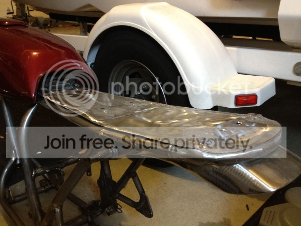

got the seat pan finished too:
Used 14 gauge steel from speedymetals.com
I basically cut to shape using my cutoff wheel, pounded in the fender bump in back, and then welded some weld-nuts in place so that I can bolt it on from underneath. The seat is going to be distressed black leather- super thin and flat. Sent it off to Ginger at
www.newchurchmoto.com
she does the work for glass from the past. Can't wait to see the finished seat.
Still trying to decide on what to do with frame. I was thinking about leaving bare metal and simply putting a clear coat on it, but now I am leaning more towards black (either powder coat or appliance epoxy spray can to save some bucks)
The fender you can see is the stock OEM rear fender that I cut down significantly and then had welded on to frame for a permanent solution. The tank is a really nice CJ360 tank that I found on ebay. Not a single scratch or dent on it. Paint is faded though. I plan on stripping it down and leaving it polished bare metal.
