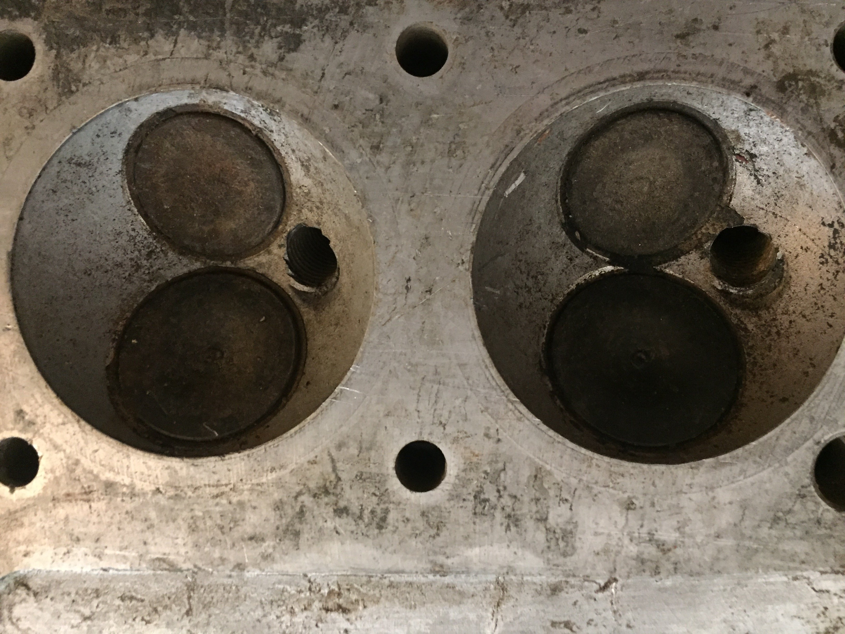

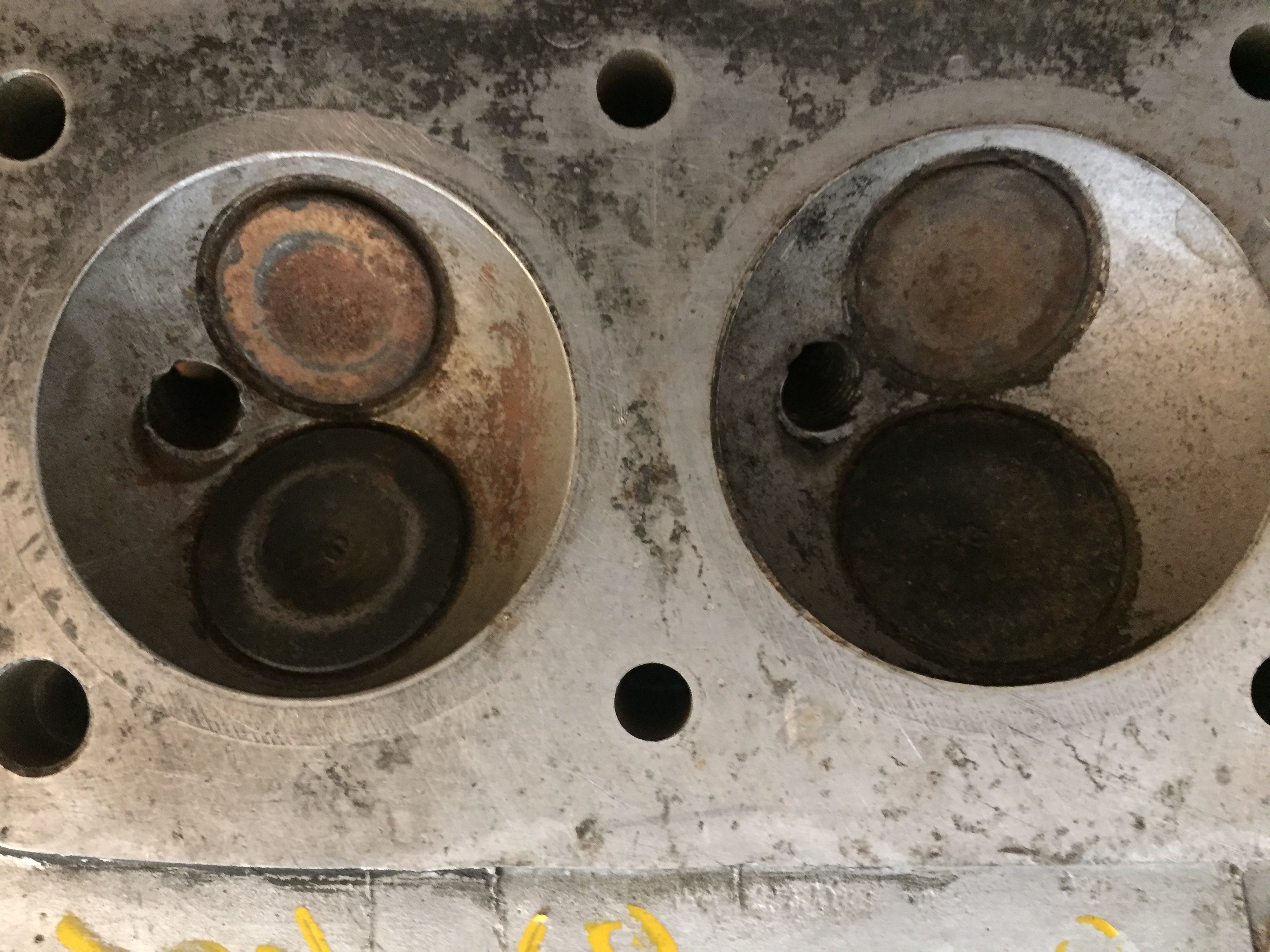

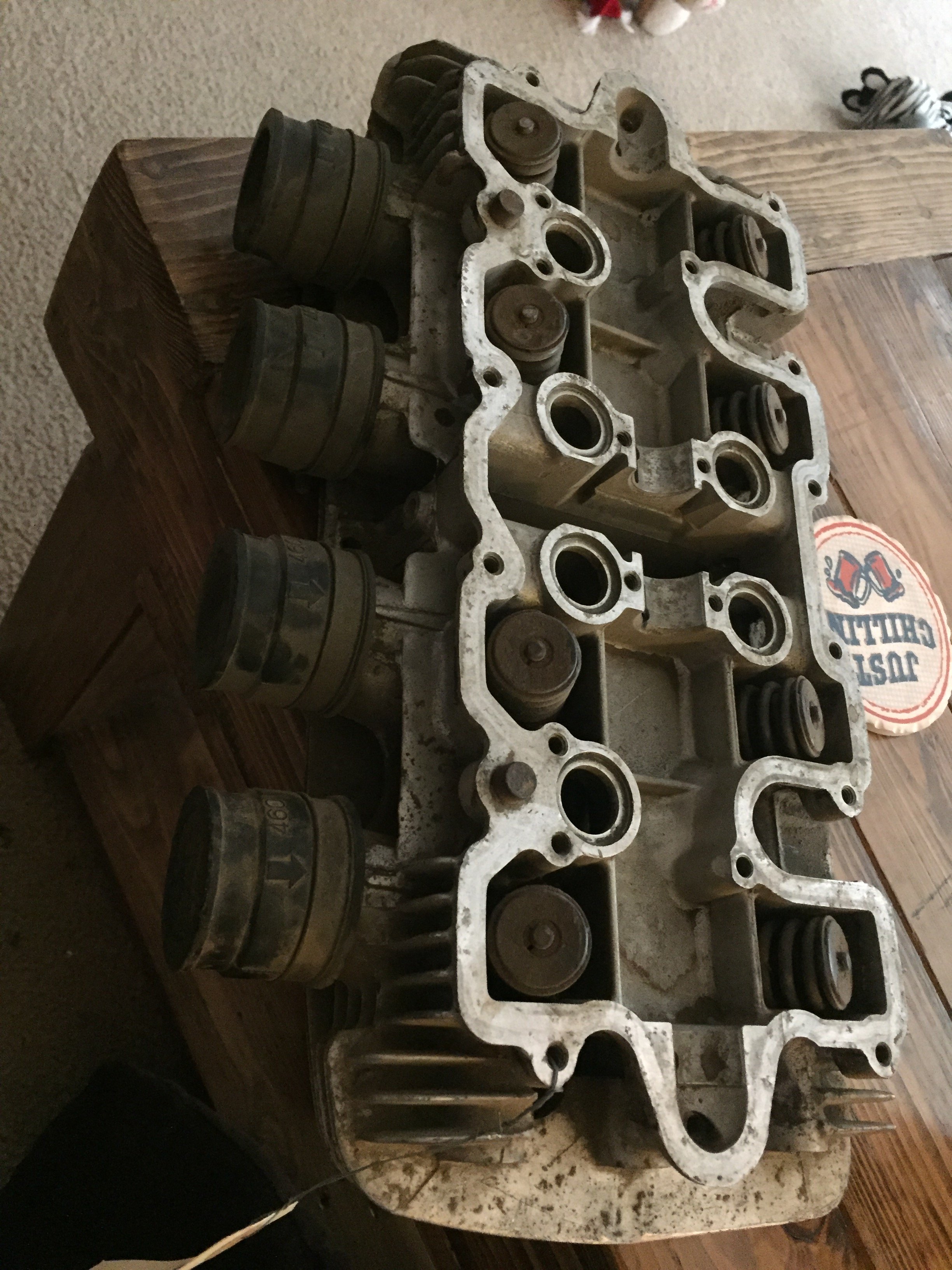

So how should I go about cleaning this? Should I soak it in something? I figure if I have it off might as well soak it. Or should I just clean it one piece at a time?
Why yes those are perfectly good boot with no cracks!

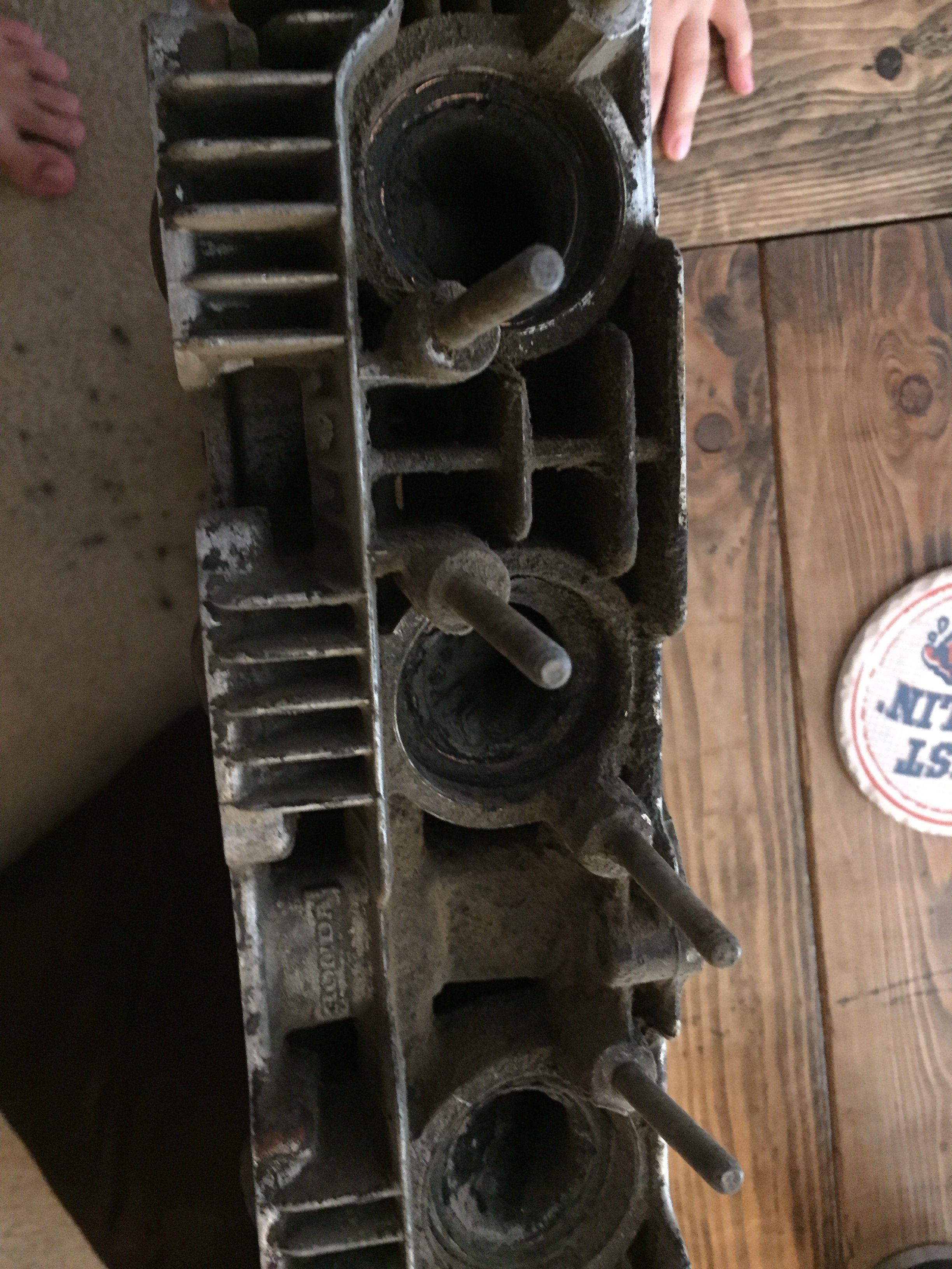

Couple real quick questions.
1. The long bolts that hold the cylinders to the lower half, how important is it that they all have washers? Because I only have like 4 so I'm thinking that's why I leak oil, because they are just a tiny bit too long.
2. should I undo the entire thing so I can get to the base gasket and copper coat it?

You need to strip the head for cleaning, change valve guide seals while your there.
I don't remember 650 having any long bolts? (do you mean the studs?)
Fit thick copper washers under dome head nuts on studs, 5/16" is usually a better fit on 8mm than a metric washer
If bolts should have a washer, fit a washer. It's a good idea to make sure the threaded holes are clean to the bottom, 4.5mm drill bit for 6mm thread) and 6mm for 8mm thread (in your fingers not drill motor) to make sure there isn't any crap preventing bolts going all the way down then a thread chaser.
