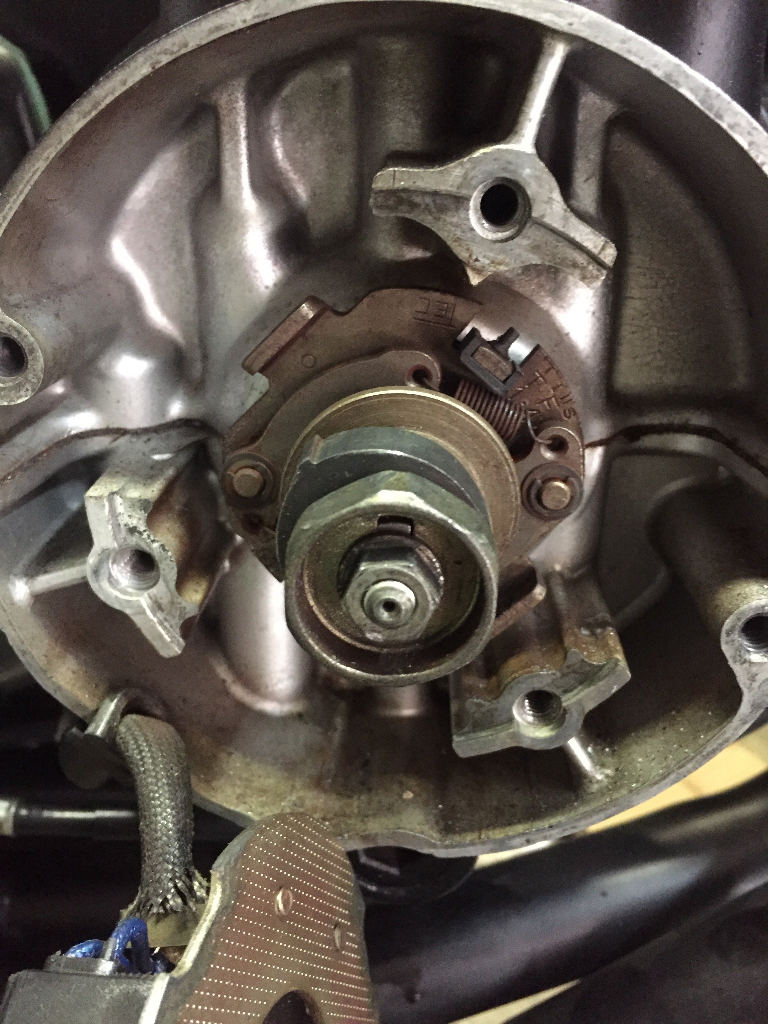

Tune-A-Fish said:
You can see the key behind the bolt. That advancer does not look healthy tho
That 'key' only locks the nut to the advancer. The pin is on the crank end so bolt has to come out and advancer removed

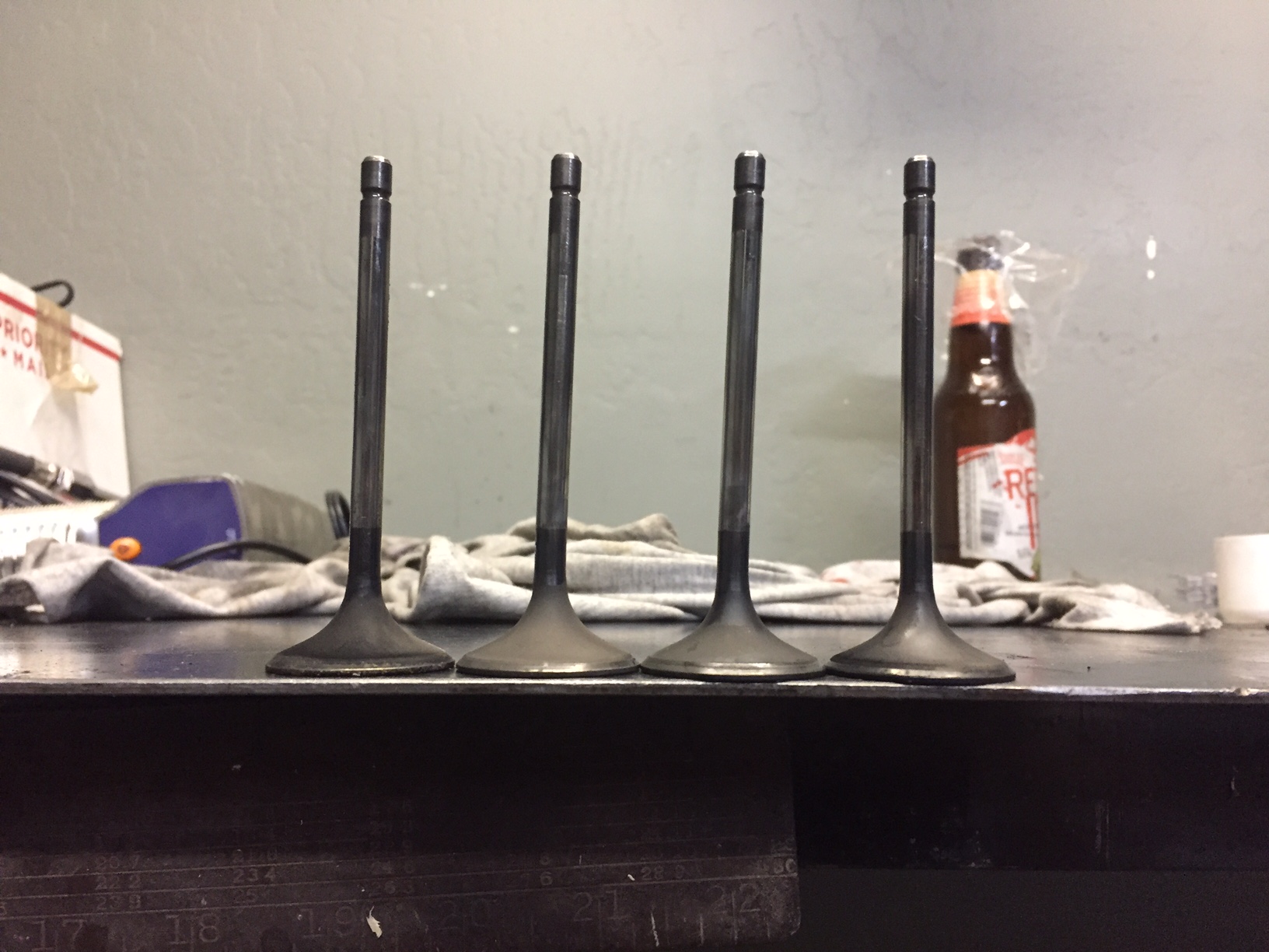

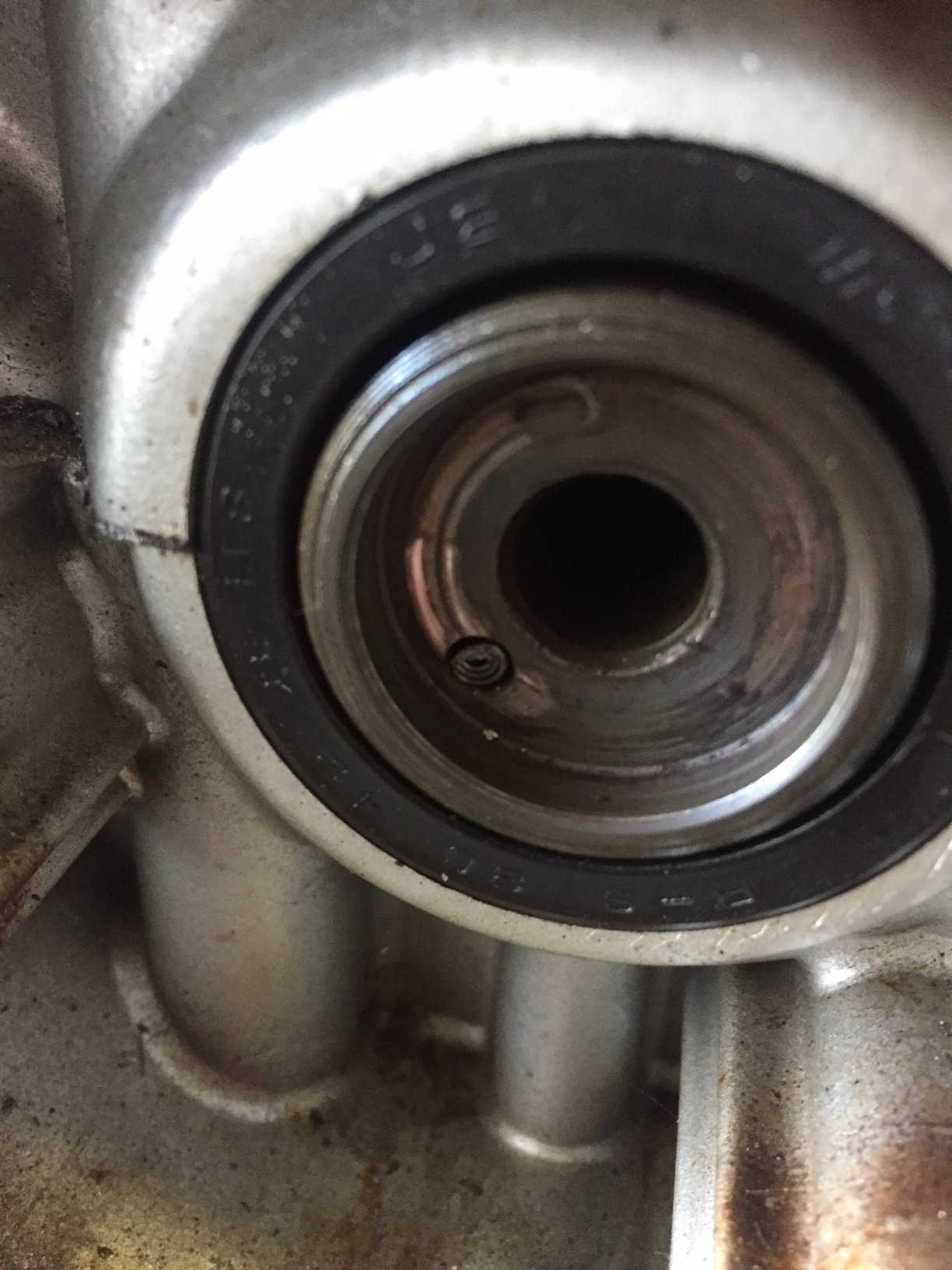

Alright so here it is...
That little pin broke, which in turn made the timing way off.
So when I went to time the motor I was very very off... and now I have bent intake valves. I did a leak down with brake clean on the exhaust valves and they didn't drip any liquid, one or two may have had the slightest moist spot around the seal but nothing close to a drip. I guess I shouldn't expect them to be perfectly sealed as the motor set for a very long time unprotected. I had touched them up in the first rebuild with some lapping compound (don't yell, I said touched not used a drill, it was all by hand)
and they have around 30mi on them so that is probably not a bad seal for that.
So now questions,
do I need to buy new? or can I get used? and in ether case of new or used how do I go about seating them? (please don't say machine shop, please don't say machine shop).
Is the very light moistness around the exhaust valves ok?
Do I have to replace my band new head gasket? I mean I just got it, its only had 1 very quick heat cycle to it, that really wasn't ever brought up to full temp...
Am I at an acceptable limit to shoot myself after all the problems I have had?

You can search eBay for used valves, I had a really hard time finding a straight valve for the XL when I did the head - it took me 3-4 valves to find a straight one (they were known for bending). Its going to cost you some coin, but I would just pony up and buy all new valves. Bring them to a machine shop (yup) and just have em grind the seats. I had all 4 valves on the XL done for under $100 at a local machine shop, and they were BAD. You may be able to find a place that can source the valves for you as well and maybe get a good deal. I would call around.
