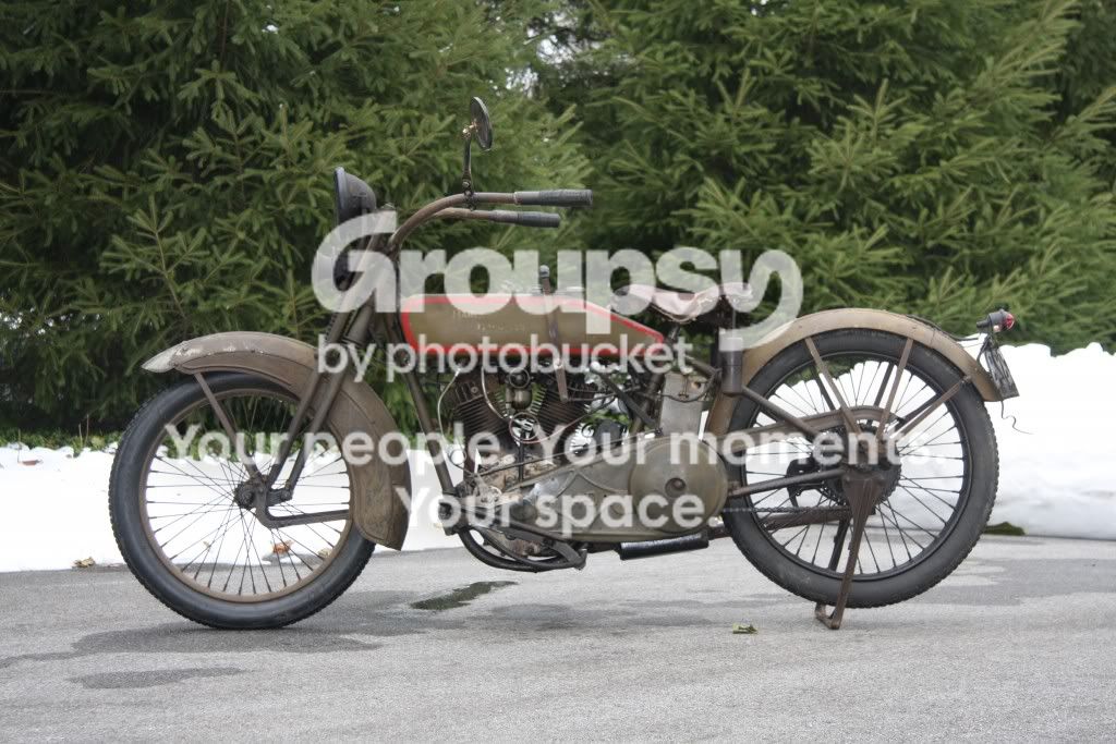

Good thought on the pegs Mike... If you really wated that "race" feel, move the pegs back about six inches and up a bit. Right towards the middle of that curve in the lower rails. Toss some linkages on and go. Itll be tight, but will give a real performance riding position.
Another thought... How about a rear wheel stand like the old HDs and Indians? Fab a flat bar that mounts to the rear axles, and swings up over the "fender". It can attach with a bolt welded to the "fender" and a brass wingnut. When you park the bike, you undo the wingnut, and swing it down under the tire to raise the rear up and keep the bike upright... Would get rid of the side stand and clean up the frame around the motor. Im sure you can come up with a better way of doing it, but that would certainly keep with the vintage race look youre after.
Re: Beat The Clock Salt Flats style
Built in race stand, very cool. and if it gets too tight of a riding postion you will just have to use it as the short trip fun bike and get cracking on the CB750 in the garage for the longer rides :-)

Instead of securing it with a wing nut (might be a pain in the ass to be really functional as a kickstand) if you weld a stop point at top and bottom a simple spring that reaches full extension at center axle will hold the stand in the up or down position.

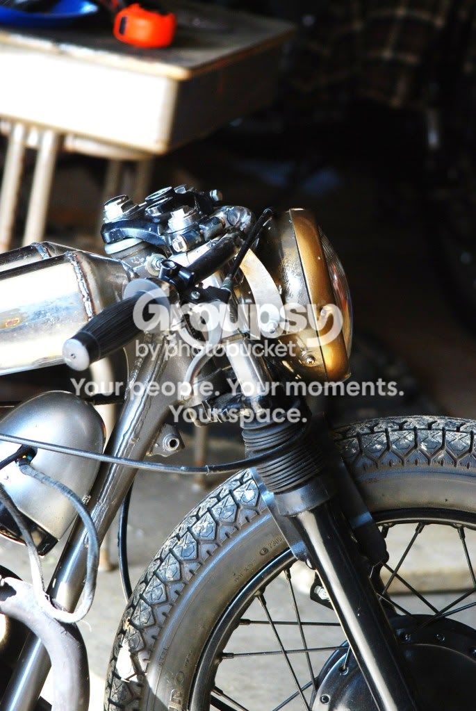

Nothing new other than a couple more pics. I really wanted to get a better shot of the headlight/bars:

i really dig the concept drawing. the bars and swaggers clamps look fantastic. i wasnt sold on them, or the big light, but after seeing them on the bike, i can't picture the bike without them.
Thanks Doug. I didn't know your feelings on the bars. I'm glad I pulled it off haha. Thanks for all the help man. It really was a blast. From the point of staring at those cones on the 750 to coming home that night and placing the tank on the bike. Awesome experience
