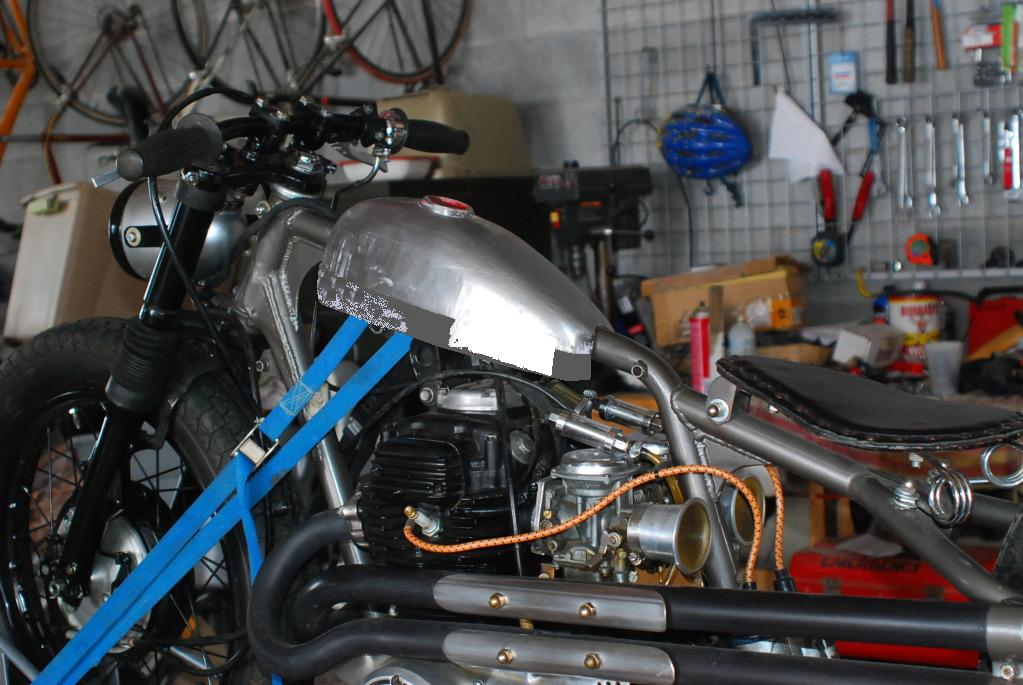

Now that the bars are going to be low I really wanted to go back to the bikes roots. One of my early inspirations is boardtrack racers. the bars will have that feel and I want the tank to look less chopperish. At the moment it is more suited for the FU bars. It sits kind of high with a very shallow tunnel. Thats about to be fixed
cut the tank apart
Cut for a new deeper tunnel
top half sitting back on the bike:
Two inches will be added between the two halfs. I think the profile is much better
Even drag bars seem a little high now
Much better lines imho
For comparison
the way it use to sit (frisco style...not my favorite)

Looks good Troy. That tank will look perfect with the deep tunnel. I am very interested to see the bar mounts in action. Just keep perfecting her I'm loving every bit of it.
Re: Beat The Clock...new tank 01-09-2011???
Once again, excellent work sir. I didn't get that tank because I didn't want a frisco mounted tank. Fantastic solution.
Much better than the frisco mount. So from what you say you are going to do someting like this? Add back the cut piece extending the depth of the tunnel?

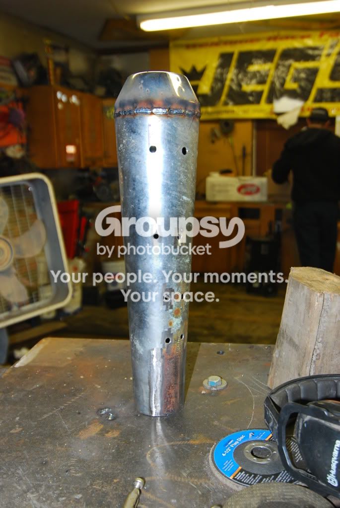

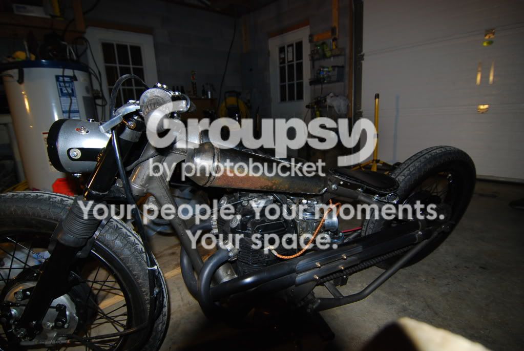

A little garage time and some friends can bring about some wild results. Thank you to Kanticoy, Beatnic and my bud Jason. Amazing what can happen you you get 4 builders together.
Doug and Kiley studied the lines of my little scoot for over two days.
Vintage salt flat racer influence: Plans are rootbeer two tone with oval creme insert. 50s style lettering with race number on the side

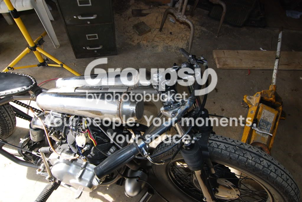

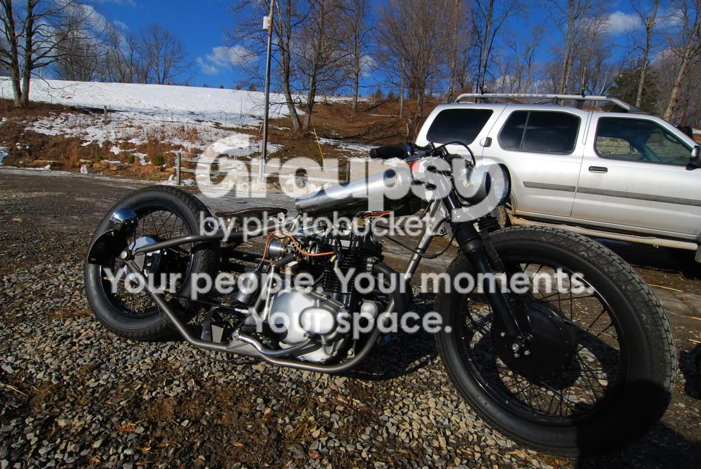

Then Swaggers brackets arrived. I bent some new bars, made headlight brackets and tracked it all up
Tossed the Wizzer tank on. I love both tanks. I'm torn ...

Wow man... Pretty fucking awesome idea with the reverse cones.

Ya Troy, I had no idea. I'm digging it.
And the bars are looking great!
