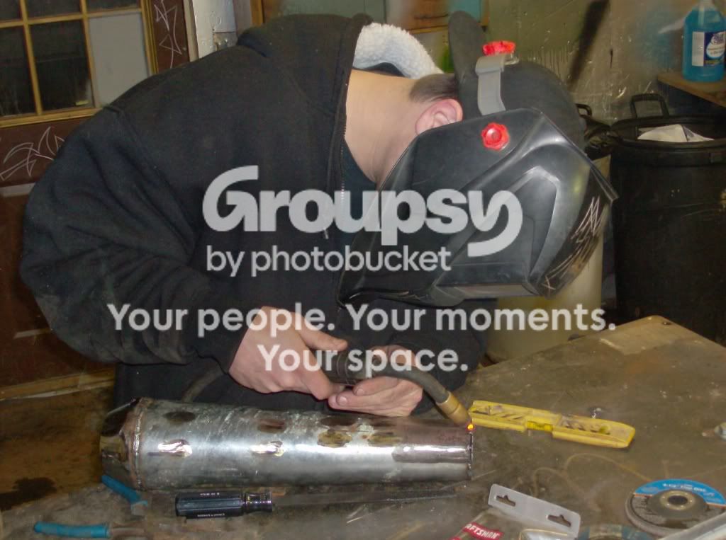

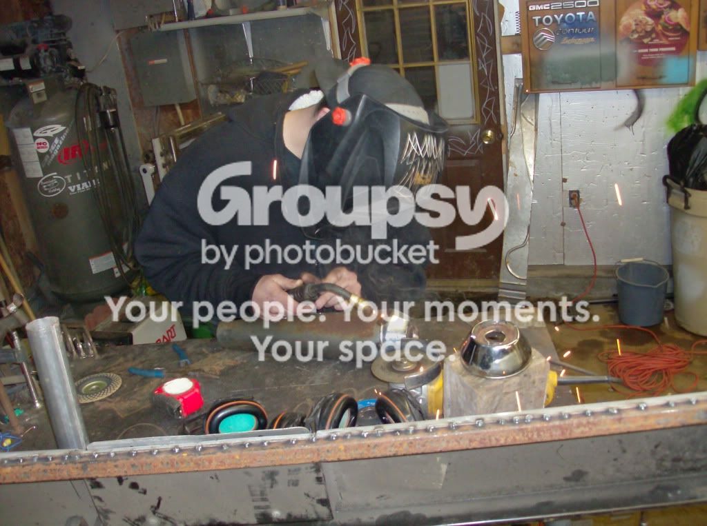

Sorry to back pedal here but I must. Kanticoy sent me some pics were we made the tank. I'm so lucky to have such talented friends. That night was such a blast. Thanks fellas!

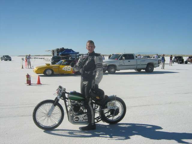

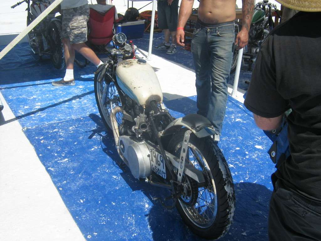

Tyler is Tyler Malinky of Lowbrow Customs. He is building another salt bike in his usual perfection style. These are the tanks. The bike is in the bone stage. I'm sure he'll update me shortly. I'll go find a shot of his Triumph on the salt from last year. He does build beauties.
I took this shot of Tyler waiting to run at Bonneville last August. Immaculate bike as was his brothers.

Haha, no that's not the Salt Ghost. Sweet looking machine though. He looks huge standing over that bike

Definitely not the Salt Ghost. Heres a link to Tyler's build diary on the JJ. No doubt it be will like his other builds, beautiful and fast. Unlike mine which are fast but agricultural.
http://www.jockeyjournal.com/forum/showthread.php?t=76268
This is the Salt Ghost.
And Wes White's Triumph.
[/img]
Kyle's stunning 650 Triumph. All great machines that might help your build. But unfortunately no match for a 500 Weslake single in a sidecar!!
