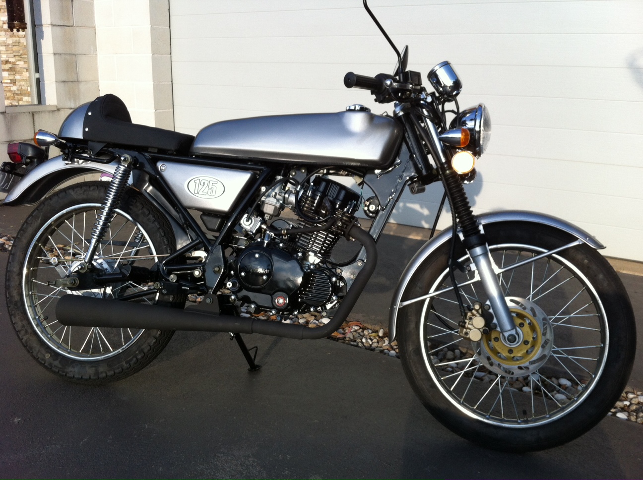

Finally got it today ! ... and the engine's black. I think she looks different, some might not prefer it this way, but to me, she looks absolutely gorgeous!
First mod - got rid of the kick starter, hehe!
More to come ...

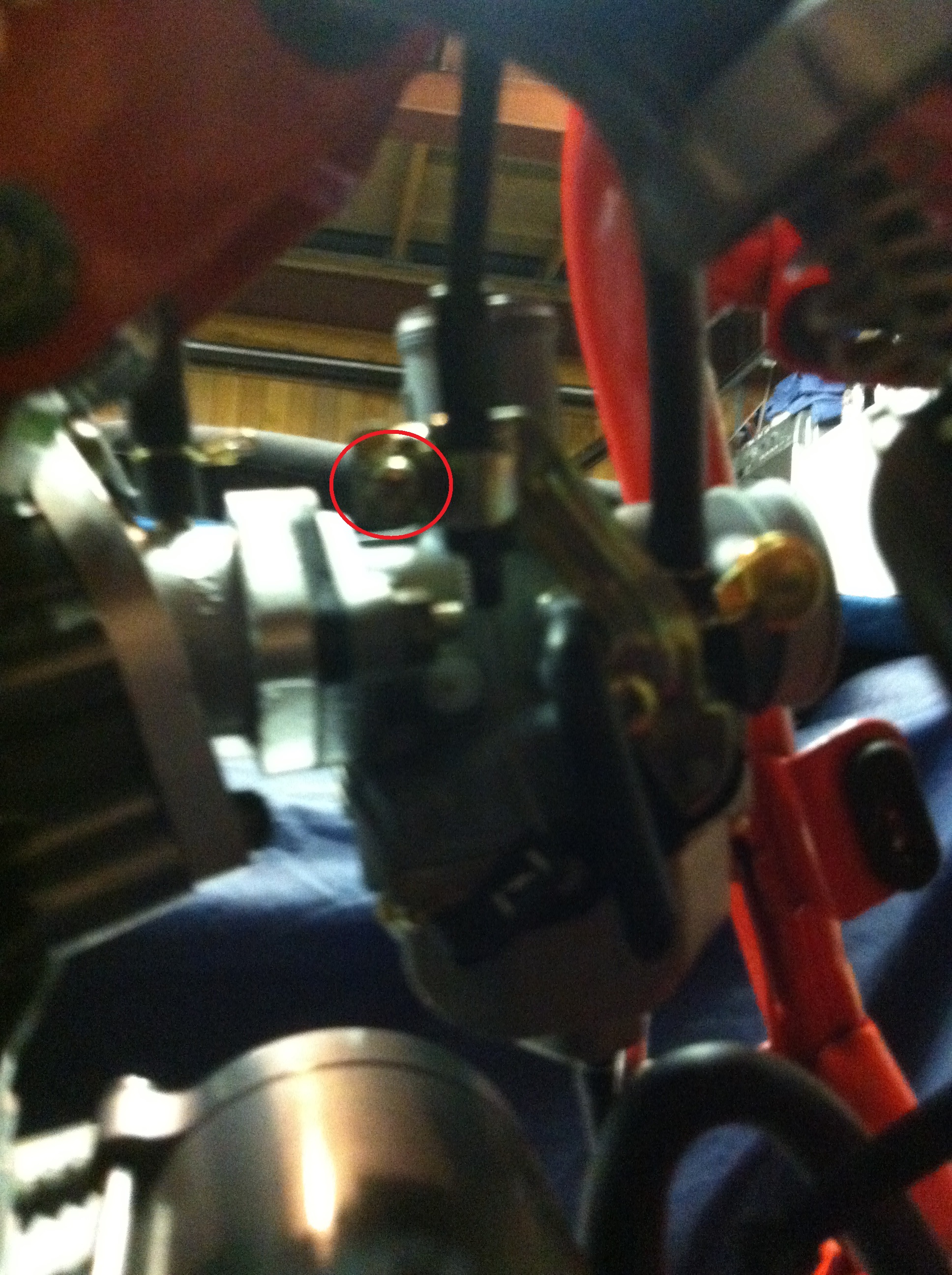

Hi Hazza,
Might be able to shed some light, sorry if it has been a bit over simple. This is also from memory so if I've made any mistakes please correct me.
1st would thing would to be disconnect the throttle and choke cables. The cap for the throttle just screws off and the return spring and needle come with it, can be laid to one side. Easiest way to get the coke cable off is to unscrew the single screw holding in the clip (circled blue 1st pic), can then be unhooked from the lever and removed.
Next drain the bowl using the screw circled in red on the second pic, might be worth letting the hose run into a jerry can or something, I'd made the mistake of unscrewing it before I realised what it did. The carb can then be unbolted from the manifold, and turning upside down you'll see the 3 screws on the bottom (circled in blue, second pic). Take those out and the float bowl will come right off.
Finally you will be left with what is shown in the third picture. The two circled are the jets the kit replaces. The larger jet in the centre looks at if it could separate in two pieces, but it doesn't, just replace the entire thing. Perhaps someone could shed some light on what the third screw does? I didn't touch it (or I can't remember doing so) but could possibly affect the tune. Like I've said put the thing back together and ran fine without any fiddling. I'll also be keeping an eye on the responses. Might be that I've missed some easy horsepower. Hope this has been of some help, good luck when your kit arrives.

I didnt even worry about removing the throttle cable. Fuel off, unbolted carby from the airbox/manifold and then took off the bowl, took the old jets out, new jets in. bowl on, fuel on, and start her up.
Hi Chris ... I ended up having problems refitting the throttle cable after I removed it - just couldn't get it right, no spring return action, throttle was stuck in the wide-open position, etc. etc !! Yikes ... had to fluff around for longer than I wanted to in the end, but managed to get it working in the end. Rejetting was a simple exercise, but my god, the throttle spring and restoring proper response was a P.I.T.A !
Bike feels slightly more responsive now, EGR removed, re-jetted using 00racing's kit, but still on stock exhaust (incl. restrictive cat). I haven't fitted the new S/S header and performance silencer yet. (Like Liam's, I need to enlarge the holes in the flange piece, and get some parts to make up special brackets for the silencer) ... maybe sometime later next week, just had to go for a ride !
