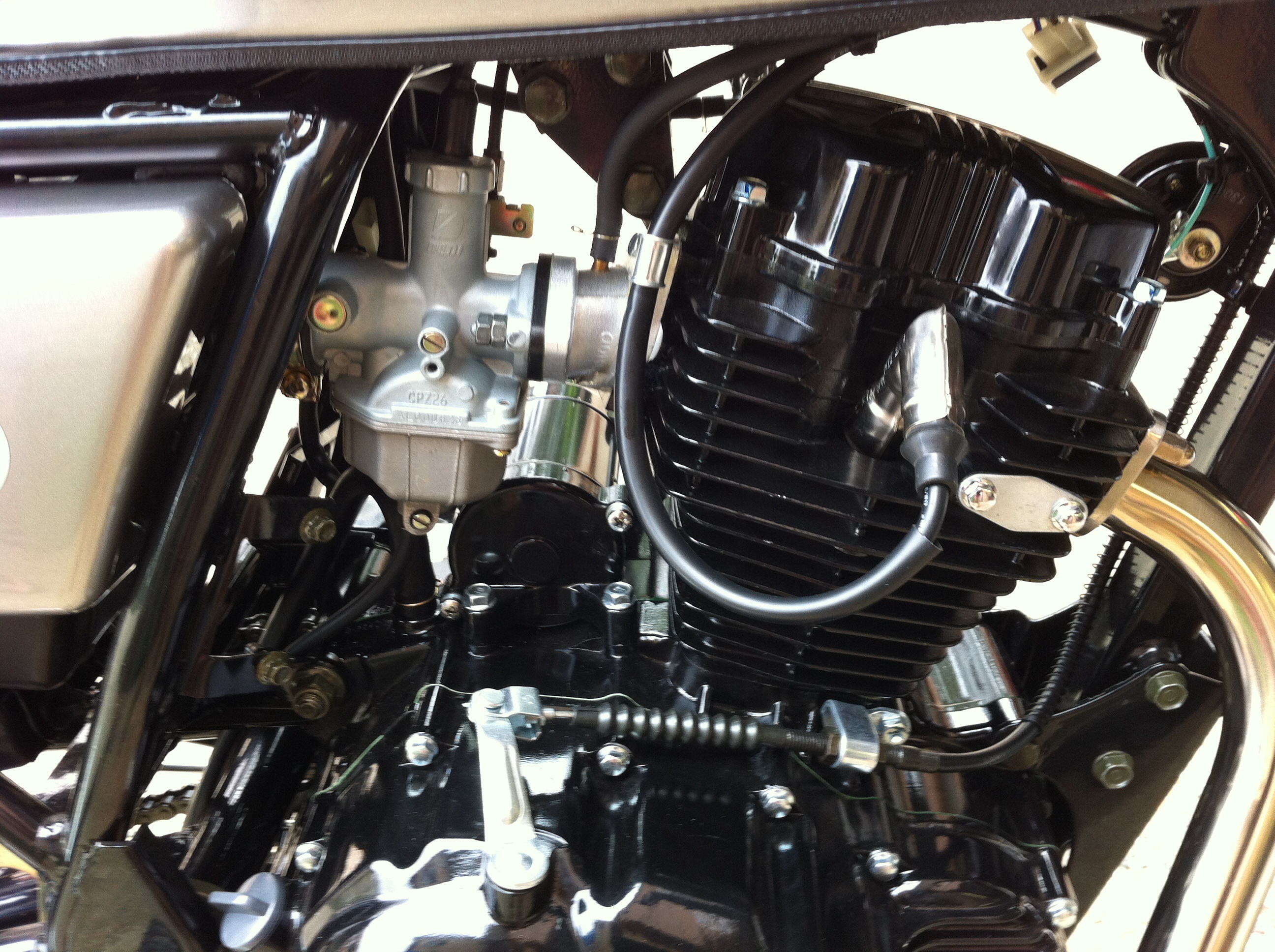

Another rookie question about the carb, just managed to change my stock carb to Mikuni VM22, it was a tight fit, took me ages to swap as lack of experiences.
After it was changed, the engine start up fine but sounded like in very high RPM, which scared the hell out of me.... Don't know what I have done wrong though. Currently running with stock air box.

Joseph... appears to be same problem as me ... I think your throttle cable maybe stuck and needs adjusting to ensure the spring action of the needle is working properly. You can tell just from whether the throttle twist grip returns to idle position by itself when you release the grip. Mine didn't initially when I reassembled the carby after rejetting. It was stuck in wide open throttle - when I started it up, it revved to the high heavens! Kill switch!
Others have posted "With the throttle cable you will notice there is a cut out of the slider at the bottom of the spring the cut out needs to be towards the back of the carb (towards the air box) as it only goes in one way or else it will be stuck in WOT. Easy mistake to make as it is a bit fiddley to get it back together. " <-- this is key!!
I had to play around with the throttle cable adjustment screws and re-seat the spring/needle in the carby many times (unfortunately for me, I didn't know about this key instruction, so used trial & error but got there in the end), then it all worked. Twist throttle, spring return could be felt again. Started up, bike stayed at idle. Rev up, all normal, ran just fine after that.
Not saying it could be the same problem for you, but sure does sounds similar. Hope it works for you also.

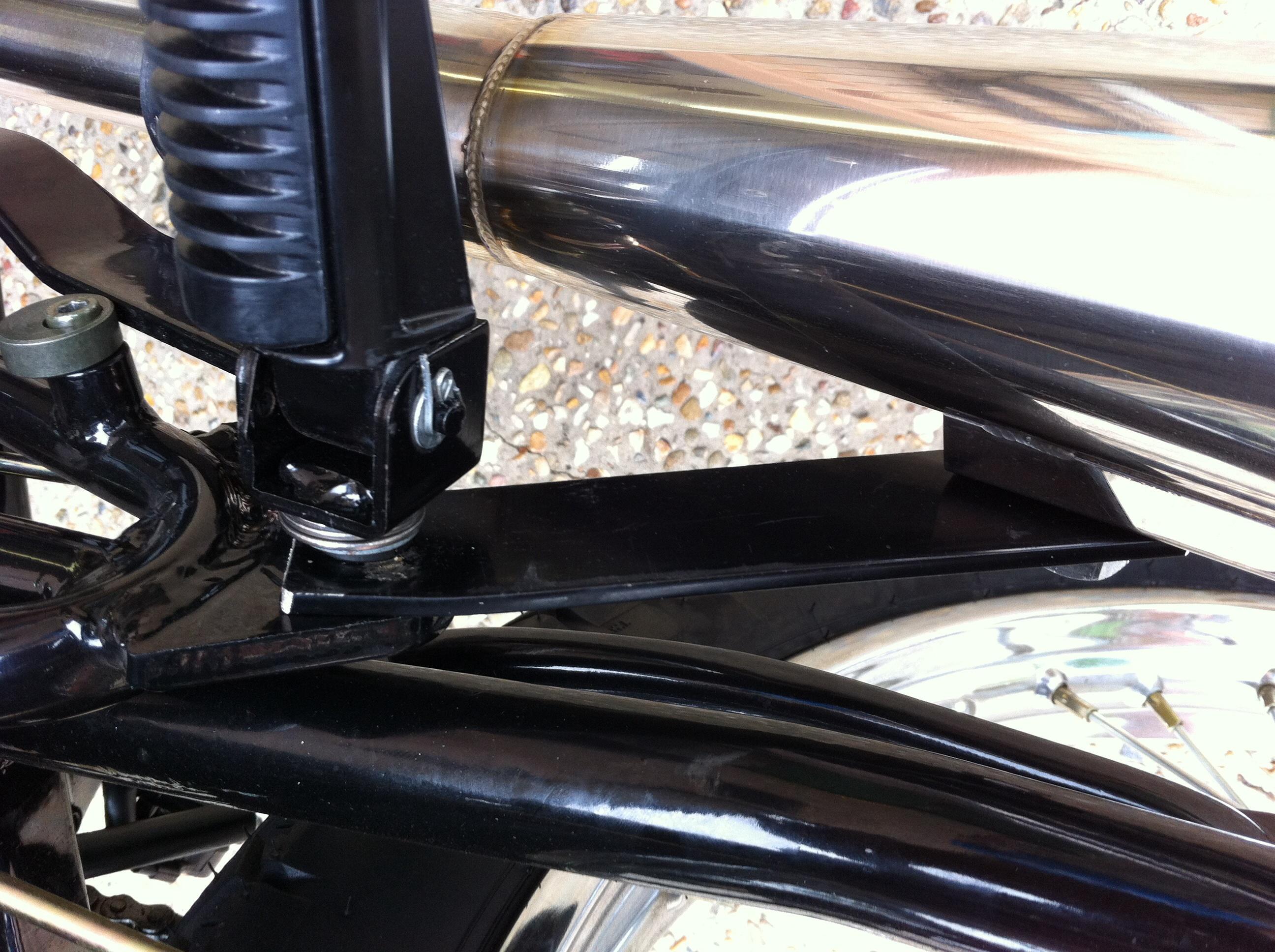

... I can't wait Pete ! ... I'm a bit challenged with the tools I have at home (one large hammer, one screwdriver, one borrowed socket set!! hehe), but will find someone to help enlarge the holes on the flange and help with the custom bracket to fit the silencer.

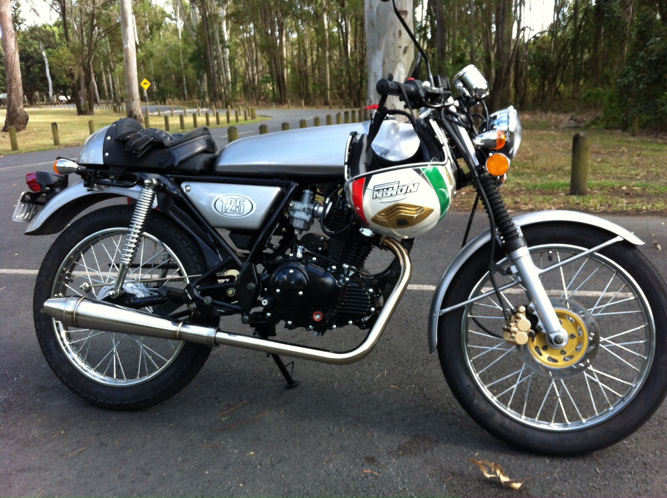

Finally ! ... Got my new exhaust and CDI fitted with the help of a mate who was more mechanically gifted than I ! He fabd a bracket for the silencer and helped with the flange holes.
Sounds great and feels much more responsive now ...
Pics to follow
Haz

Will post a sound file of the new exhaust tomorrow ... At idle, it really sounds like a much larger bike, very impressed by the sound and change in its attitude!
Haz
Glad to see it come along so quickly! Looks great. Should ride much better, more responsive. When I made my exhaust I cut into one of the bends in the original pipe and found that the internal wall of the pipe was half cut off in the bends with gathered up inside pipe. And after that it had to get past the two cats. Exhaust was choking the poor little bike half to death.
Looking good mate I will have to get my bracket for the silencer sorted tomorrow.

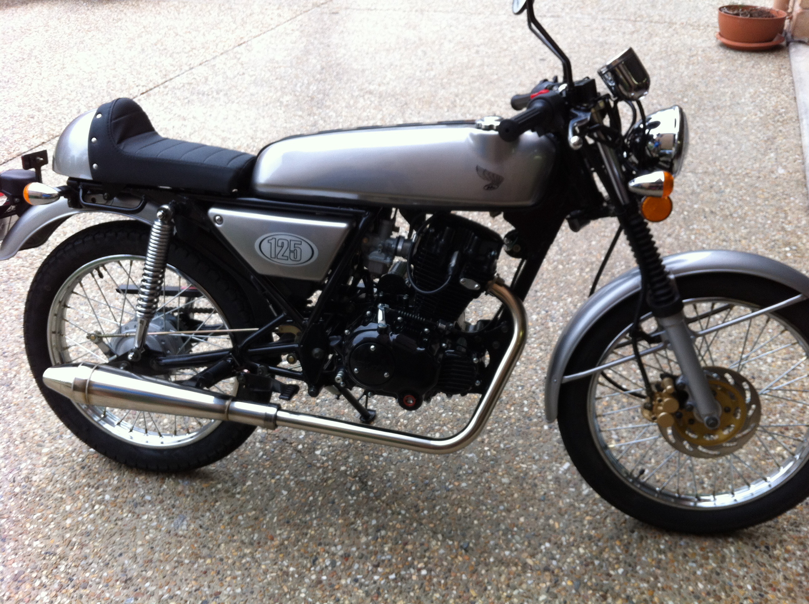

... few more pics from this morning's ride !
Haz

... are they the stock rear shocks?
Yes Chris ... I don't really feel the need to replace them just yet, but have looked at a few aftermarket options.

they arent the same as most of the other aces, they look cool.

... hmmm, wonder if it's the same as your stock unit, but without the outer chrome cylinder (maybe that part wasn't fitted, or was forgotten, by my bike dealer)?? ...
Haz
the ones on your bike looks like it has adjusters to preload the springs, from what i can see in the photo,the stock ones dont have preload adjusters.
