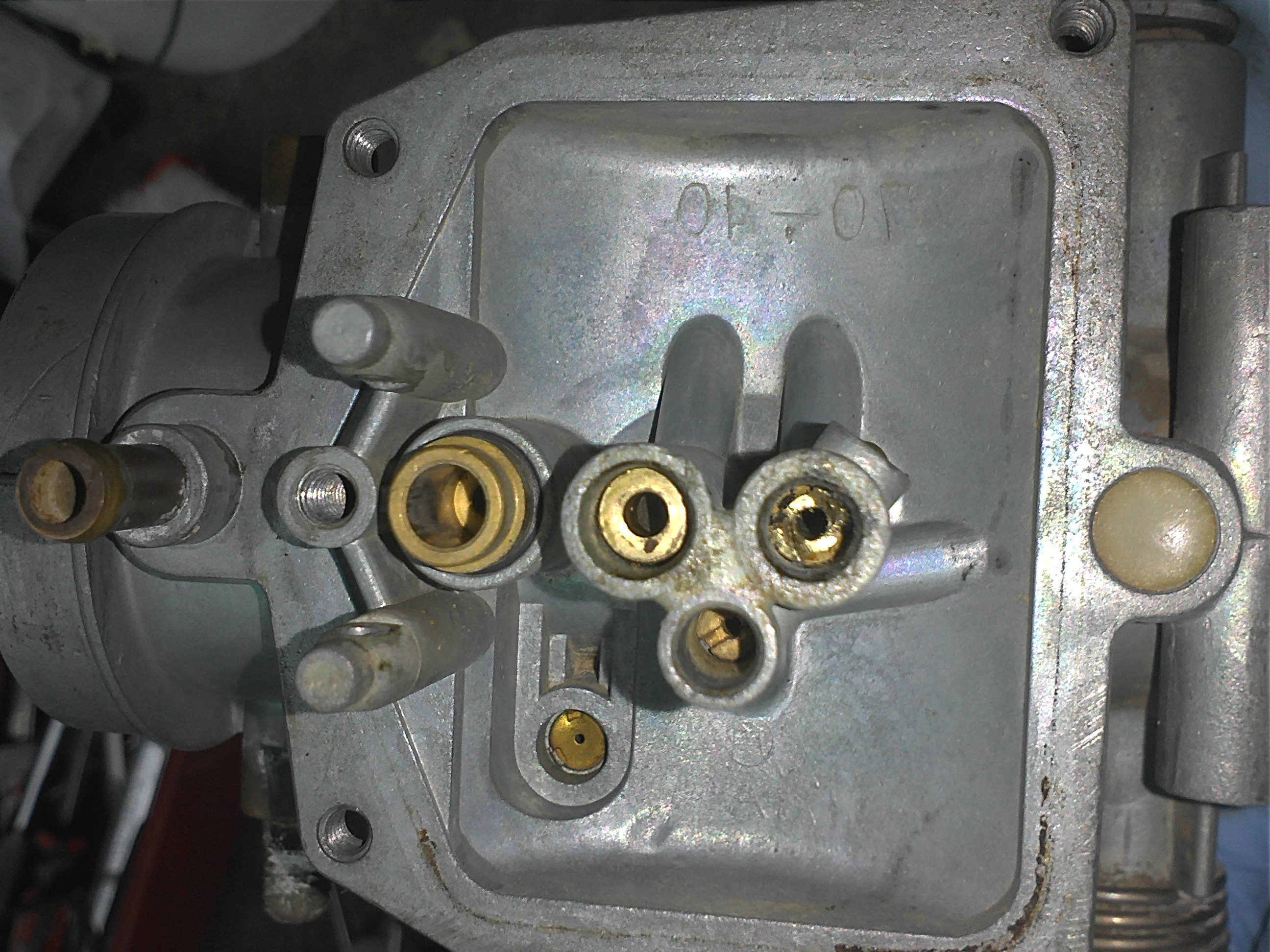

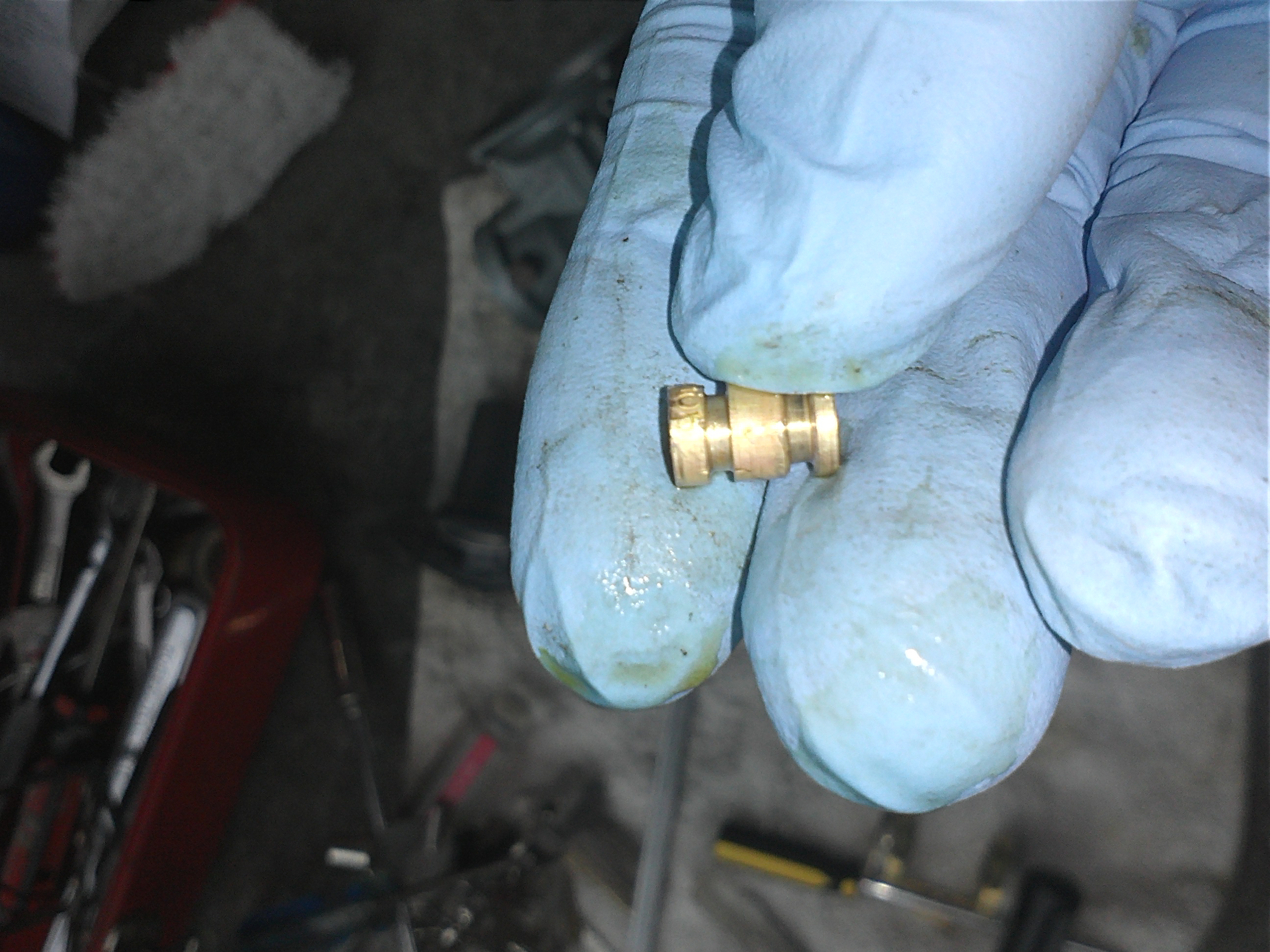

Looks like in at a stand still currently because the PO screwed up one of the carbs it got stripped or something.
And does anyone know where to get a replacement for the second picture?
Looks like it doesn't come with the rebuild kit.

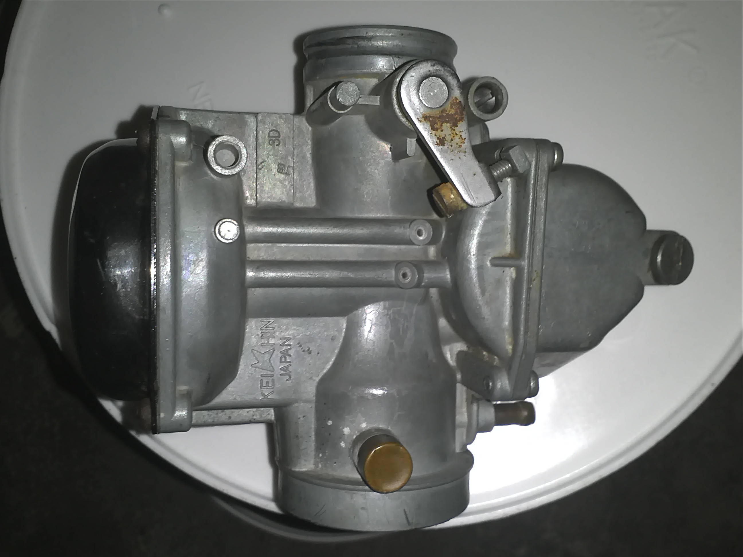

Also what Carb do I have?

the second picture is one of the jets, I can't tell but it's either the main or the primary, the main is the bigger of the two. as far as getting that stuck stripped jet out, try one of those really small 4 fluted screw extractors, it's brass so the extractor should bite well and it'll destroy the jet but probably get it out for you
thanks roc! i will try to attempt it when i pick screw extractors wednesday!
