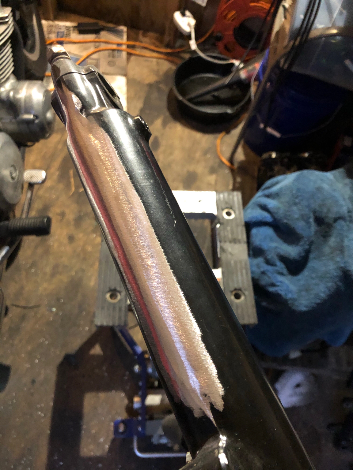

For mounting the front, you can form loops over the braces on each side (total four) and attach with 4 or 5 mm nylok nuts and button head allen screws (my local Ace carries them). For the rear, look at rotating an original for that size (from your favorite source, maybe even a DTT member donation) forward and cutting off extra.
