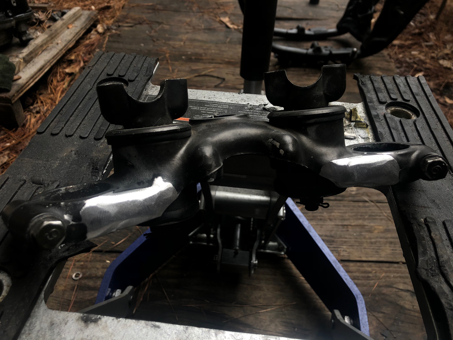

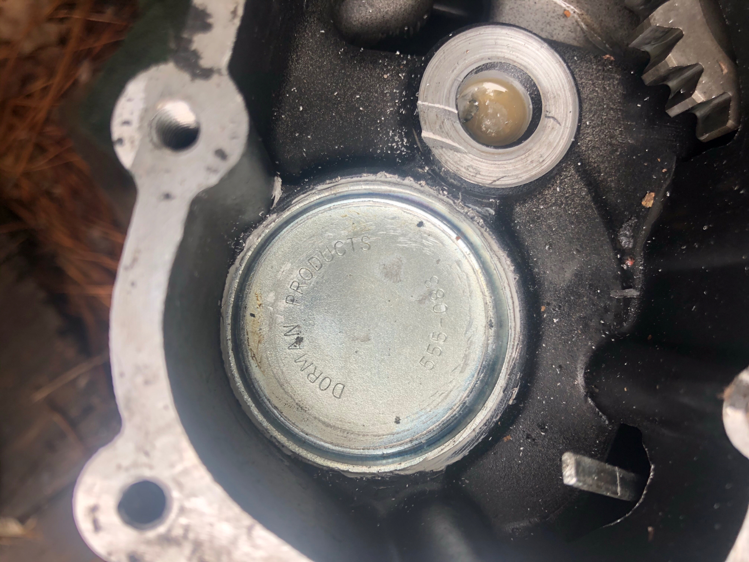

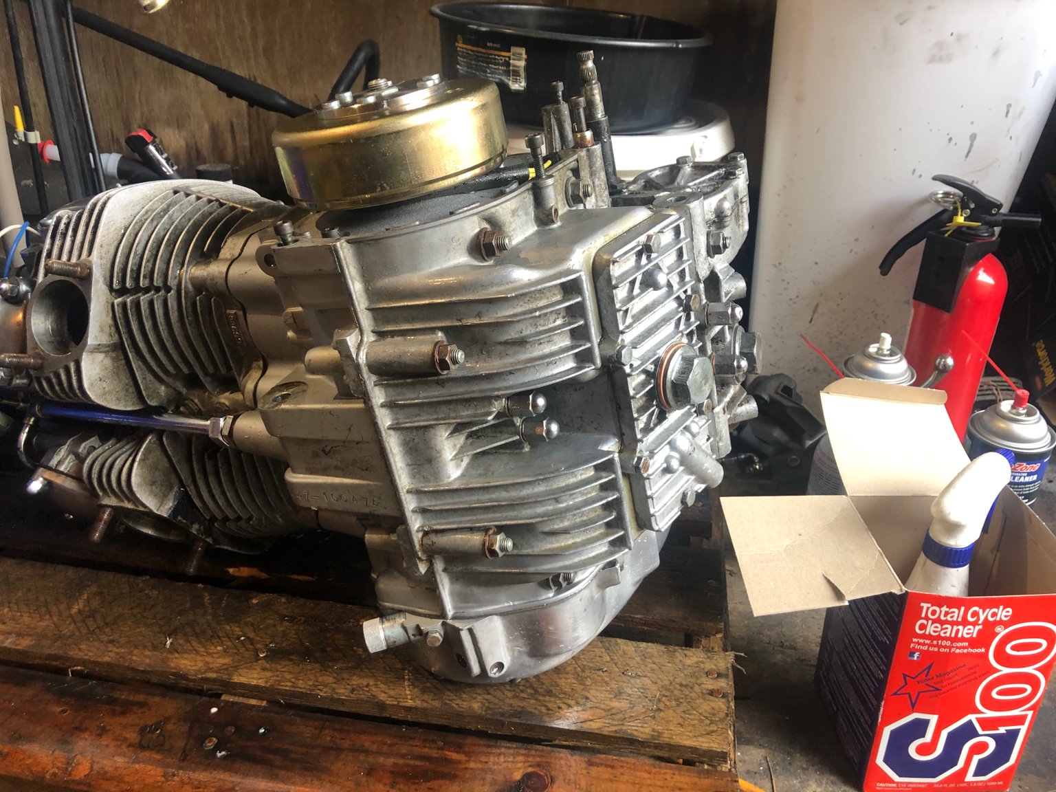

Weather is a little better today so I’m charging on. Finished the starter delete on both motors. I tested it out on the first then on the motor I’m using. Didn’t go in beautifully, but it should get the job done. Then I worked on the top triple shave. I’m leaving the ignition mounts so I can add a speedo later on. It should look pretty nice after some sanding and paint. Then I’ve started on cleaning the motor. This thing is a real chore to move around. The S100 works really nice. Now I’m off to the hardware store for some etching primer. Hopefully another update later

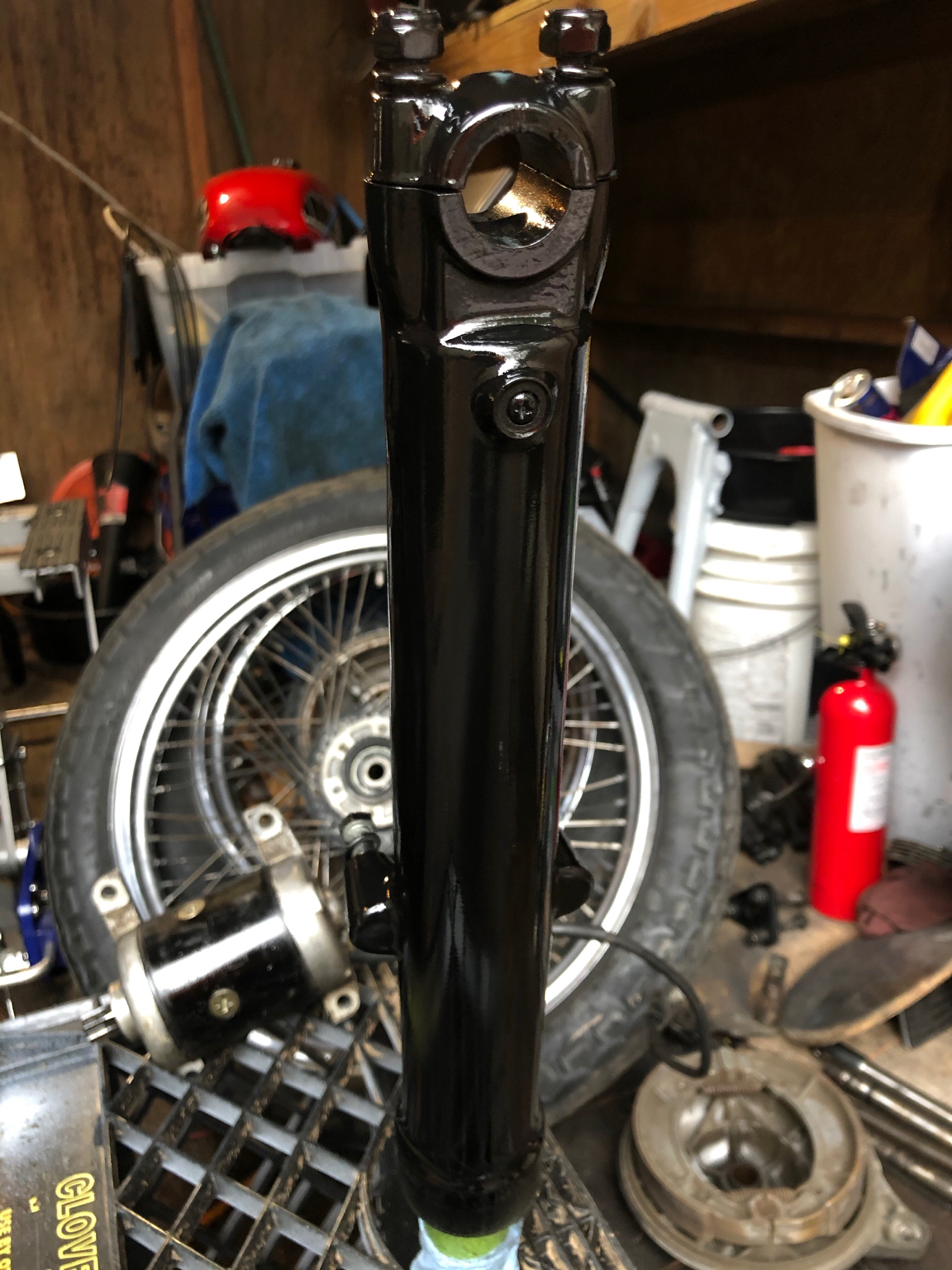

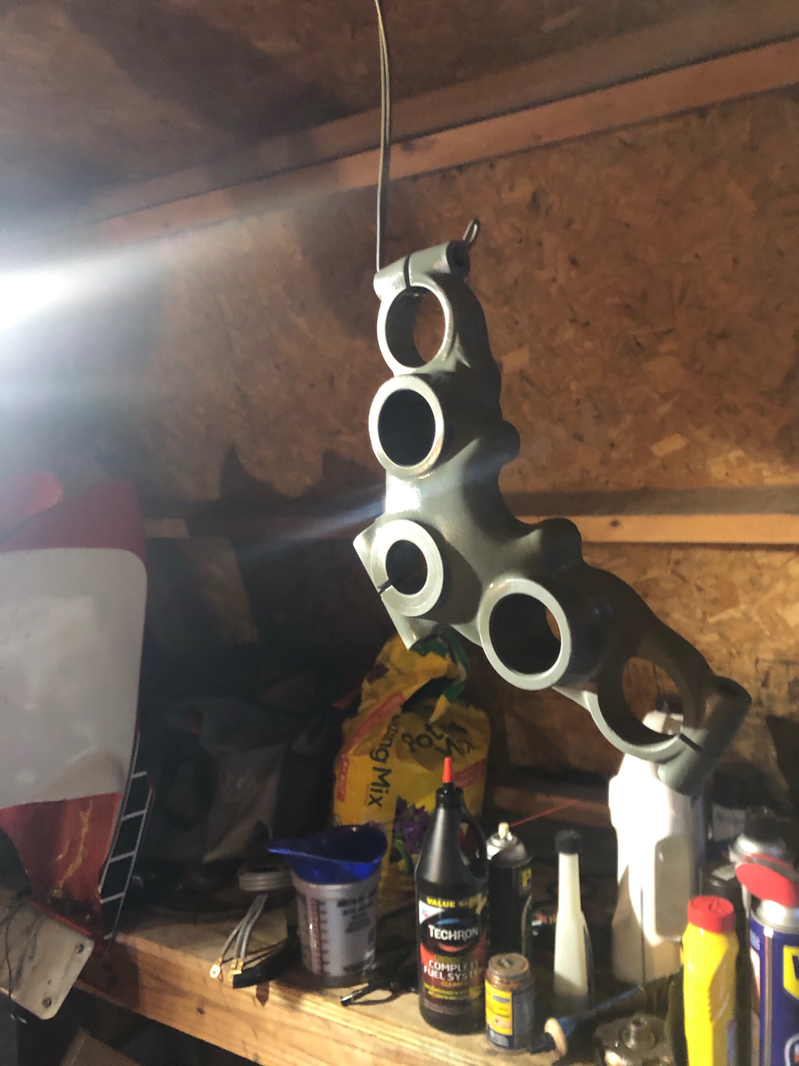

I was able to get the top triple and the fork leg stripped and primed. Took some extra time on the top triple since it’s basically in your face the whole time. Still waiting on my seat, and still procrastinating on my wheels. Once I buy tires I’ll kick it in gear

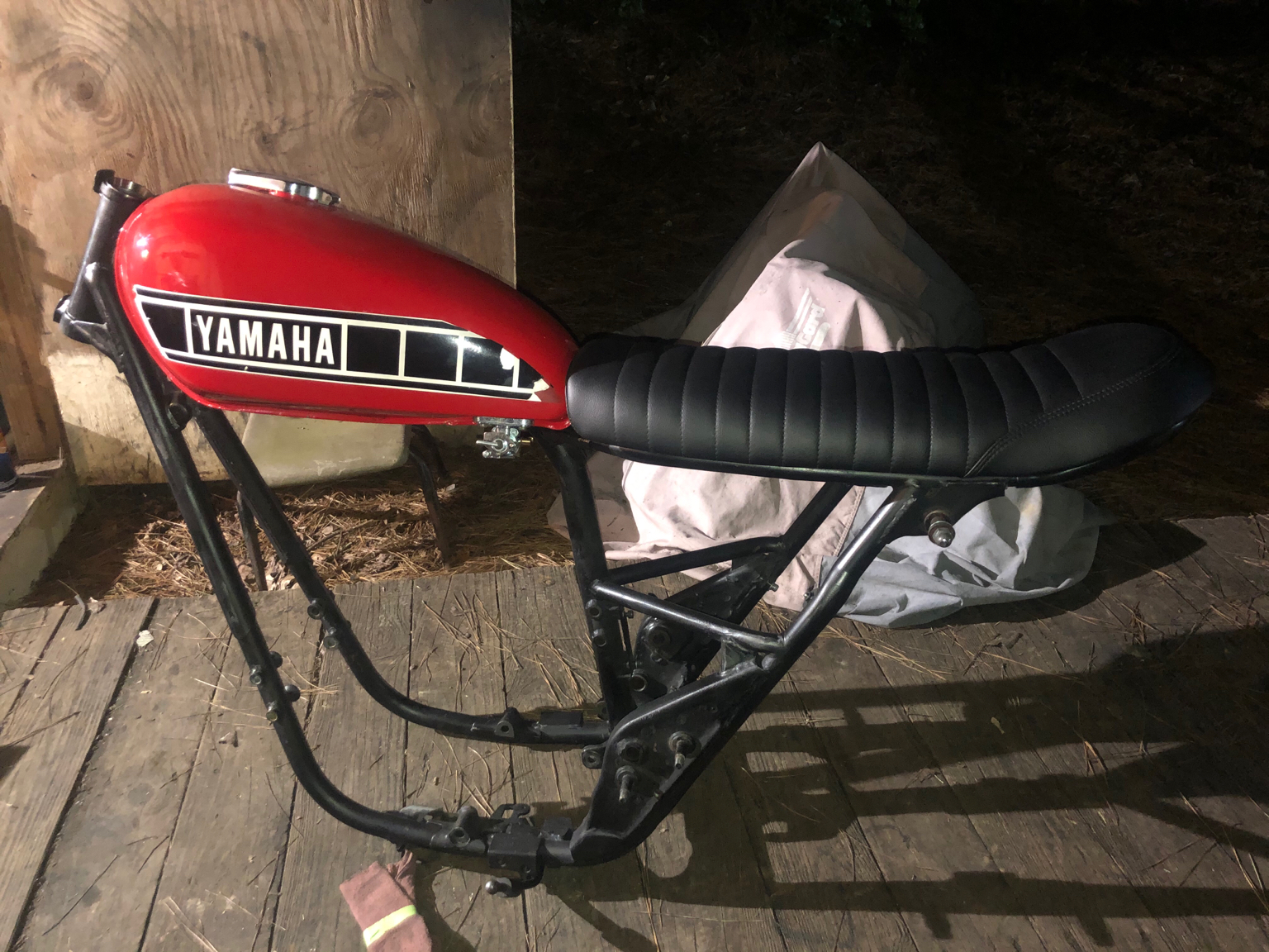

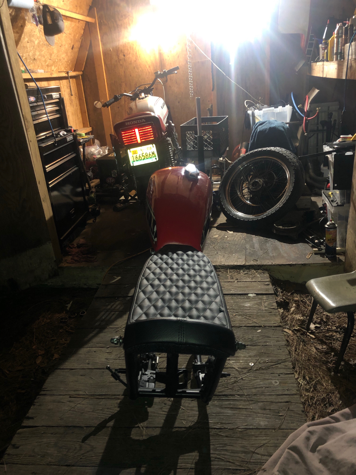

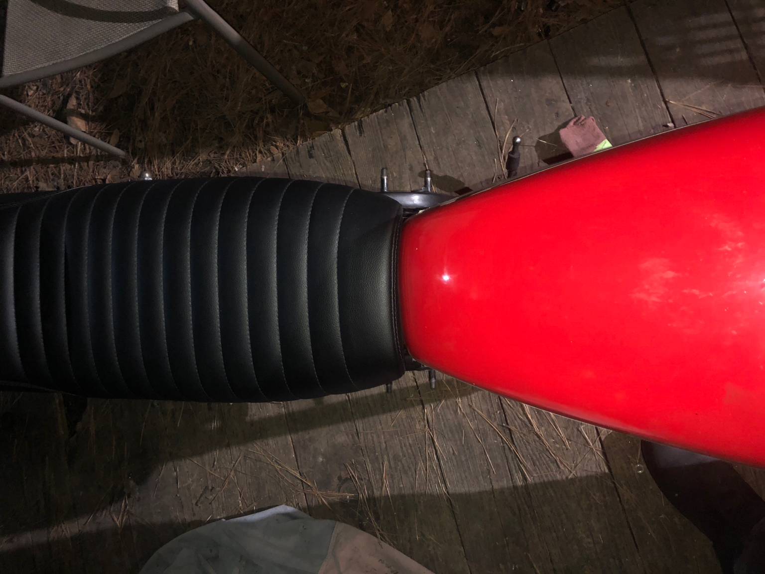

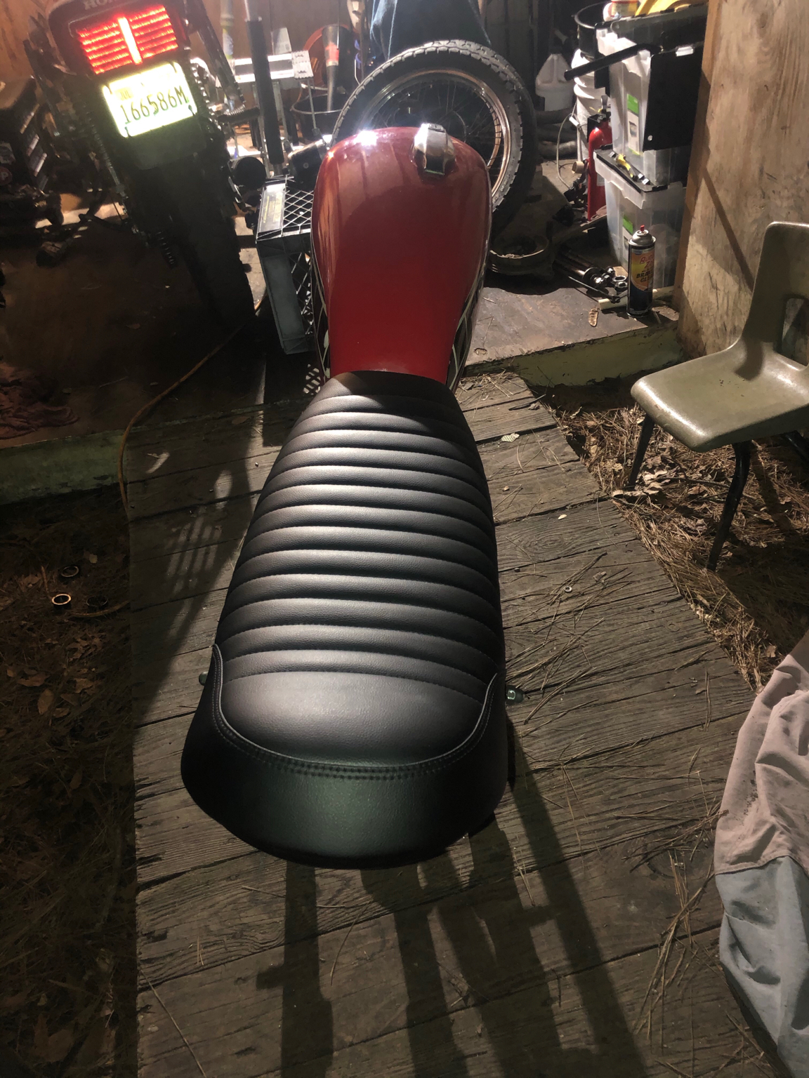

Ok, so I did one thing I probably shouldn’t have but I’m glad I did. I ordered two seats. One from a Vietnamese company called Texavina and one from a guy in Rhode Island. The Vietnamese seat came in today. I have to say the quality seems better than I expected, and it also came with some extra brackets and doo dads. It also came with an unexpected seat hoop that fits quite well. The seat however doesn’t fit as I had hoped. It’s a little wider than necessary and doesn’t meet the tank well. It’s pretty marginal, but it may be a deal breaker for me. It will work, but it doesn’t pay any attention to detail. Hopefully seat number two from the Rhode Island maker will do it for me. Took some really bad photos in the dark, but open to opinions. Also, the crappy sticker could be throwing it off. Still haven’t stripped the tank, so look past the paint
Also, this is just me running outside to look at it quickly. So rough mock up is an understatement.
For what it's worth, for my personal taste I like the first one better, I like the rounded contour more than the flat but that's just me. Both look pretty nice and you've got to do what makes you happy. Use either one and you'll still have a great looking ride.
