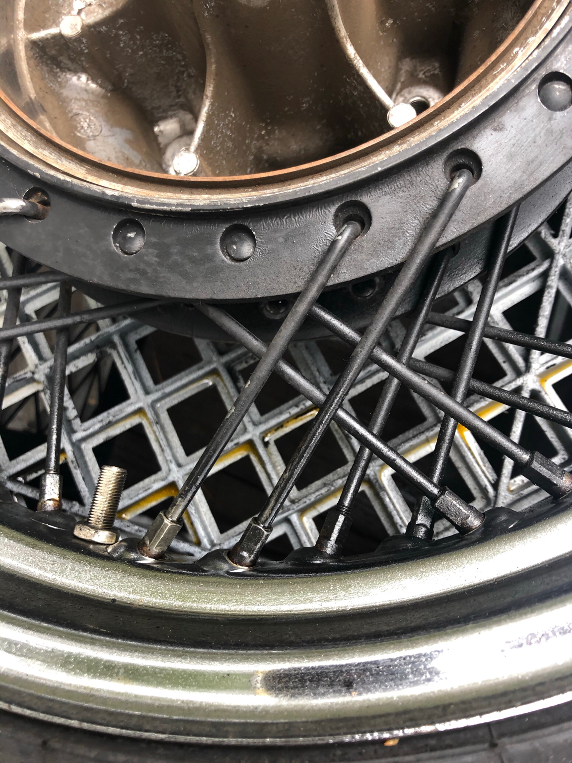

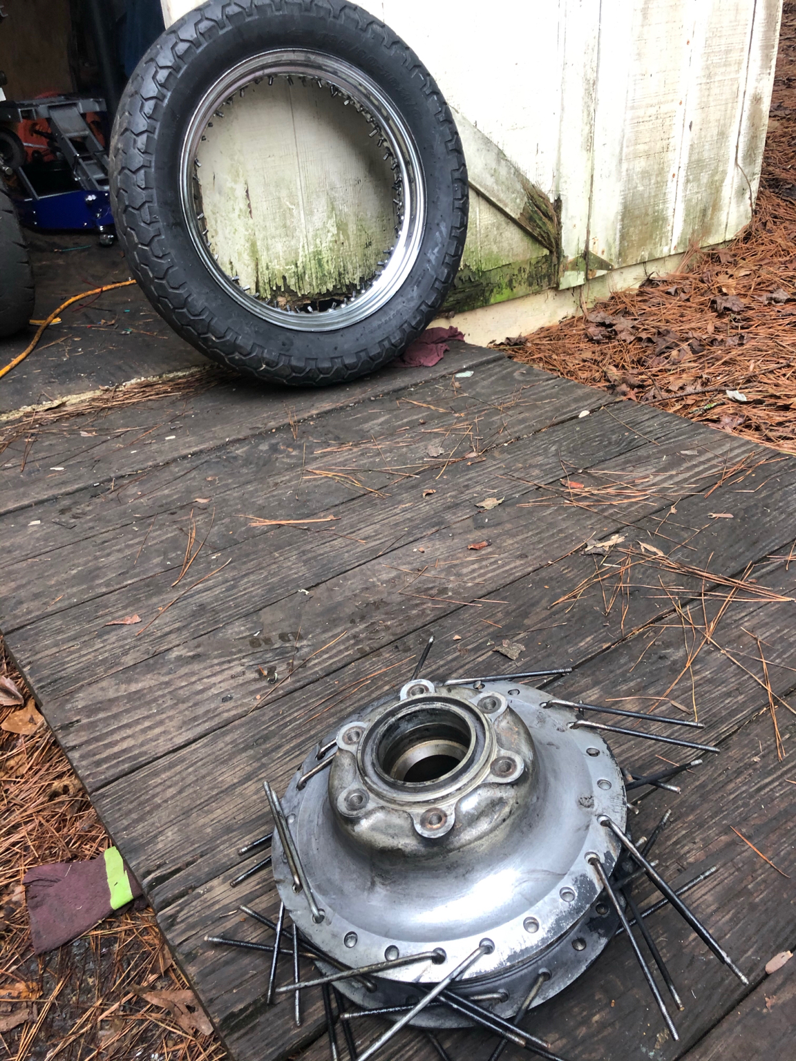

They are the 48 spoke 16” wheels. Haven’t found a viable replacement rim in the 48 spoke so I’m going to suck it up and make it work. First of all I need the hub separate for paint. PO just painted everything assembled.....terrible job. Also, flat black..... not good for spokes. I’m going with high gloss, and I’m going to leave the spokes metal.
After separating the hub, the angle grinder made quick work of cleaning it up
Tried an angle grinder clamped in a vise for the spokes, but it’s dangerous and labor intensive
Back to the drawing board on the spokes and nipples. I’m going to try some airplane stripper and see if that works
Dude. You need the Jimb-O-Matic spoke cleaner. It's a highly specialized piece of kit, but essentially involves clamping a drill in a vise, sticking the spoke in the drill, turning the drill on and then run some wire wool or scotchbrite up and down the spoke. I cleaned up all the spokes on my last CB build that way, worked a charm.
Not sure if you can see much in the pic (ta, Photofucket) but you'll get the drift...https://www.dotheton.com/index.php?threads/montreal-manchild-with-an-81-honda-cb750k.72170/page-24
Nice! I may try that. After stripping the paint, there’s a fair amount of rust. I may end up replacing them. We’ll see
It only took a couple hours with a drill and 800 grit. They came out alright. There’s a little bit of pitting, but it should work for now
Thanks for the tip!
Look great, nicely done. Mine were really beaten up and the nickel plating was really roached - the sanding will likely remove the plating so you'll want to prevent these from rusting further. I 2K cleared mine and they came out aces.
I was thinking of clear coating them. There are some spokes that are pretty rough. Hopefully I’ll have a new pair of wheels built by later this year, but these should do for now. I think they’ll look fine laced up
Rustoleum makes a stainless steel appliance paint. I've painted some parts with it. It is durable and leaves a nice finish. They also make a professional stainless cover but I have not tried it. I think spokes would look good using the appliance paint.
A set of high quality stainless steel spokes and nipples from Buchanan is in the range of $100 - $120 for a 36 spoke wheel. MikeXS sells the XS stainless spoke kits for $75 per wheel. I question all the effort and expense of buying stuff to plate or coat or polish when getting something that will never rust again is really not that expensive. I used to go through the effort before I realized I was killing myself for not much in return.

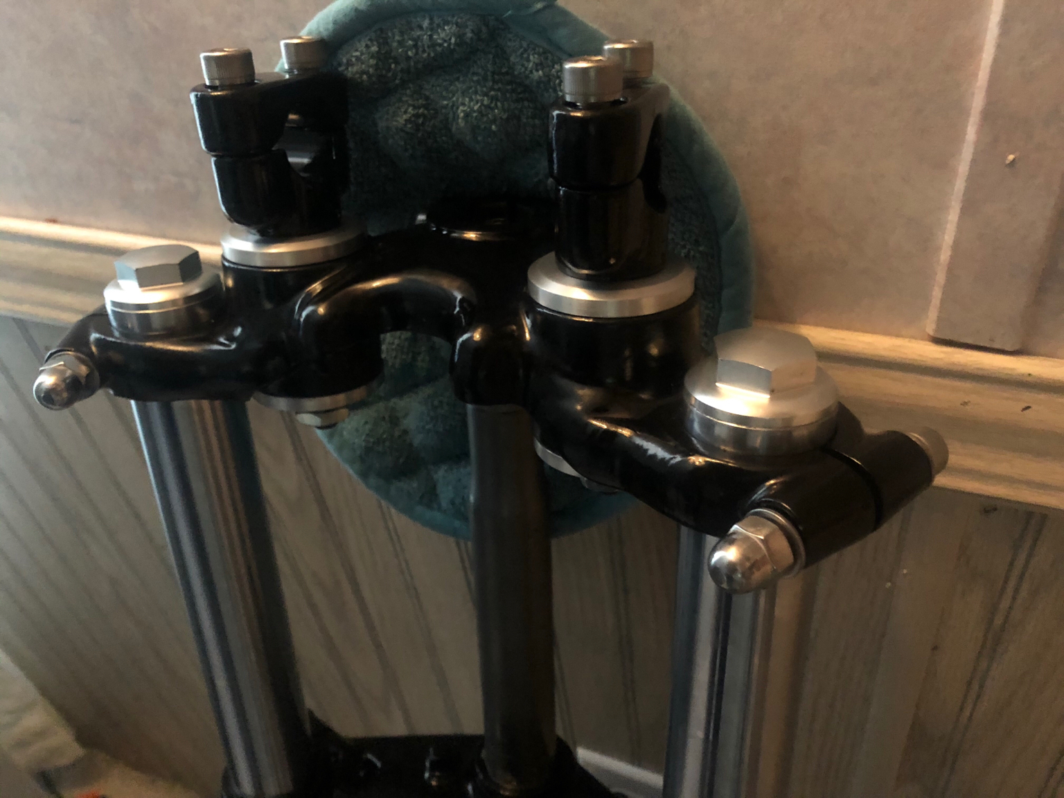

Cockpit is coming together nicely. Swapped out the fork caps. Didn’t realize the factory ones had preload adjusters. That explains the unexplained stiffness in the front end. This should be a much nicer ride. Fork oil was perfect

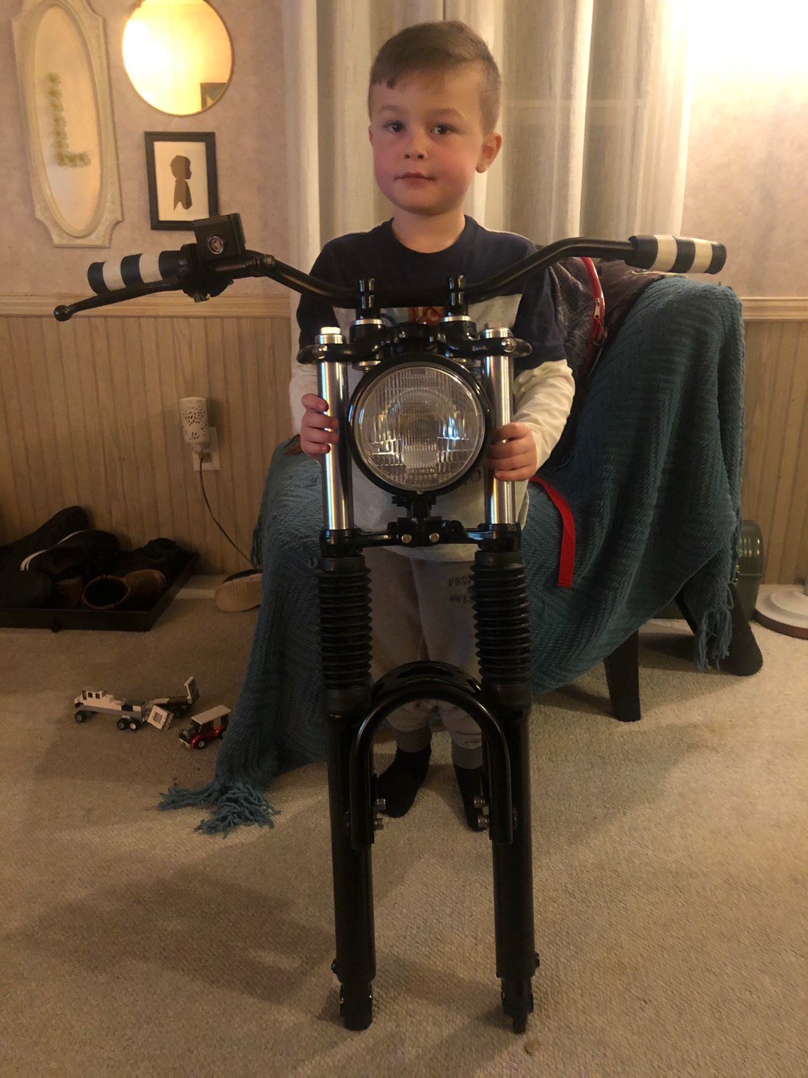

Here’s an idea of what it will look like. I’m a very visual person, so I employed my boy to help. Shortened the handle bars by one inch each side. Still looking for the clutch lever.
