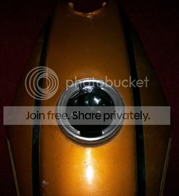

We spent some time Sunday afternoon cleaning the inside of the fuel tank to remove light rust and old fuel residue, I let the tank dry real good overnight and sealed the inside of it yesterday afternoon with Caswell tank sealer. Now that I have completed sealing the tank the tins and new decals are on the way to my Brother Jason for new paint, he does absolutely beautiful paint work so I can not wait to see them when he is done!
It is hard to get a good photo of the new sealer in the tank however you can see some of it in this photo.
