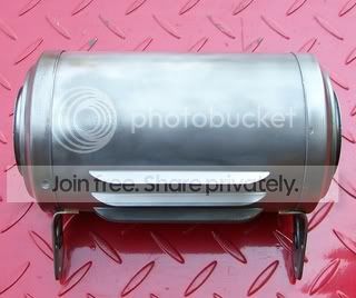

I spent a few hours today working on some of the small parts like clamps and brackets, etc. I did not take photos of all the small parts however here are a couple that show the exhaust clamps and the bracket for the battery and oil tank.

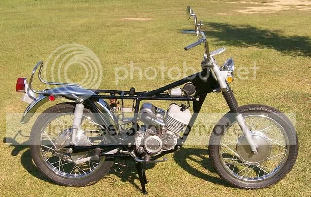

Today I spent some more time working on some of the small parts for the Bridgestone, I installed the battery bracket to the frame first and then restored the left side covers post and the oil tanks lower bracket and installed them to the frame. I decided to work on the airbox next so I spent a couple hours restoring it, sealed it with shark hide, mounted it to the engine, and installed the new rubber elbows that Brother casi sent as well as the tubes that he had rechromed. I also cleaned, sealed, and mounted the kickstand as well as a few other small pieces of hardware.
I also realized it has been a while since I have shown how the whole bike is looking so I rolled her outside and took a few photos!
Re: Bridgestone M2/SS 200cc Motorcycle Restoration
Wow Joe she's really coming together! Thanks for the sunny photos, nice to see it outside and in one piece :)
