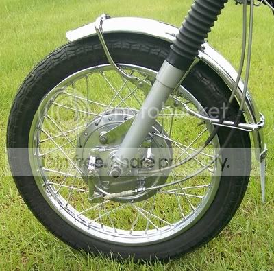

I had some butterflies in my stomach about the front fender as it was nearly impossible to find a good quality one but Joe you have turned a usable fender into a piece of art! It trully bringsthe front end together. As for the steering damper, who knows if it will function like the new technology but it at least looks real perrrrrty!
Re: Bridgestone M2/SS 200cc Motorcycle Restoration
casi85 said:
...As for the steering damper, who knows if it will function like the new technology but it at least looks real perrrrrty!
That it does, deffinetly more subtle than modern tech ;)
Have played a bit with an old Suzuki T250 which has the same type of damper. It is more or less just a long screw threaded into friction plates below the triple tree which effectively "brakes" like your basic caliper/rotor making the front end harder to turn, simple to tune but not as effective at dampening hard jerks as the more modern rod damper, still very cool though.

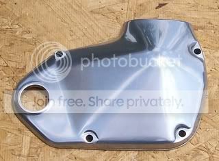

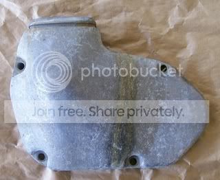

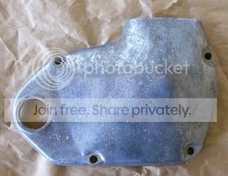

We have been working on restoring several different pieces for the Bridgestone this week, the carburetor covers had a lot of corrosion so we sanded them down to remove the fine pitting and started to give them a light hand polish. I am going to polish the carburetor covers some more however here are the before and after photos that show how they look after their first hand polishing

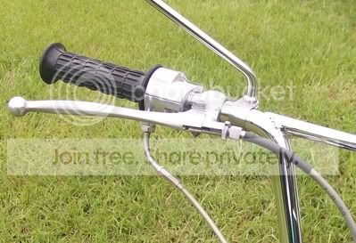

We also installed the front brake cable and adjusted the front brakes. There was one small place in the cables casing that we were not happy with so we sealed it with black heat shrink, after we sealed that area of the cable we liked the way it looked so much that we added two pieces of heat shrink to the front brake and speedometer cable where they run through the front fenders bracket as accent pieces which will also add protection for the cables.

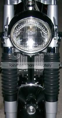

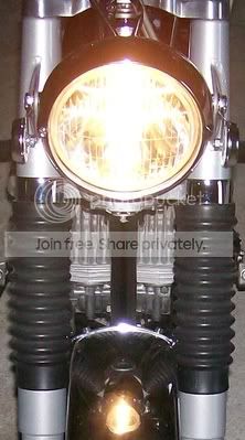

We have been working on the wiring and I was able to get most of it installed, I have just a few small things left to wire however I have most of it completed. We have had the headlight bucket mounted on the bike and now that I have most of the wiring completed I installed the new old stock headlight that Brother casi sent so that I could test it, according to the tag that was on the bike when we received it this is the first time that she has powered a light in 38 years so it was really awesome to see the first signs of new life from her this evening!

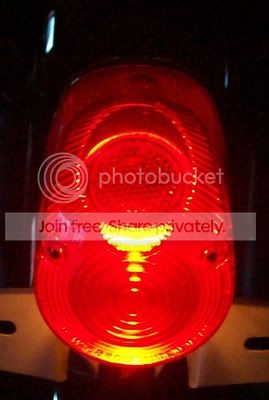

I still have to complete the final wiring for the tail light however I temporarily connected the wiring so that I could test it and the running light as well as the brake light are working good so I should have all of the wiring completed very soon!

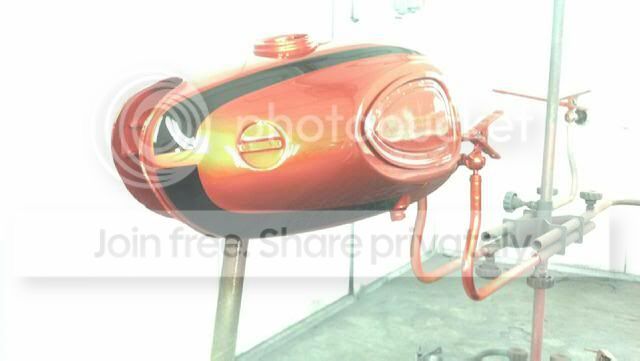

My Brother Jason added a couple more coats of clear to the tins and he sent me this photo of the gas tank!

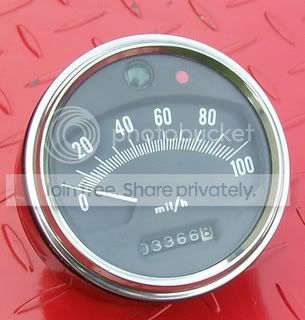

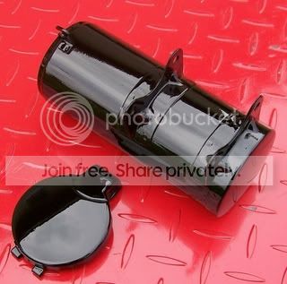

My Brother Jason really did beautiful work on the tins and I can not wait to see them on the bike, he put the final coat of clear on the tank today and has it so smooth there is no edge around the decals! I have been working on restoring the last few pieces that we are painting black, today I painted the speedometer, tool box, tool box door, kickstand, and the skid plate. I am still working on the skid plate and I have more detail work to do on these parts however here are a few photos of how they look this evening!
