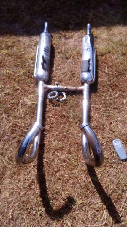

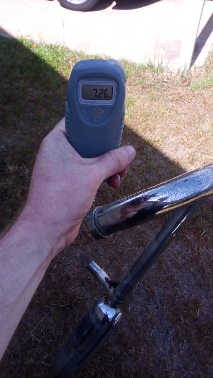

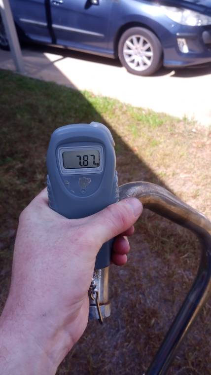

I picked up a power commander today for once I get a decent exhaust. The bloke I bought it from was kind enough to give me a stock exhaust system as well.
So in the interest of information gathering I decided to weigh it. My scale only reads to 8kg so I had to weigh each side seperatly. This exhaust also has the end baffles removed which would reduce the weight slightly. I left the flanges hooked on to compensate for that.
Kawasaki W800 stock exhaust weight.
15.13kg

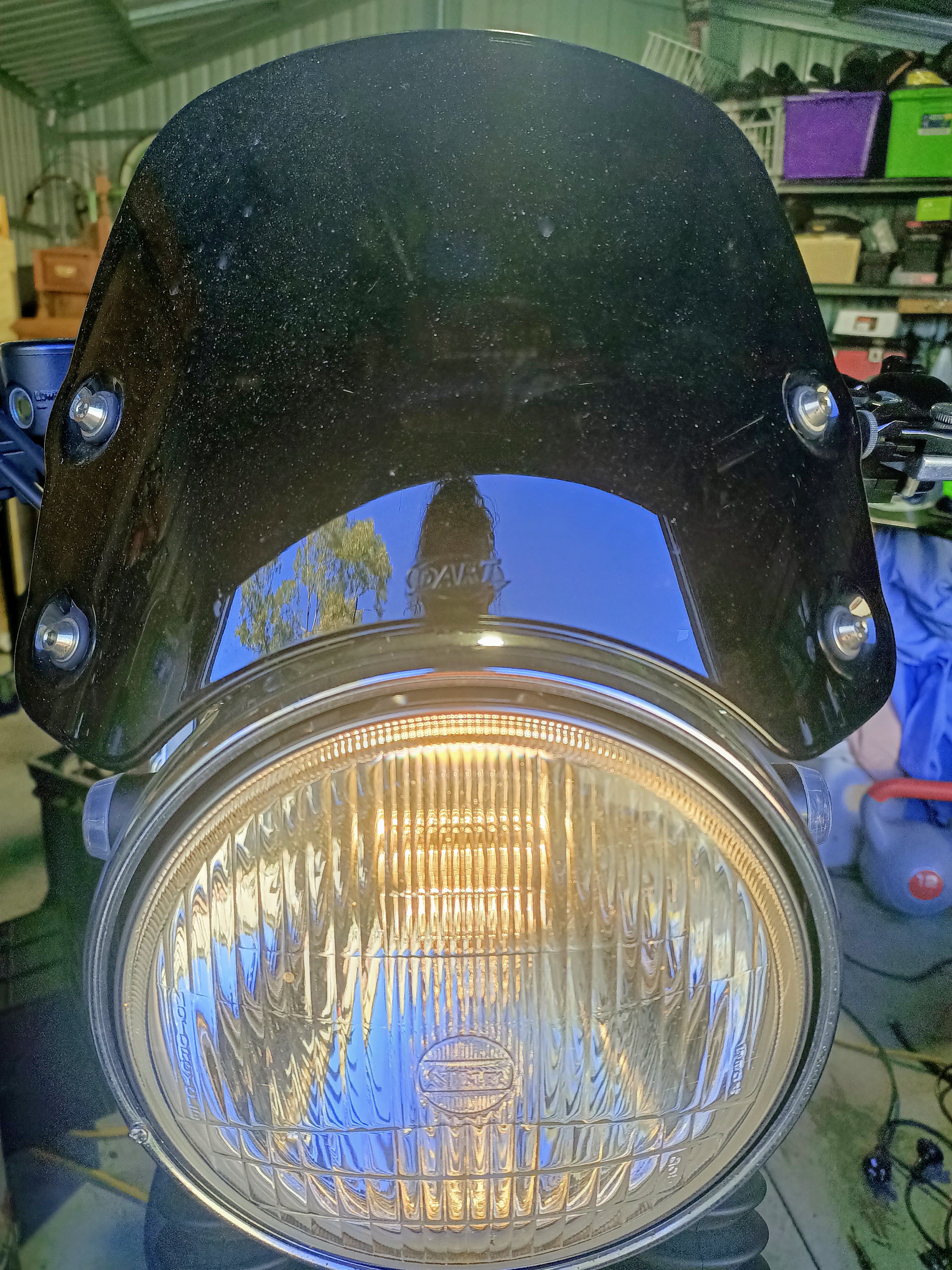

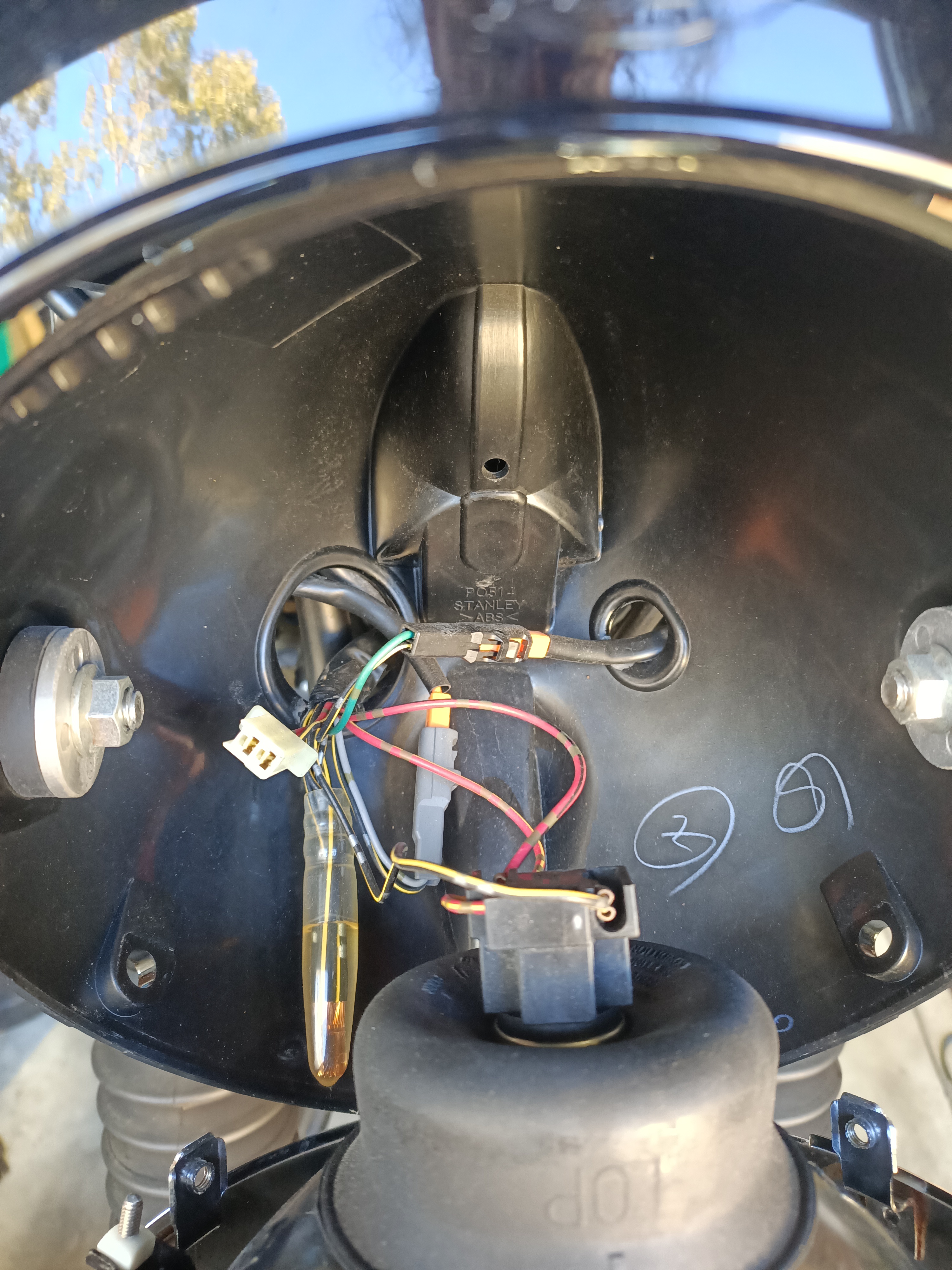

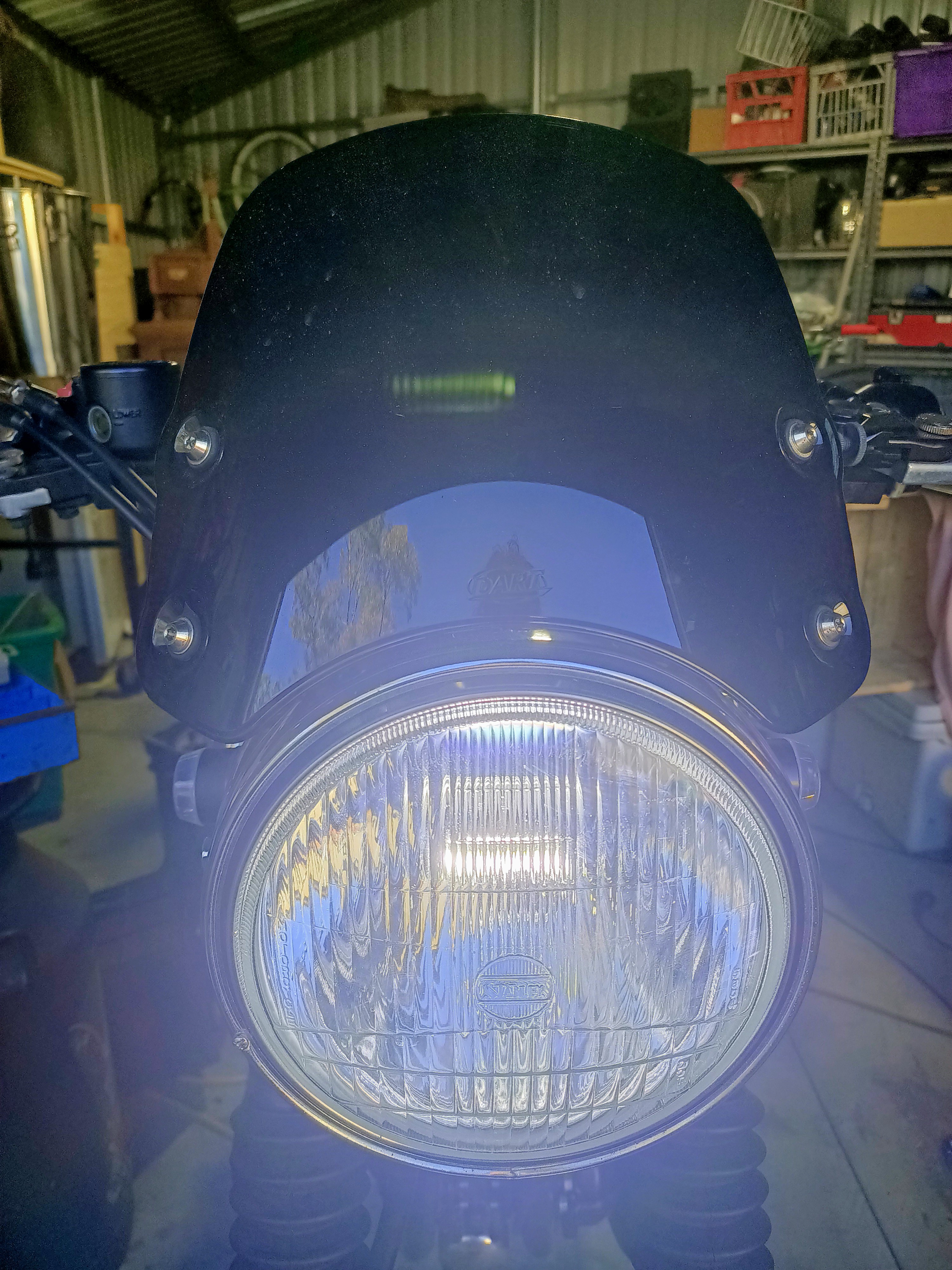

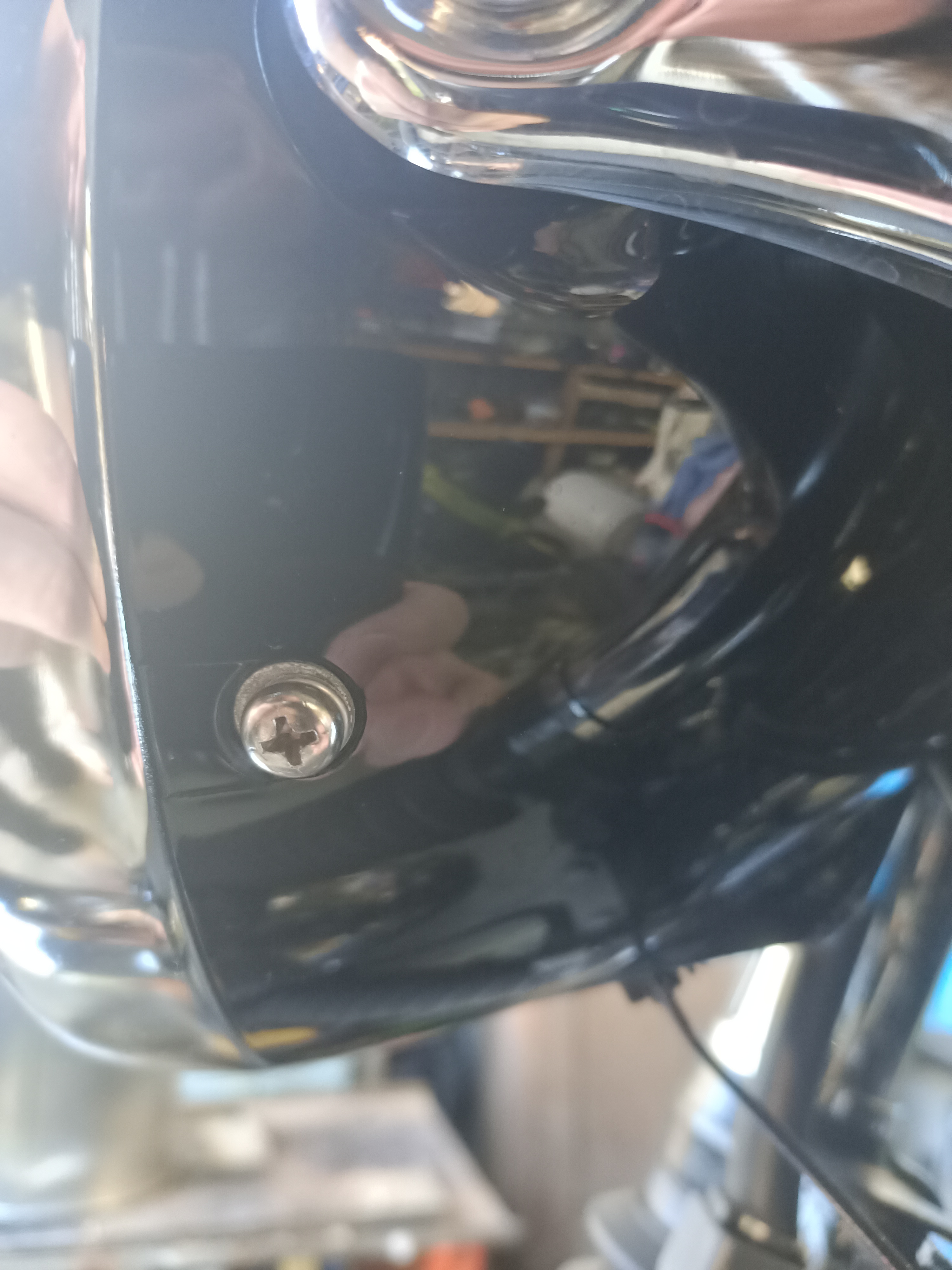

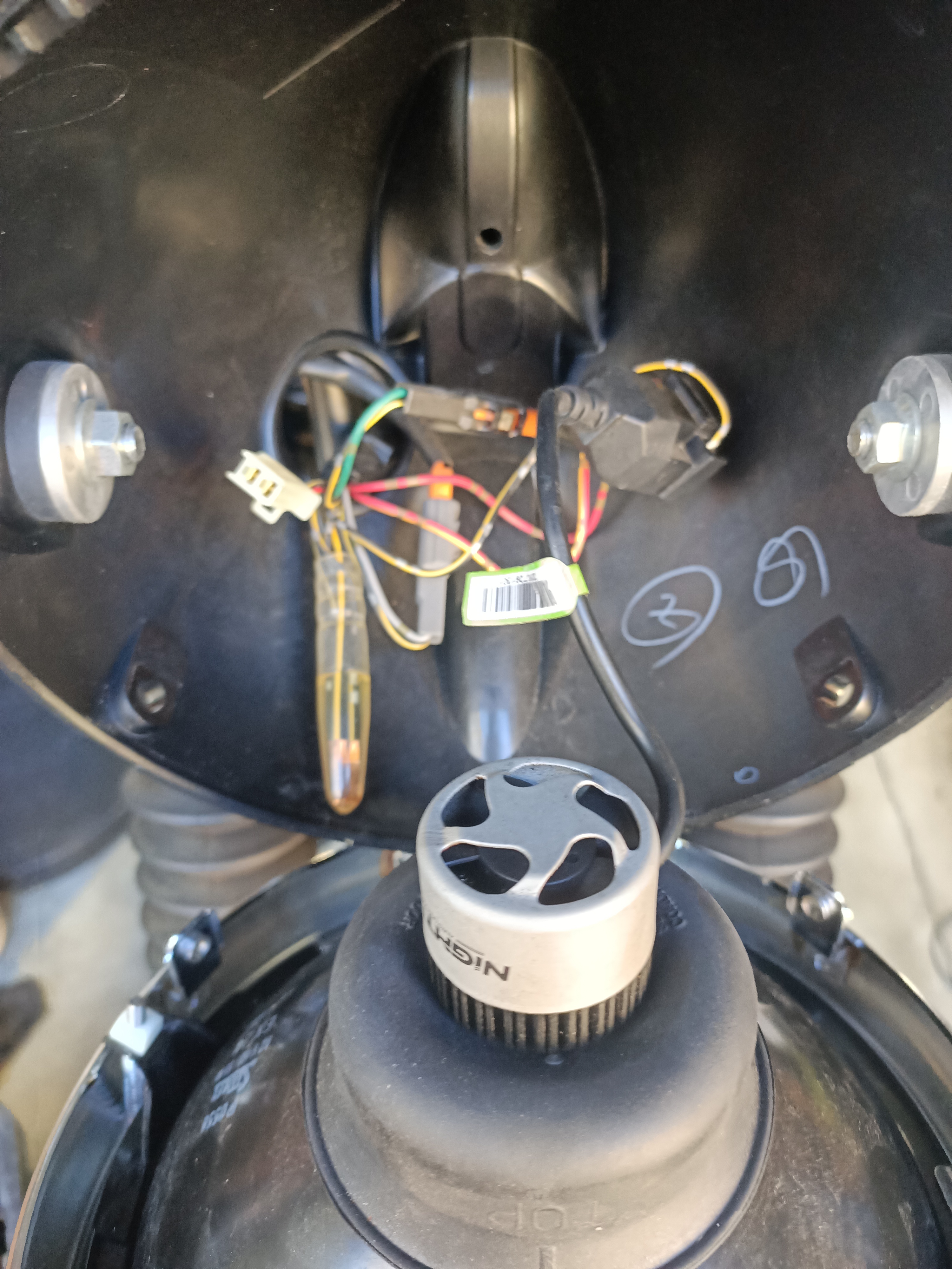

Changed the original headlight out for an LED unit today. No problem squeezing it into the near empty headlight bucket.
Here is a quick rundown for anyone without the knowledge.
Locate screws on each side of headlight bucket and remove. One on each side towards the bottom.
Do not remove the screw in the headlight ring, this adjusts the angle of the reflector.
Remove the reflector assembly from the bucket. There is a small clip at the top, gently pull the reflector downwards to unclip.
Remove the plug from original light, remove the dust boot and remove light from the socket.
Install new LED light bracket, reinstall the dust boot and install the light into the bracket.
Plug the new LED harness into the old h4 plug.
Reinstall reflector assembly.
Reinstall the two screws on the headlight bucket.
Enjoy increased visibility.

Nice write-up! I drooled over an 800 last week at our local dealer while dropping off bike show flyers. Really the only thing they had that attracted me. I wish my GL1000s had room in the bucket for the LED heat sinks, but I fear they are too shallow. I have a spare and I'm considering making a hole in the back of it. So.... exactly which LED rig are you using?
