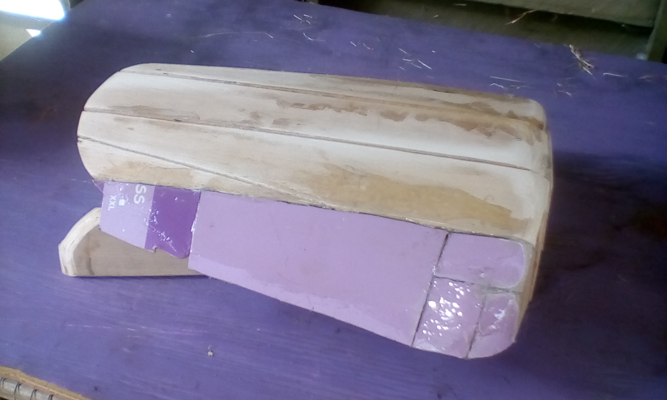

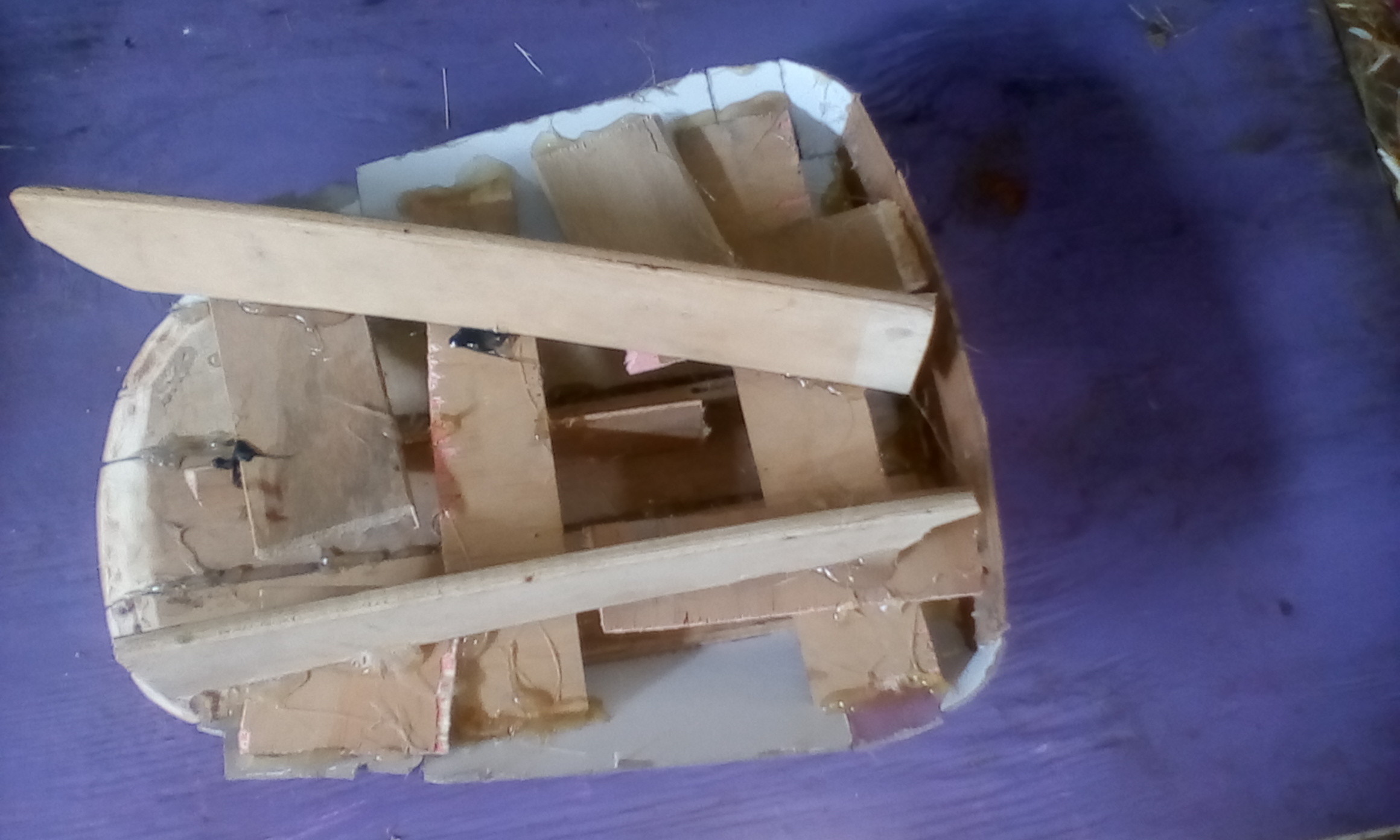

budget sv650 cafe racer
A bit of filling and sanding and it will be ready to pull a mould

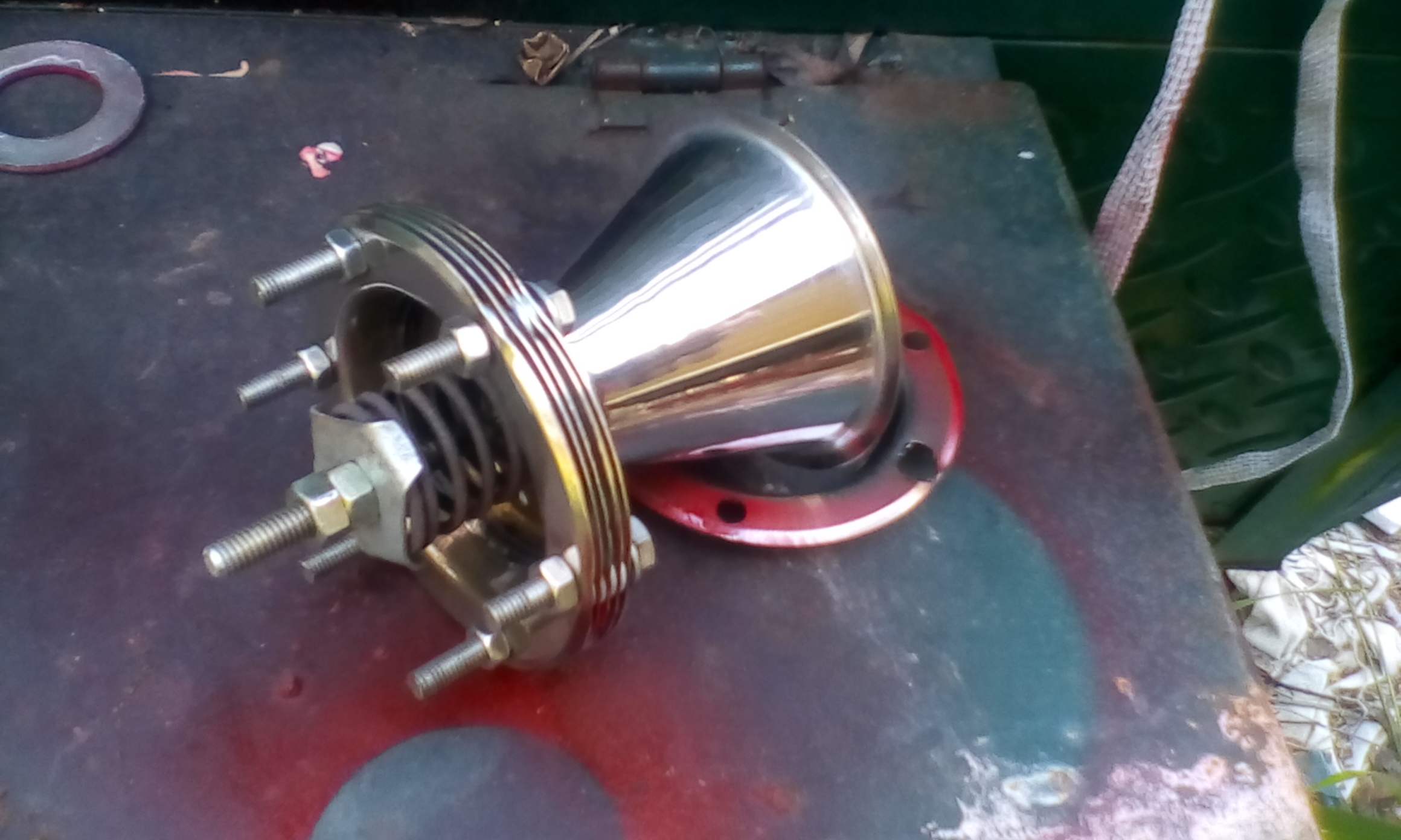

Been bit busy but getting back to the bike. got all the fiberglass stuff last week and today got the muffler baffling to a legal level but now thinking of building a valve and a second stage in the disc assembly to releave backpress over 6000 rpm since the legal test requirement is 4500rpm

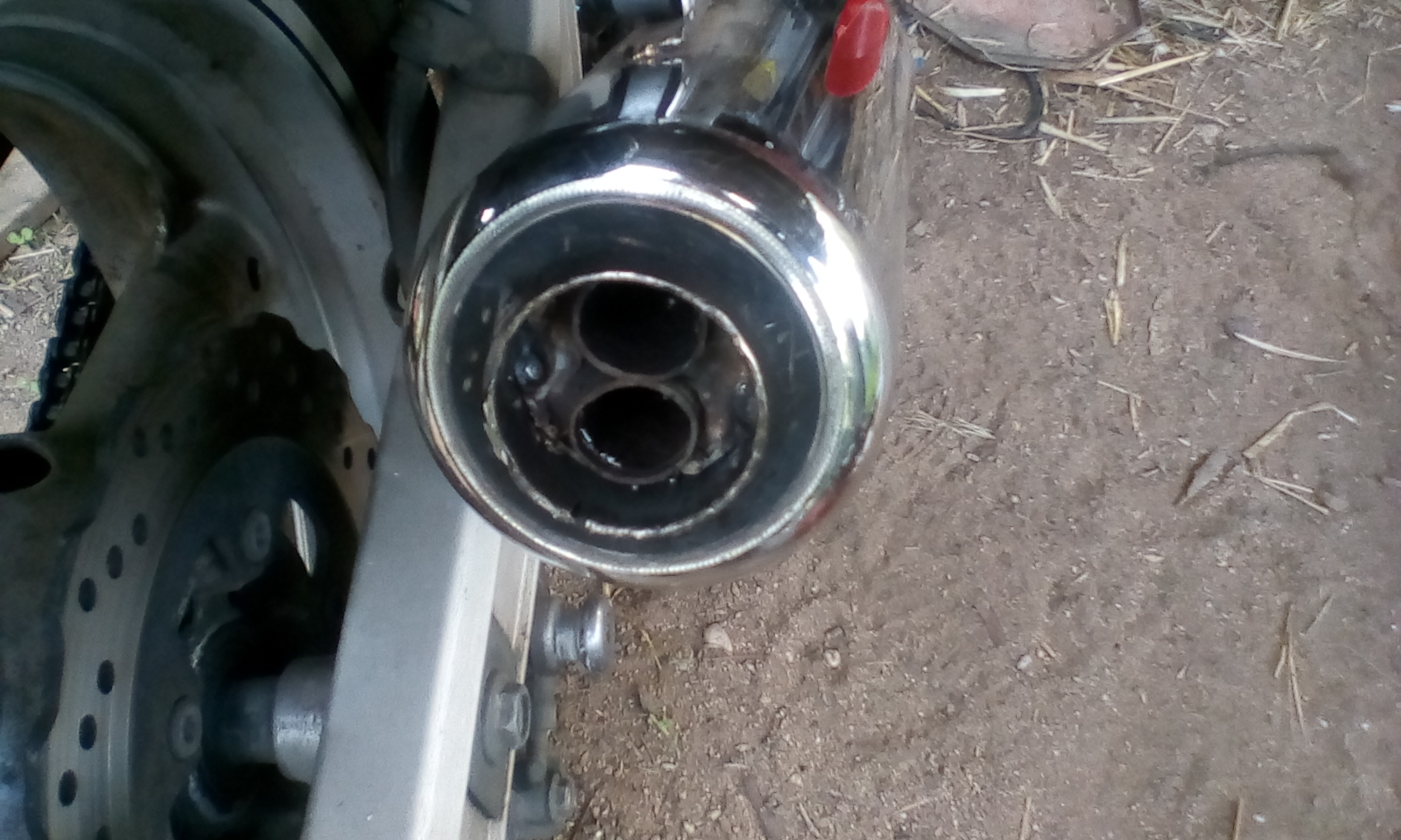

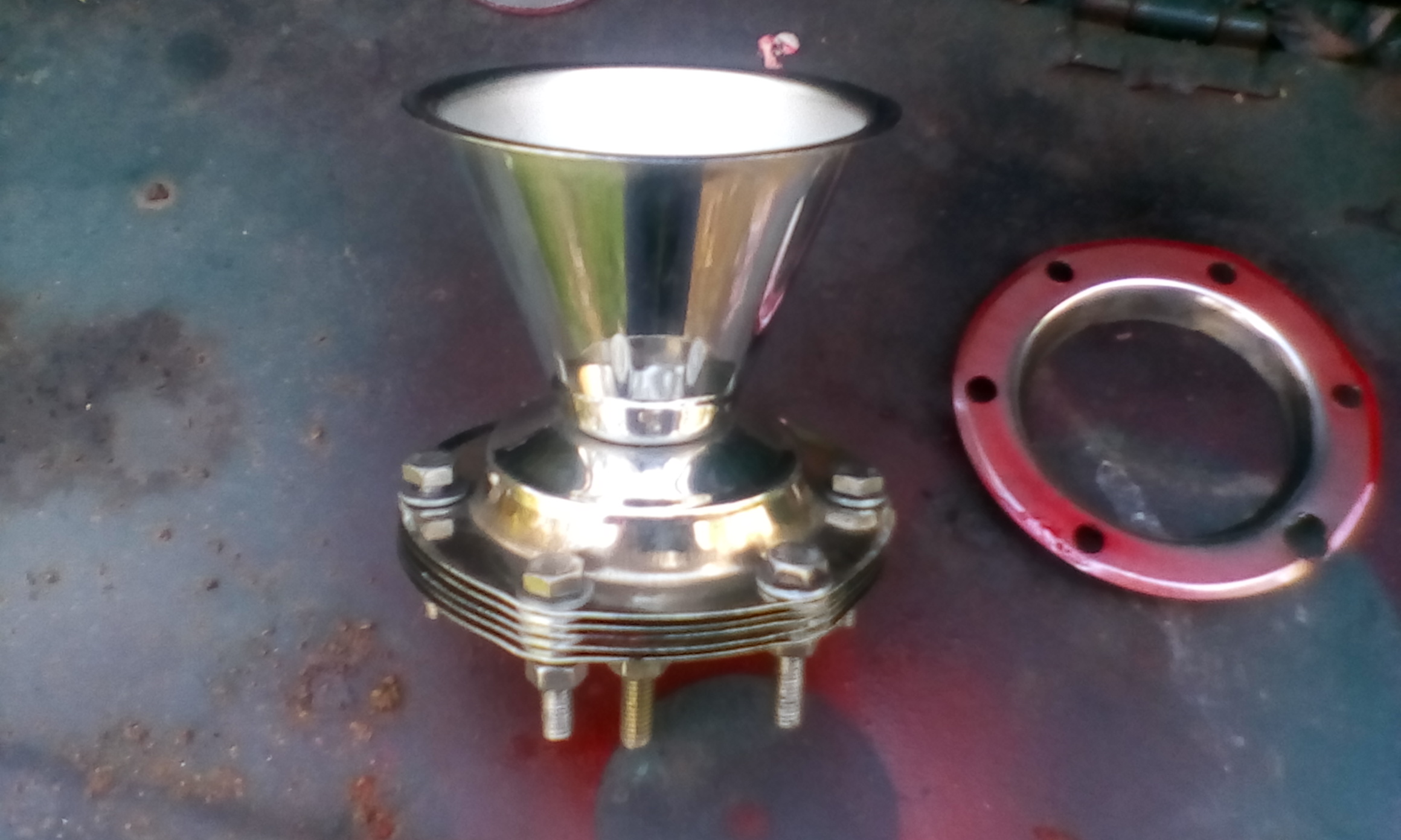

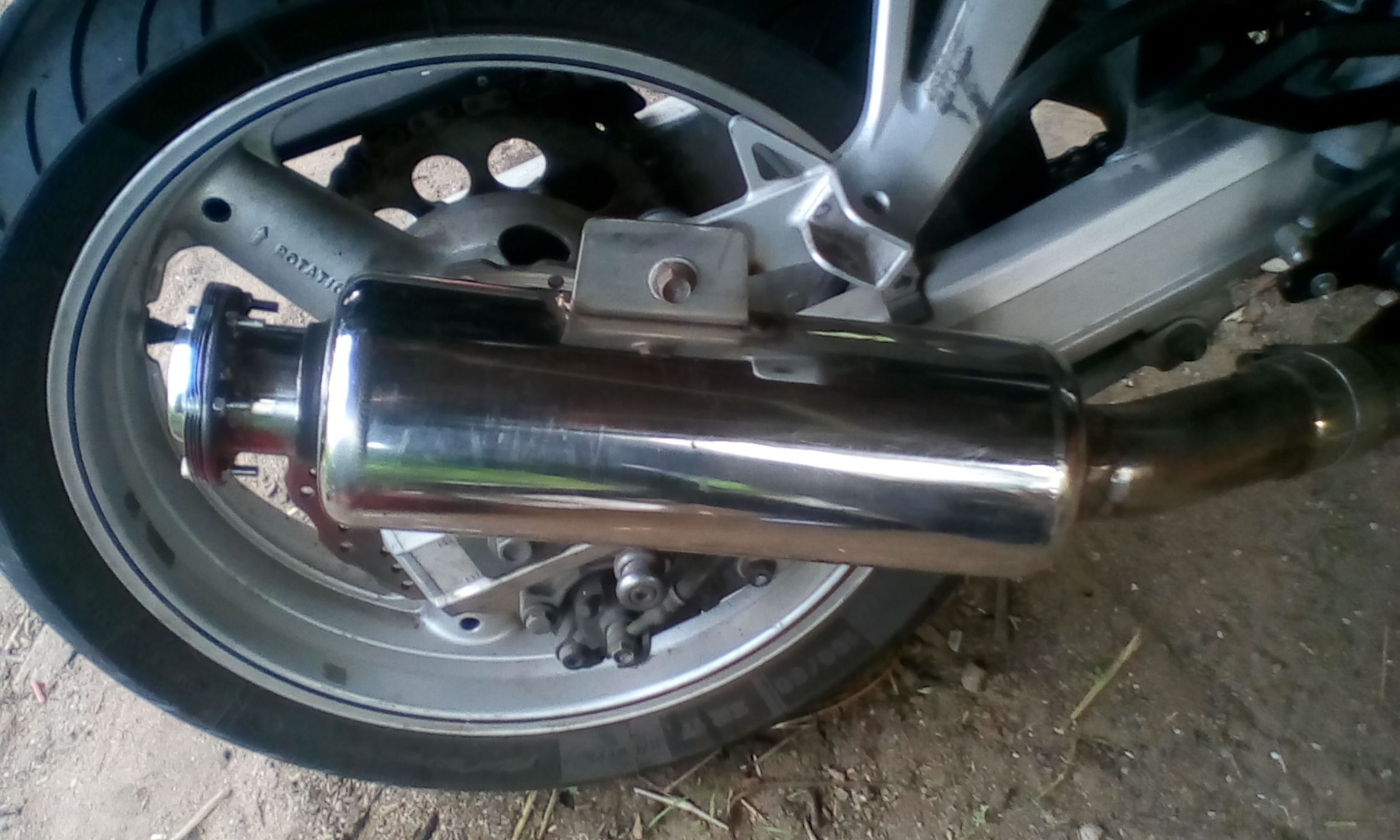

The exhaust is sorted, still needs a tidy up
Current state
basic muffler 14" long, 4" dia, glass packed 2" core
Mod 1, twin 1'pipes with slots and holes with 2" baffle each end and stainless steel wool, inserted and welded in muffler. 107 dba 4500rpm
Mod 2 home made disc type muffler fitted with 4 discs. 93 bda 4500rpm
Mod 3 spring loaded end plate on disc pack which prevents excessive back pressure, opens 6000 rpm free reving no load.
now needs epa label on bike and muffler stamped

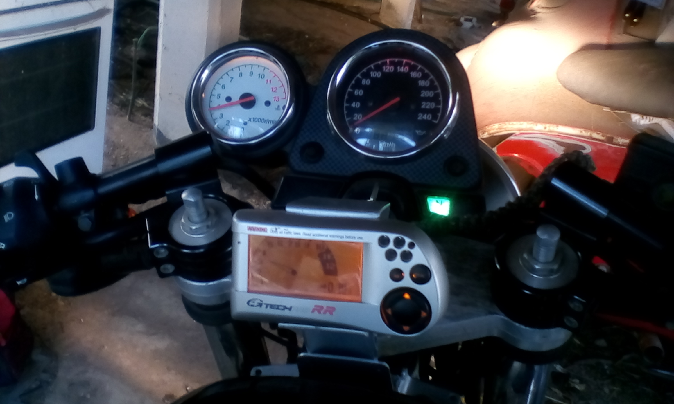

Since I have many mods planned and want to make sure they do what I hope to day I made a braket and mounted my G tech pro RR and calibrated it. All except the weight (not sure how I'm going to weigh the bike?)

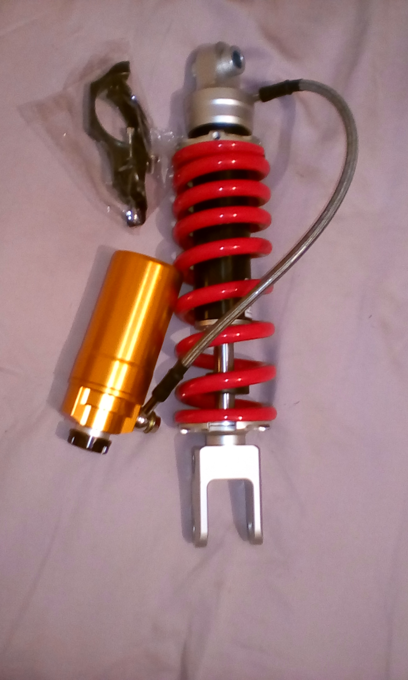

I previously fitted lowering dog bones to my cafe racer project but the shock I bould is 8mm shorter than standard so I put the standard dog bones back in since it will be lower anyway.
I all so took the oppertunity to measure with the rear fully dropped with the lowering links and the standard links. measuring this time it looks like 45mm difference.
Also a good chance to show my stand in use.
Now the old shock is out and scratching my head the best way the fit it as it has 12mm monting holes not 10mm. drill everythine for 12mm bolts or fit spacers in the holes.

Today the rear shock went in, only mods required were some alloy tubing to use 10mm bolts with the shock (designed for 12mm) and the bottom fork of the shock required a longer bolt and a nut (the original used a thread in the fork) this required longer dog bone bolts and spacers on the left side.
Also I had to recess the bottom of the battery tray 5mm.
Tomorrow I will set it up and hopfully the spring rate will be in the ball park. a quick check looked promissing 20mm static sag and 55mm total before doing any adjustments.
Better than the oem 5mm static and 55mm total was the best ajustment I could get (i don't like runing less than 5mm static)
Then there's the rebound and compression rate to do.

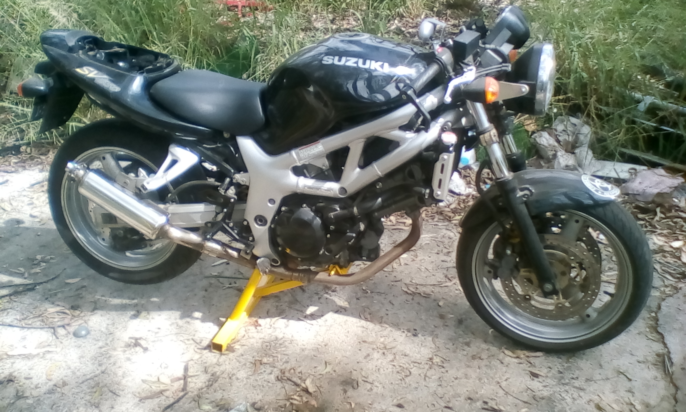

Been a while but I have been enjoying riding a bit rather than working on the sv650.
all seemed good till the other day when my lithium ion battery arrived and after checking charge voltage with the old battery still in place (14.5v ). I decided it was all go for the the new battery, which I fitted with the spacer blocks provided.
Next morning cold started well second go with some choke. By the time I got to the street the tacho stopped working, then about a km down the road the bike stopped.
It blew the tacho, cdi, head light, and the new battery, all I can think is the rectifer regulator died taking the rest with it.
So I contacted the battery supplier who implied I had a faulty regulator all along but I think I was bad luck.
The battery supplier has offered a good deal on a replacement but I a am a bit gun shy now
What do others think try again?
I got a cdi for gumtree and ebay RR on order.
while need to wait for money for the rest hopefully nothing else blew.

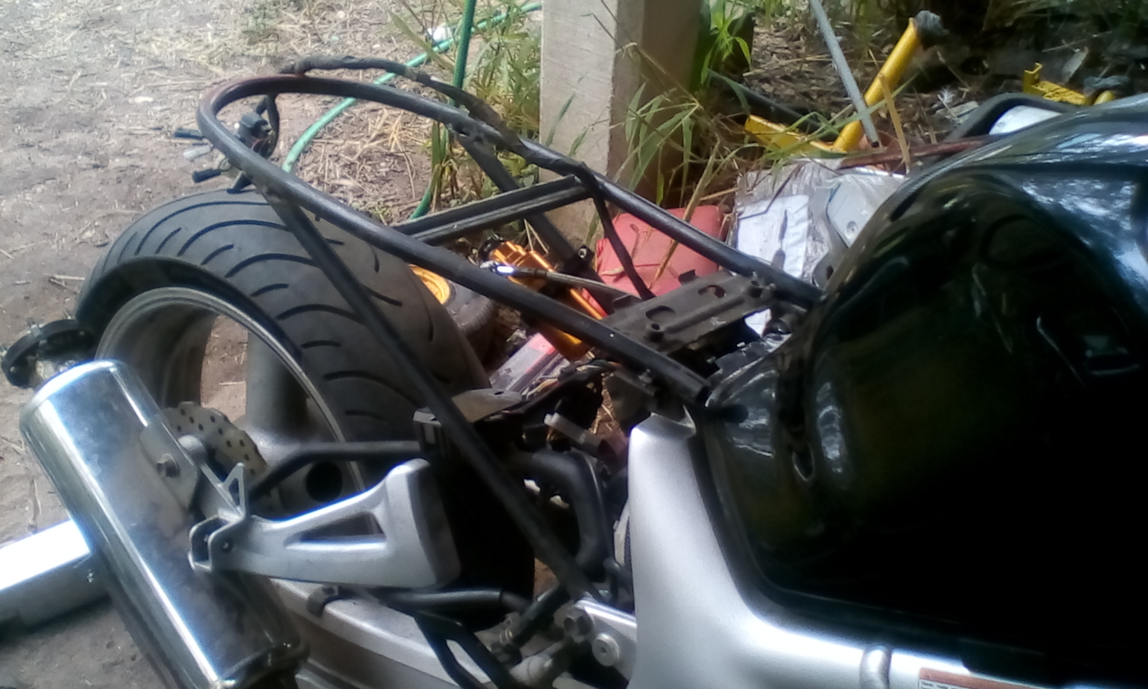

In the mean time since I can't ride I have started the hump seat conversion.

sv650 not running but looking more the part.
Painted the seat frame silver rattle can to see how it looks. what do you guys think?
Mounted the tail light and blu tacked checked paper to see how that looked from the side, and over all I think its a go, the plan is checkers down the centre of the guards and tank as well and thats it.
Nothing says cafe racer like checks.
I recieved the REG/REC today so tommorrow I will make the electrical tray mount the parts and start shortening and hiding the wiring.

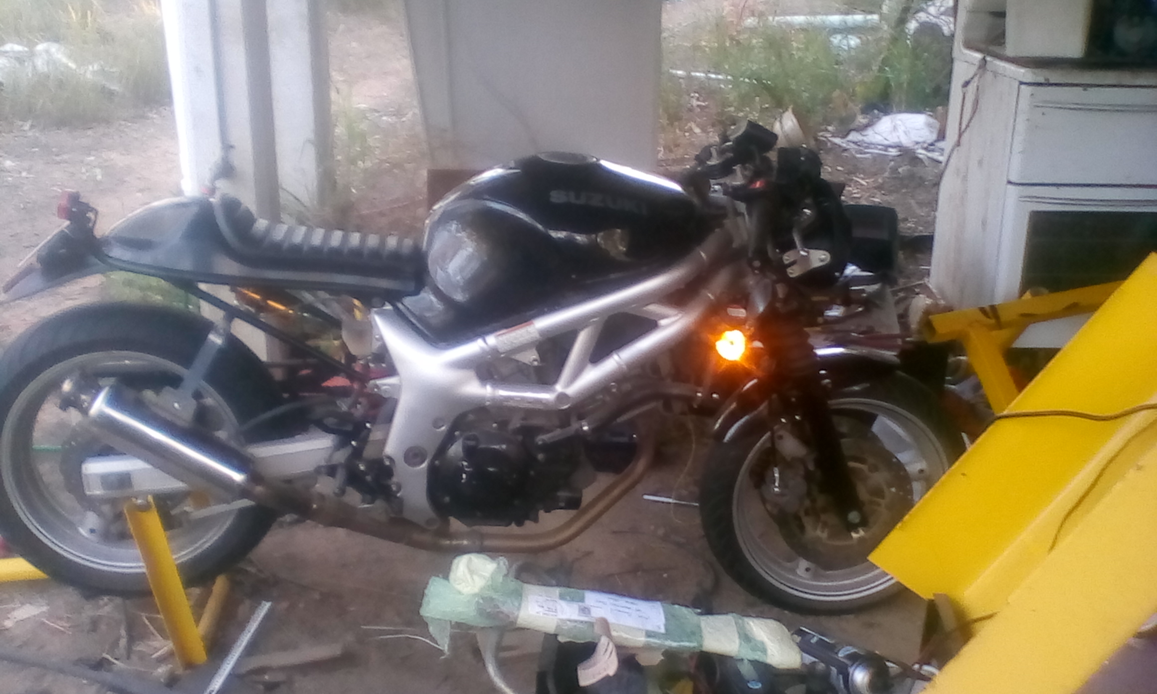

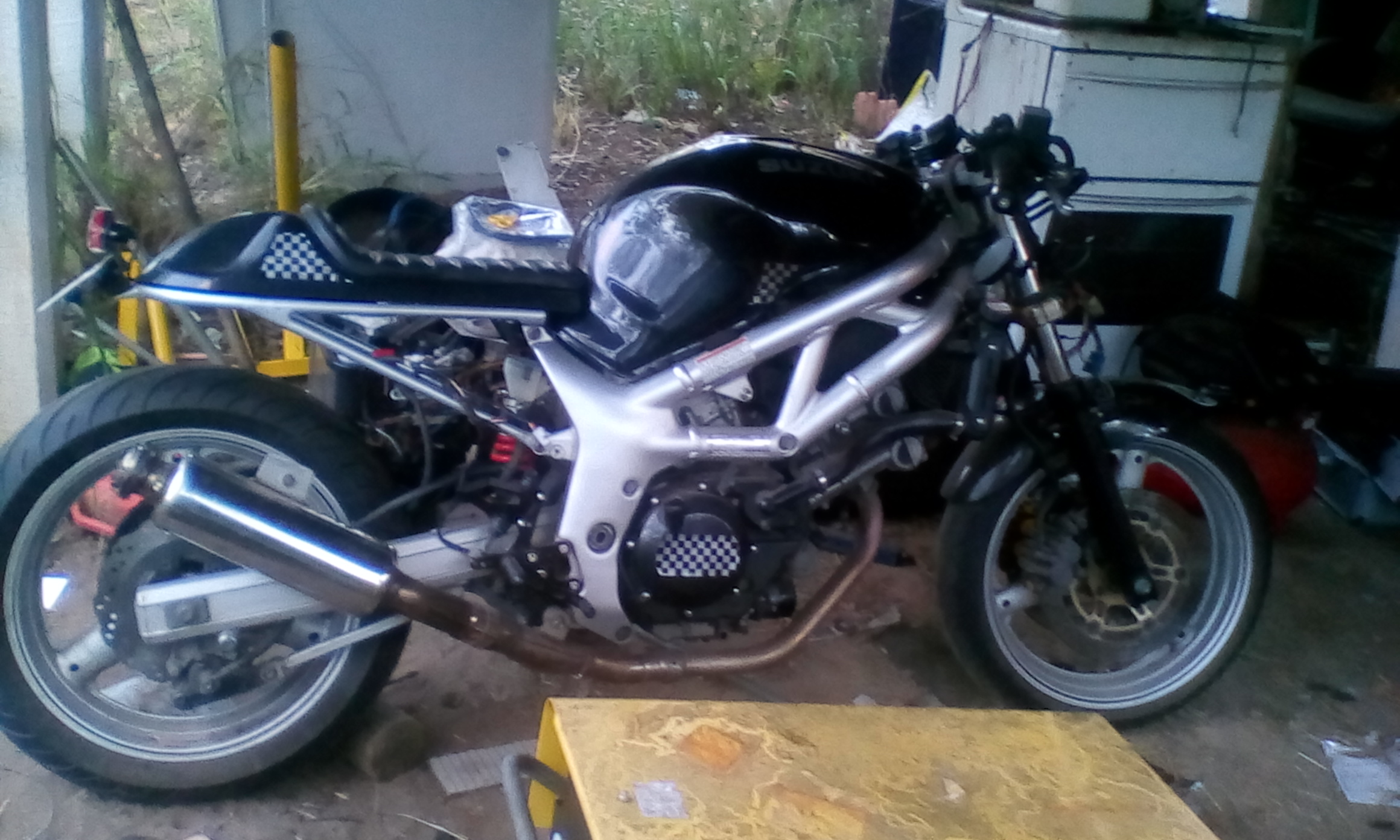

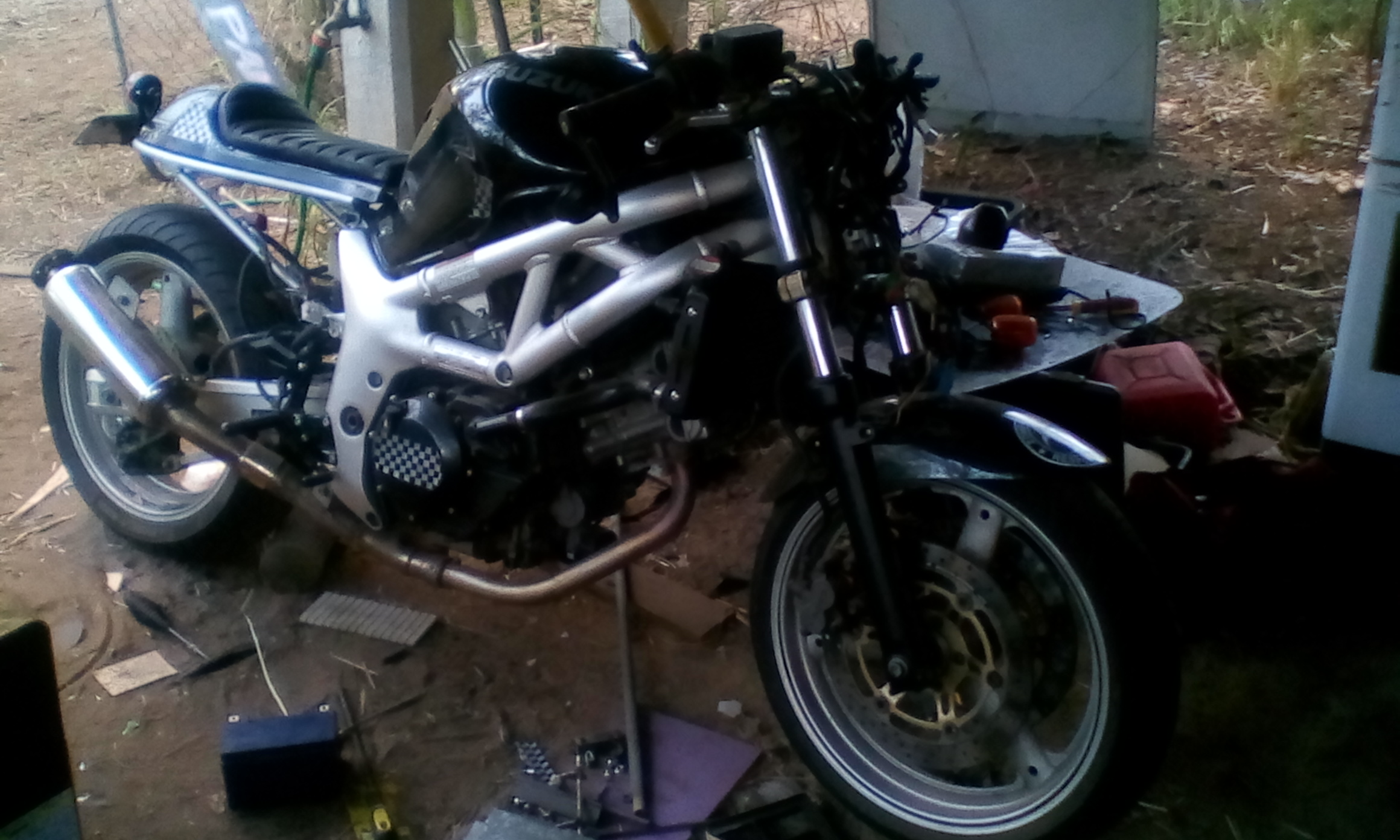

All running but I keep scatching the rear subframe so out of frustration I painted it black and will end up painting the whole frame black.
The electrics are all done (bar putting the fuel sender in the tank for the gauge) I will post some better pics soon but here is the latest pictures.
Any comments or thoughts are very welcome. I am finding it really hard to stand back and see it as a whole.

I love SVs. I had one and it was a ton of fun. Cool stuff going on here.
There's some nice work gone into this...good outcome fella :)
