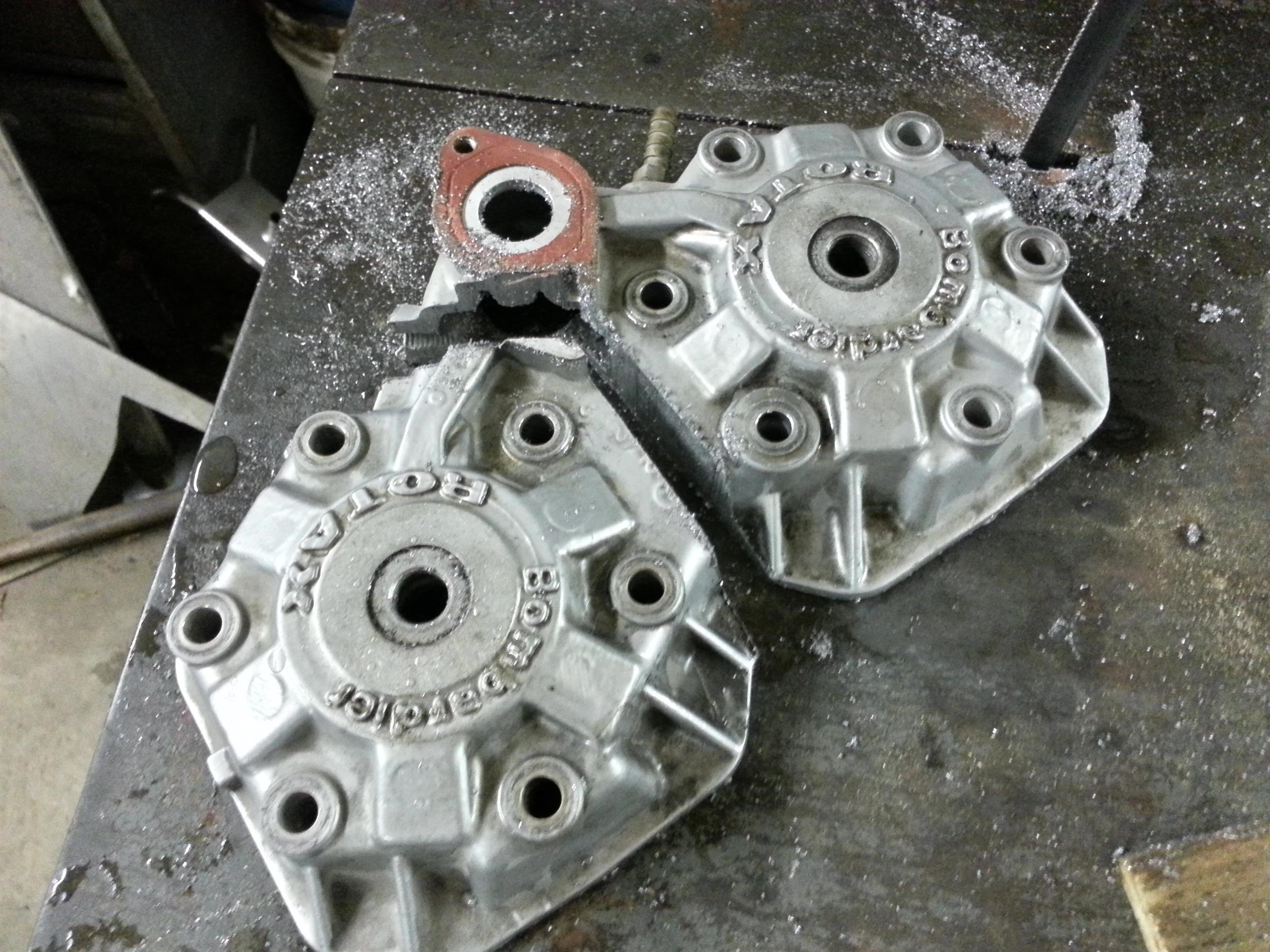

My dad and I finished up a project engine for an ATC250R about 2 years ago, and ever since that was completed I've been kind of day-dreaming about building a 2wheeler to put this custom power plant in we built. It started life as scrap ATC250R engine cases. I procured a Skidoo Summit 800 cylinder and head, and long story short basically welded/machined/hacked those parts to make myself a 410cc counter balanced 6 speed 2 stroke engine (with custom pipe...)

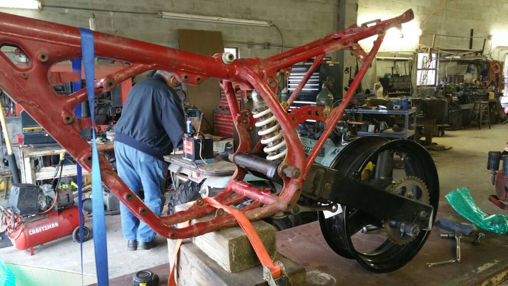

Small little update - over the weekend I worked in the shop and did some clean up and organizing since its been 2+ years since I had a real project in there. Degreased and pressure washed the frame, got it up on the work table, rolled the SV650 rear end into place. Whacked off the bottom linkage tabs of the frame. Swingarm fits width wise in the frame very nicely - minimal bushing required. Will need to reduce down to a 15mm swing-arm pivot bolt (same as frame).
The biggest challenge I had not really noticed before is that the SV650 rear shock and linkage is offset to the left, which is terrible for my carburetor and air filter clearance. Especially with the big motor I made, I barely stuffed it all in there with a center mount shock, and it should have really been offset to the right. I suppose the SV is offset to the left to make room for the exhaust collector in that region on the bike. I'm currently leaning towards just welding a new mount onto the swingarm and going linkageless with another shock. Utilizing that stuff is going to be pretty tricky with the frame placement.
I'm waiting on a 520 conversion rear sprocket for the SV back wheel, and then I'm gonna set my motor in and see what I need to do on my chain alignment before I make any other decisions with the shock/linkage scenario. I'd like to keep the linkage and stuff if I can, but its in a terrible terrible place.

A few mock up photos for your viewing pleasures.
