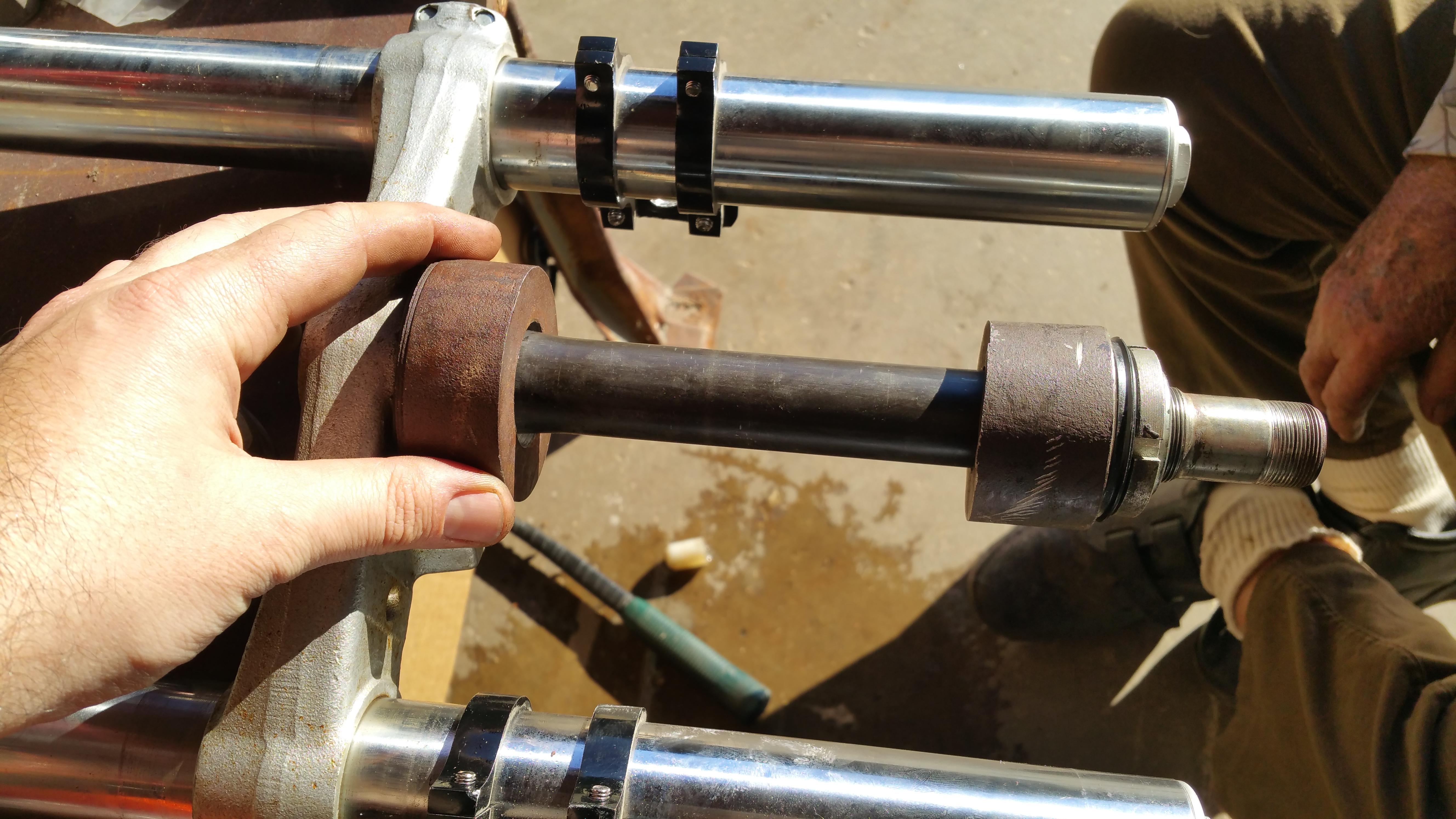

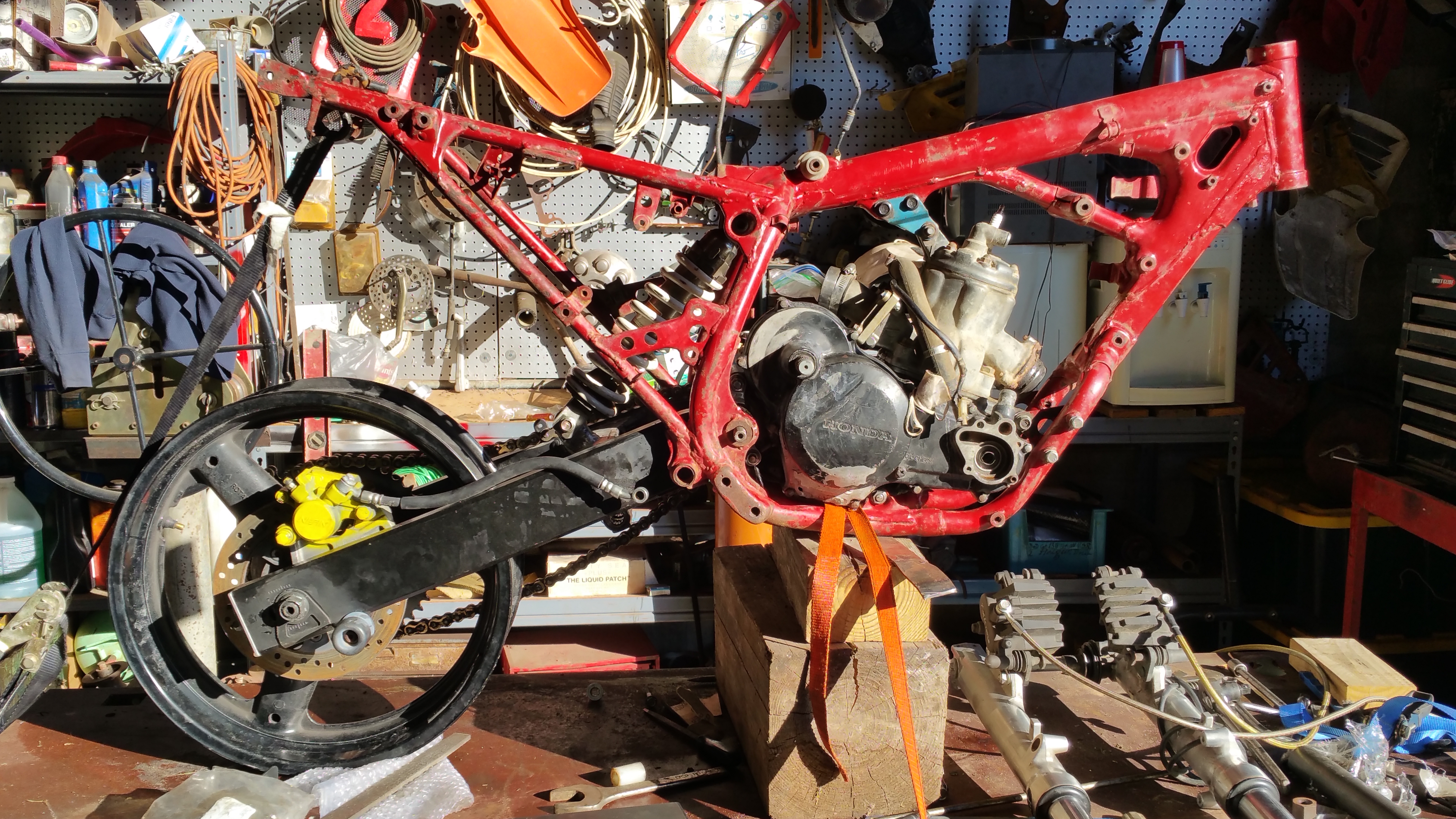

So here is how it sits now with the rear suspension final welded, completed pivot bushing/bearing swaps, motor mounts and engine all in, etc. etc.
Also some humble beginnings on our new steering neck tube and bearing holders. Those chunks of iron are already machined internally for the tapered bearing races, and the tapered bearings are fit in there. Measurements look like a piece of tubing about 4.750 long will go in between those and be welded to each end to form my new steering neck. Will be slightly longer to allow for bearing tensioning. Going for 2" OD, .180 wall chromoly for material. Those heavy pieces will have shoulders machine onto them to fit the 2in tubing so we have a nice precision fit. Most likely will use the tensioner nut you see there in the one picture to squeeze everything together and hold it square when I go to weld everything together at finality.

Step away from the bike and no one will get hurt....
That surely isn't the swingarm droop angle you plan to run , is it? Presumably, it's just how the bike was sitting when the picture was taken. Ideally you are looking for somewhere in the 8 - 10 degrees of droop. What would the seat height be with the swingarm the way it is? 34" or more I would guess.
Re: Building my own two-stroke "Mongrel" - Inspired by CharlieT & TedT
That's full extension with no weight on it so yes it is pretty aggressive looking angle wise. I was hoping for a bit less but with sag it is going to change quite a little.
No idea on seat height yet. Sub frame will be removed and a new one built. It'll be more leveled out and probably lower than that one.

Likely you will find that you won't have any of the geometry even remotely close to being acceptable without getting your frame oriented like it will be when driven. If you think you are that lucky I suggest lottery tickets - much more of a sure thing. It really is not so difficult to determine where and how your frame needs to be positioned:
jpmobius said:
You may wish to consider a bit more than the height of the neck. Rake angle will be all important. Likely starting with the rake used in the original application of the front forks you are using will be a good number, but the wheel diameter will impact this if different from the original. Consider the total suspension travel and resulting percentage sag you will have to determine your ride height. This will create the actual ride height and pitch of the frame which will determine the actual rake angle and height of the neck. Make a stand for the front and rear axles (or fit the wheels) to hold them in the right place. Determine the suspension total travel at both front and back and mechanically hold them compressed 30% (or whatever sag target you like) to get the the forks and frame at the right height and you can mock up the steering neck.
Your swing arm does indeed look to be very low, and you frame looks to be pitched forward quite a lot at least in the pics. Rotating the frame back will make the swingarm angle that much worse. Mechanically, the alignment of the sprockets and swing arm pivot drive much of the design. The three centers should be in alignment at fully loaded sag. Typically you would still have some droop of the awing arm at this point -more if you design to overcome large obstacles like rocks and less if you expect a smoother surface. Take the spring off of your shock and mock up what you have so the sprockets and pivot are aligned and then angle whole works so the arm is how you want it while riding. Your shock will need to be compressed about 30% (or whatever you like for fully loaded sag). I would guess that you will have to relocate your shock mount(s) to get within reasonable range of this condition.
The notion here is that you are not building from scratch so you have to make choices on how to implement the parts you want to use. You have to fabricate rather a lot to get it all together so you want to work around the most difficult things to change so you can leave them alone and build or alter the stuff that is easier. It is easy to get shock mounts in the right place compared to relocating the engine so the kinematics of the chain drive are what they need to be. It will be very difficult to change the relationship between the sprockets and swing arm pivot, so leave that alone and rotate your whole assembly so it is in the right orientation. Make all the other stuff fit that.
Don't forget wheelbase. You want to be somewhere around 58in - 59in, and no more than 60in.

Further back I mentioned you cannot remove the spring from the shock but I made a strut the length of the shock fully extended minus shaft stroke to set and check things.
Perhaps I am under thinking this, but it does not seem like rocket science to me? The entire frames position and geometry is going to be modified once I fit up the front end as that steering neck and everything sitting on the table now has little to do with what it'll be sitting on the ground completed?
I realize i don't want the chain cutting into the arm or an angle abrupt enough to make it squat like a bitch everytime you crack the throttle from it trying to make the swingarm climb.

Thanks! I had looked up the Sv650 wheel base and found it to be 57 inches and intended to be in that neighborhood
