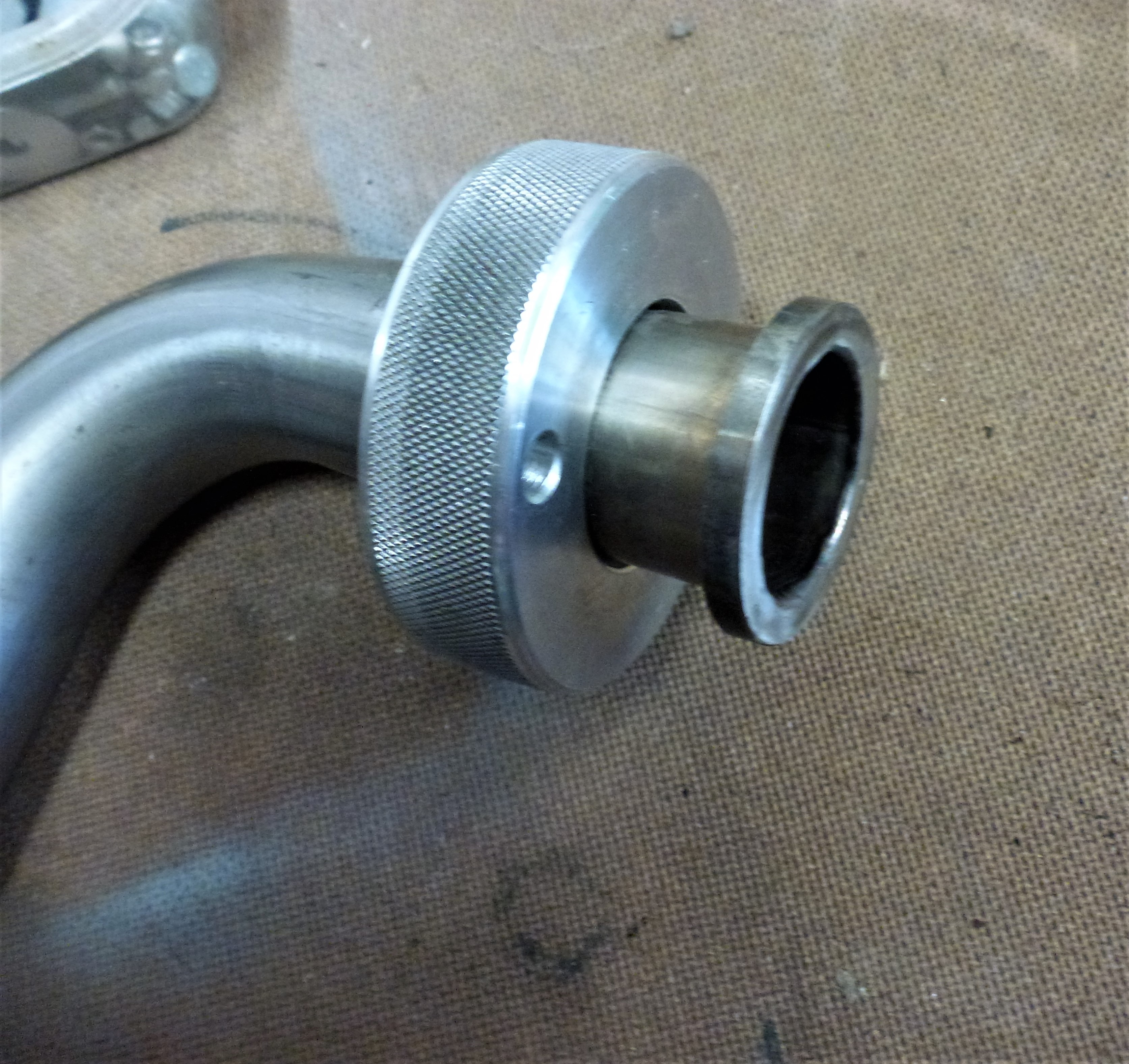

Neil also made up the stainless collars for the headers to the exhaust flanges and is getting them tig welded for me.

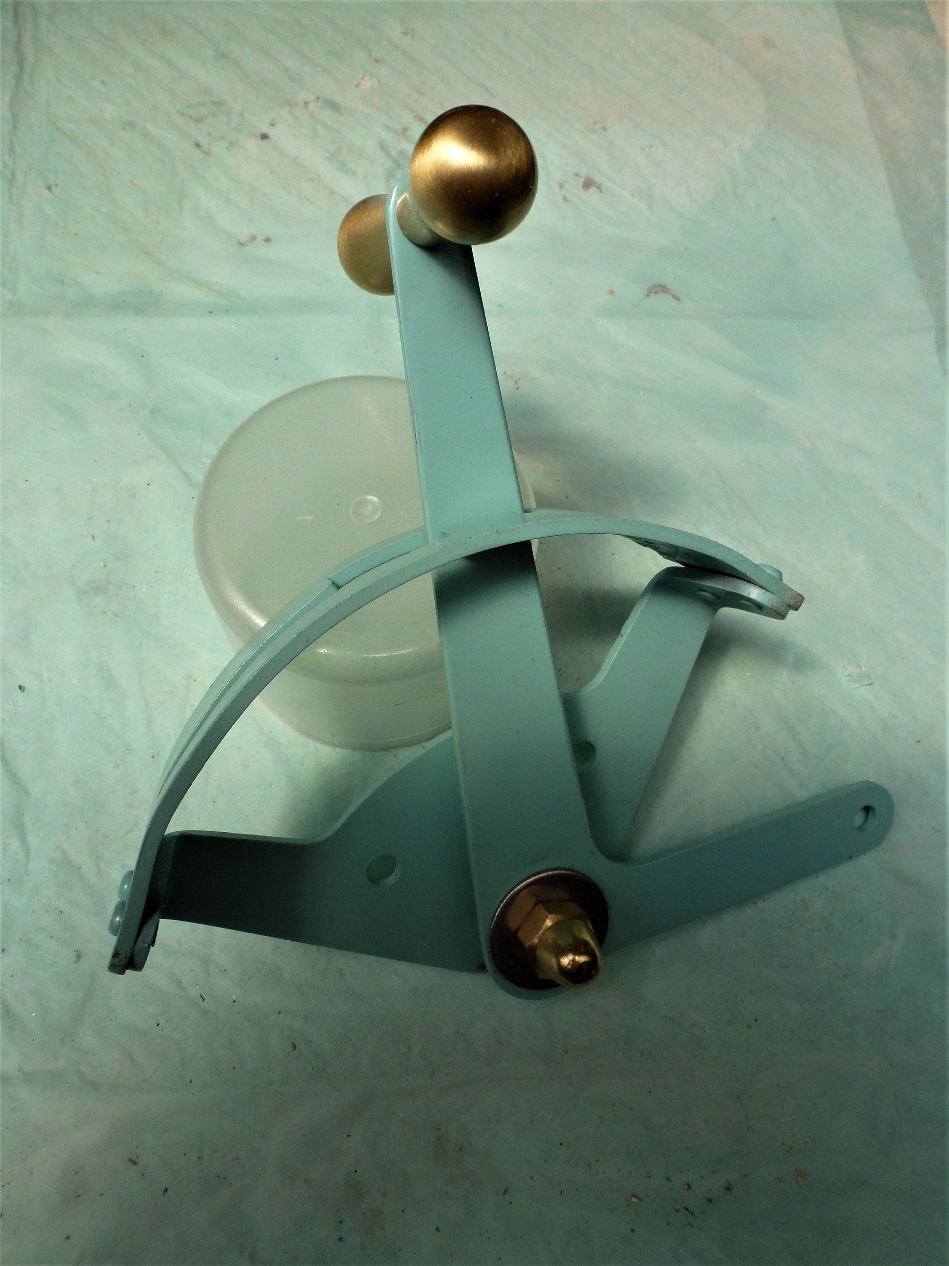

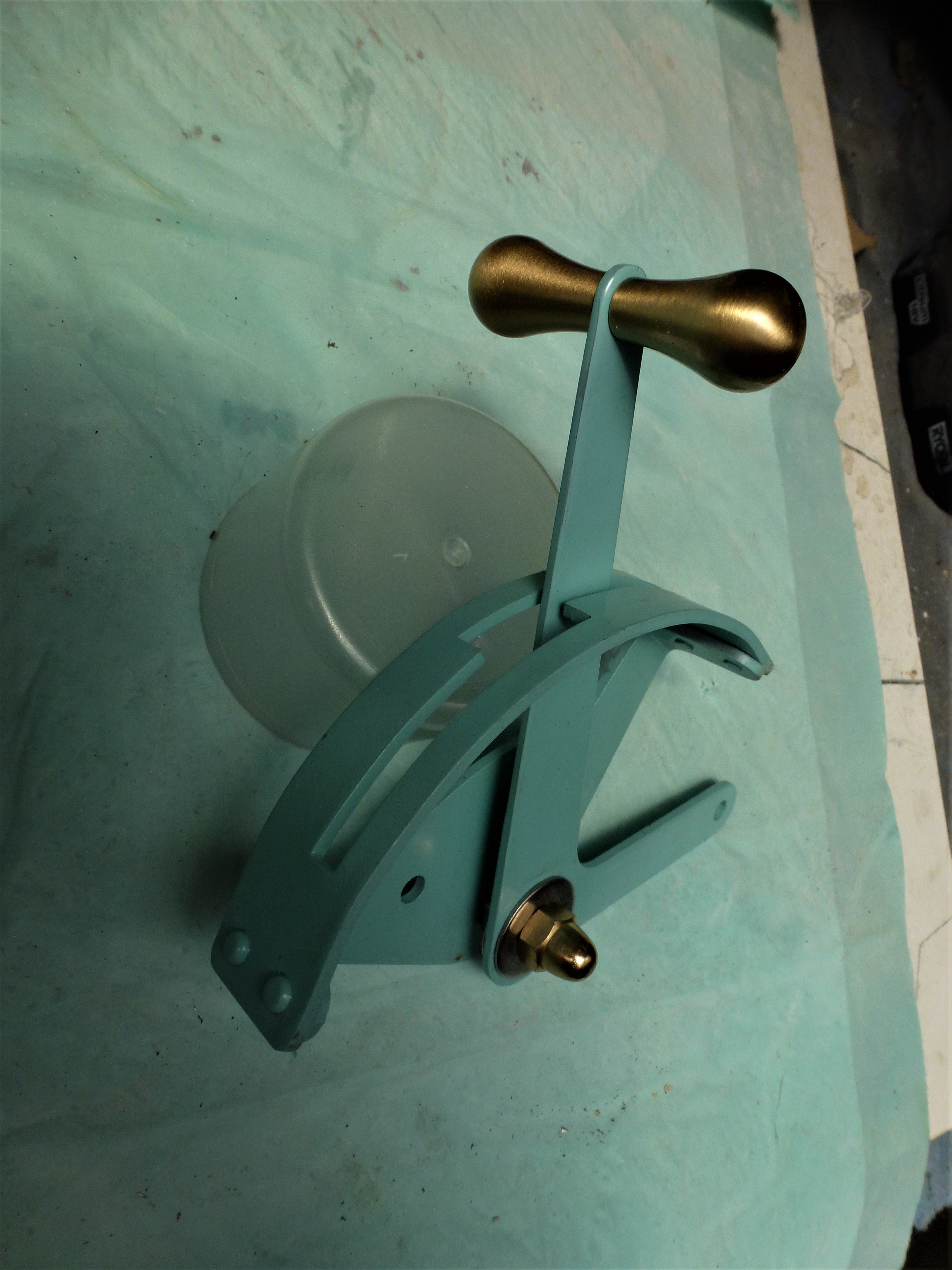

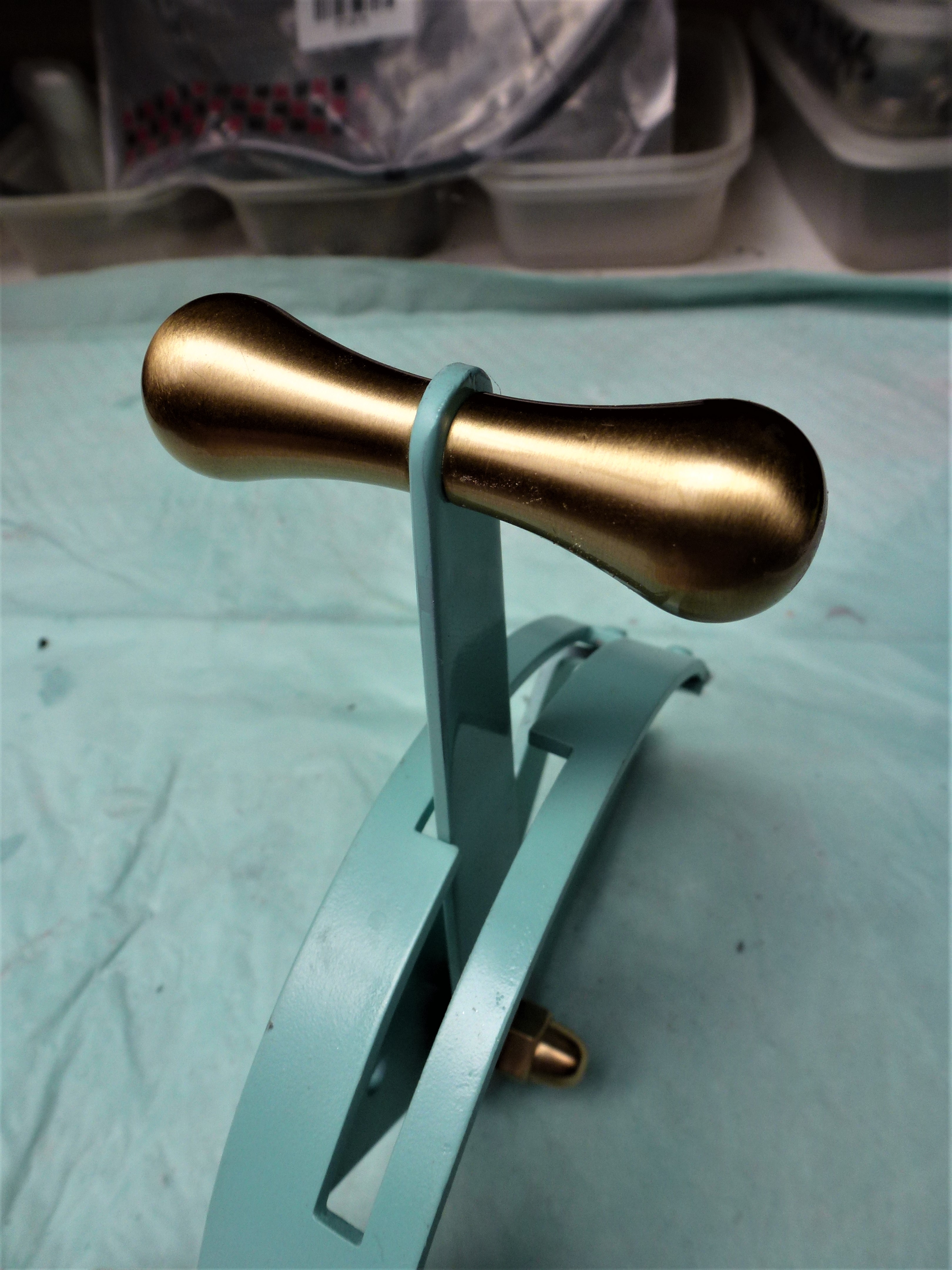

I think my "kitchen cupboard knobs" worked out OK.?

Thanx MT,
they wotrked in my head - but needed to see them in place before I convinced myself ??
I offered up a wooden gear knob [ "Cobra" ! ], but it just looked out of place [ ignore the Cobra bit ]. It really did look like I'd just fitted the first thing I found in my spares stash.

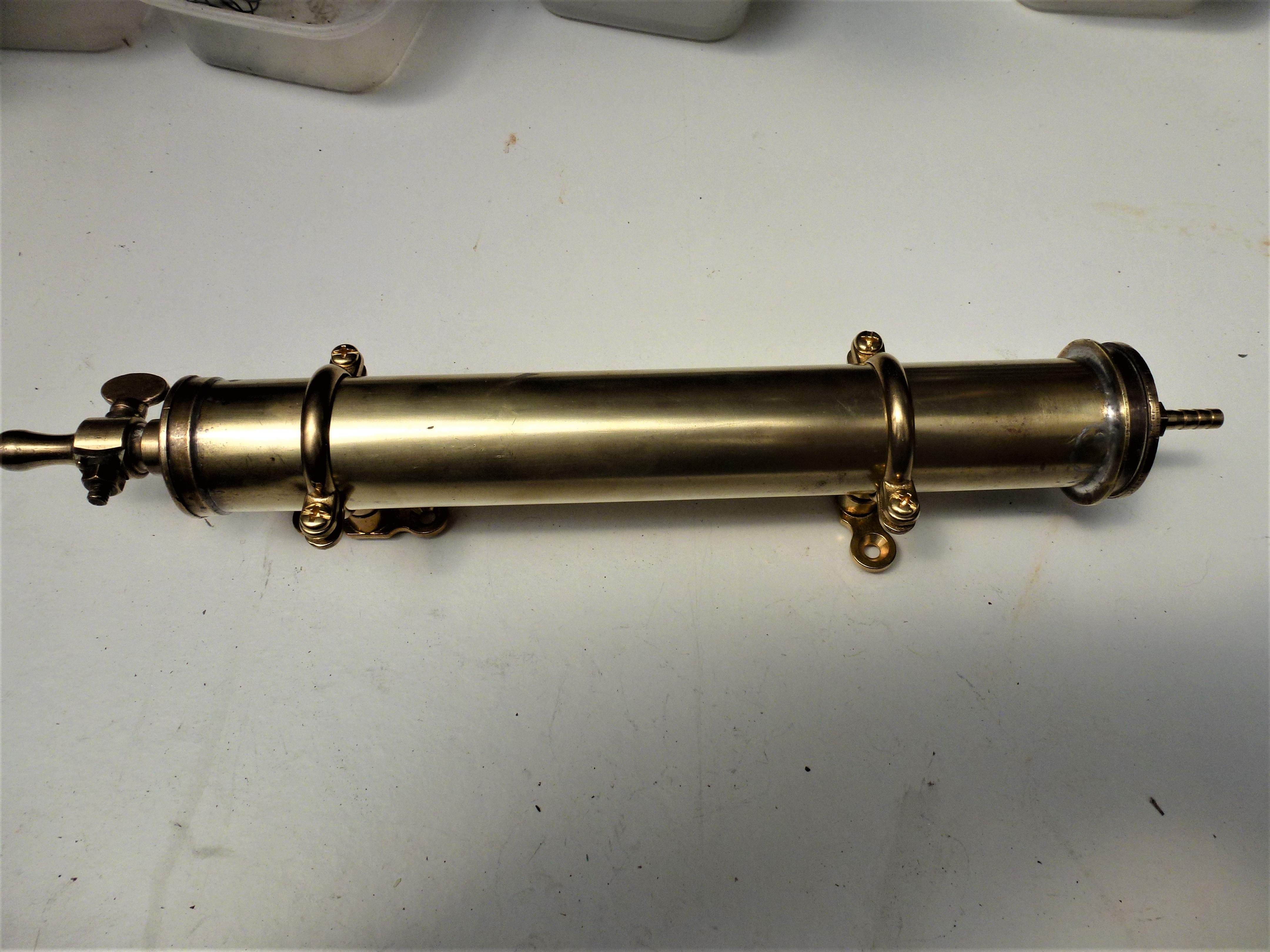

The brass Munsen clamps arrived to attach the fuel log to the frame. Perfect fit, even though they are metric !
SU has been stripped. cleaned and loosely re-assembled. I think just a light polish .

He's also completed the exhaust collars / retainers - all spot on.

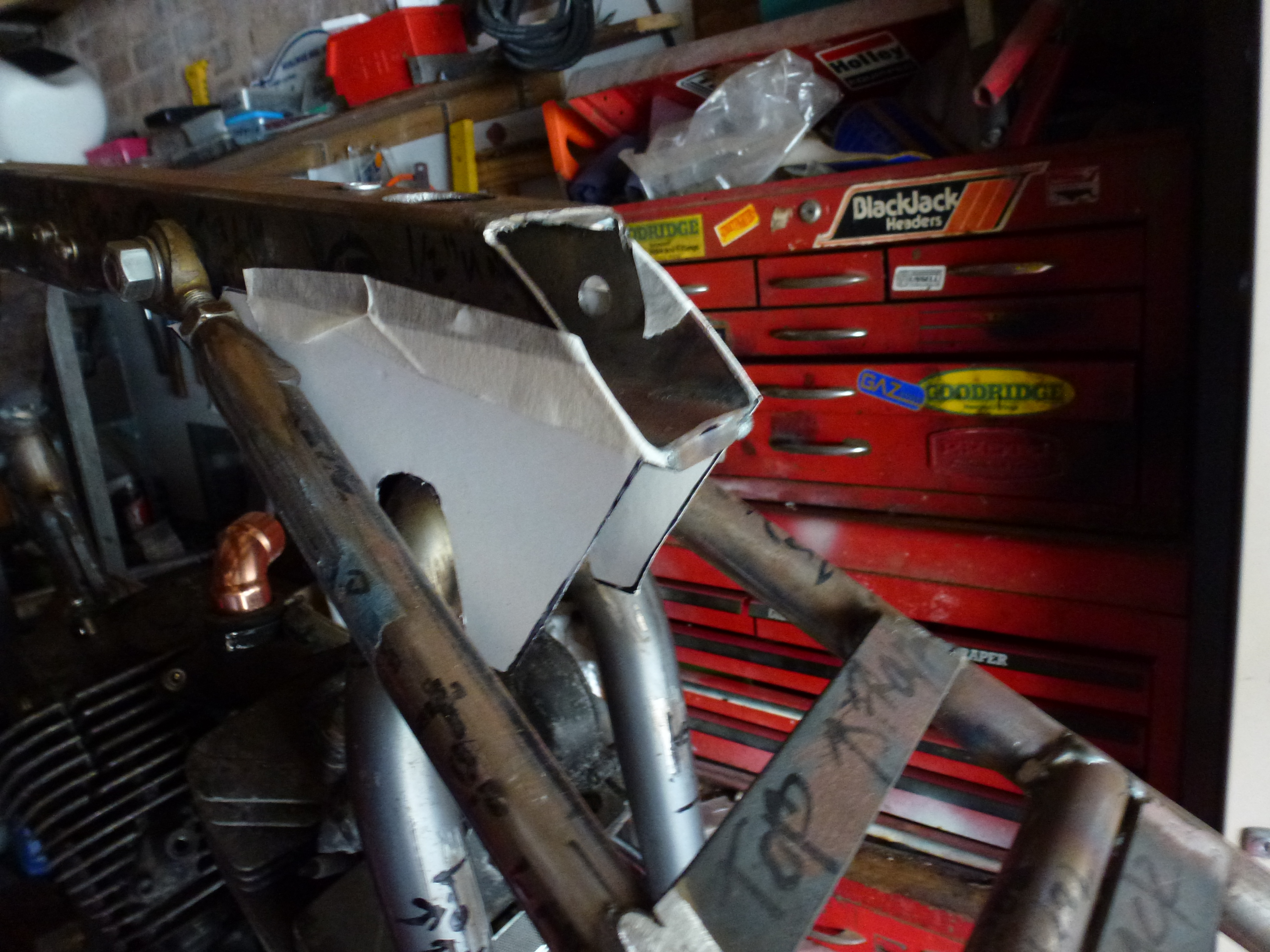

Once I got the frame back on the bench and chance to have a good look. I wasn't happy with the rear to top frame junction - had become very messy.
So, the CAD came into play and I contrived this enclosure which I'm more than happy with - looks as if it was originally planned !!
Additionally gives me somewhere to mount the saddle mini coil over damper and maybe some other squitter.

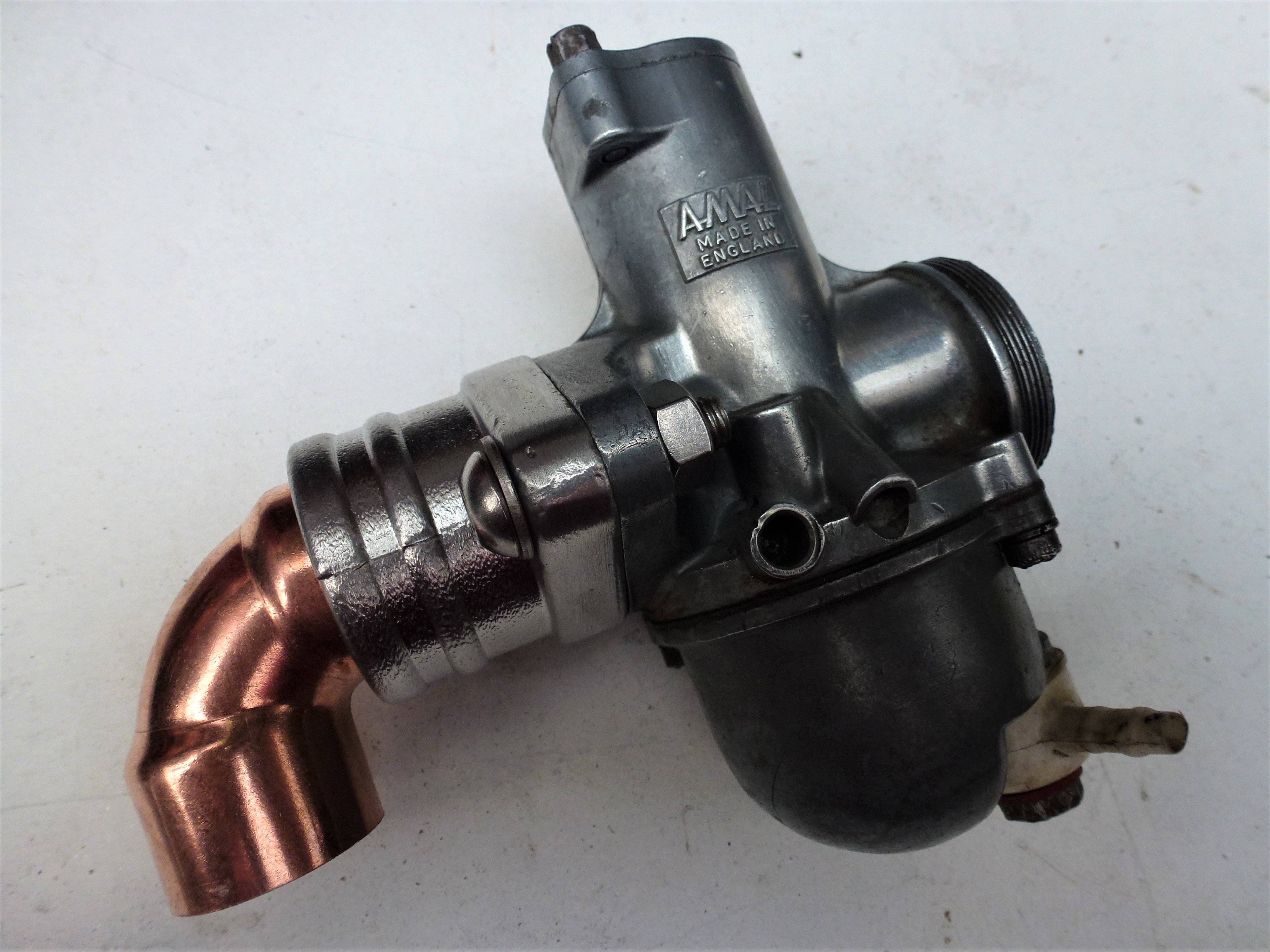

The Amal Concentric [ 22mm ] has arrived [ one of two ] and I found a brand new Triumph Trophy twin carb stub that I can mod onto another copper [ plumbing ] bend to make up the manifold fitting for the Virago "Y" intake.
I'll use my favourite JB Bond resin putty to attach the copper bend to the Trophy intake stub.

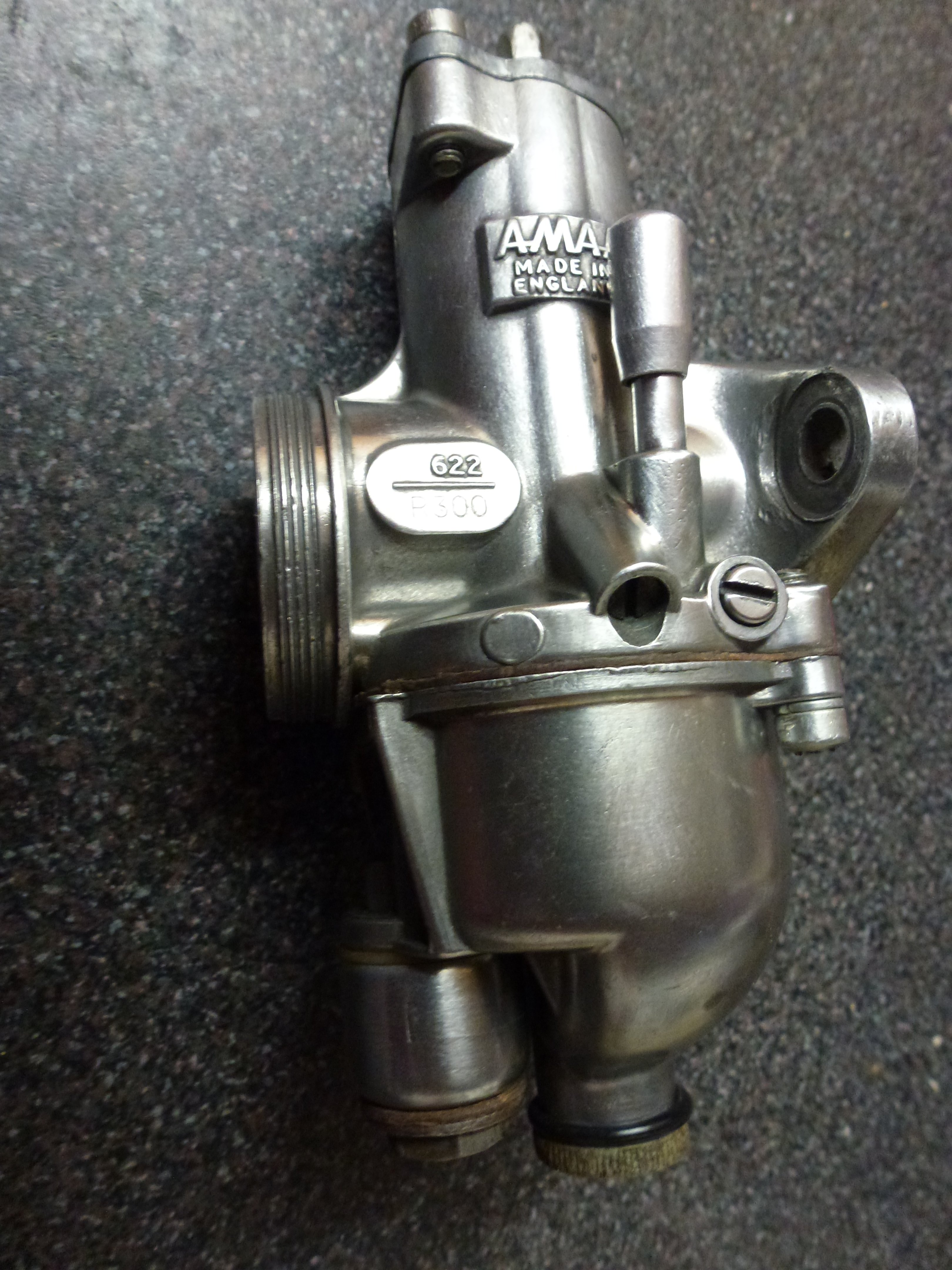

The Concentric is much simpler to set up than the SU and parts [ jets, slides, needles etc. ] are a quarter of the price of SU bits - plus readily available secondhand.
Because the 622 body series is not as popular [ or expensive ] as the 900 series they are much cheaper - I just bought two complete and in good condition for £40. Virtually all parts are available from the continuation Amal company in the UK.

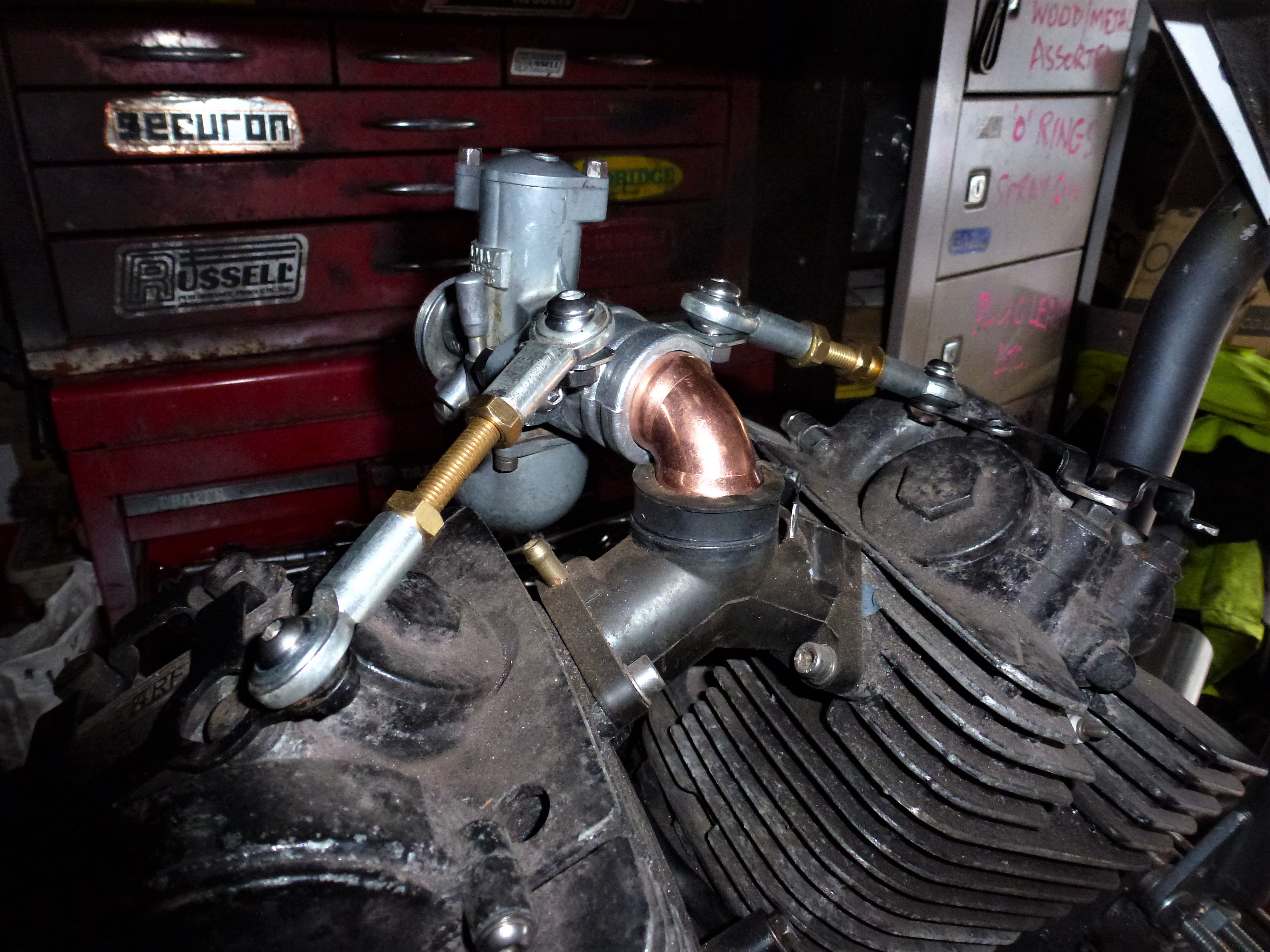

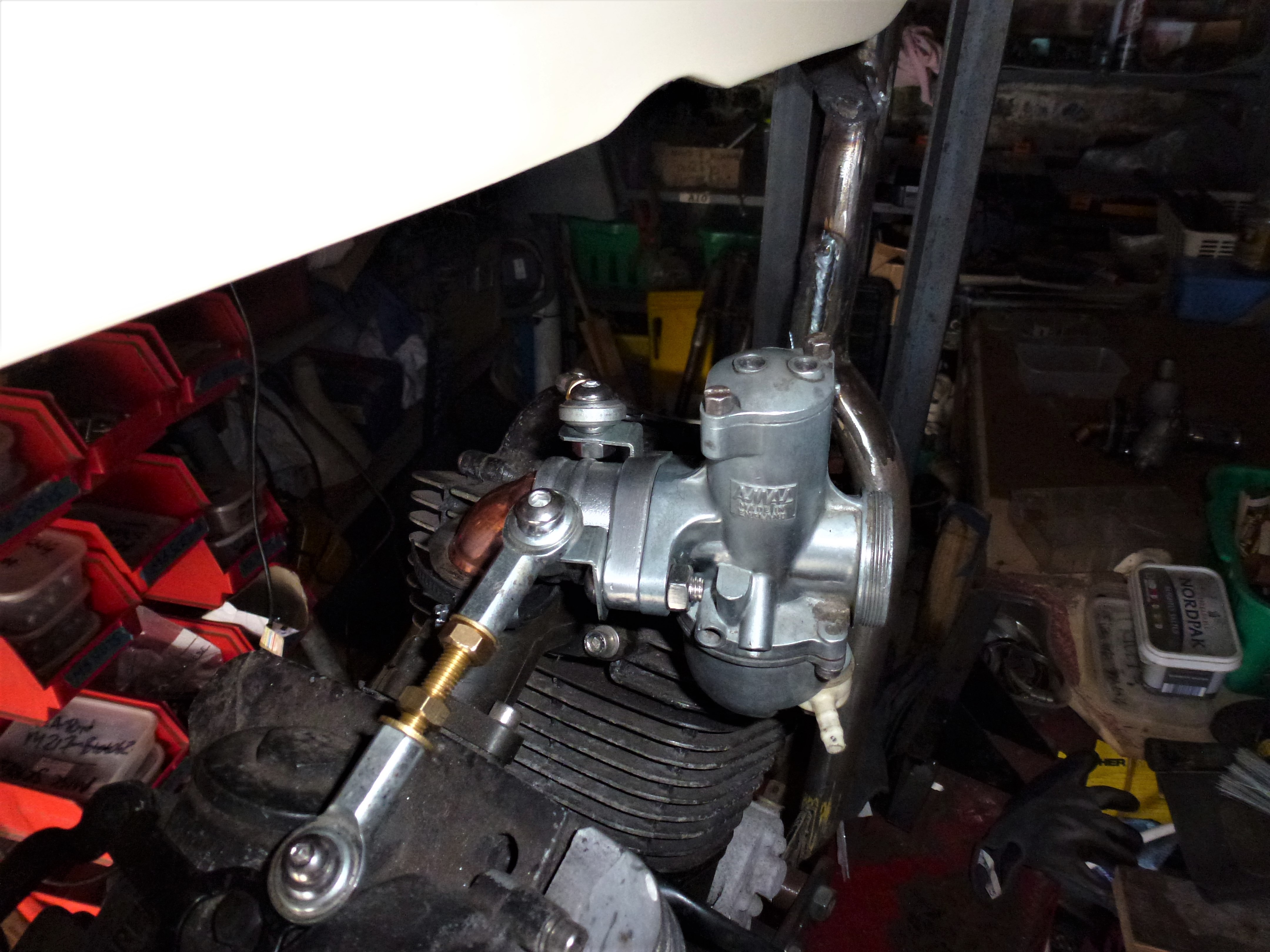

And here it is !!! Quite straightforward in the end as I made it similar to the previous SU mount.
The copper plumbing elbow has been resin bonded to the Amal stub manifold and it's all fitted up on the engine with the modified support struts nfrom the SU set up.
There's also enough meat on the Amal stub to drill and tap for the Nitrous fogger nozzle.

That looks the biz.

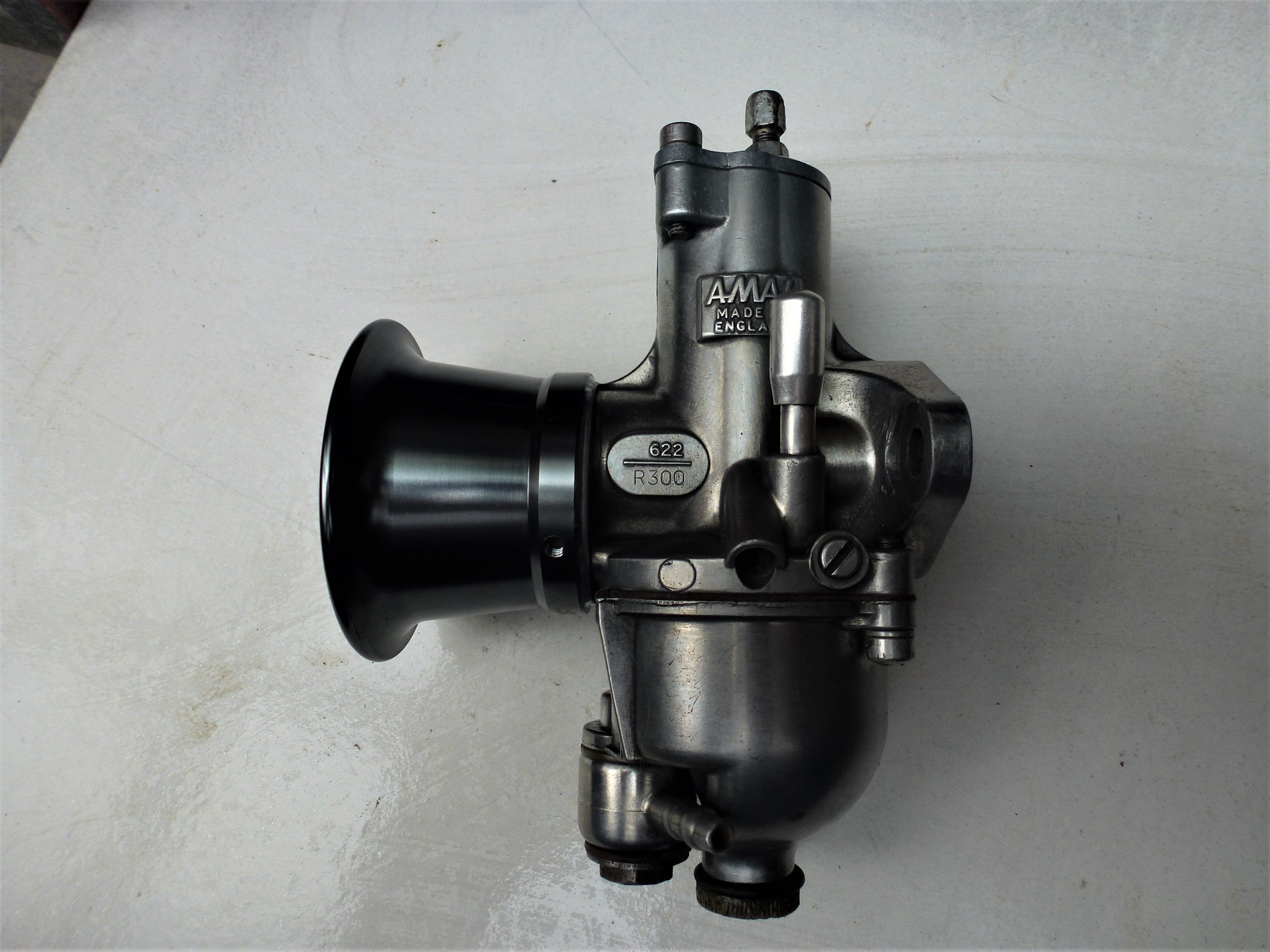

A genuine Amal velocity stack for the 600 series Concentric is £65 .......... secondhand if you can find one around £25 - £35.
Chinabay to the rescue - superb quality CNC alloy item - £6.00 delivered [ in less than a week ].
Required minor fettling to the Amal intake as I didn't want to use the grub screws they included for attachment.
