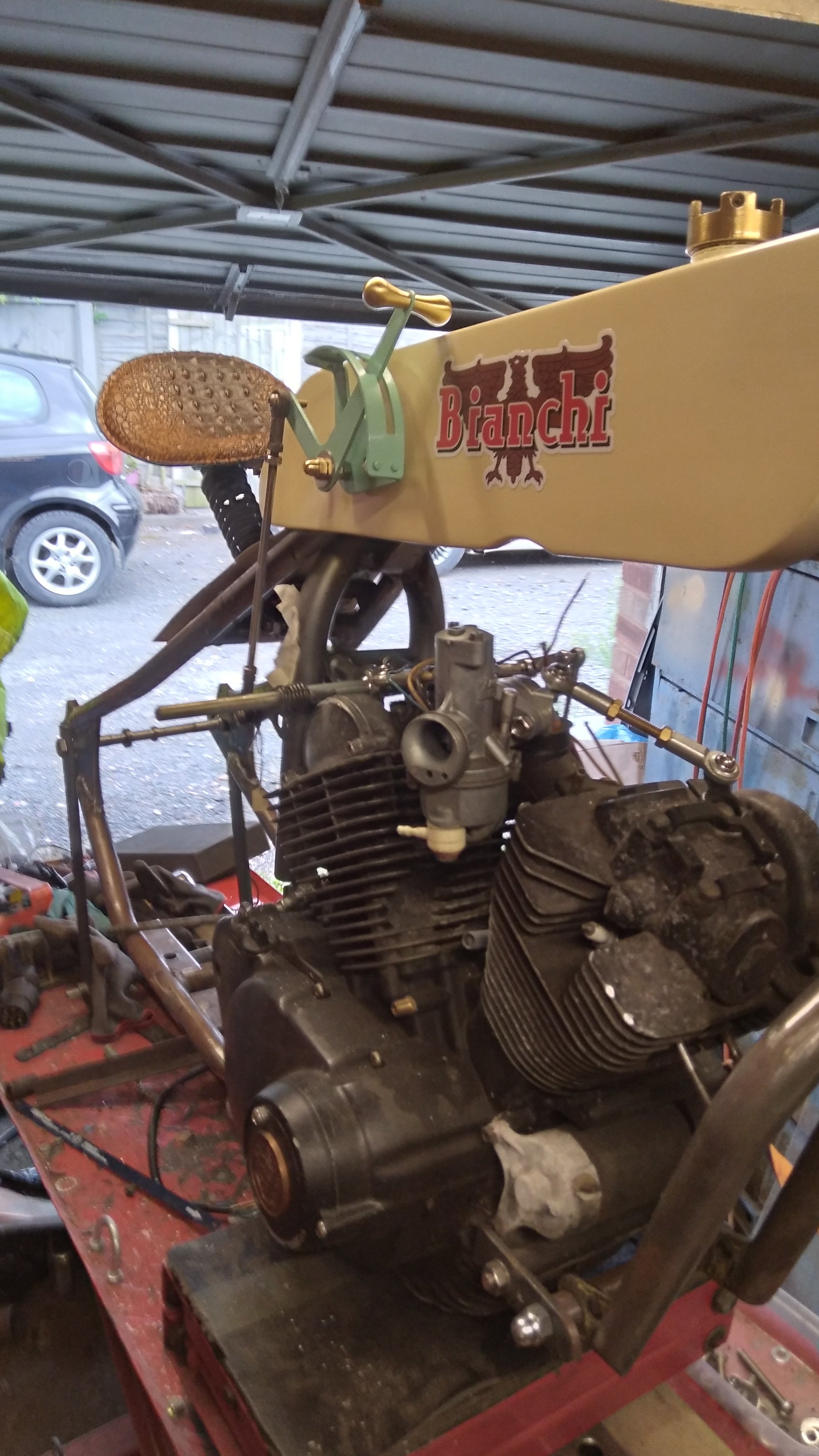

I resolved the issue of the saddle making contact with my newly painted and lacquered tank [ !! ]
Simple solution .......... turn the saddle mounting bracket over giving me the required clearance !!

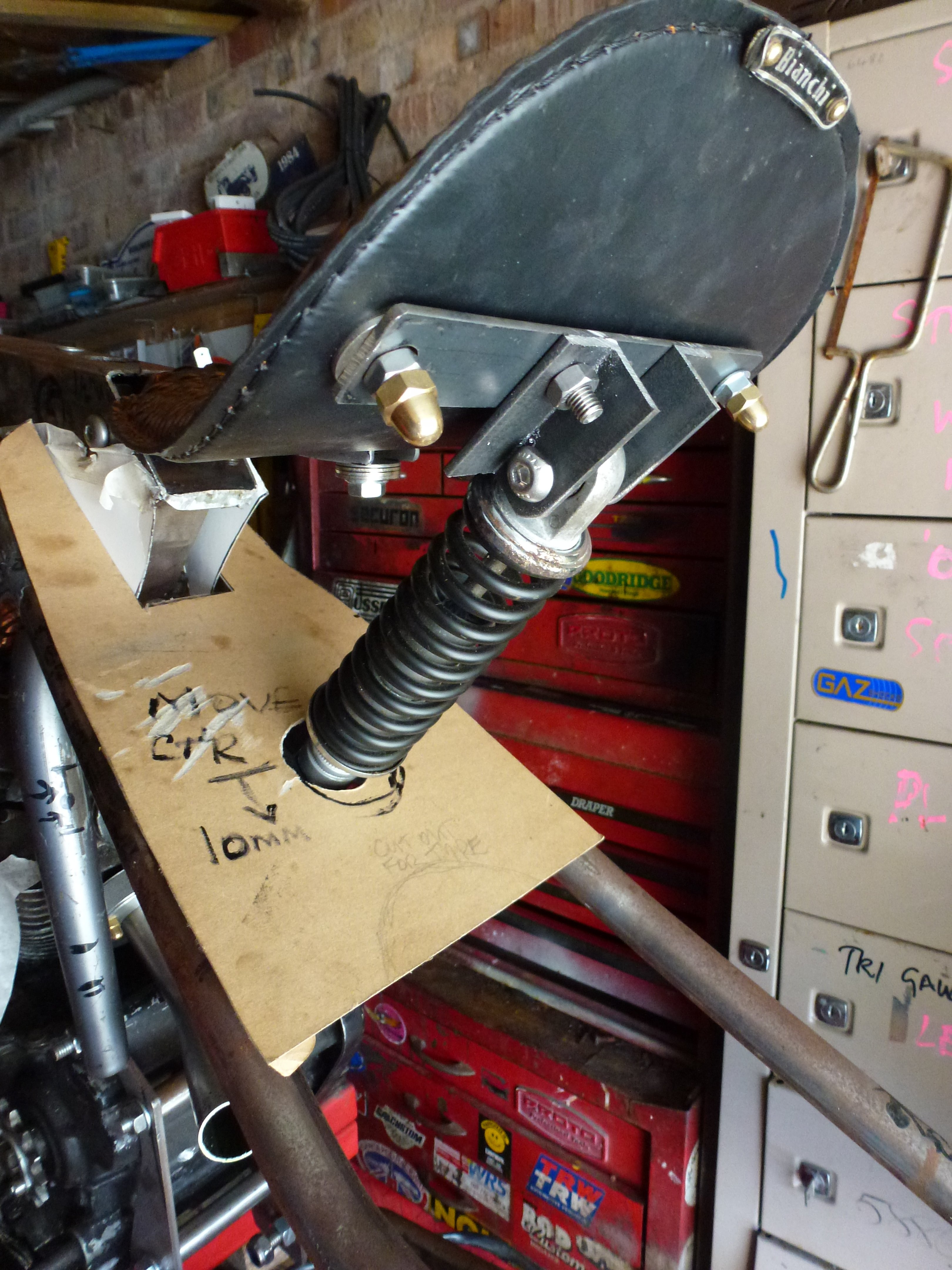

I've gone with a mini coil over shock - left over from my Hot Rodding days [ engine torque damper ] .
The bottom of the shock mount will pass through the cover plate and be similarly mounted.
New POC brackets made and all fitted up. works fine. Just need to dismantle it and dress all the brackets and tidy the overall look.

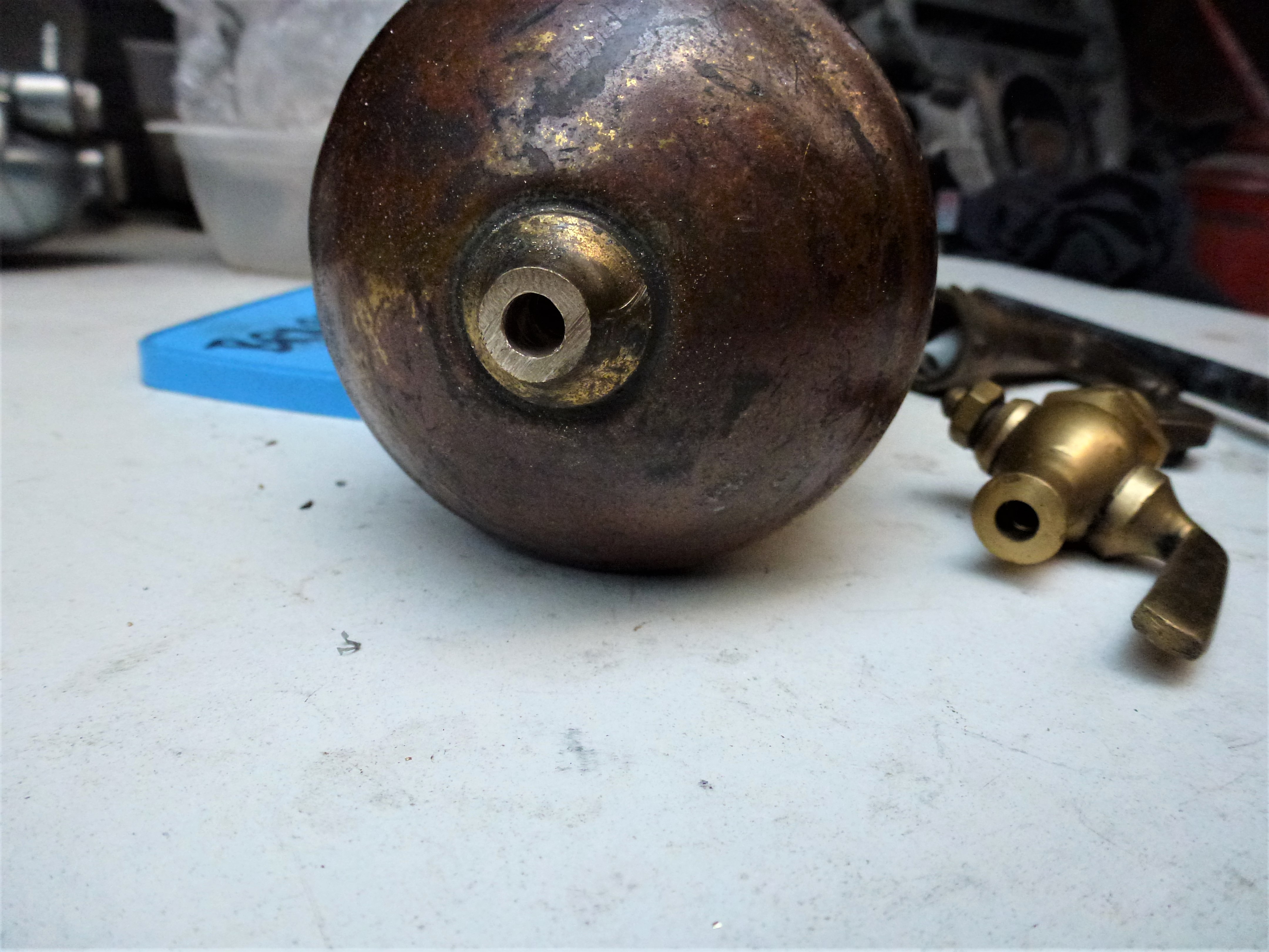

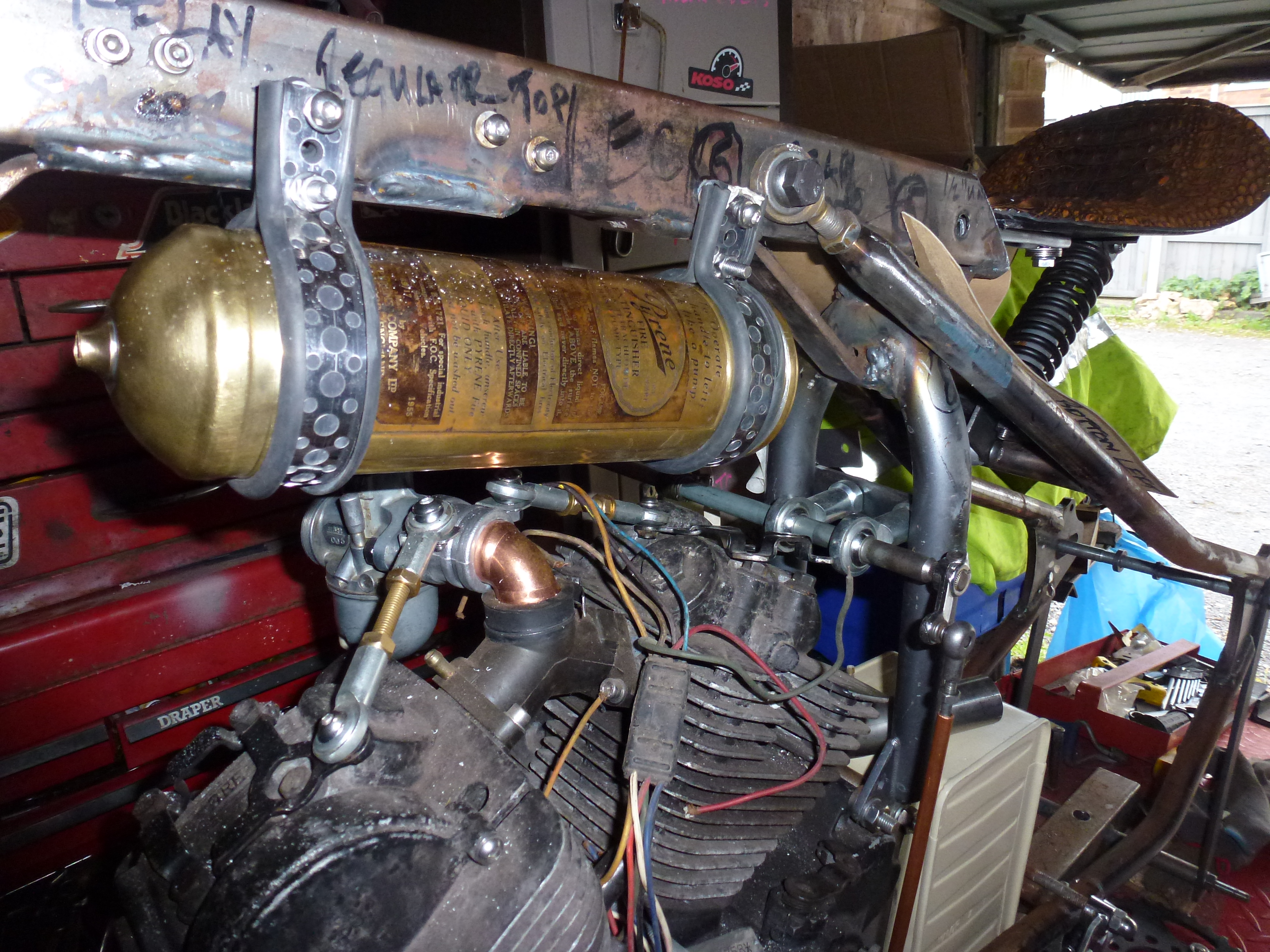

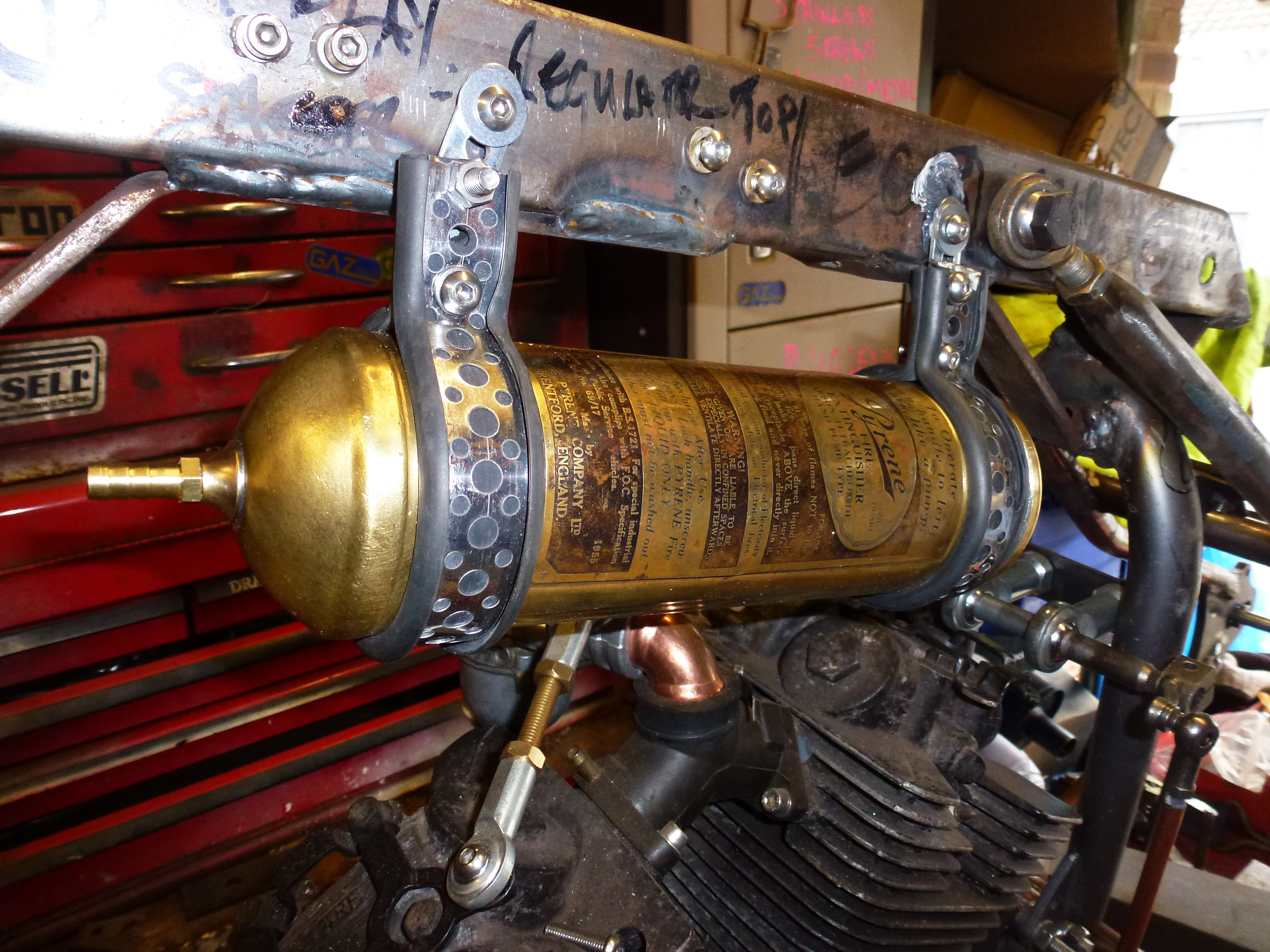

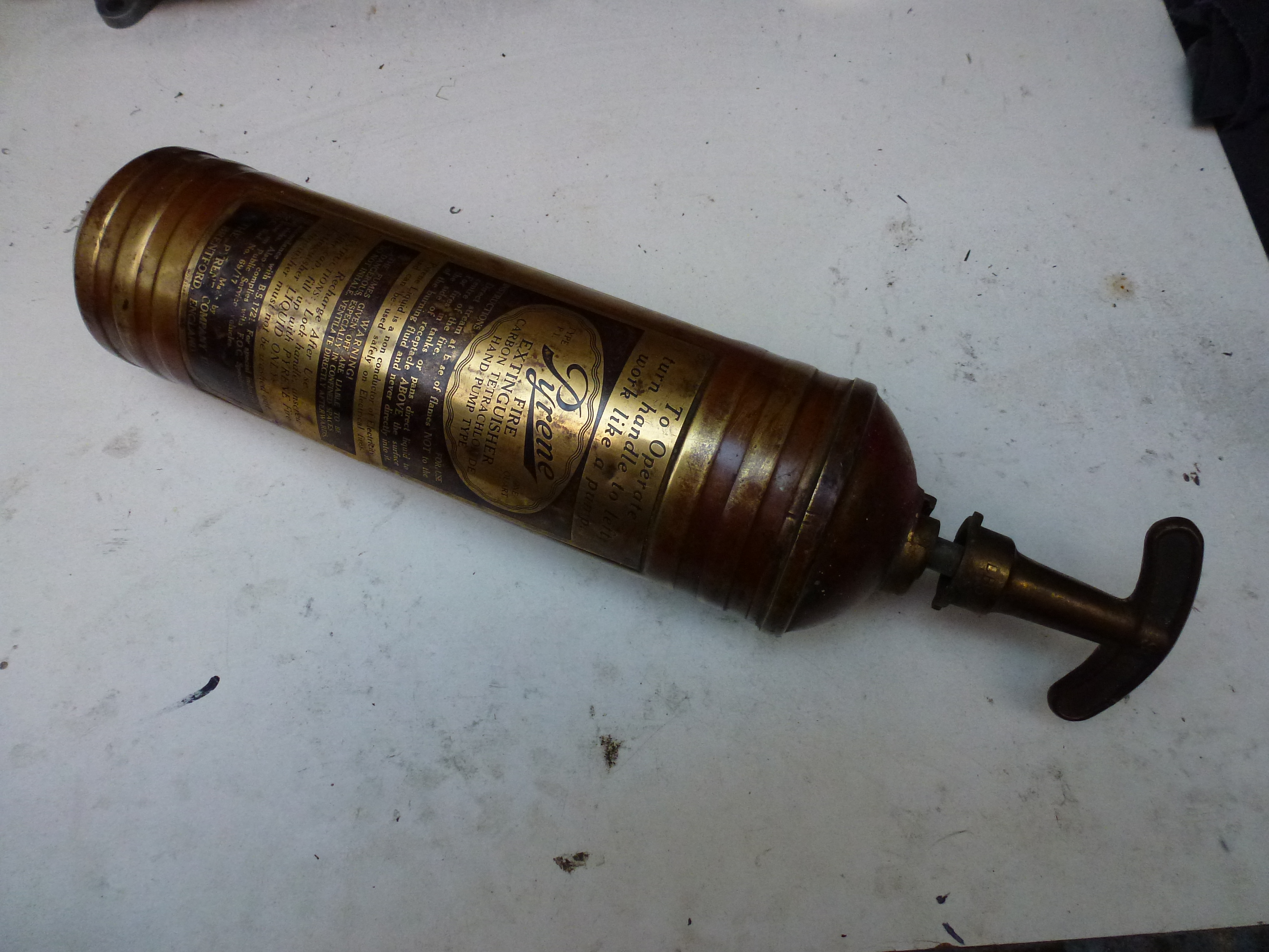

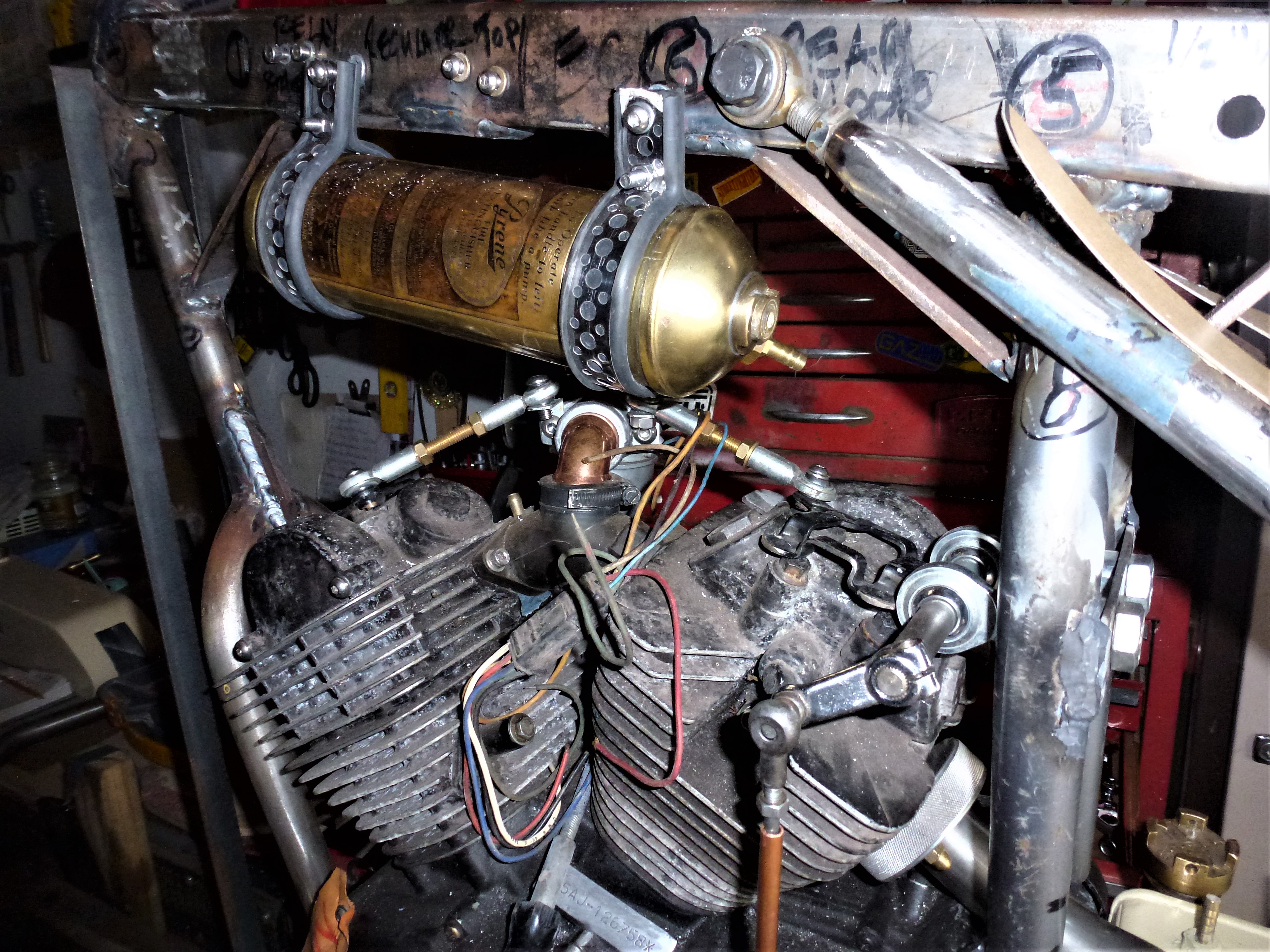

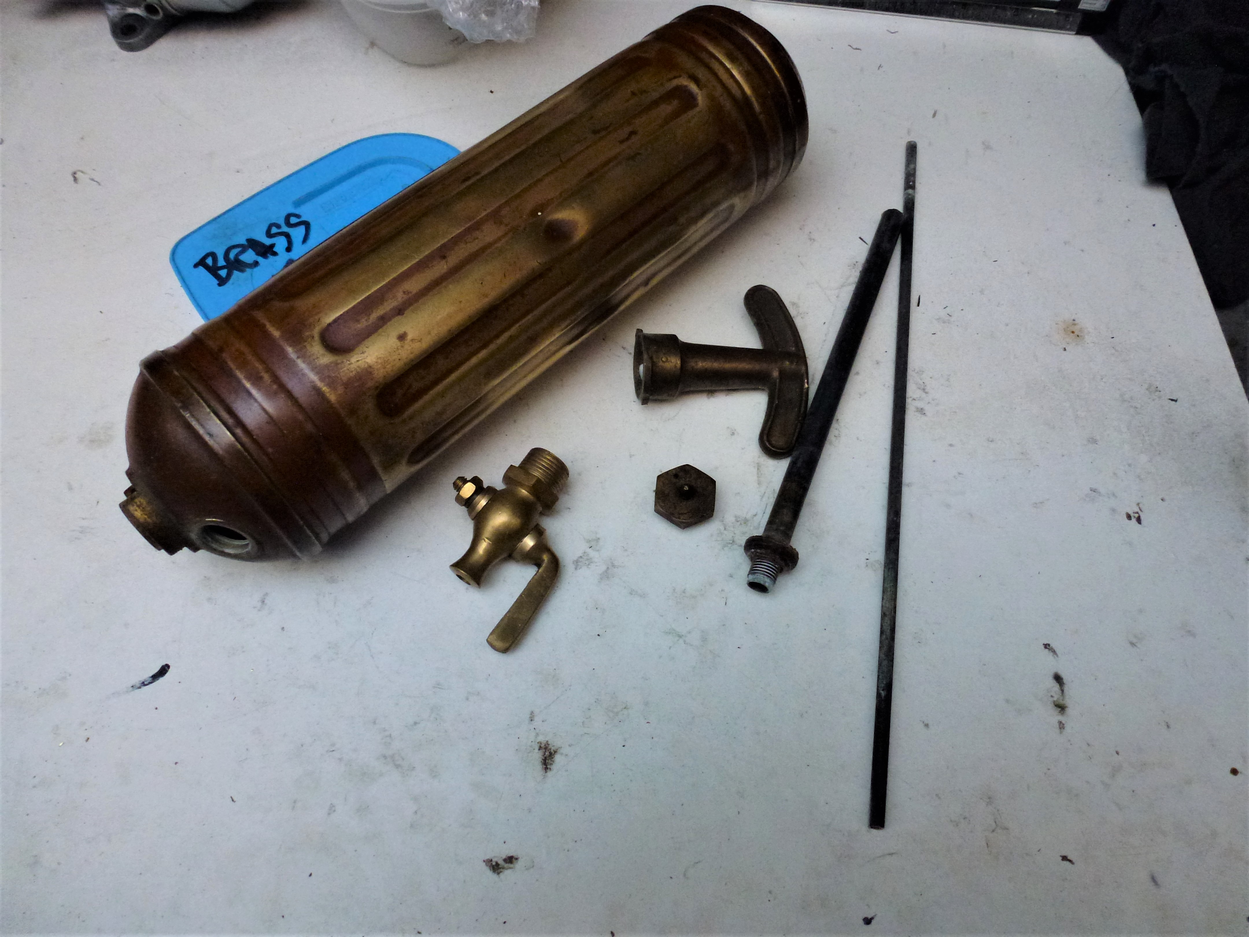

My Pyrene fire extinguisher arrived today - it's going to become the fuel log / header. The SU runs on about 4psi fuel pump, but the Amal Concerntric is gravity fed so I need to have a fuel log / header from a low pressure pump to raise the fuel from the cell in the bottom of the frame without creating excessive pressure.

The seat mount position looks good, and I like the velocity stack you were able to find for your carb.. She is coming together nicely!
Cool, that will look neat and not just be decorative.
MT, it's all about recycling and lateral thinking !
I got a quote to make a simple header fuel cell ............. £48 [ I supply the hose tails ].
The Vintage Pyrene extinguisher [ solid brass ] £20 including delivery , and as you say cosmetically appealing.

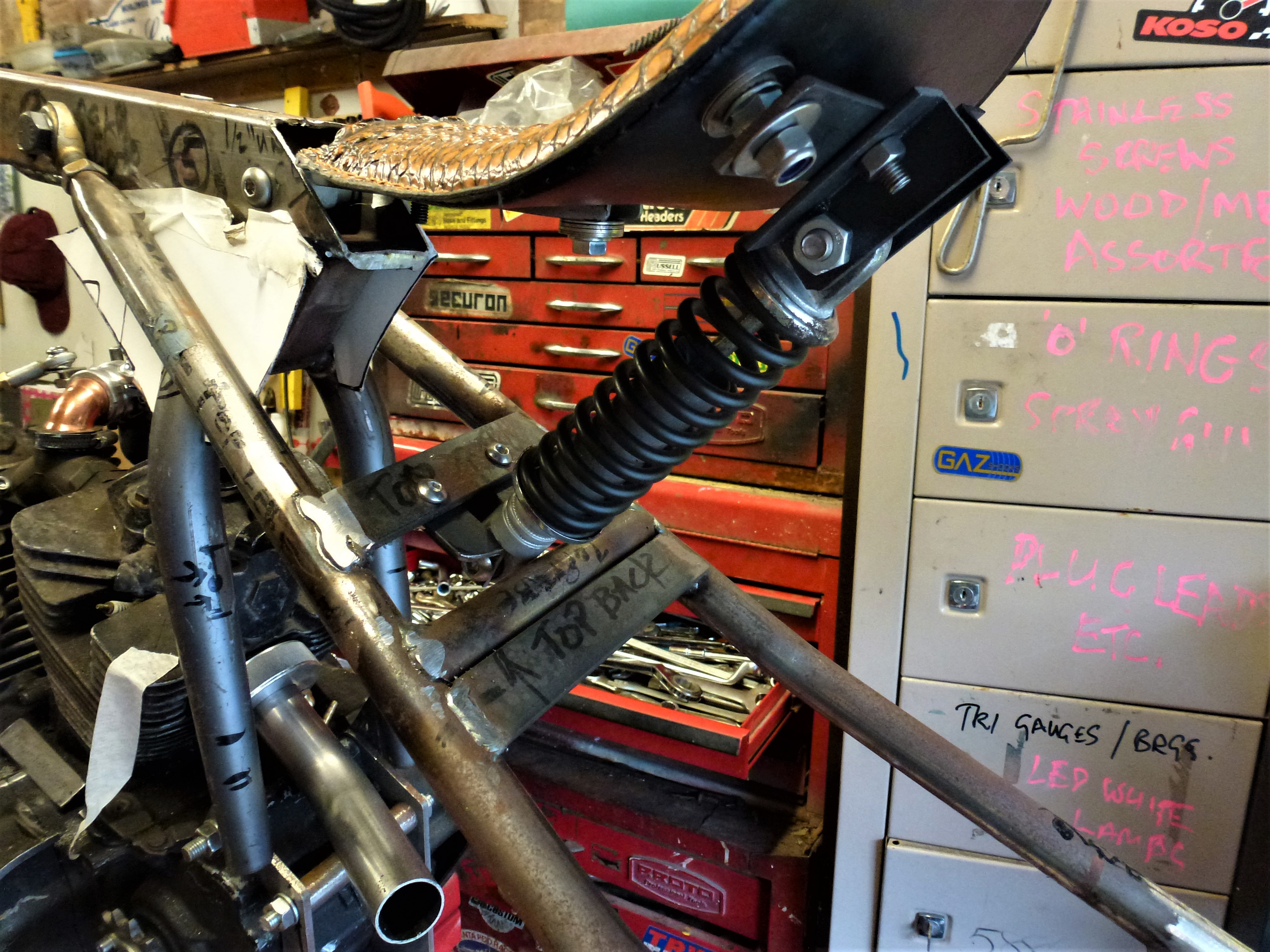

Thanx Luugo. The template for the top frame has been completed and proven out. The brackets have now been fettled and trimmed down.

Hmmmm ....... brackets all fettled and tidied up - don't look right.
What do we think - hide them ?? !!

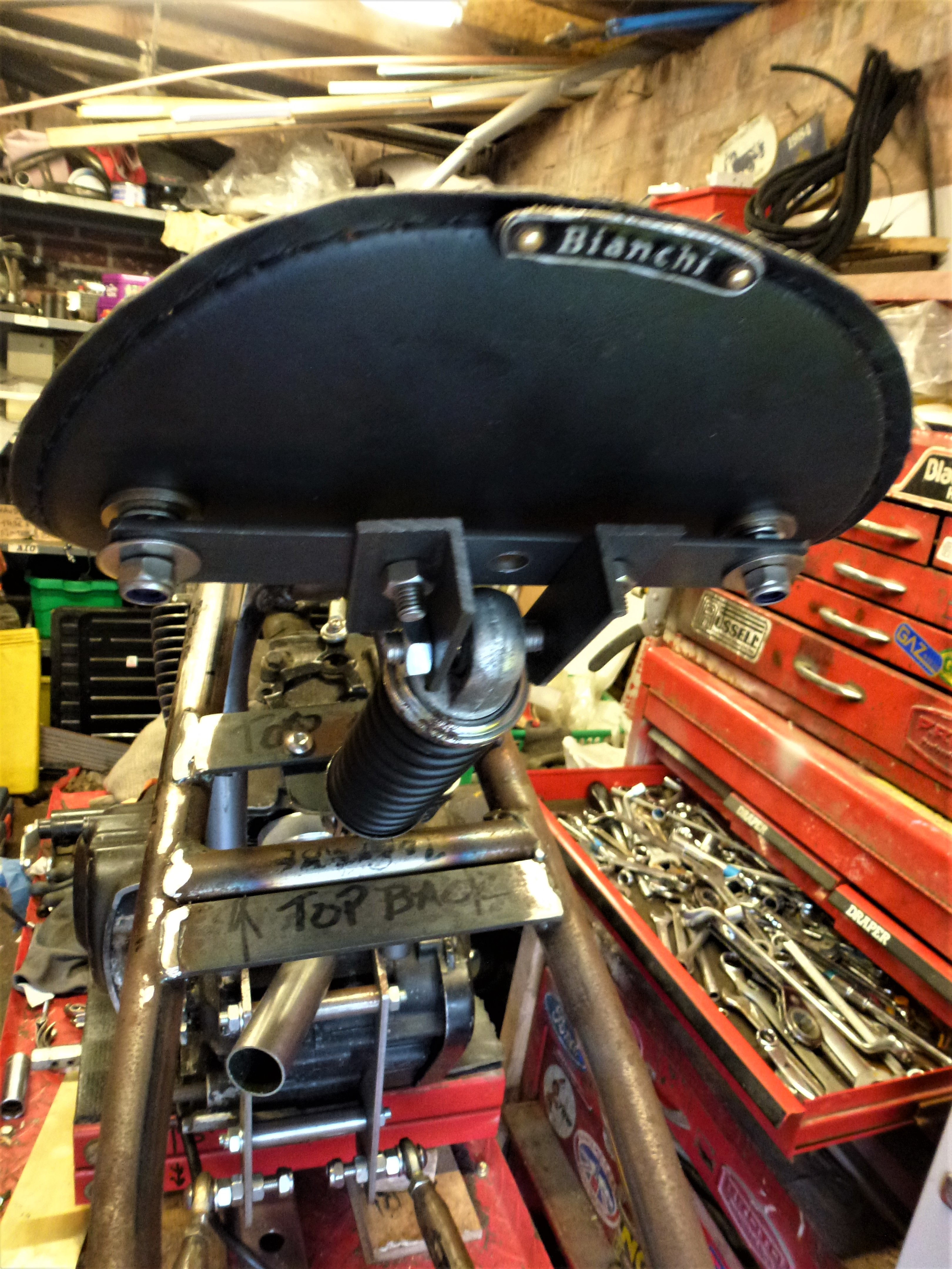

is it safe to assume that you will make those seat brackets smaller, lighter and more elegant? ;)
Yes, already done Teazer. They were just POC to make sure that the saddle worked as intended with me sat on it !! As you know - I am NOT a welder so had to make the POC parts from what I had - angle iron !! I've already sent a sketch to my new welder buddy.

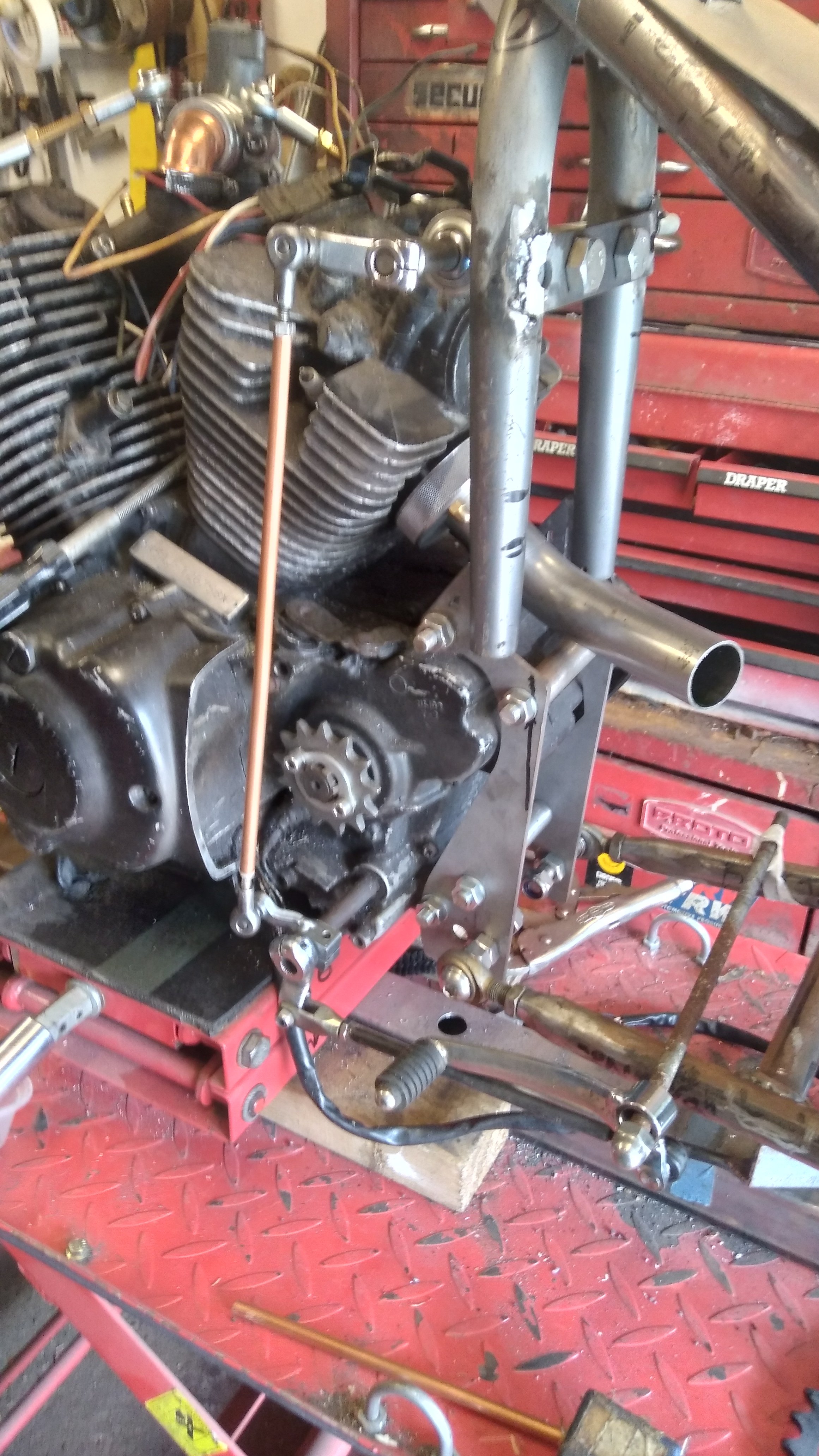

Mock up of hand / foot gearchange linkage to cross shaft and foot lever.
I'll be at the mercy of welder "mates" to get the mounts fitted for the footchange lever !

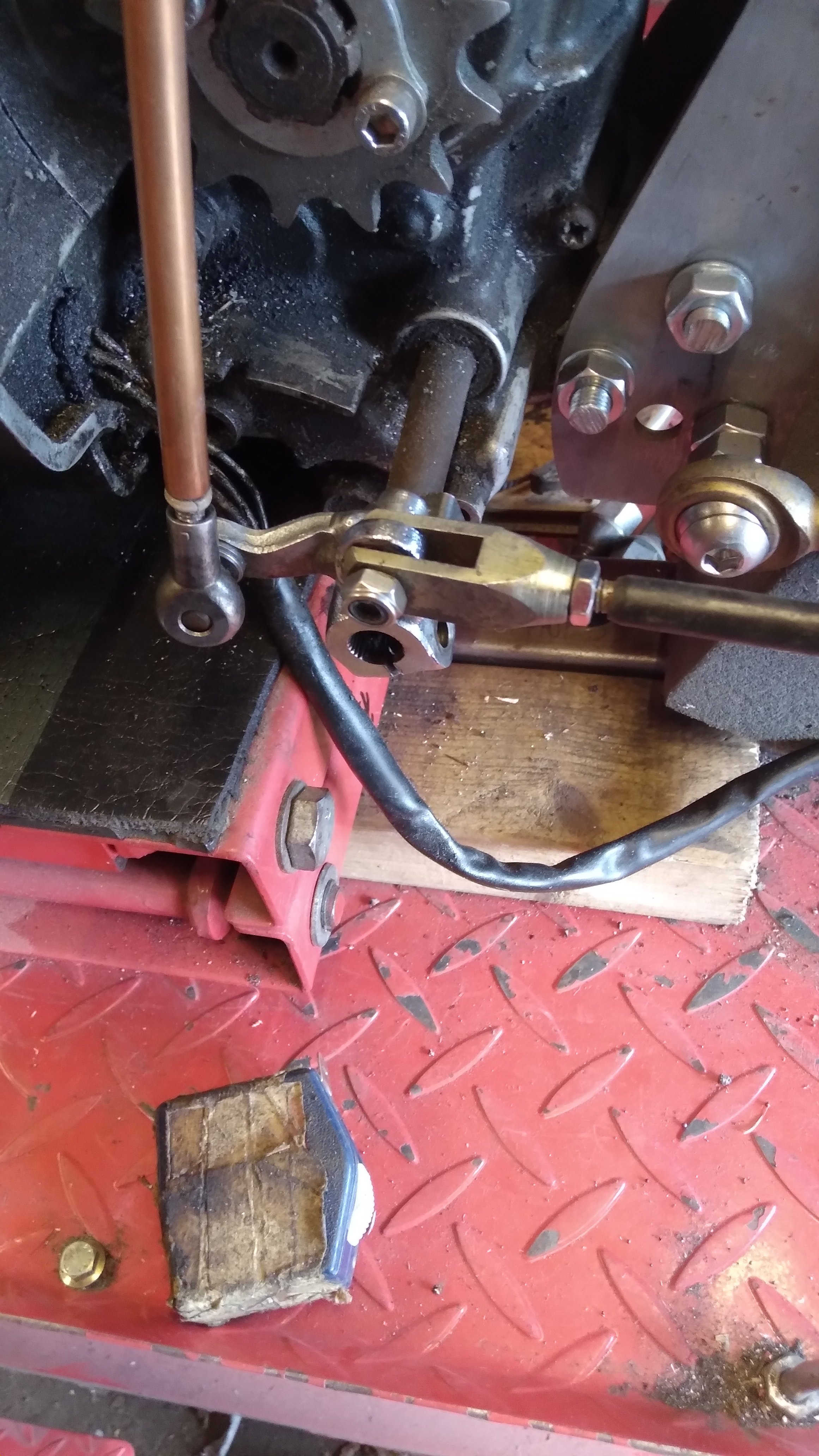

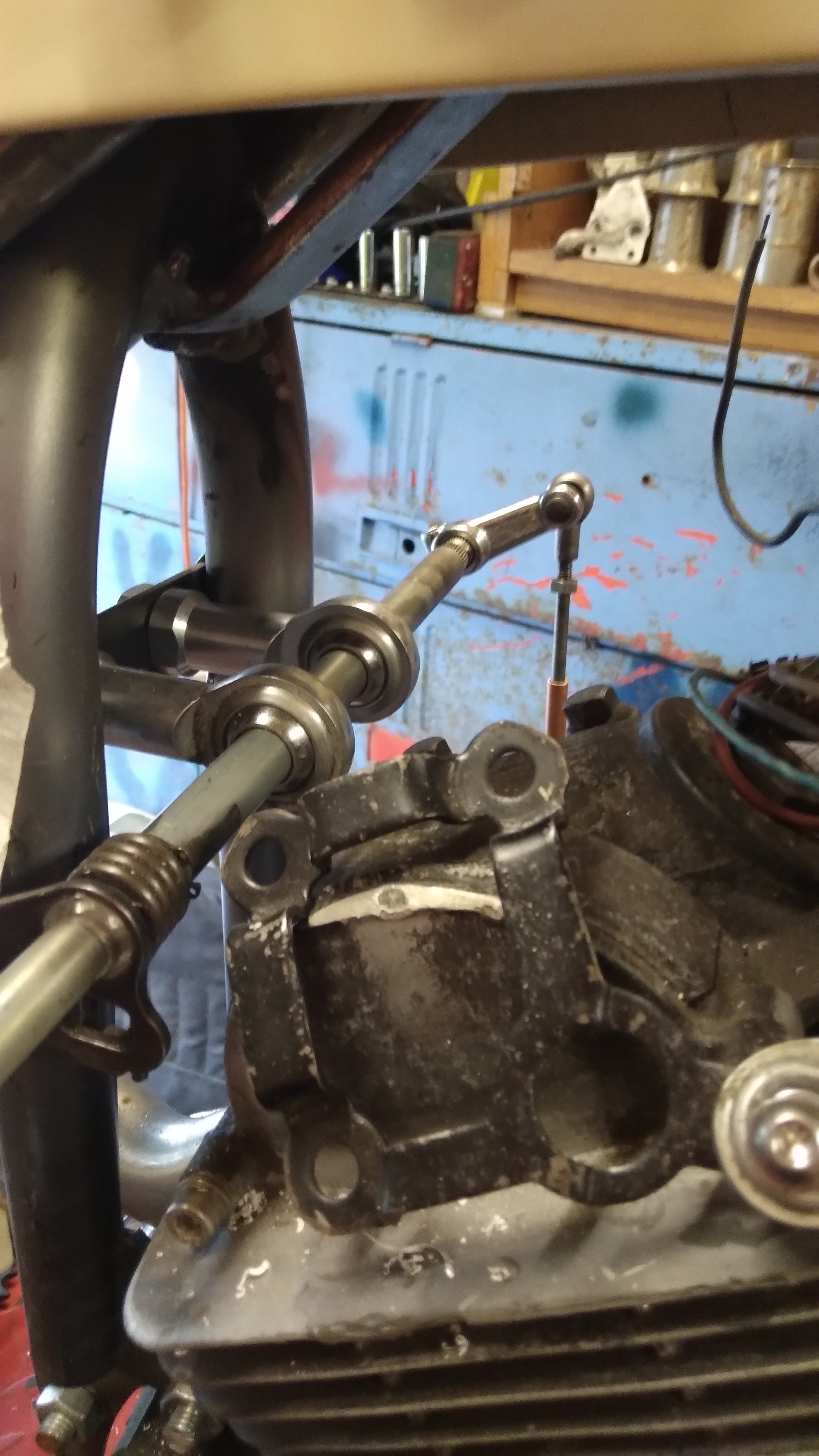

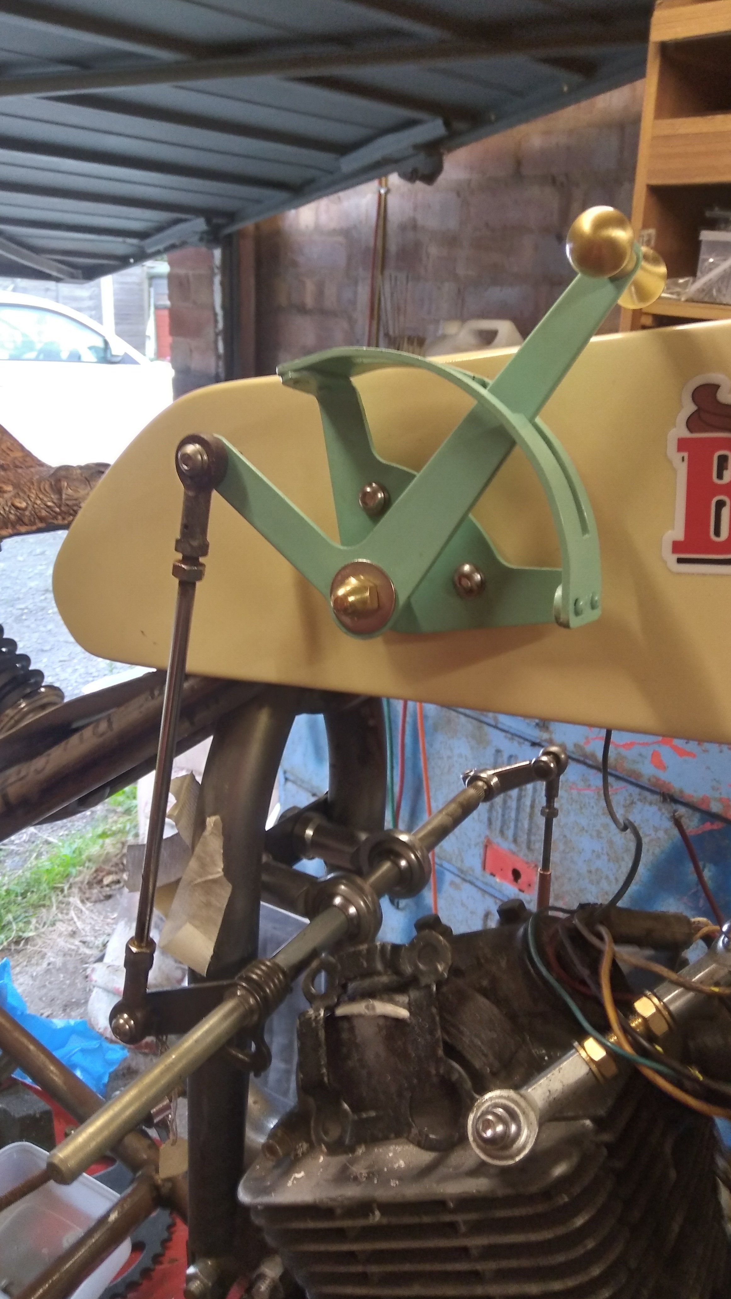

Switched to the other side now. Handchange quadrant and rods all mocked up. The rod on the quadrant side will have to be shortened to get the correct angle.
Need to get a small amount of machining done then I can finalise the system and trial it out.
Waiting for copper tube to enclose the connecting rods.

VINTAGE PYRENE FIRE EXTINGUISHER - NOW MY LOW PRESSURE GRAVITY FEED FUEL LOG. Ooops caps lock off now.
Just some dummy brackets to mock up the position, it will be partially under the "tank".

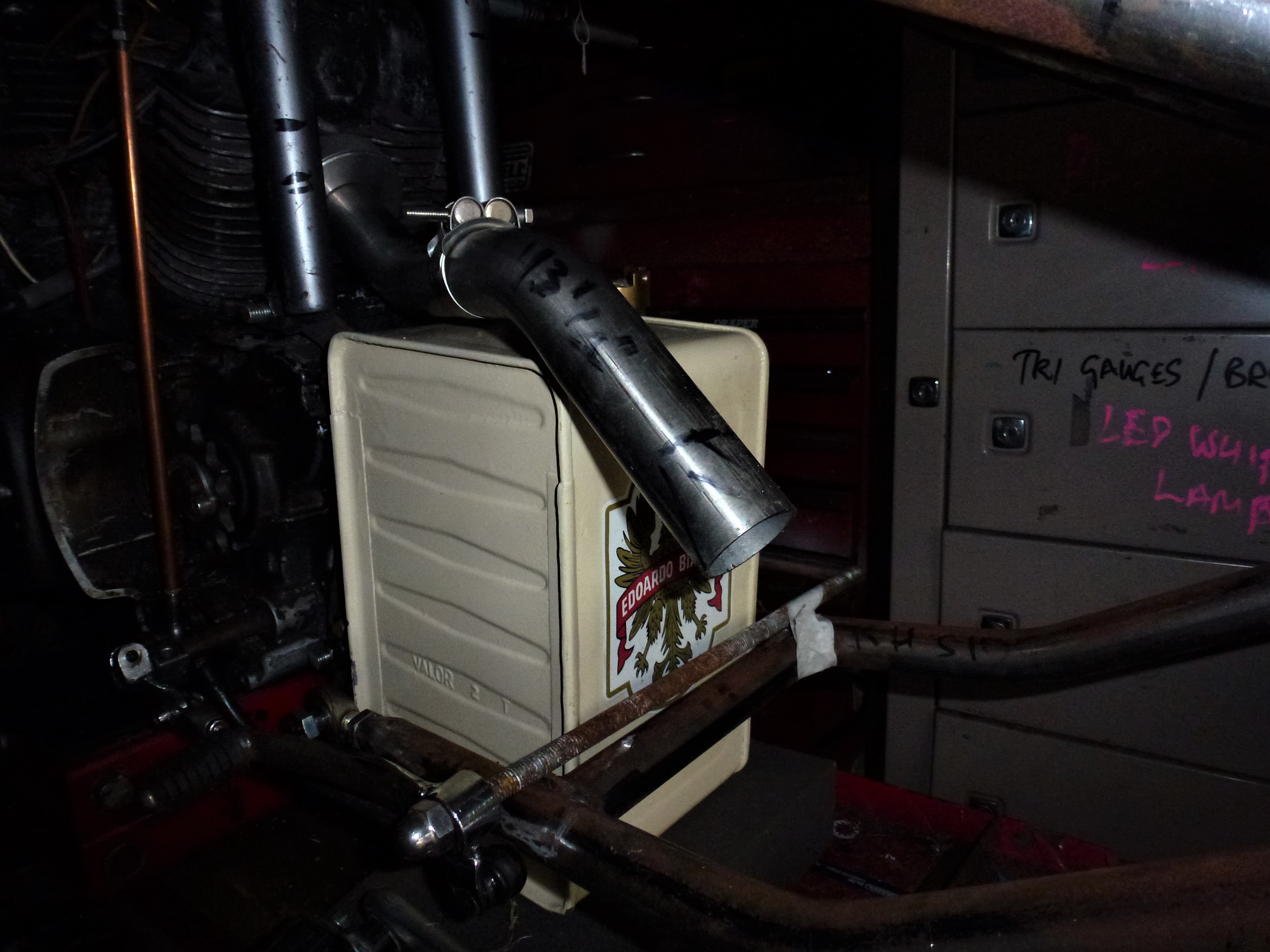

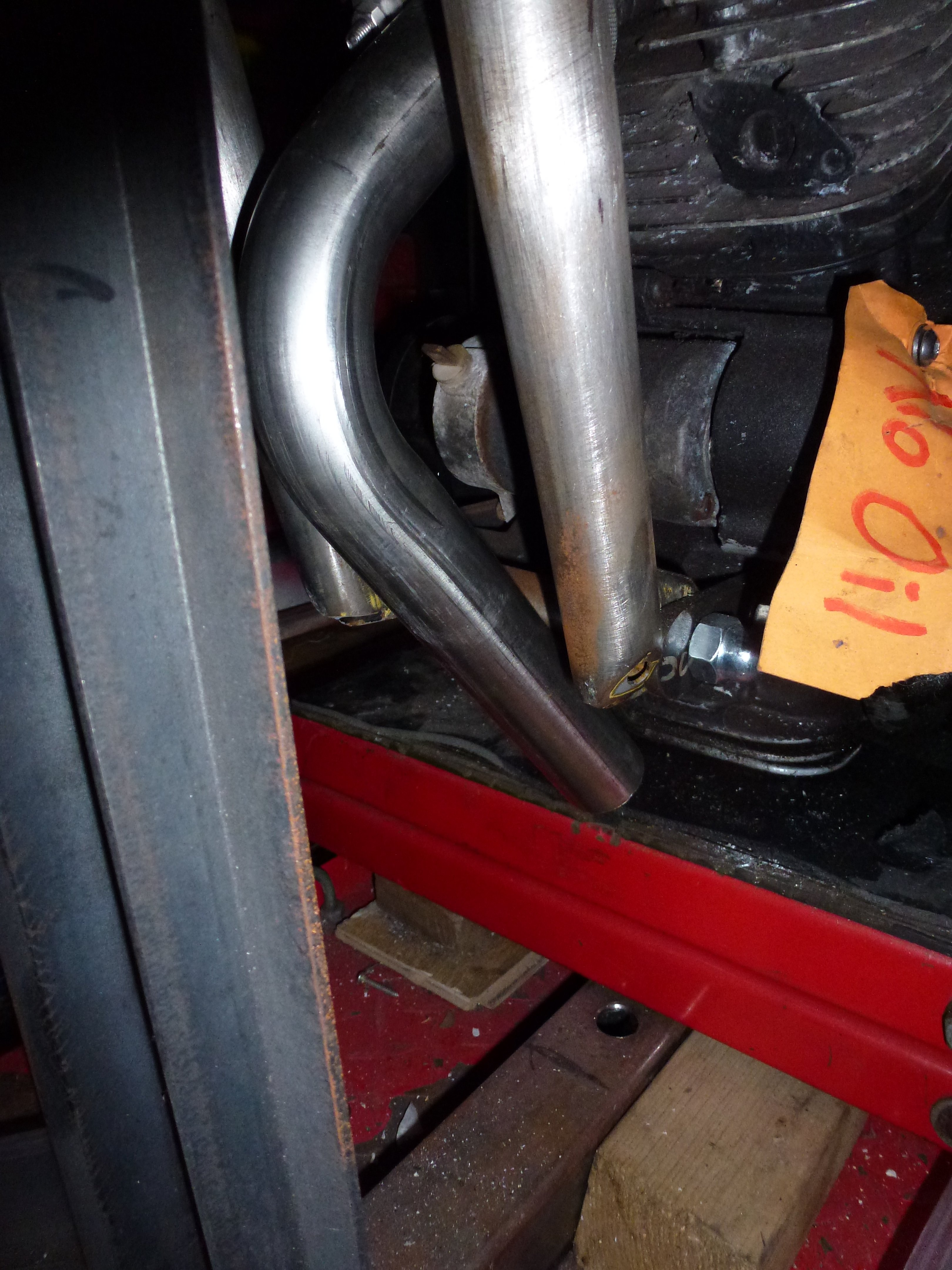

I finally mocked up the rear exhaust to make sure I had clearance on the fuel cell - all OK.
Despite looks, the front and rear headers will both be the same length ! Pure luck not planning. The rear one is just joined with a wide exhaust clamp to secure the position . Then back to finding that elusive st. steel welder nate ! I'll slash cut the ends for pure cosmetics.
I've now got the copper tubing to cover the various gearchange connector rods.

It's very satisfying when that germ of a thought in your brain works in reality !!

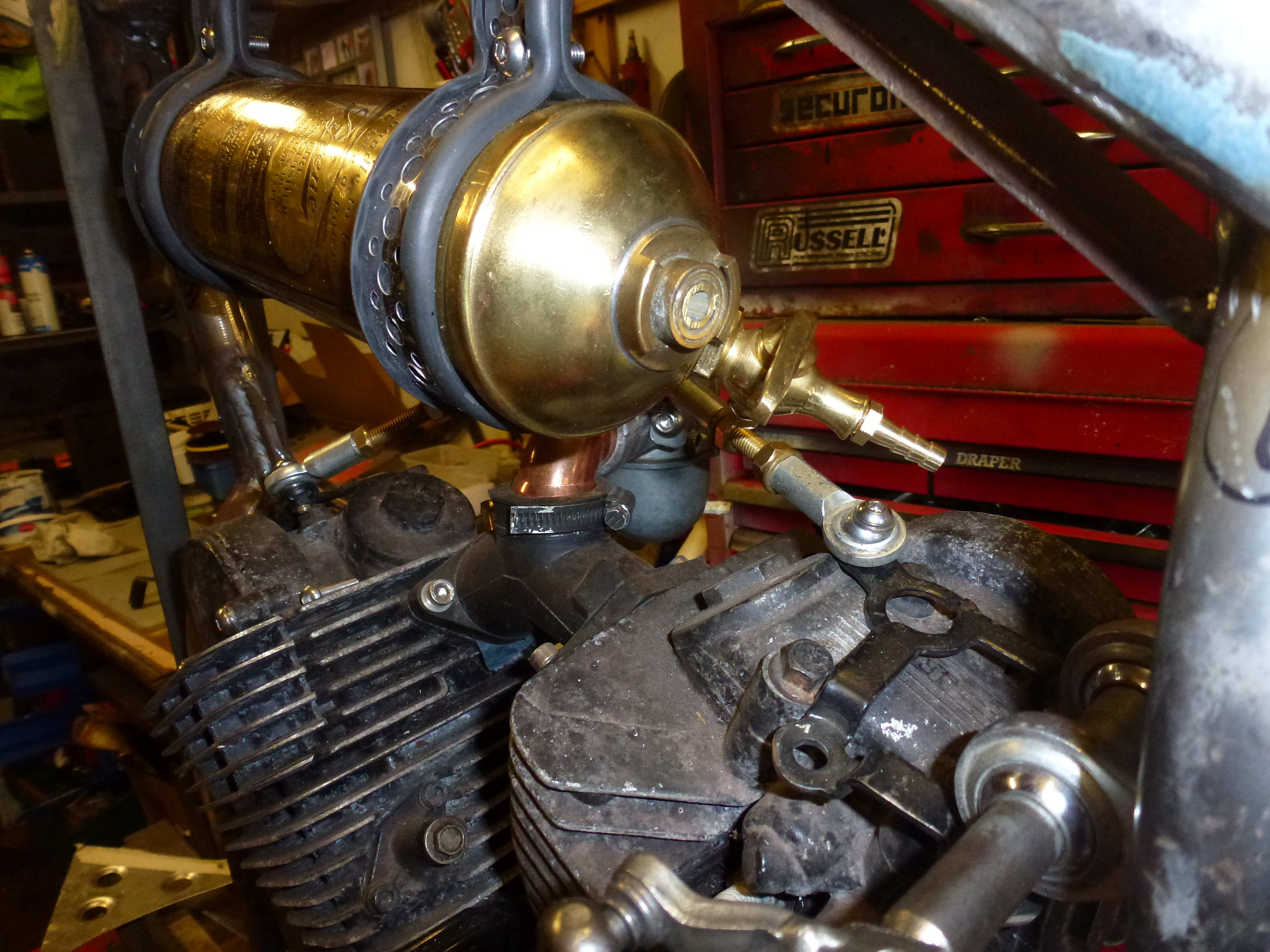

The Pyrene fuel log is now completed and functional using an 8mm brass hose tail for the inlet and a 1920's NOS brass fuel tap bought at an autojumble 30 years ago ! That also had to be modified to take another 8mm brass hose tail for the supply to the Concentric carb.
The eagle eyed will see that there's a hole to be blanked at the fuel tap end, where the original plunger went in. That will be blanked off, maybe with a 1944 farthing coin [ my DOB ]

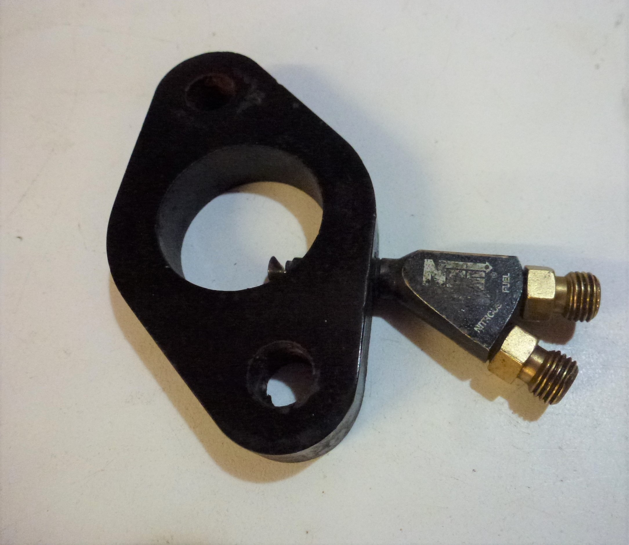

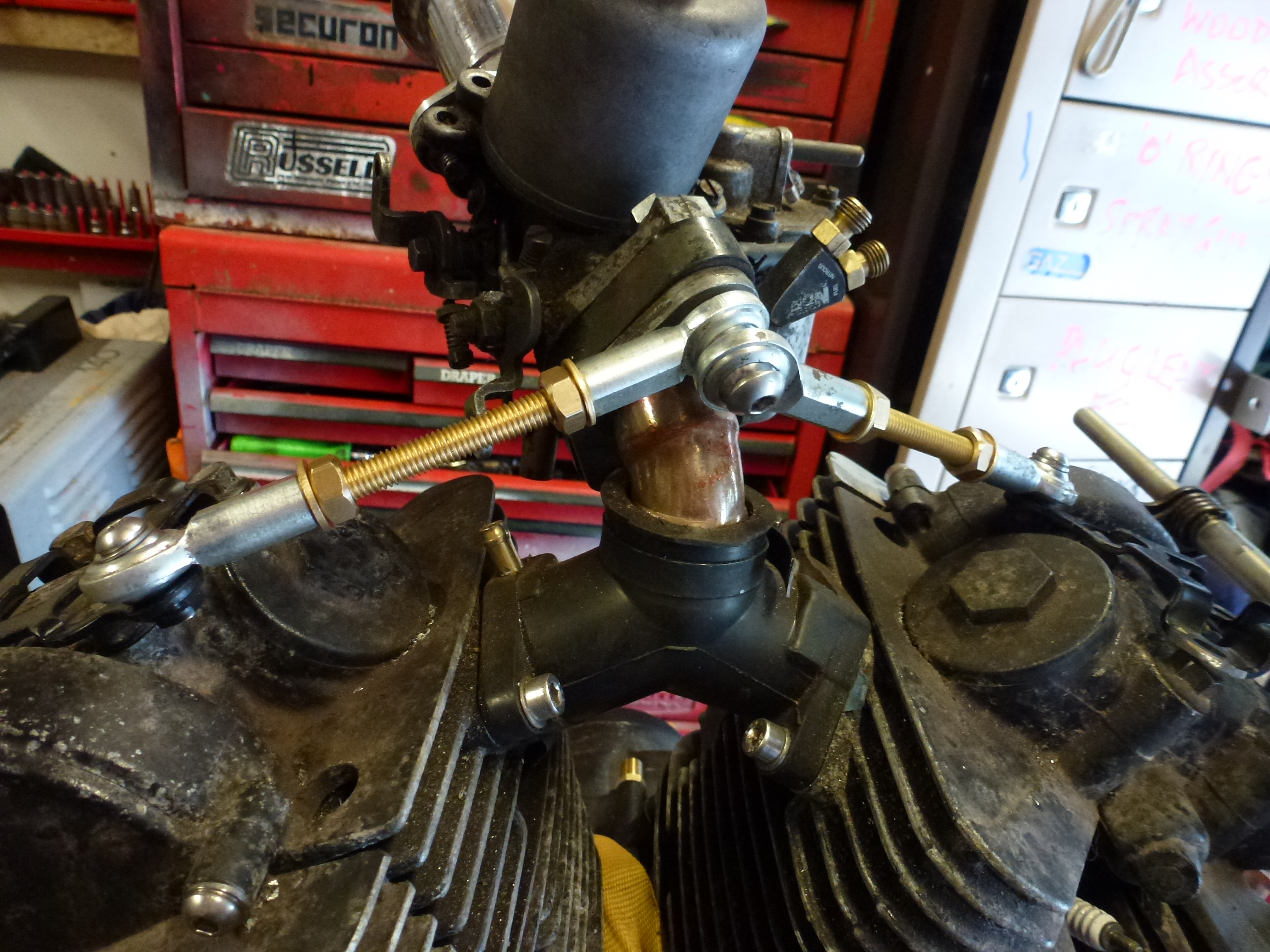

I'm still working out how to integrate the NOS after the change from the SU. I'd got it all worked out with the Fogger inserted into the sandwhich block between manifold and carb. Got to start all over withe Concentric set up, but I think there is room to get the fogger drilled and tapped into the Triumph [ !! ] hybrid swan neck intake. The Triumph / Amal part of the intake is slightly longer giving me more room to put the fogger in from underneath rather than 45 degrees from top. .... more stealth !!!

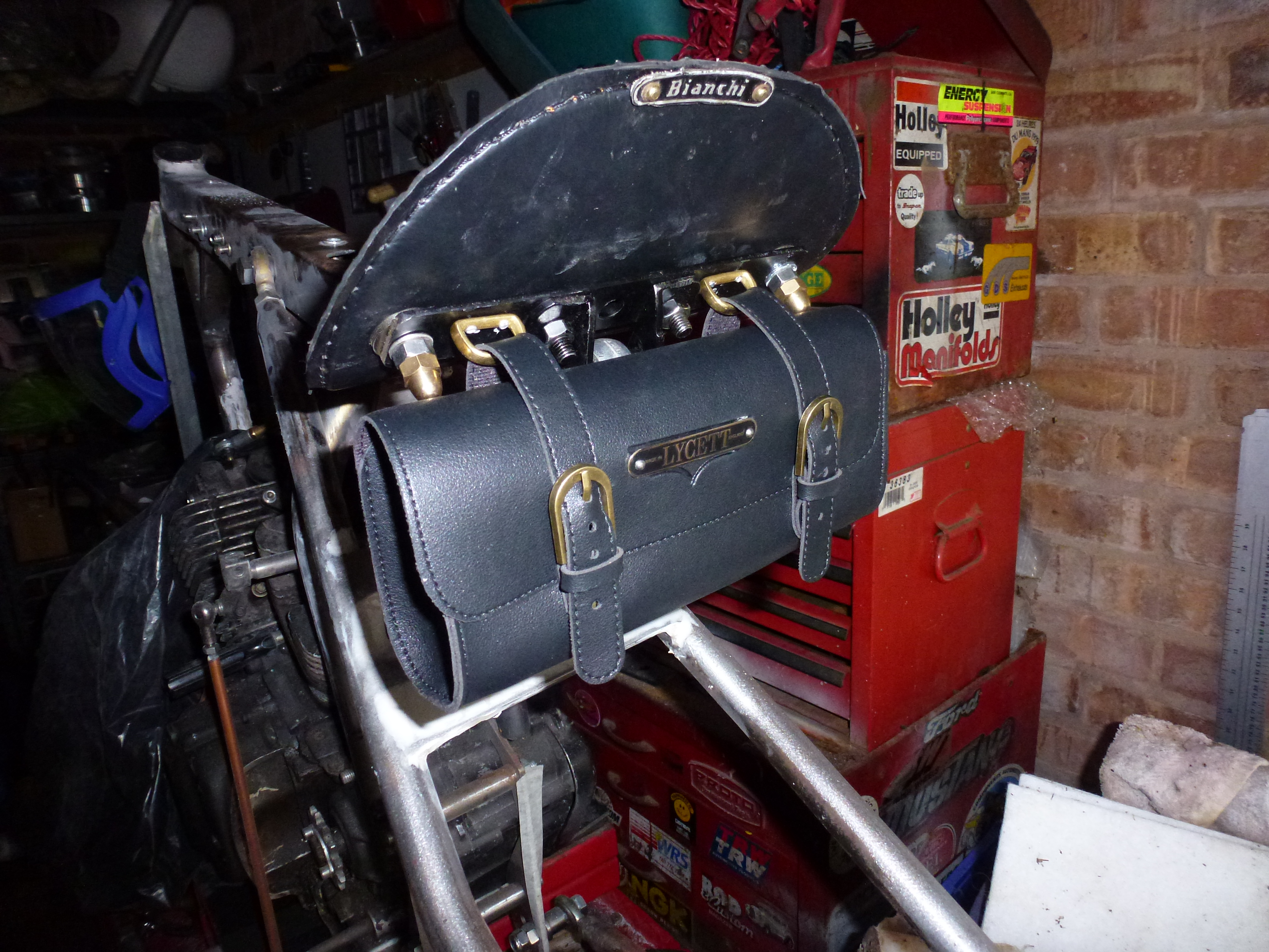

Saddle and tool bag finally finished and trial fitted.
I found a Lycett enamel badge in my stash [ ?? !! ], finishing touch.

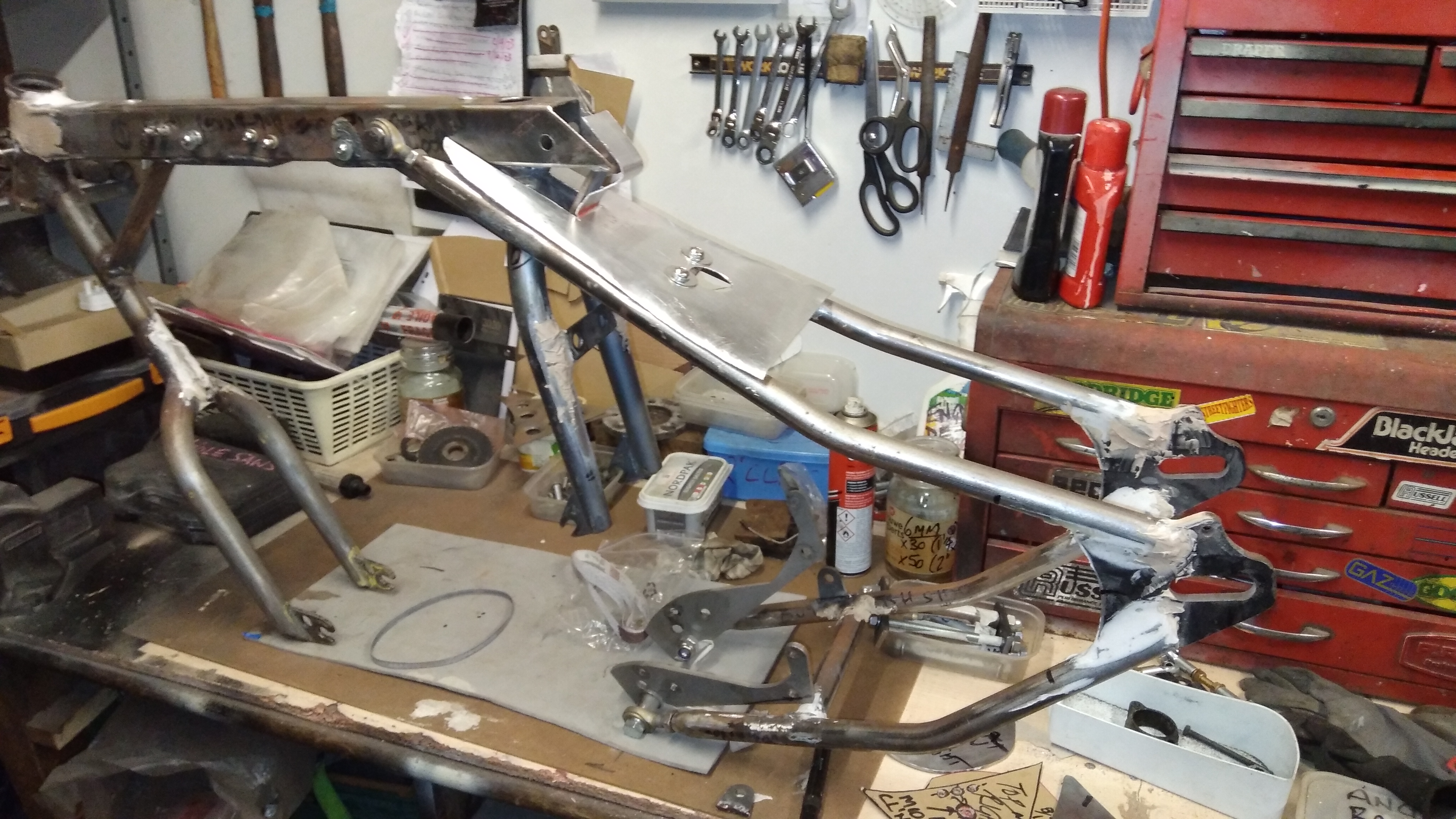

New year, new start .........
Two months of Chronic Kidney Disease issues slowed me down [ even more ! ], on the mend now and back to my projects.

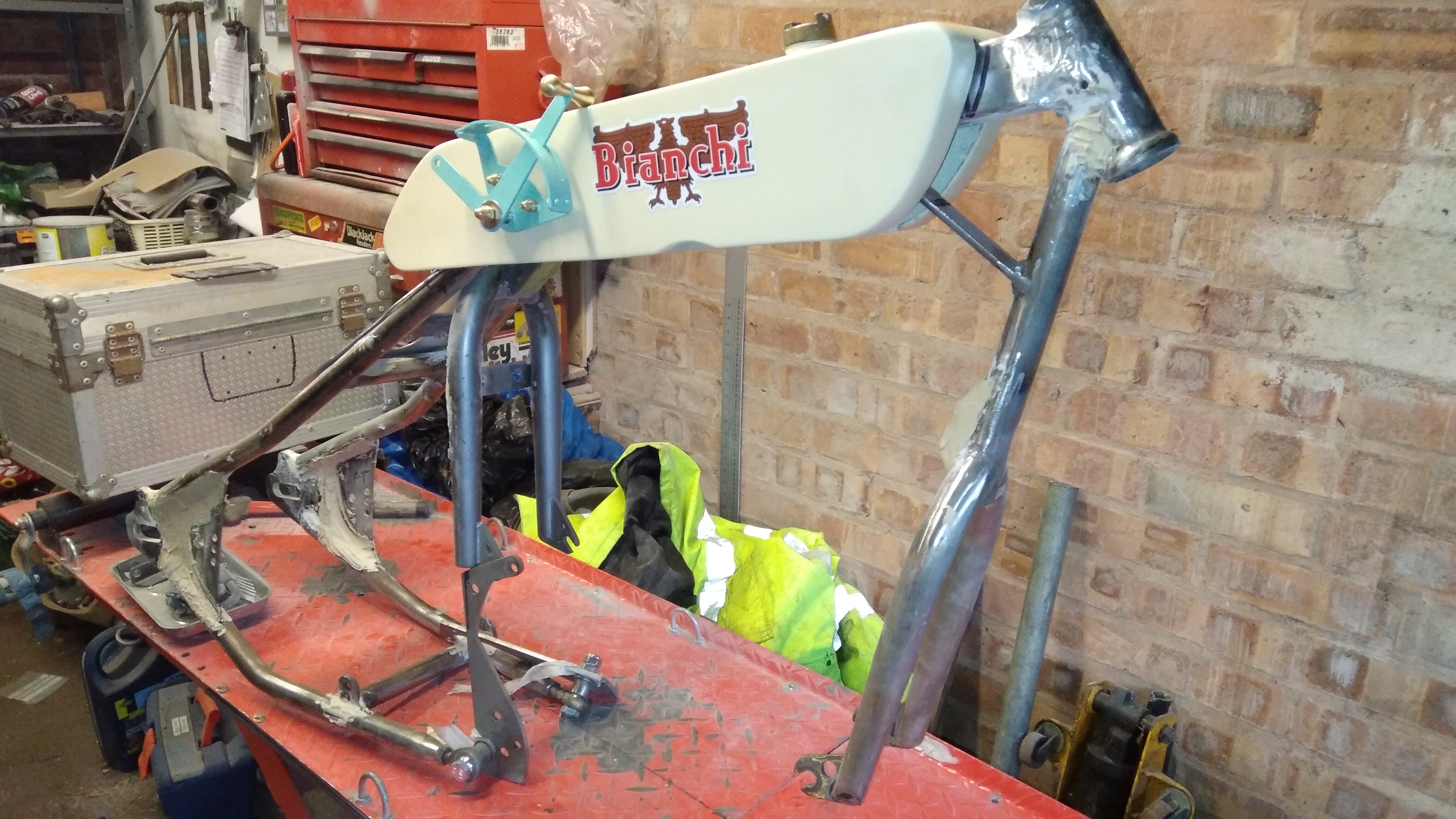

Welding all completed now, in the end I had to do it myself - lots of promises and no shows from "mates" who said - "yea no problem I'll do that" .....................
Anyway not neat but solid ! I had always intended to blend all the joints with filler and smooth them out - just wish I'd done the welding myself 6 months ago rather than waiting for the experts.
