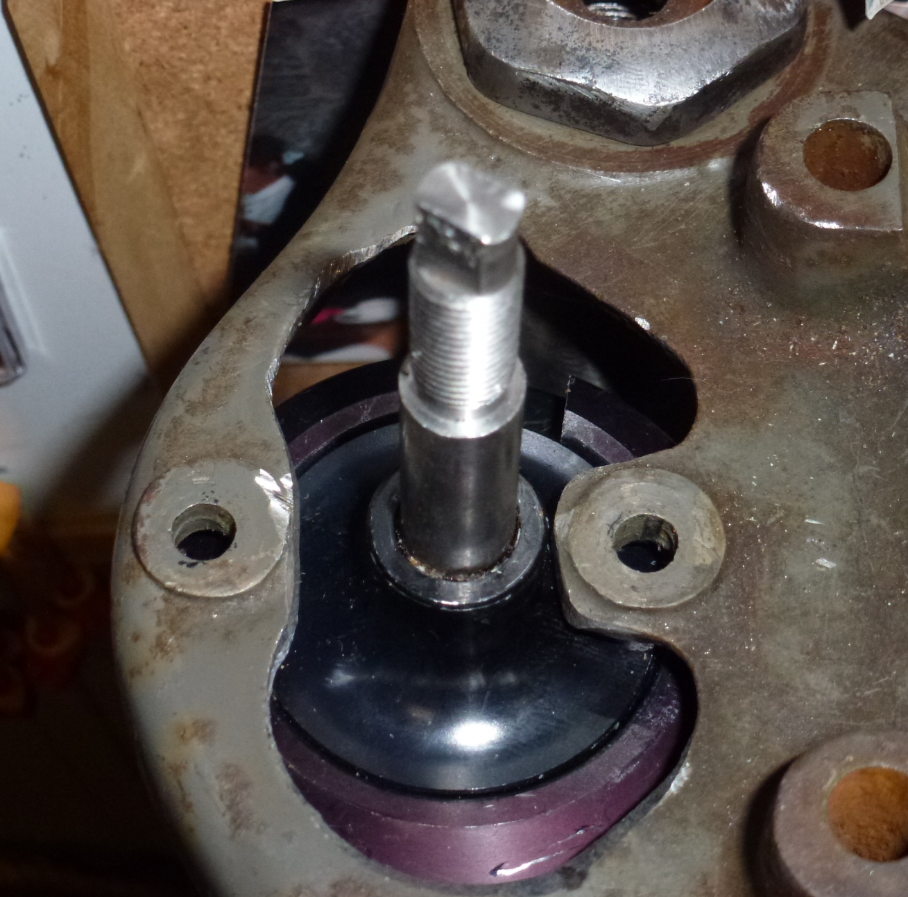

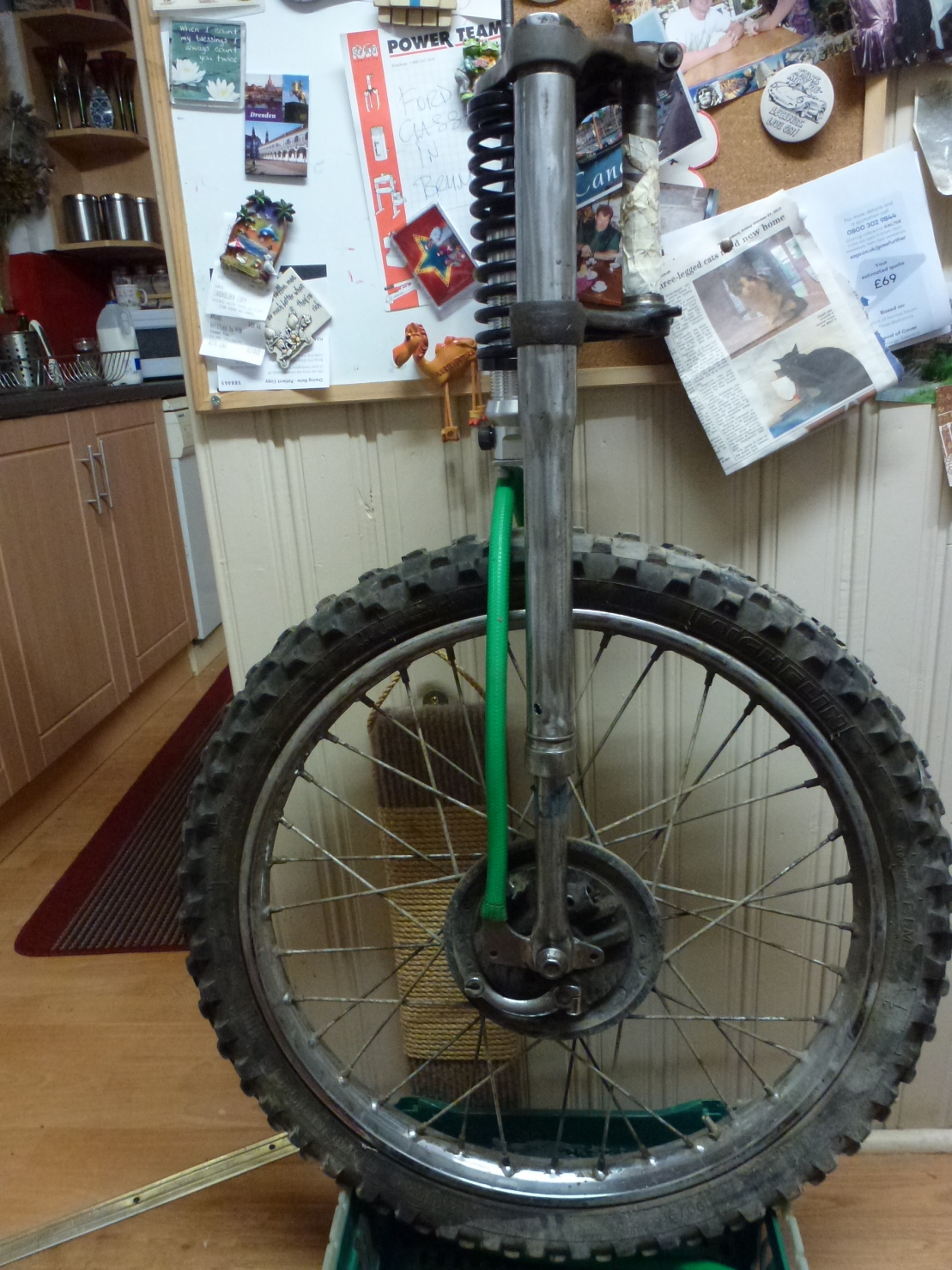

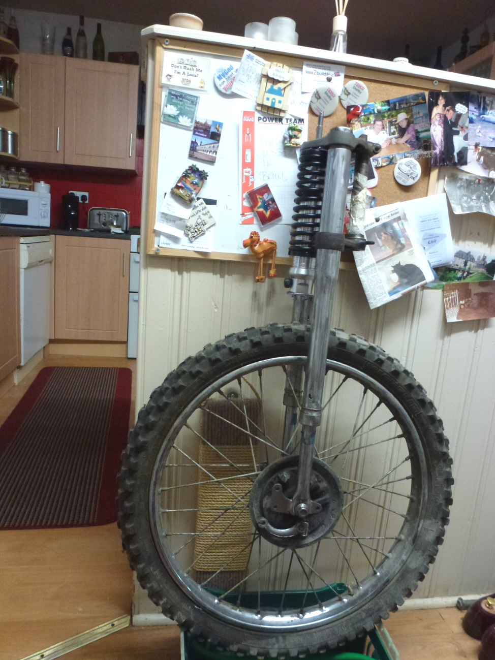

A bit more progress on the forks. The POC mock up has been completed - and YES it will work ! Pix self explanatory. There will be a plate on the top yoke for the pin RAMSHOX unit fitting and there will be a decorative plate added to the top of the "Springer" loop [ see green garden hose stand in ] with the mount bracket for the shock bottom mount. The forks are shown 1" shorter than stock, and with pre-load / sag that will reduce to about 2". My pal Brian has fettled the fork legs so that the Honda wheel spindle slots straight in - just needs shortening and re-threading.

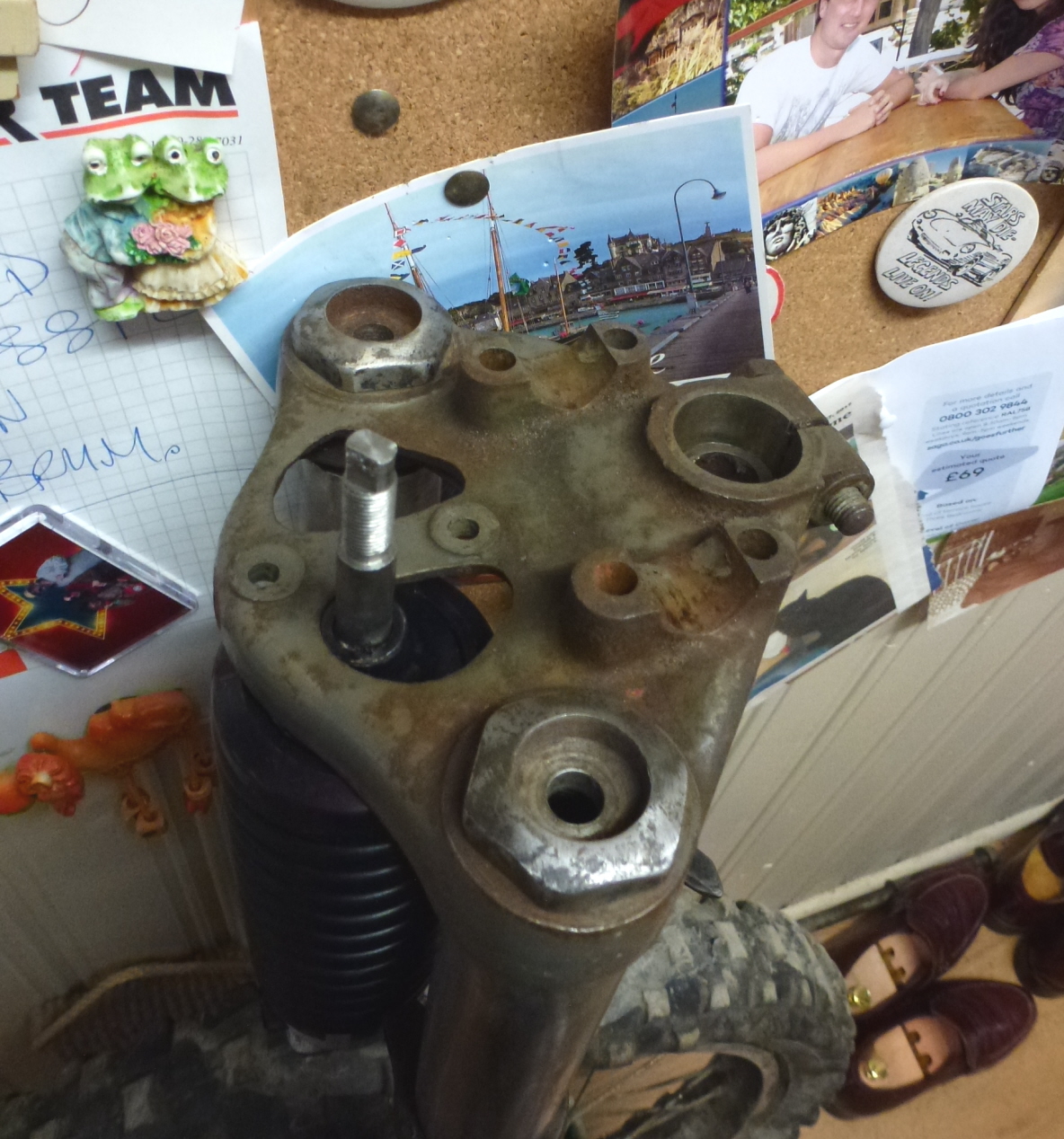

I now have all the new / refurb parts for the forks - bushes, seals, fork nuts, new [ !! ] springs, etc.,etc. but there'll be a full mock up first. I've decided to save myself some money and spray the components. definitely some sort of Coffee Cream for the cycle parts with Cream highlights - maybe wheels [ as the chrome / alloy is very good ] but definitely the engine [ yes ], handlebars and probably tank - IF I decide to spray rather than keep the 100 + year old patina.

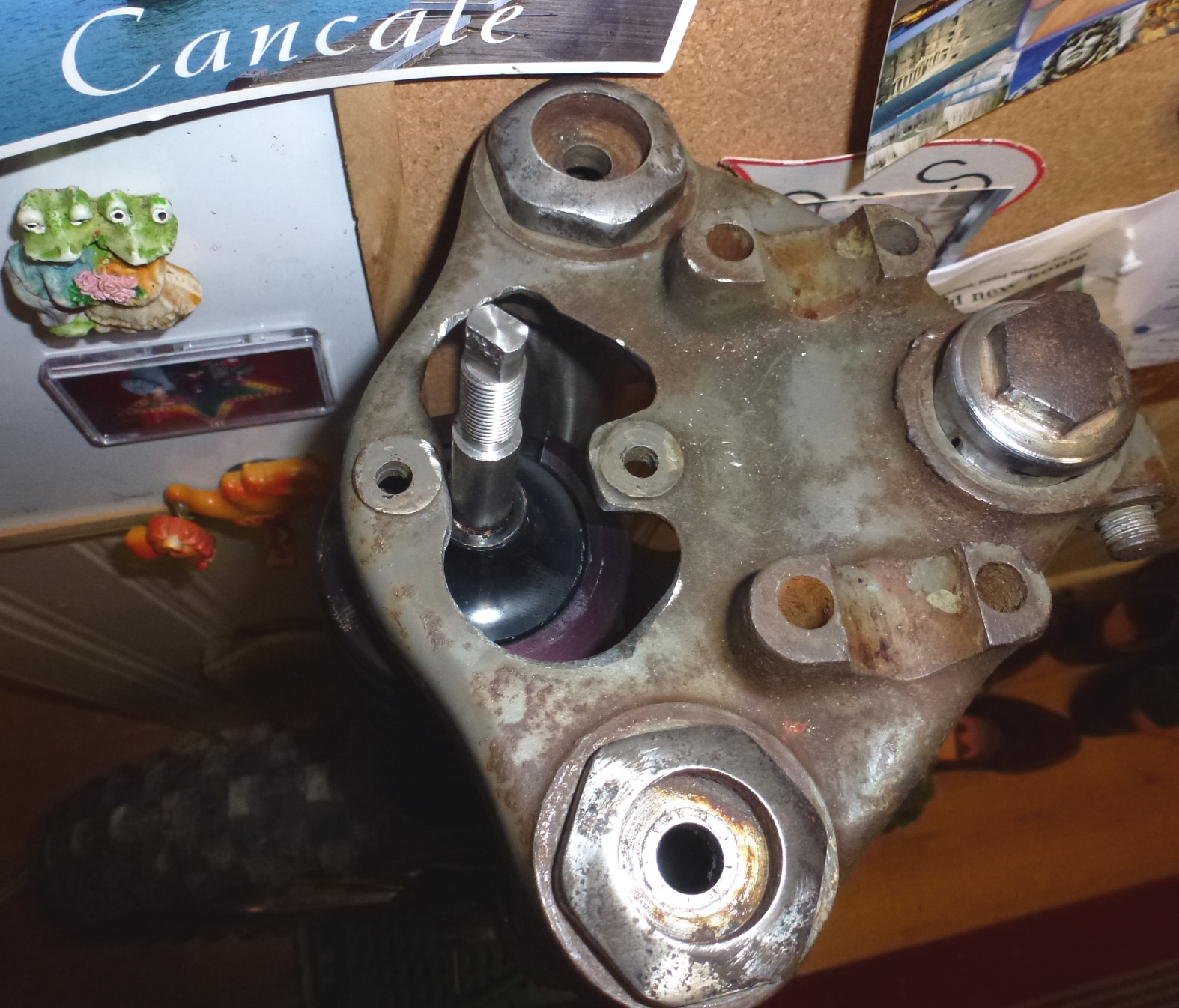

Final leg of the POC mock up. The RAMSHOX unit will fit snugly in here. Alloy plate - nicely machined if I can - to support the top pin and bolted through the threaded locating holes.

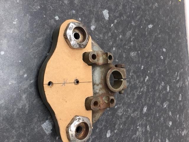

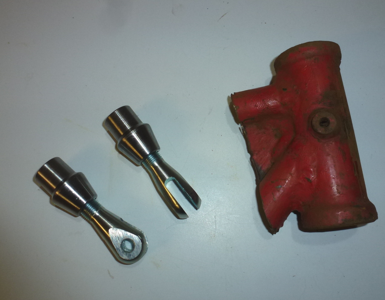

My pal Brian [ build buddy ] is now obsessed with having Brass highlights - nuts etc. he's just finished the template for the top yoke cover - in 3 mm Brass ! I'm trying to find someone who can etch in "Cafe Creme" 8)
BTW - the fact that the holes are obviously out of line is NOT Brian - but the good old factory workers at BSA ! ::)
