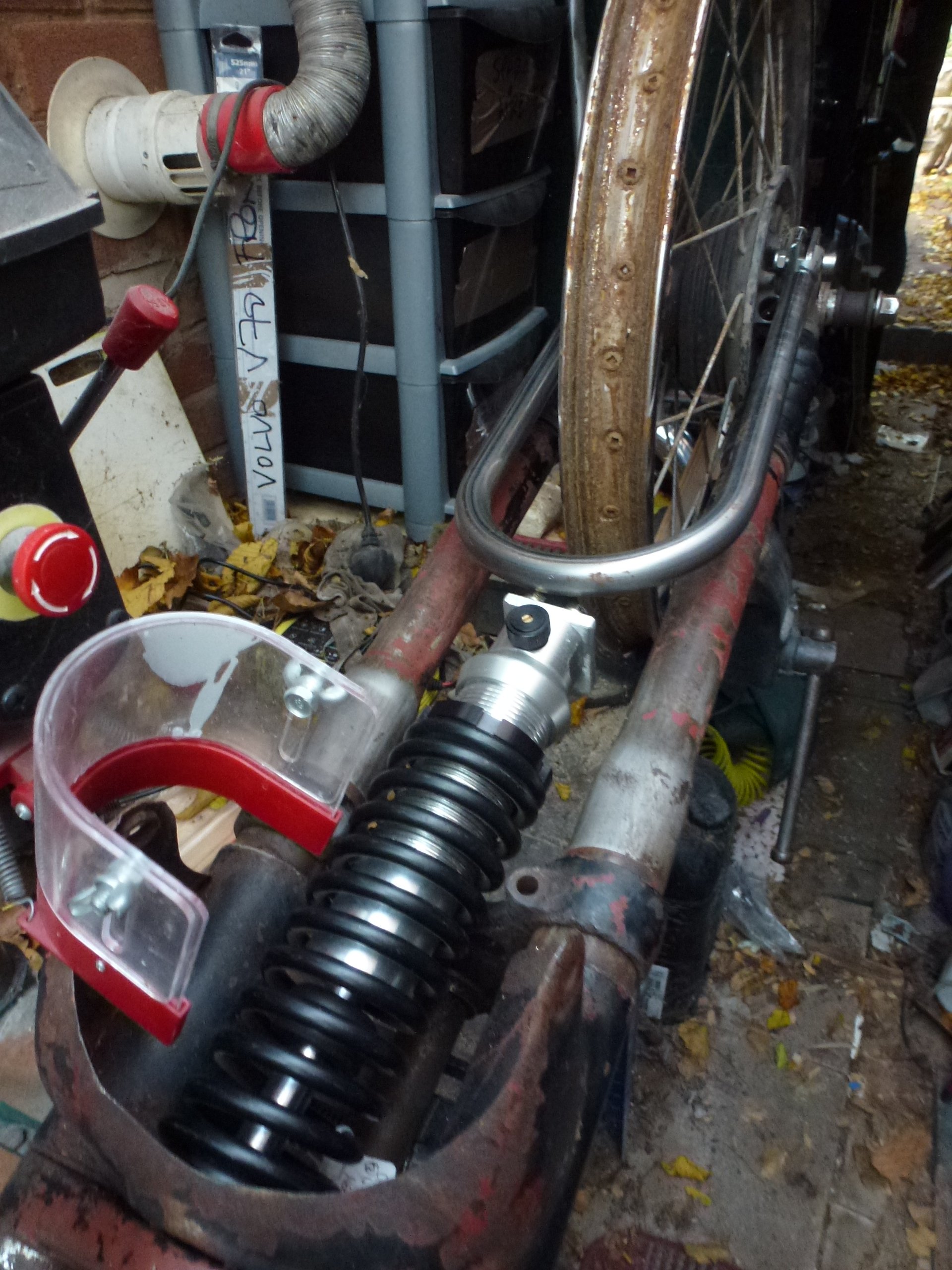

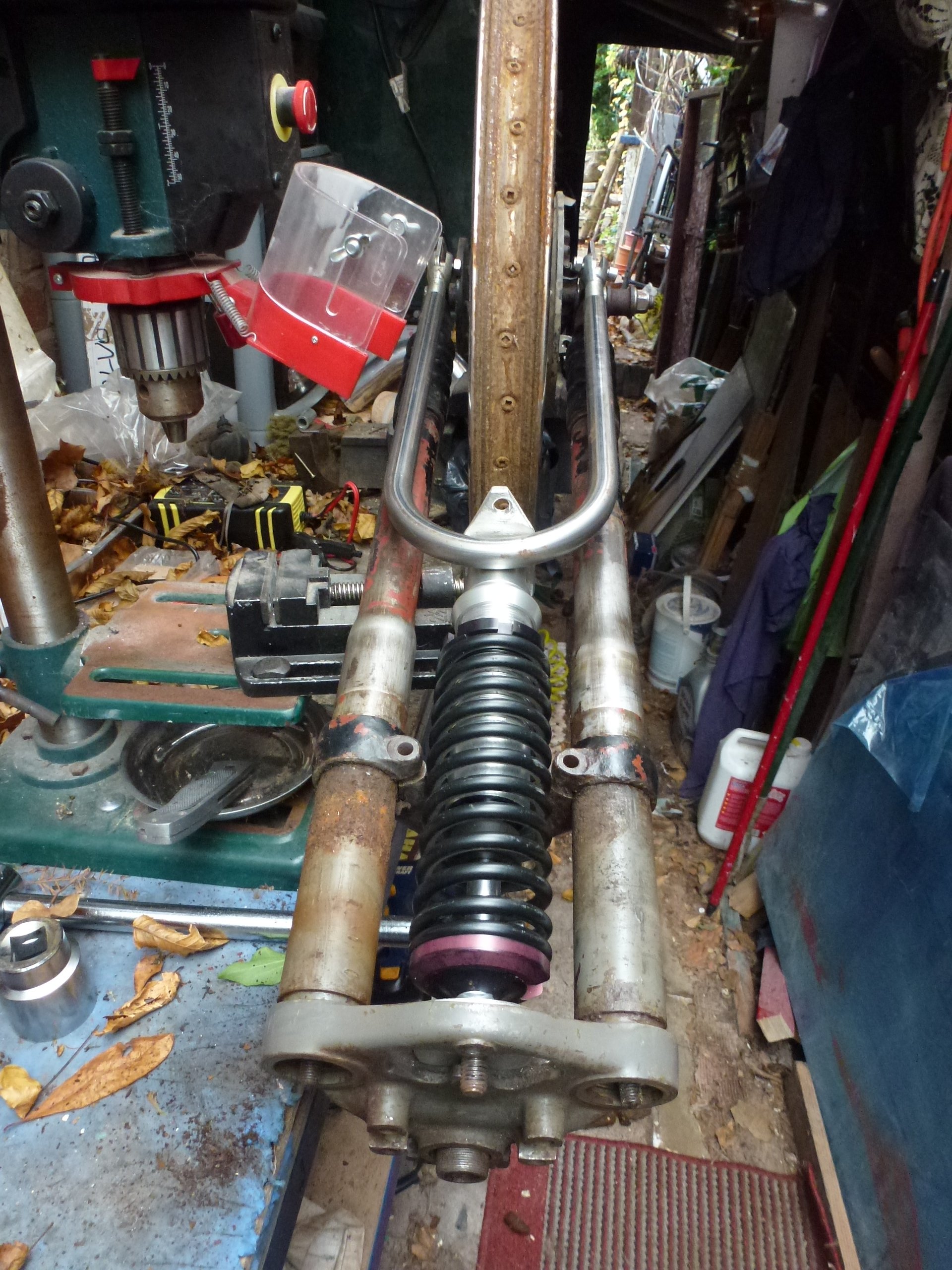

I finally got the Bantam base fork set up and the Honda XL 125 front wheel married up.
Simples in the end, just needed to ease out the Bantam spindle mount out a gnat's and it will require a couple of straightforward spacers and the Honda spindle shortened by 30mm and re-threaded for 20mm.
Even the brake plate anchor will be straightforward.
Next job is to offer it all up and make brackets etc. for the one off RAM shock and the front hoop, which will give stability and strength to the Bantam forks.

Finally able to mock up the POC fork set up. All looking good -as it did in my head !
All the measurements are now done and I can get the spindle cut to length and re-threaded, spacers made and get the front hoop cut to length and get the weld bungs attached for the clevis ends.
Once all that's done I just need to swap the top yoke for the previously modified item and then the mounting bracket for the bottom shock mount can be made and welded to the hoop.

Anyway back in the shed ....... the headlamp shroud on the Bantam forks resisted ALL efforts to remove it ! It was securely rusted down the whole length to the fork tube and top yoke. Over a week of spraying with GT89 and gently tapping. Normally I would have just cut the shroud off - but they are fetching £40 -£50 from restorers !!
I wanted to fit the modified top yoke for a final POC mock up. I WAS tempted at one point to just cut the shroud off, but it eventually came free.
Then I was able to fit the modified parts and check alignment .... all spot on. I just need to finalise the length of the hoop legs before the weld lugs are welded in place, and then finalise the top hoop to shock attachment.

The current pix are P.O.C. only and brackets, fixings etc., will be made properly for the final fit.
