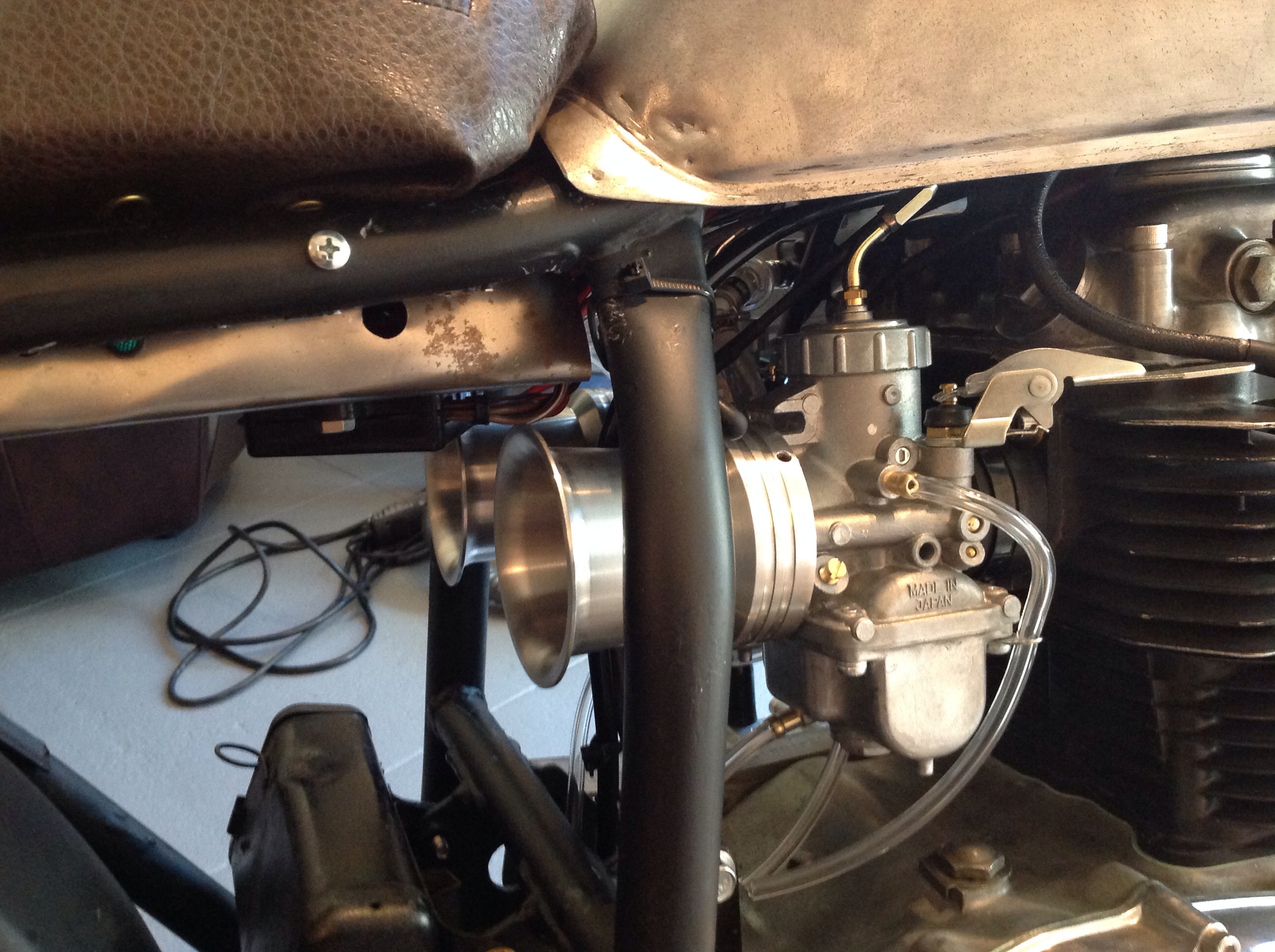

can you post a pic of the install
It's a CB360 with velocity stacks, i can post a pic if that will help

Pic of the setup
Not sure about the VM28's or 30's, but on some VM's the slide can be installed backwards, worth checking, especially on the fast cylinder.
