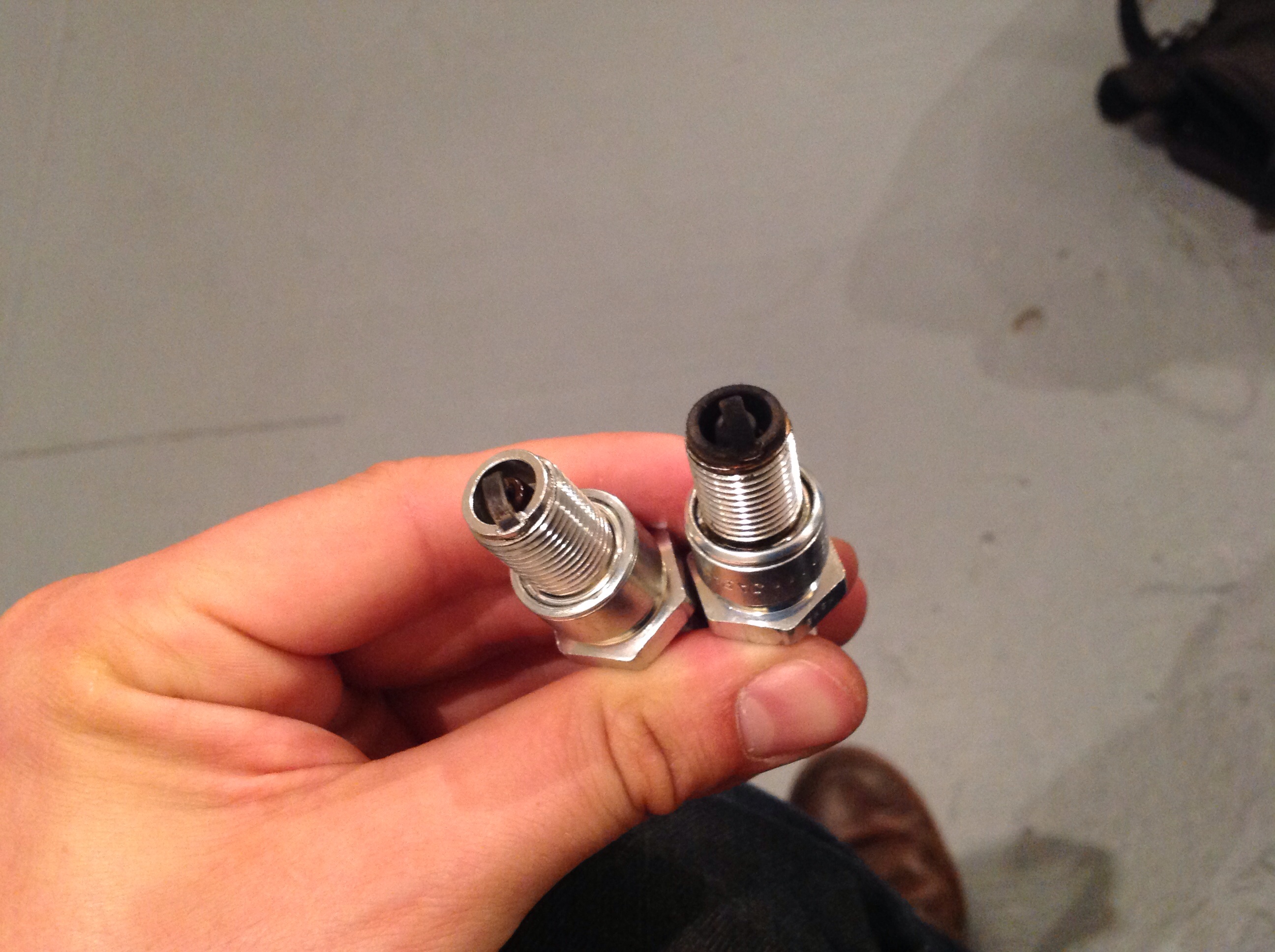

Ok so I pulled the carbs and one felt like it had oil residue in the left, then I pulled the plugs and one looks greasy?! Can that happen?
In the carbs? That's a tricky one. Maybe leaky intake valve seals? I would probably guess somewhere higher up, though. Maybe the valve covers and then leaking into the carbs from there? Not something I've heard of before.
Sounds like a good idea. If compression is good, the only place I can think of that would cause oil to burn would be leaking past the valve guides.
