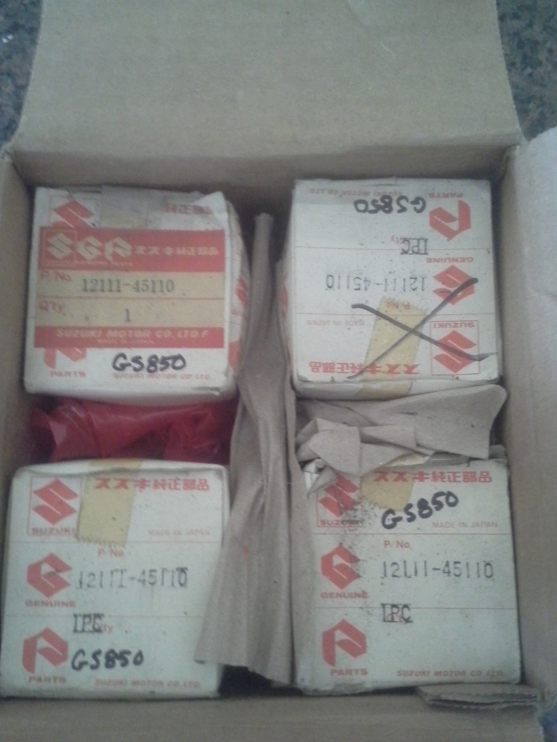

I've two sets of standard bore (69mm) NOS Suzuki GS850 pistons used to big bore CB/CL/CJ360s from their stock 356cc to 378cc.
This mod was originally developed by 'CrazyPJ' and has been well documented in various threads.
They are a direct bolt on, merely overbore your cylinders 2mm and these drop right in.
These pistons and rings have gotten very difficult to find.
CB/CL/CJ 360 stroke of 50.6mm x 69mm GS850 pistons x 2 cylinders = 378 cc, equating to a 9.5% increase in displacement in addition to the GS850 pistons being much lighter than the stock 360 pistons.
1st set includes 2x standard bore (69mm) NOS Suzuki GS850 pistons, 2x std bore NOS Suzuki GS850 piston rings, & 4x NOS Suzuki circlips - SOLD
2nd set includes 2x standard bore (69mm) NOS Suzuki GS850 pistons & 4x NOS Suzuki circlips - SOLD

WOW, Suzuki 'ran out of stock with those pistons at least 6~7 yrs ago.
The only way to get them is dealer NOS
That's actually a pretty realistic price, genuine brand new were $108~ just for single piston 8~9 yrs ago when I last priced them, rings, clips, etc are extra
One thing you probably didn't know, the 2mm over piston makes intake port work better (it's too big for stock motor, actually sized for a 400)
Open exhaust port a bit for much better performance
Seeing how easy the 378cc conversion is I'm surprised no one has bought these yet.
The 378 runs much better than anyone thinks it should (including me and I 'invented' it ;D )
120mph 'CB360' surprises the hell out of anyone (including rider 8) :o )

It astounds me as well PJ, I wish I could've found this set up when I was building my last 360.
If anyone is interested, I may have a line on another set of NOS rings to go with these pistons, PM me if you're looking for a full set.
They've been posted since the beginning of June.. Easy to bore a spare cylinder and swap, few hours at most, let me know
Not sure of the #s off the top of my head, they have been covered in depth in several threads on this forum as well as others.
I plastigauged the motor I built and had more than sufficient valve clearance, the quench area is pretty comparable to stock pistons, valve pockets line up perfectly and dont require modification.
I know PJ decked a few of his heads to up the compression a point or two, I didn't bother and was fortunate to have a square and unwarped head; I seem to recall the math working out to about 9.5:1. I ran premium pump gas and well tuned Mikuni VM carbs without issue.
