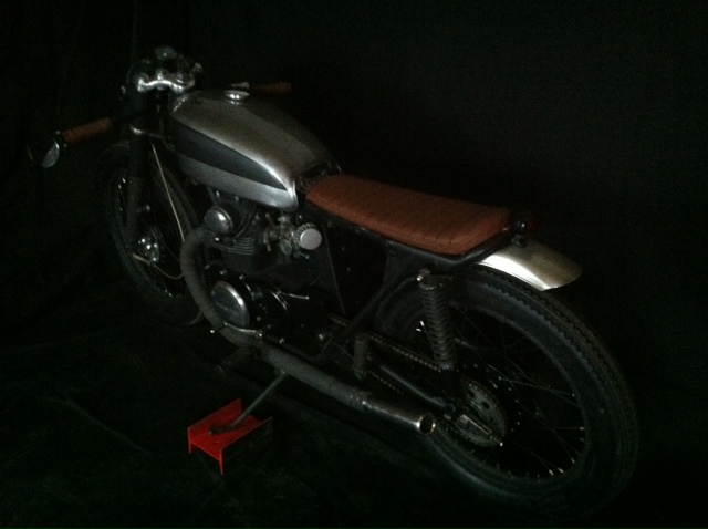

lots of work to done. but the major:
New wheels,front suspension and brake from honda nsr125 2000. new shocks, new exhausts, modified frame, engine rebuilt, new fender, new stop light(cat eye led type), motogadget tiny clock, m-unit and bottons from motogadget2, rizoma brake fluid case...and so on! :D
At the end we need to put the two bikes side by side :P

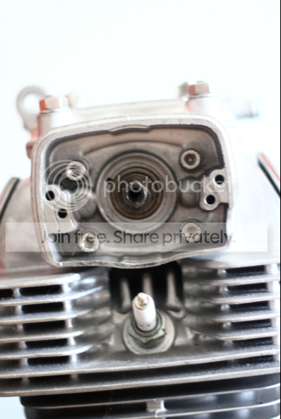

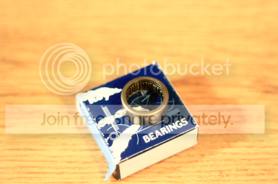

These engines are known for cam housing issues so we decided to reroute the oilpassage externally. We also decided to install a needle bearing on the points side for this being the side with the least oil and the biggest chance to die.

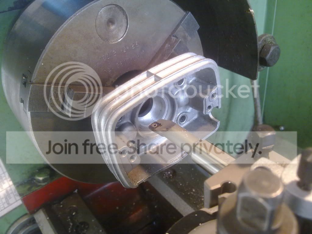

Bert used the lathe to undo the conic shape on the camhousing so it would fit in the lathe jaws. After that used the lathe again to make the camhole 26 mm in diameter and 14 mm deep. That way the original bearing in the camhousing wasn't completely taken out so the camshaft stays aligned and the bearing has a boss. Needle bearing was then pressed in. Man he is so smart ;)

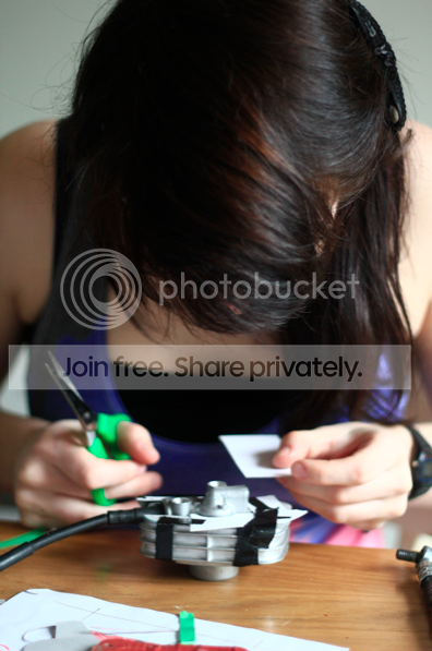

We also made a template for the CNC mill to cover up the cam housing. Maybe we're not the sharpest tools in the shed, but with a lot of patience and luck i managed to make a scan to finish in Illustrator. I guess we missed a simple solution, cause first we tried to make a mold with marzipan :P After that stupid plan oldfashioned paper and scissors seemed the best option.
