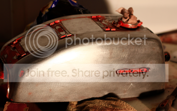

Started yesterday on my fueltank. I was planning on removing all the paint and leaving it unpainted (except for a transparent coating). So i bought "super-paint remover" and started enthousiastically :)
Coated the whole thing in smelly goo and waited. and waited. and waited. nothing happened.
Tried the old-fashioned way of sanding paper. Cause of 2nd christmas day I had to do it by hand. Don't think my neighbours would enjoy the sound of a electrical sanding-thing while eating their christmas-turkeys.
Today i almost finished it with the machine. Still a lot of work. Last bits of paint will be removed by sandblasting next week. The top part will be covered by a black thing.
Leaves the big question: what to do next? My first idea was to leave it unpainted and to find a way to 'etch' a logo in it. But where the old tanklogos were placed, the tank is really ugly. So the first option is to place the original tank logos back on the fueltank (which is nice but a bit dull too...)and the second option is to find a way to cover the holes on the sides.
Any ideas or opinons on this subject?

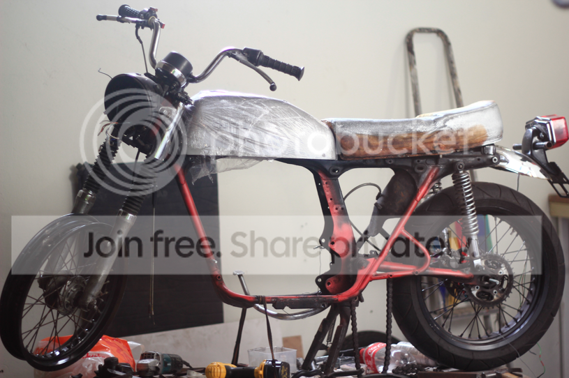

I bought some rims from a derbi senda supermotard moped, hoping they would fit somehow. Rearhub was a straight fit (haha wtf!) and front rim is now on the honda-hub using a creative spokepattern and make the old spokes fit.
My McGyver friend Bert Jan laced the wheel. Whoohoo, progression at last!
Also made a quick photoshop on how it could be. I'd like all the advice too make it better, hotter, tougher, sexier, sweeter and so on ;)

Netherlands? Upstairs garage? Awesome pully-to-upstairs-garage? This build looks like it will be awesome! For the tank, they make dent filler material that you can use to fill dents, but I'm also guessing you could use to fill those holes. Of course then you'd have to paint it, or do something to cover up the filler. What if you took the logo bits and customized those while you look for a way to etch a giant Honda wing into the bare metal? Just rando thoughts, looks great so far.
Re: CB200 '73 tracker project
I think the bare tank with stock emblems and the rubber center strip would look killer. IMHO, I learned the more time you dick around with trying to improve and improvise, the more time your wasting. Work with what you got.

I've been working on the fueltank again, but still not sure what to do with it. I agree on the fact that you should not mess too much with things that are allready good (honda-logos etc) but i'm hoping to come up with the perfect idea. I'll come back to that later, maybe it will all come together when i got the frame powdercoated and the engine in place.

I'm not sure if i make it even shorter. If it is possible i want enough space for two people so i can take my sister for a ride. I also think that making it shorter and smaller will result in an too tiny looking machine. After all, it's only a 200. But seeing the lovely deus-builds, it makes me wonder if i should make it smaller after all? Any opinions would be welcome :)
Last question:
In this picture you can see a gap between the base plate/seat and the frame. How can i fill this? We're planning on chopping the frame after the rear shocks and create a hoop, but it would be nice if it followed the lines of the seat.
Thats all for now, love to hear your ideas ^^
