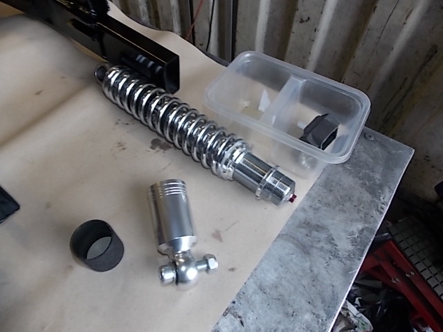

I use NJB Ultimate shocks instead of Hagons....big bonus is that they are length adjustable by 50mm. They're made by Norman Blakemore who used to be a Girling development engineer, has a small unit over in Colchester. Once I've decided on the length I need I make up an ali collar (painted black in pics) to cover the exposed threads...
I have looked at NJB shocks before. How do they compare to the Hagons and how is the finish? They seem rather cheap but seem to hear good things about them.
They're certainly not cutting edge or anything but I've had maybe 10 pairs from him and no complaints. From a building point of view its nice to be able to set the shock length to what you want and see thats it right rather than have a pair made to a specific length and hope you're got it right.
