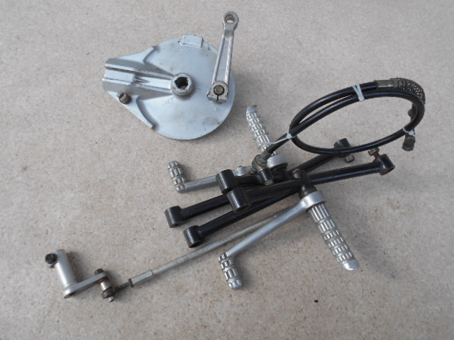

However with every step forward there's another back. My original plan for the rear brake was to use the original mechanism, actuated by a cable from the new rearset lever. That's simply not going to work - due to the longer shocks increasing the swing arm angle, the swingarm now hits the brake mechanism. The rearset lever is also much too close to the brake spline, so that again wouldn't work anyway. This one's gonna take a bit of thinking about - I may be able to convert the brake to cable actuated rather than rod actuated. Suggestions would be more than welcome!
Here is a pic on how WM (JDM accessory maker) do the honda GB rod to cable conversion. maybe it will give you some ideas ....
Thanks mate. I think I've actually sussed it now though.
So....
It turns out, with my natural riding position, it's comfy for the rearset arm to actually be below the existing spindle. It looks extreme, but that's where my foot was when I sat onto the bike and got myself comfy...
So that then makes everything much simpler. I can cut the arm down at the back and move the mounting point closer to the spline, giving clearance around the swingarm..... i.e.: move the pin to where my fingertip is in the next pic. This might then mean I can use the existing brake rod. However how well this will work with the dropped swing arm is yet to be seen, I may have to convert to cable, but even that would be much simpler if I do it this way. So all I need to do now is cut the original brake pedal arm down, drill a hole in it, and make a linkage between that and the new rearset arm. Might mean that my exhaust needs a rethink...
