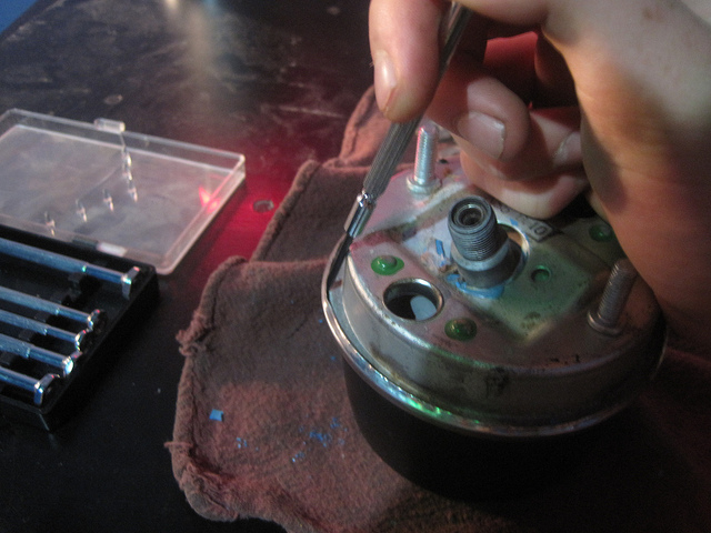

Took apart my Tach today, would have done the speedo, but one of the screws striped >:( . I am getting in the mail some guage overlays from a CJ360, I think they look cooler and more retro. Taking the guage apart was easier than I thought, and I thought prying on that ring would make it bend and look like crap. I plann on putting some LEDs in, looks better and better for a small battery. And sorry for the off focus pics, looked good on the camera, too late now.

While you are in there, check the drum right under the spring for grease on it. They are supposed to be CLEAN but after sitting for years the grease they stuck up higher will fall down and get stuck on the drum which will stick in between it and the little shield thing that sorta covers it. Clean it off and it will rise and fall as it should, not slow or not at all.
That is the main cause of sticky gauges, when I did the faces on mine I cleaned the shit out of them before I put them back together.
