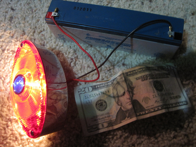

Got my battery in the other day and just got around to taking pictures. Its a 2.9 ah 12v battery that weighs 2.2 pounds and as you can see pretty small. It was under $30 too, hopefully it works for what I need it for.

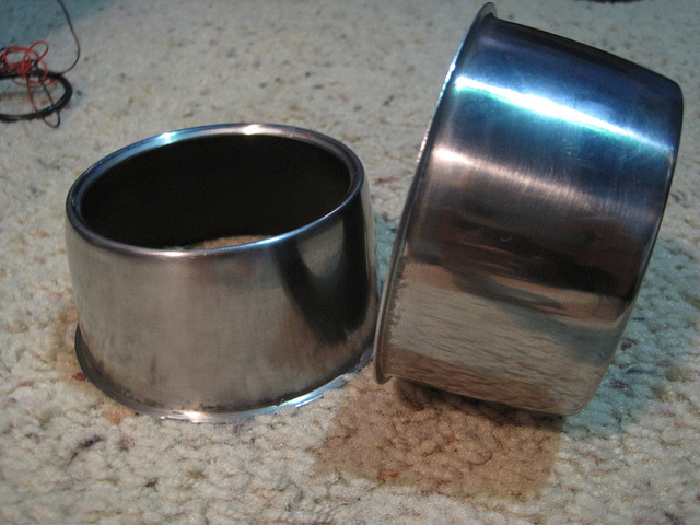

My gauge faces (overlay decals) came in today, and I put them on tonight and look great, or so I think. :D
I am also polishing my gauges (even though they are steel). In the picture I am not done polishing them.
AH yes, nothing brightens the look up like new faces and polished housings. Make sure you paint the insides of that green part white, it makes for a difference when the lights are on and its dark outside.
Thanks, its good to know this stuff before I put it back together, will do thanks!

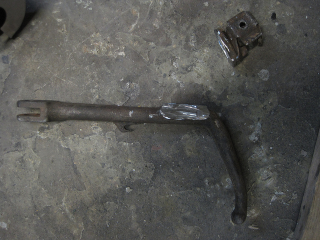

Today I cut and cleaned up my kickstand, I intended on keeping the rubber piece on the kickstand but when I was taking it off it ripped. I also finish/redone my license plate/tailight bracket, were it hugs the lines of the hub and chain and sproket. My light housings for my guages got painted white, from advice a couple days ago.
