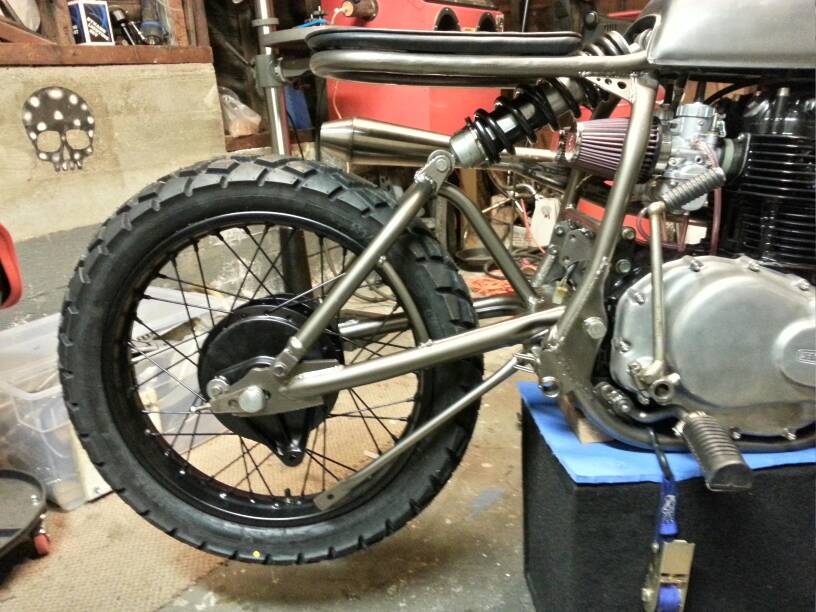

Thanks to everyone for the encouragement. I feel like I'm on track to taking her for a ride next weekend if all goes well. Of course that really means 2 weekends, you know how that goes.

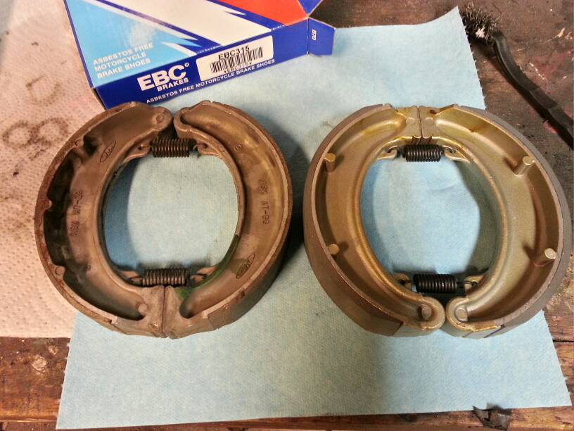

New brake shoes....and...I've got a roller again.
I painted the wheels with black duplicolor wheel paint and the local shop mounted the tires for me. I'm happy to say the front tire fits nicely.

What size did you go with on front?
Not the 110 you mentioned earlier?
Whatever it is, it's too wide for the 1.60 rim, the beads are 'pinched' and sidewalls angled/bulging
I would have to agree, doesn't look safe. With that pinch and no fork brace your front end is gonna be as stable as jello..
now that is pure hotness right there! idk what to tell you about the tires. i always thought the "pinch" was a poor idea, but then a buddy of mine bought huge tires for his honda cb400. i told him it was a bad idea, but the cycle shop that put the tires on said as long as the bead mounted on the tire, it would be fine.

Yeah, each shop as their own tech's that think differently and I'm glad you at least noted it to him, and the simple "if it fits it ships" idea from the Post office isn't the best approach ;D. Compound, it does look rad, but I would heed some of the warnings here.

Yes, you can fit any tire to rim that will fit between fork legs or inside swing arm
If you put enough air in it it will increase the stability, but, at recommended pressure it WILL roll around all over the place.
Side to side movement isn't a good thing on a motorcycle
Yep, I'm running a WM6 and a WM4 combo (110/130 combo). I learned the importance of this because of this site and info from PJ back in the day. Never ran too small of a hoop, I was scared to! Look at it this way: good excuse to upgrade to alloy hoops. You can get them in pre powdered black from Mike's XS for cheap

Yeah, excel hoops and Buchanan's spokes. Not cheap, but you only live once, right? Sad thing is, front is coming apart soon to replace the drum brake with a cbr rotor (using the adapter I bought from you) and Brembo caliper and master off of a KTM...stock works but it ain't a modern brake!

Kenda 110/80 - 18's

The tech at the shop didn't blink twice about mounting up the front tire, but I realize I shouldn't trust them in the first place. I really appreciate the advice and I'll quest for finding a safer replacement (tire or rim). But for now, and my first ride around the block when I get her started. It's gonna be with this tire.
Run it around 40psi.
I would go with WM3 rim for 110/90 tyre (in fact, I do ;D )
110/80 with lower sidewall puts bead at a different angle and is actually less stable than a 90 series
Maybe get a smaller tyre and wider rim then keep the 110/80 as a spare for rear (and a WM3 for rear to replace the WM2)
